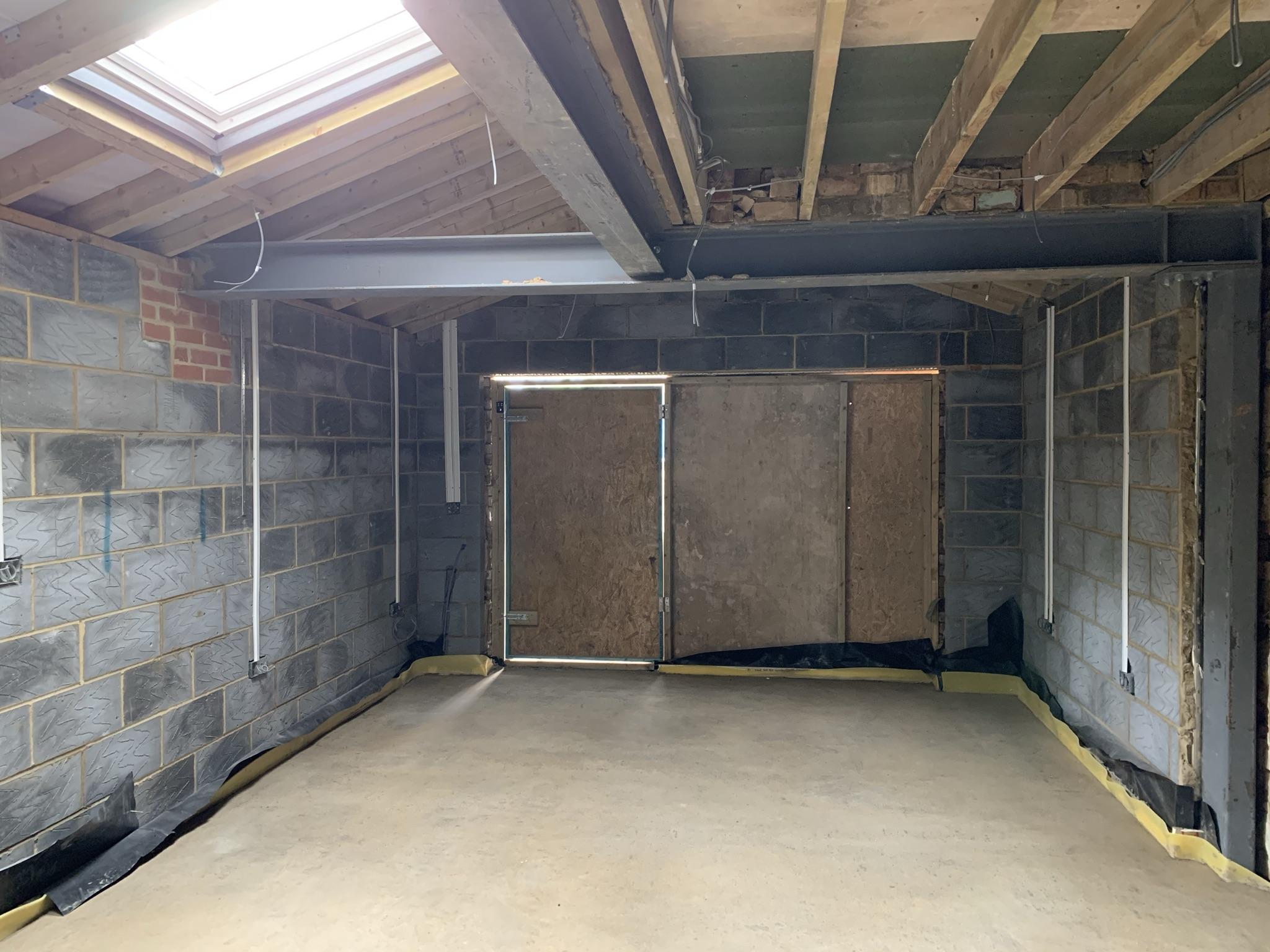

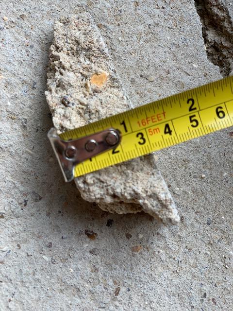

Having problems with my screed floor in kitchen extension. At one end it was too thin (30mm) and cracked so builder took up that part. More cracks have since appeared even in thicker parts (see right of photo) and today I unwittingly hoovered a big hole into one edge! Is it normal that you can hoover up crumbly patches at the edge??

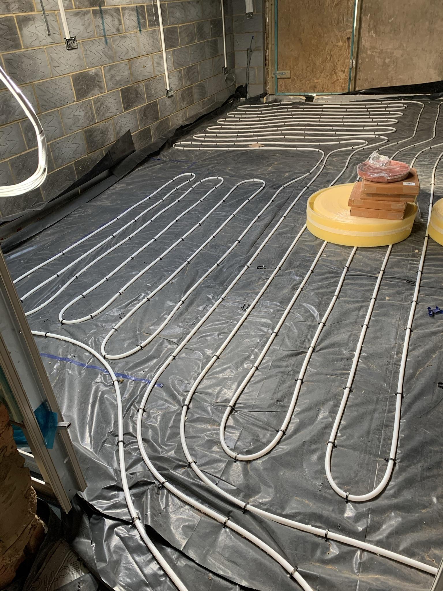

The sub-floor is not beam and block it is a concrete slab. I think a lot of the issue is with the insulation layer. It was VERY rocky when I walked over it which likely explains the lumpy appearance. I did question this at the time time but was told the screed layer would stabilise everything. I wanted to tape it but there was so much movement in it I'm not sure the tape would have held. There were also some large-ish gaps. I really should have put my foot down at this point (but it gets tiring complaining about every single thing). This is a good idea. There isn't a huge amount of room under the door frames for extra layers.

Engineered wood on top. But I would like the UFH to work as it should i.e. have something to heat! How bad would it be to rip the whole lot up? To be honest the whole thing looks like a dogs dinner in any case. I’m disappointed.

I can’t see the depth in the doorways but one has a big crack across it. I called Building Control and they said 65mm minimum. The builder will probably argue it’s only the edge which is not deep although I can’t see a reason why that should be so. Other concern was the insulation was rocking a fair bit before screed went in. So now I have an unstable 200mm insulation base with a ‘too-thin’ screed layer on the top. Yes the pipes are embedded.

Hi, new to this site. I am renovating on older property and have installed a solid floor in the old part of house and new extension (concrete base + 150-200mm celotex + UFH + screed). I'm worried about the screed as it has cracked near the door. Apparently this is normal when a large door is installed but I measured the cracked part and it is only 30mm. Difficult to guage the depth of the rest of the floor (although measured less than 50mm in another part) but I'm worried....should I be? Also the screed appears to have large aggregates in it. Is this normal?
