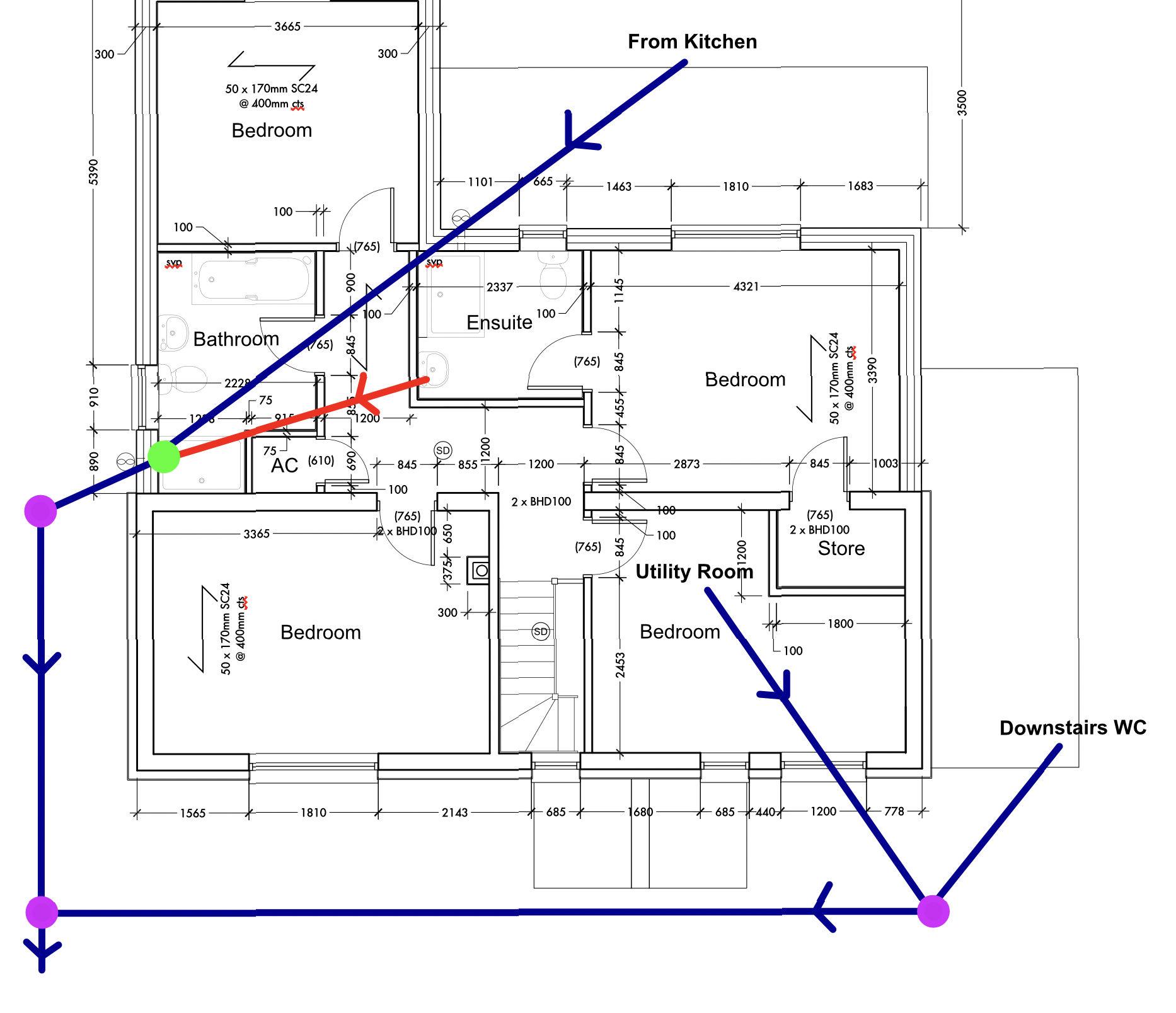

Thanks for all the comments; this forum is a trove of information! BC said it was OK for our kitchen waste to connect via a branch into the same run from the stack to the inspection chamber. I didn't know about the stack not being able to connect to a branch though. We've got a rest bend at the base of the stack into a 'Y' branch on the inspection chamber run. That's the "green blob"! We'd prefer a separate inspection chamber for kitchen waste too around the back of the house but the falls don't allow it - we'd be well above ground before we'd got round the back! We have Posi-Joists but I understand the point that, even with them, it'd be difficult to thread through at an angle. Can we go straight left with a slow radius 90 bend to the stack in the corner or is a change of direction not allowed 'above ground' (i.e. in the first floor) either? BC basically said to us "we're happy as long as every run is roddable", which it would be with this set up; but doesn't really help the specifics of achieving that.
Hi all, Wondering if someone far more knowledgeable than me can look over our drain plan to make sure it's workable. We're planning to have one stack in the corner of the upstairs family bathroom which the ensuite in the middle of the house can connect to (we have posi-joists so can pass it through them) and the downstairs kitchen waste can hook into. This will go out to an inspection chamber and then off to the sewer. The downstairs utility room and WC will connect to a separate inspection chamber at the front of the house. Presume I'd need AAVs on the main family bathroom stack and ensuite but unsure how natural ventilation will be achieved - presumably the gulley on the kitchen run won't suffice? Main sewer in our street is quite high so trying to keep runs to a minimum to make sure falls are right. Blue lines: underground drain runs Red line: upstairs drain run Green blob: main stack Purple blobs: inspection chambers

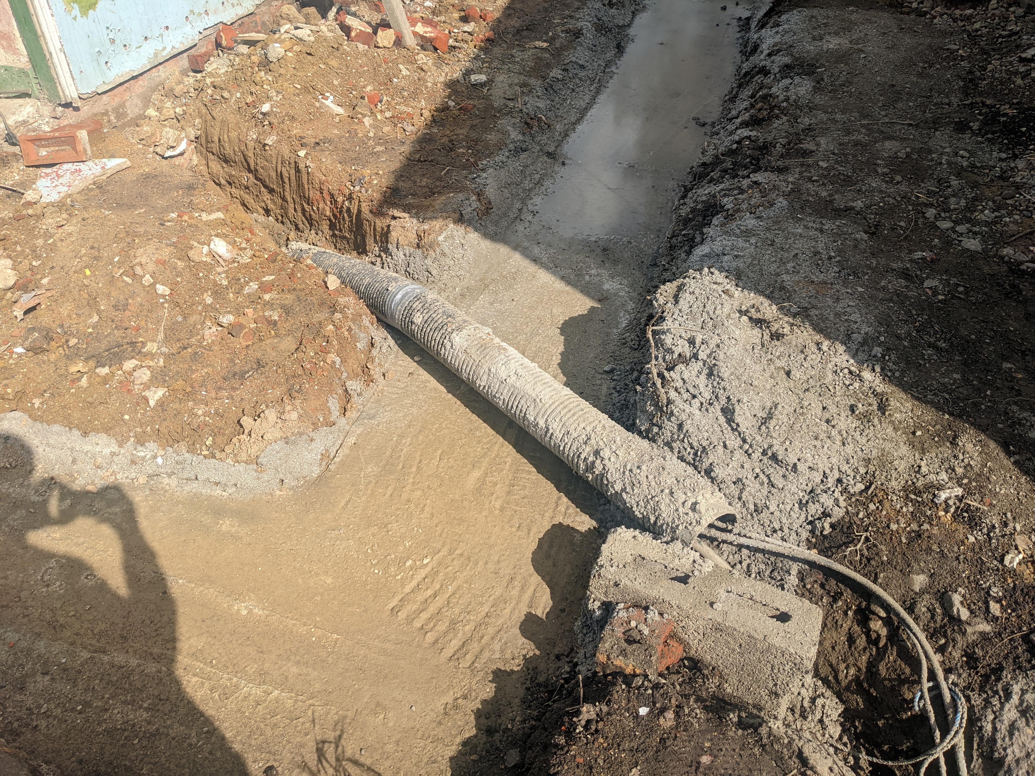

Thanks all. Yes, I knew there was an obvious solution I was missing: cut out the trench block. Obviously. It's been a long week!
Thanks all! Yes, would have buried it under the footing but it's all connected up so didn't have that much play in it. The issue I have with lintels is that they will go over the trench block in place of the engineerinb bricks and will be seen as it'll be above ground level. Yes, quite. That's why I thought the duct would go through the footing, continuing the 600mm depth. BC insisted they prefer the cables to come up from depth and lap over the top so the foundation itself is continuous, the logic of which I sort of understand. We can build up the earth a bit around the cables (they're all armoured too). It just feels wrong to penetrate the DPC all the way through; I can't see how that's better than having set the duct (which is corrugated for load) within the footing of a single-storey lean-to. But there we go.
Hi all, Our electricity line comes in from a meter cabinet the other side of the driveway (as it's 3 phase). It's buried at 600mm deep under the drive but BC said nothing can penetrate the footing so were advised to bring it up and above the top of the 600mm footing, through DPC level presumably. Having poured the foundations, it just doesn't seem right. We're one trench block and two brick courses away from DPC. The ducting you see (which I'd originally intended to be buried in the foundation until the inspector said otherwise) currently sits on top of the foundation. Trench blocks would go either side but we'd then presumably need lintels above (where the brick courses would go) which would be very obvious and unsightly as they're out the ground. I'm sure I'm missing a better way to deal with this?

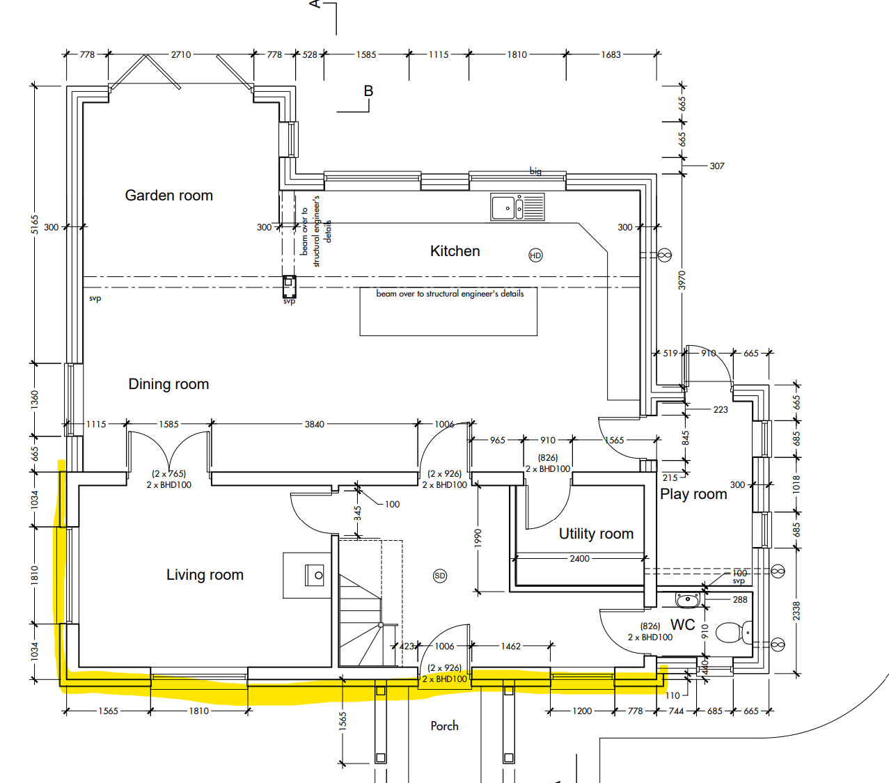

Thankfully ours is a fairly standard 100/100/100 build-up so I'm hoping SE/BC are happy with 100mm 7.3N block, concrete infill and another 100mm 7.3N block instead. More work (of course) but I can't afford any more delays if I can avoid them!
Hi all, We're about to pour our foundations and am looking ahead to getting to DPC. We need one course of trench blocks and two courses of brick. However, despite it being a standard-ish two storey extension, Building Control and structural engineer are saying we need 7.3N trench blocks?! My bricklayers say they've only ever used 3.6N and 7.3N are for three storeys+. 3.6N 300m wide blocks (for a 100mm cavity) are readily available but 7.3N Thermalite or concrete blocks are seemingly out of stock with long lead times across the ccountry. I just can't get hold of them. The only alternative I can think of is to use two 100mm 7.3N blocks and infill with concrete. Those blocks are available too. Have I missed something? Is 7.3N normal here?
