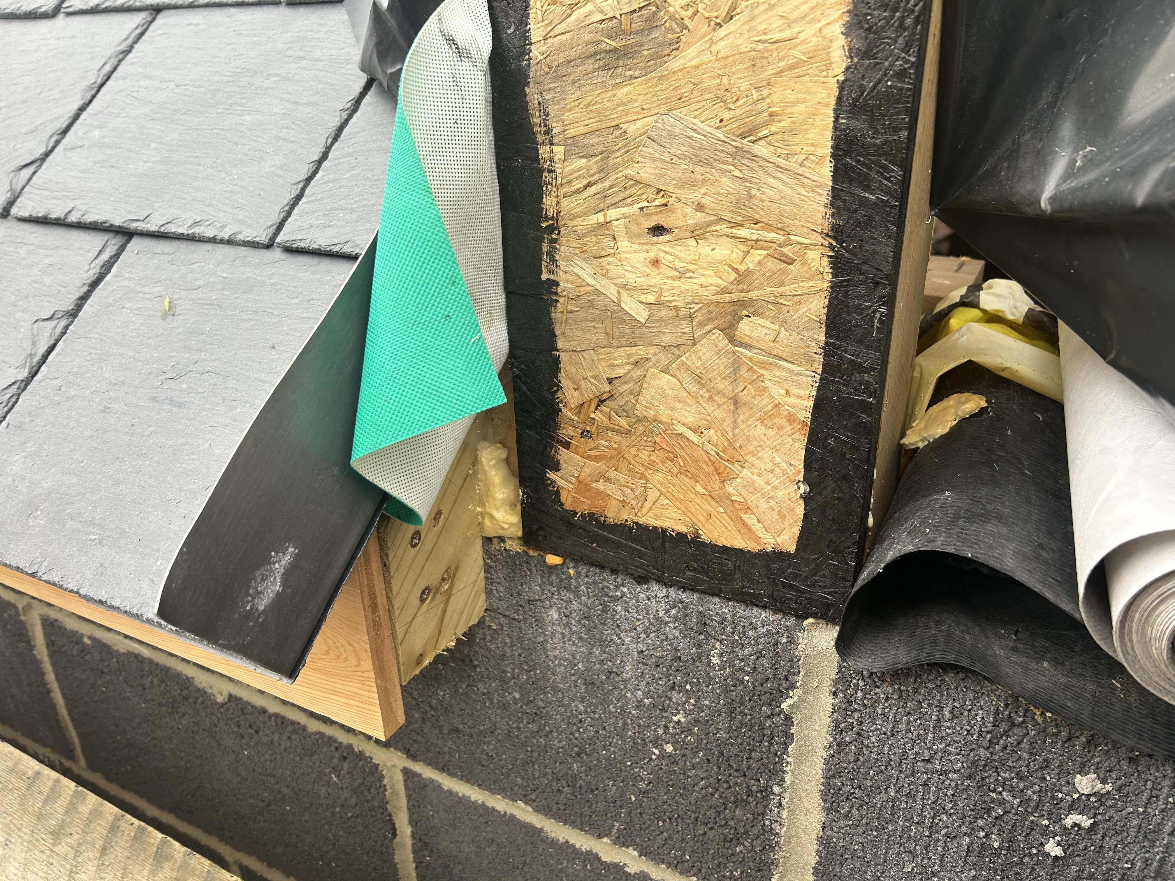

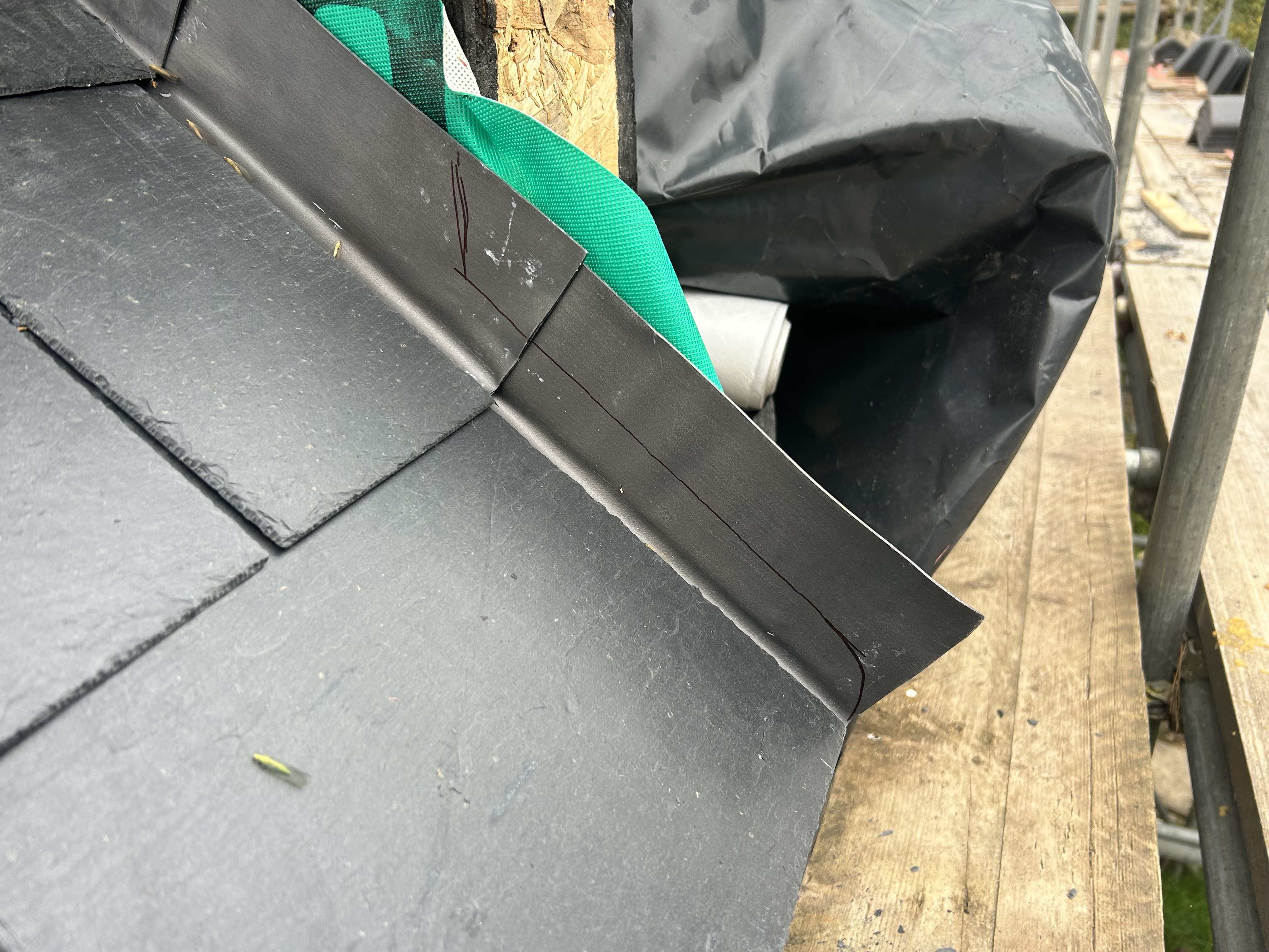

Hello, I have a question regarding the flashing/wrapping of our dormers. I understand how a dormer should be flashed if it’s in the roof I.e lead corners and a lead apron however our dormers run in line with the wall on the house so I can’t see how this would work and can’t find another detail for it. Currently I have run the soakers right down to the bottom of the slates with a view to cutting them down so that water doesn’t run off the side of the roof. I understand this is probably wrong but it seemed like a good idea at the time. The pen line marks where I had planned to cut the soakers (or possibly a little lower) any advice would be very much appreciated.

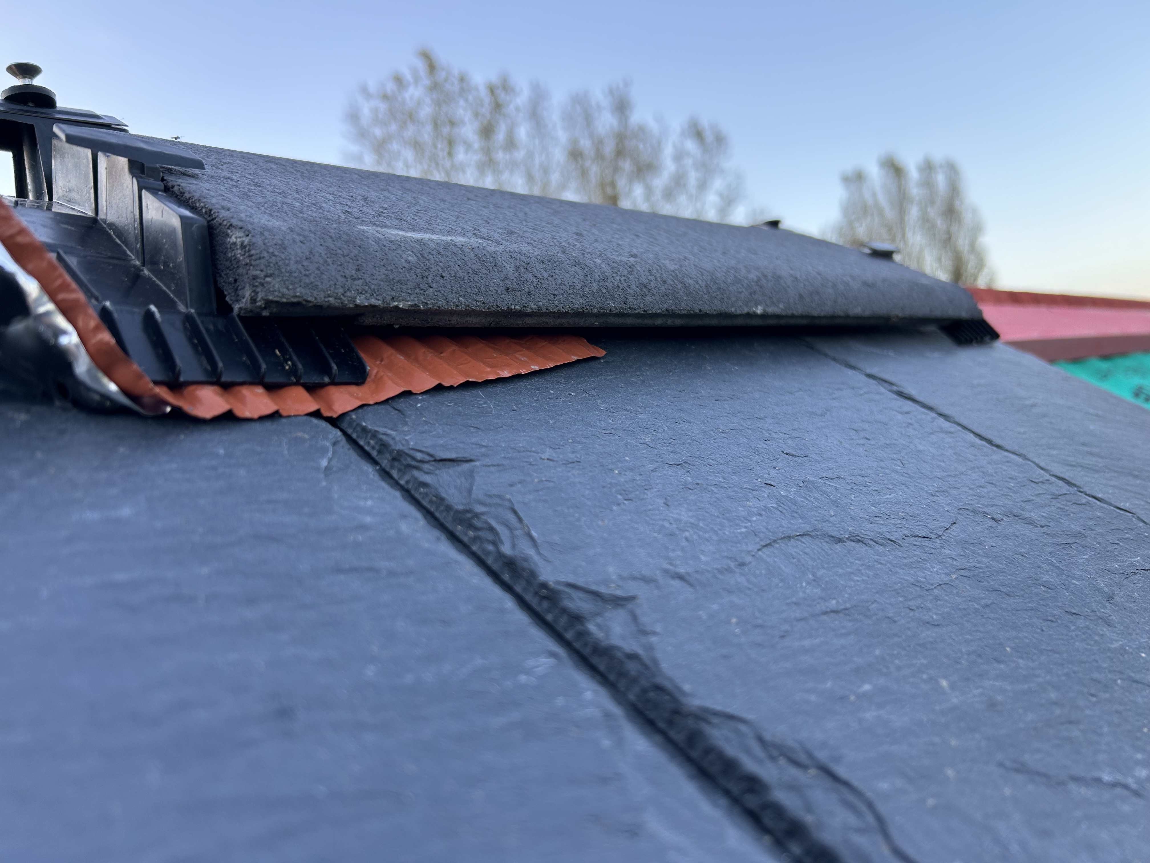

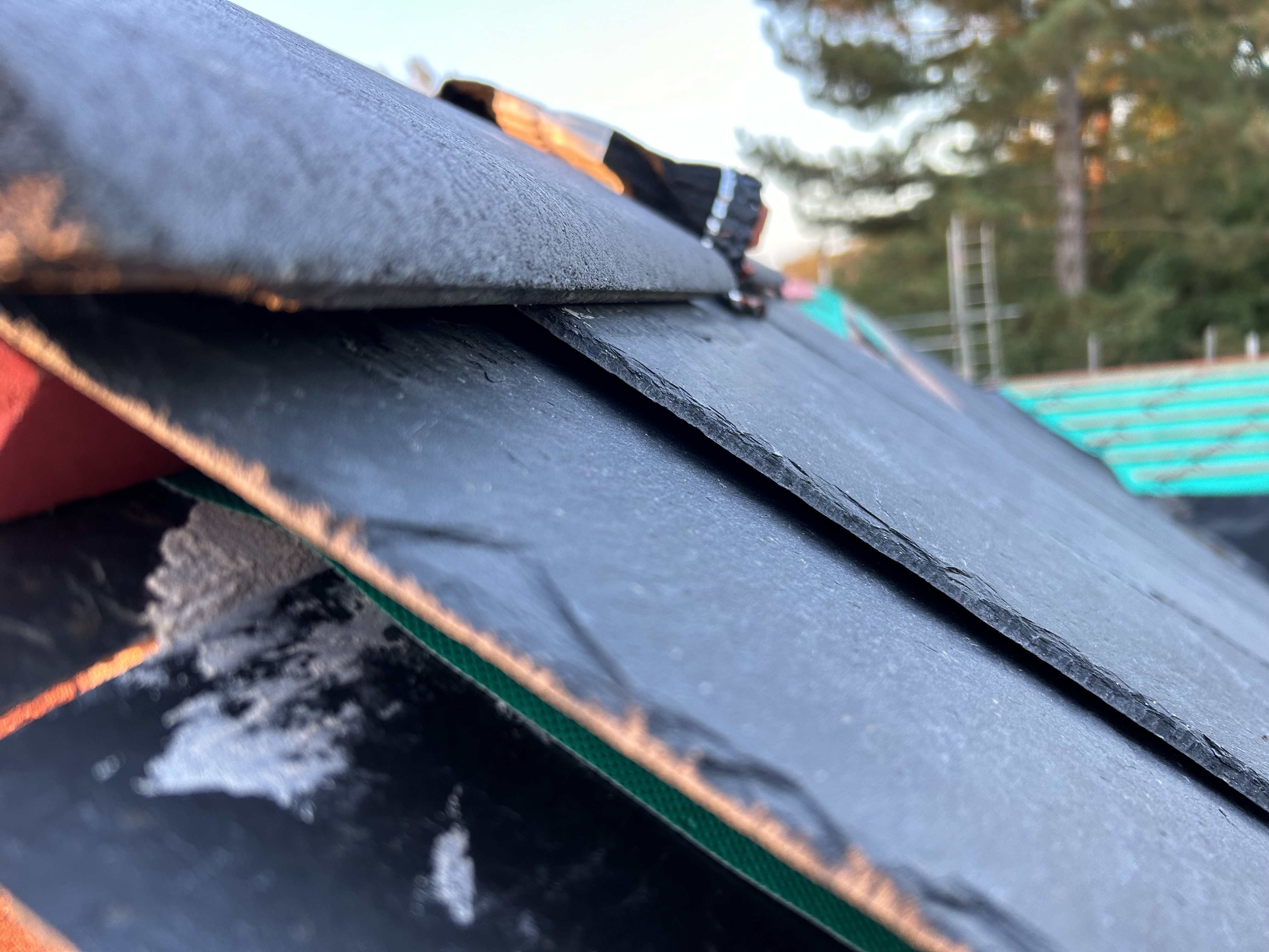

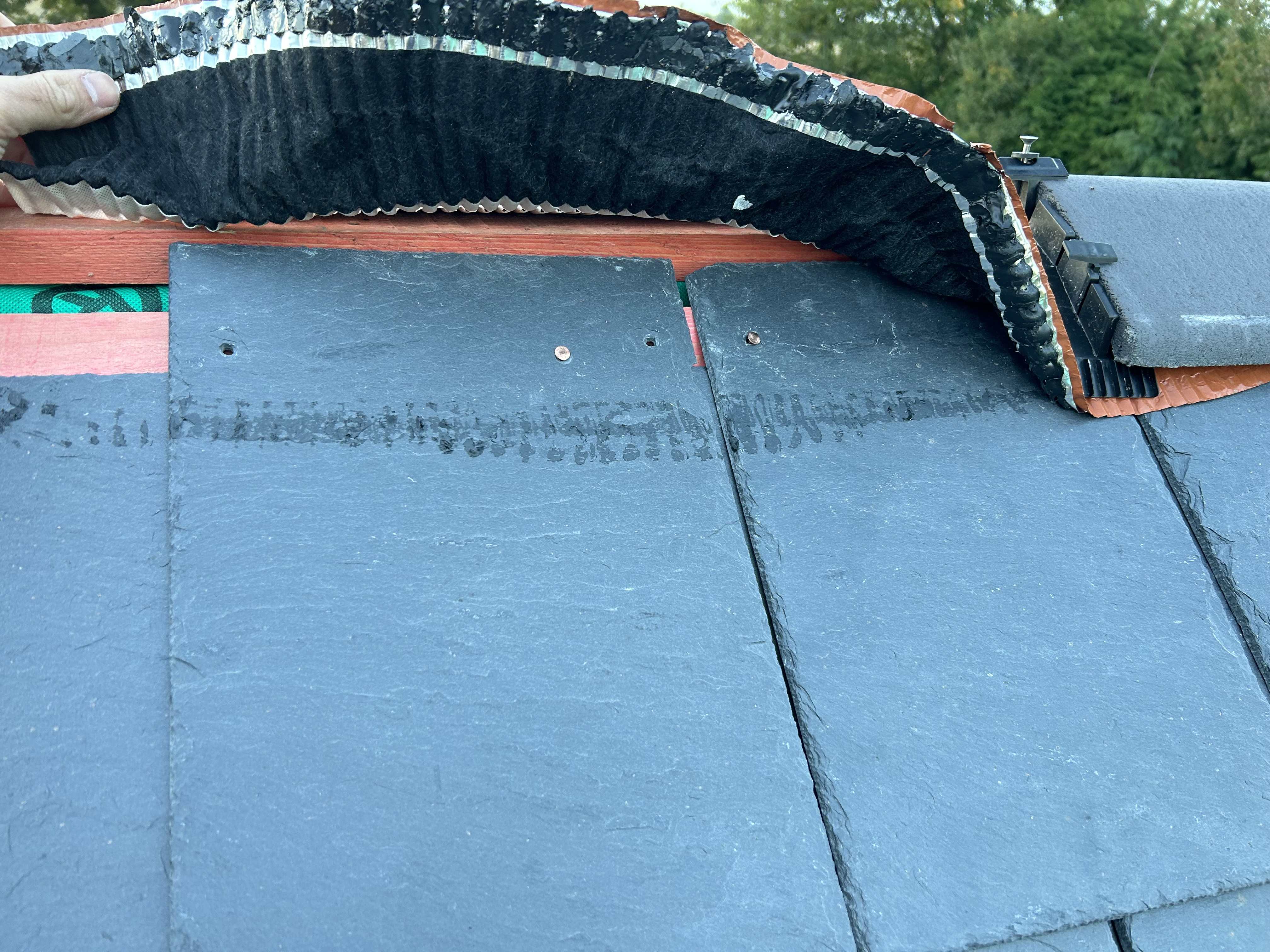

I have finally made it to the ridge on my roof and have a couple of questions regarding the top slate. please ignore the rough nature of the slating and mismatched ridge roll, these were my reject slates and only fitted for mockup. Is this the correct way to fit the top slates in terms of the lap? The area where you can see the batten seems vulnerable but I can’t see a at around this. Using the dry ridge system leaves a small gap between the slate and the ridge tile, around 5-10mm. This is because the ridge tile has bottomed out on the ridge batten. I can’t really drop the ridge batten because it will leave a dip in the top of the ridge roll which I believe is not desirable as it can collect water. Adding a fillet under the top slate on the top batten improves the gap and makes the slate more stable as the slate now can’t rotate around the nails and lift the bottom edge. the only other way I could get around the ridge tile gap is to go and find some taller ridge tiles or drop my ridge batten down.

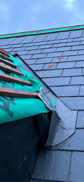

Slate and a half in valleys, advice needed.
bluebellcottage replied to bluebellcottage's topic in Roofing, Tiling & Slating
@Gus Potter I should have made it clear in my post that I am the guilty party when it comes to the slaying of the valley. For various reasons I have ended up slating the roof myself and am generally fairly handy. I have however quickly become aware that l slating is an art and would have been best left to the professionals had this been an option. i have used a slate cutter for all the cuts so far and laid them riven edge up (with the exception of the under eaves course, this is the other way up) is this correct and what you refer to as the slates needing a tail in the valley? Thank you for any input. -
Thank you both for your advice. I think I’m possibly overly worried about the small triangle of slate being insecure. Will the slating that has already been done be ok as it is Or will I need to strip and re do this? The valleys currently have 65mm cover from the slates, they have a 25mm up stand which is why they look like there is a large gap where the lead is flat on the roof it’s wider than 65mm overlap as the lead roll is 450mm I followed a diagram forwarded from our architect for this but understand now that it’s possibly over complicated. Does this sound ok or am I setting myself up for a leaky roof? -

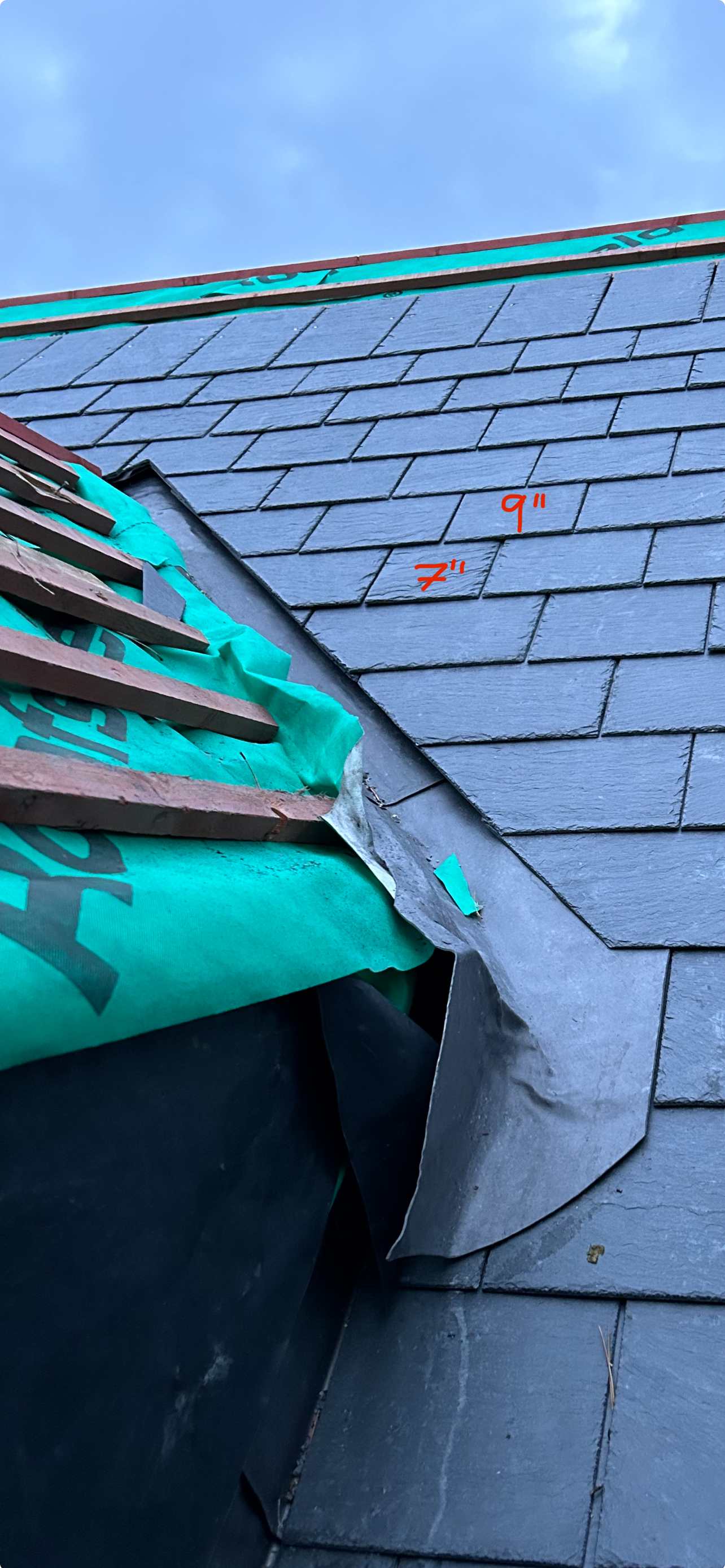

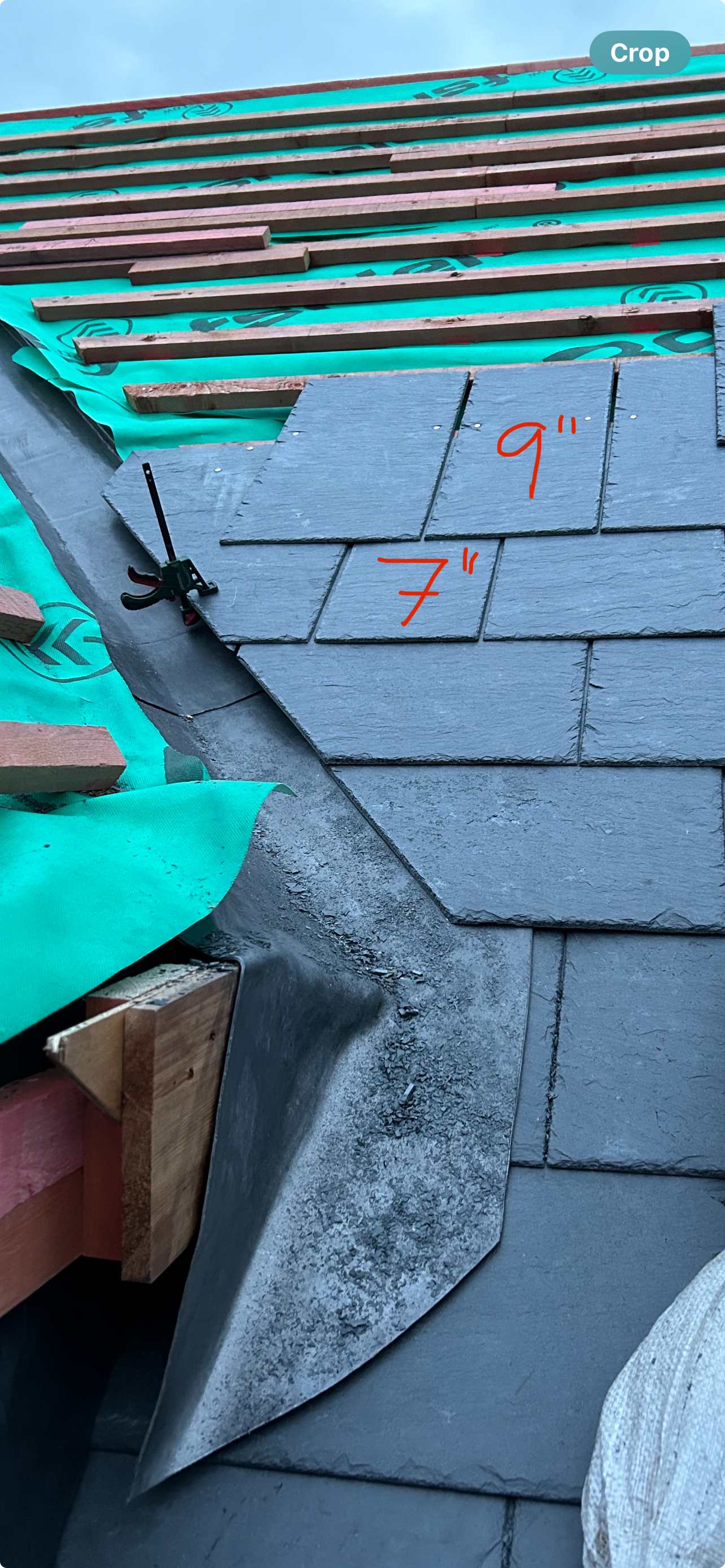

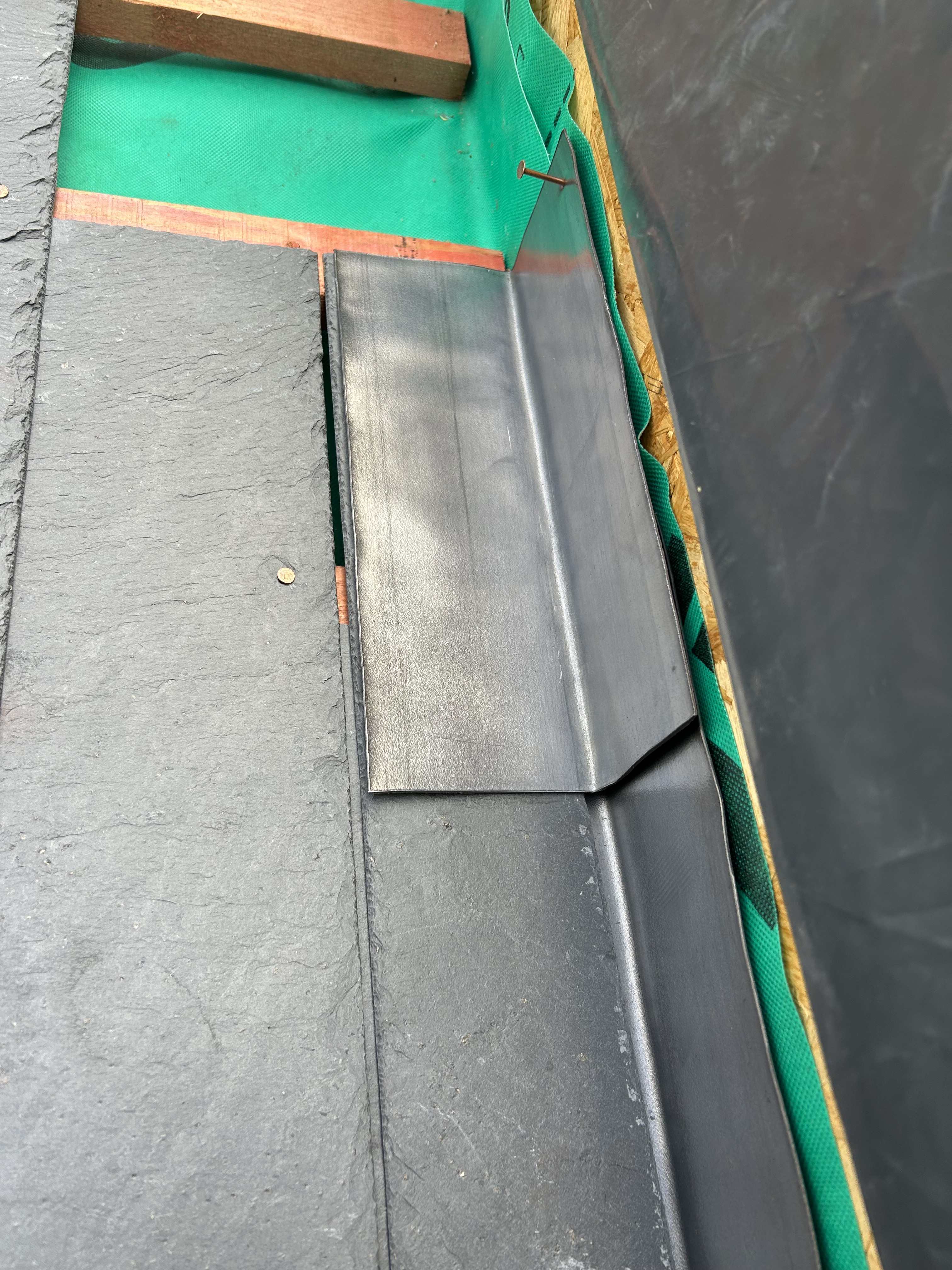

Slates and soakers at dormer cheeks
Hi Nod, thank you for the reply, I would have made the soakers wider but had already cut them to size and I would have meant another trip to the builders merchant and holding my father in law up, he was also of the opinion that water doesn’t travel sideways normally. The pitch on our roof is 40 degrees and we have about 90mm of headlap so hopefully we should be ok. no I have to decide if I do the next side the same or use a slate and a half? -
This week we have been skating in our roof, I have slated uptown and past the first dormer on the front and back of our house and am worried about the detail of the soakers and slates. i understand a slate and a half should have been used here but was persuaded to use a 9cm wide slither of slate instead, wind uplift probably isn’t a problem as it will be behind/below our cladding. i am basically worried water from the valley above will run off the soakers and down the side of the 9cm slates. i have included a photo for reference.
