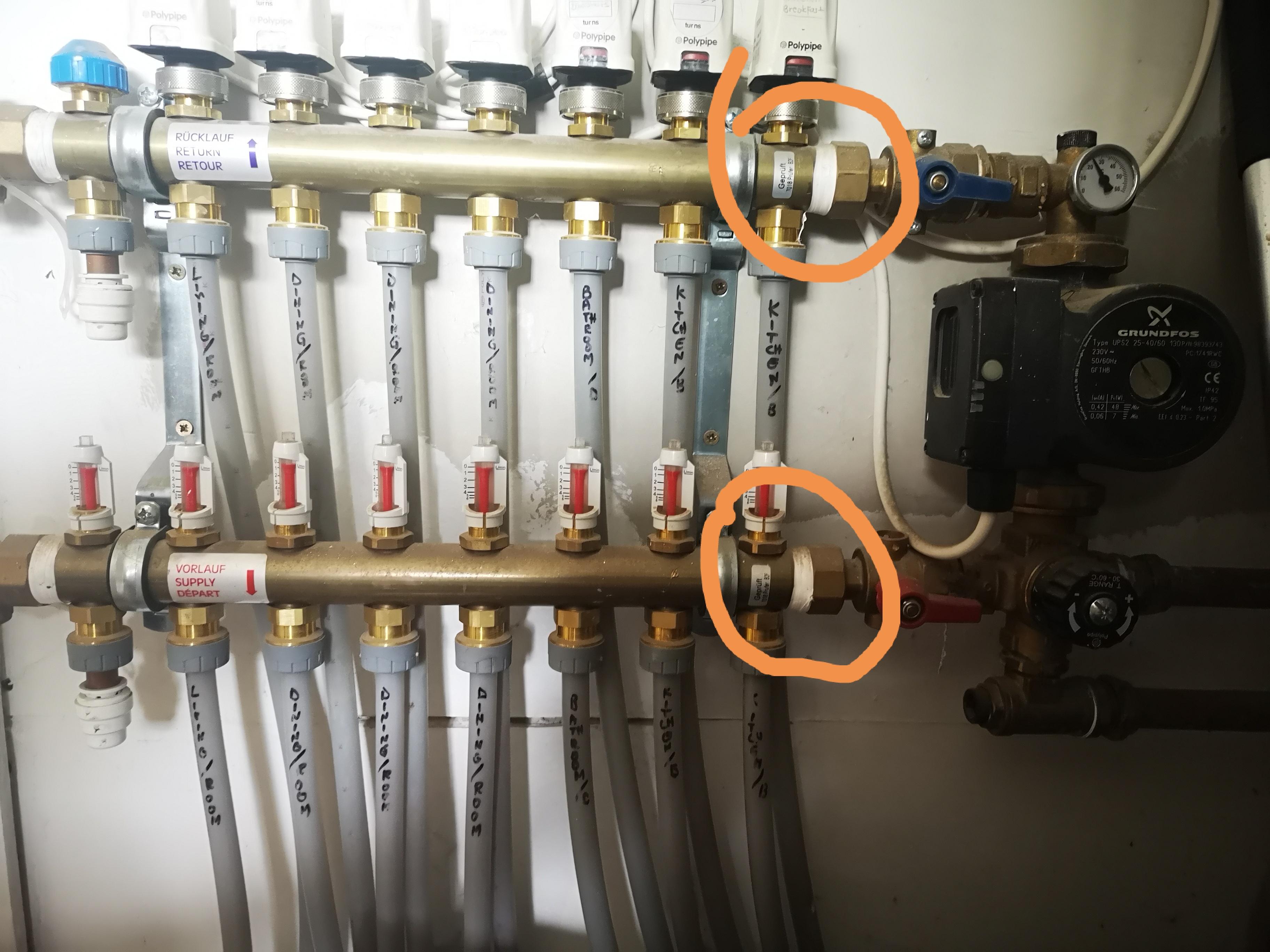

Just wanted to check these are the nuts that I need to unbolt after closing the red and blue tap? Then i swap over the manifolds, but once I reattach I probably will have lost some water, is there anything I need to do to ensure the system is refilled correctly and there is no trapped air?

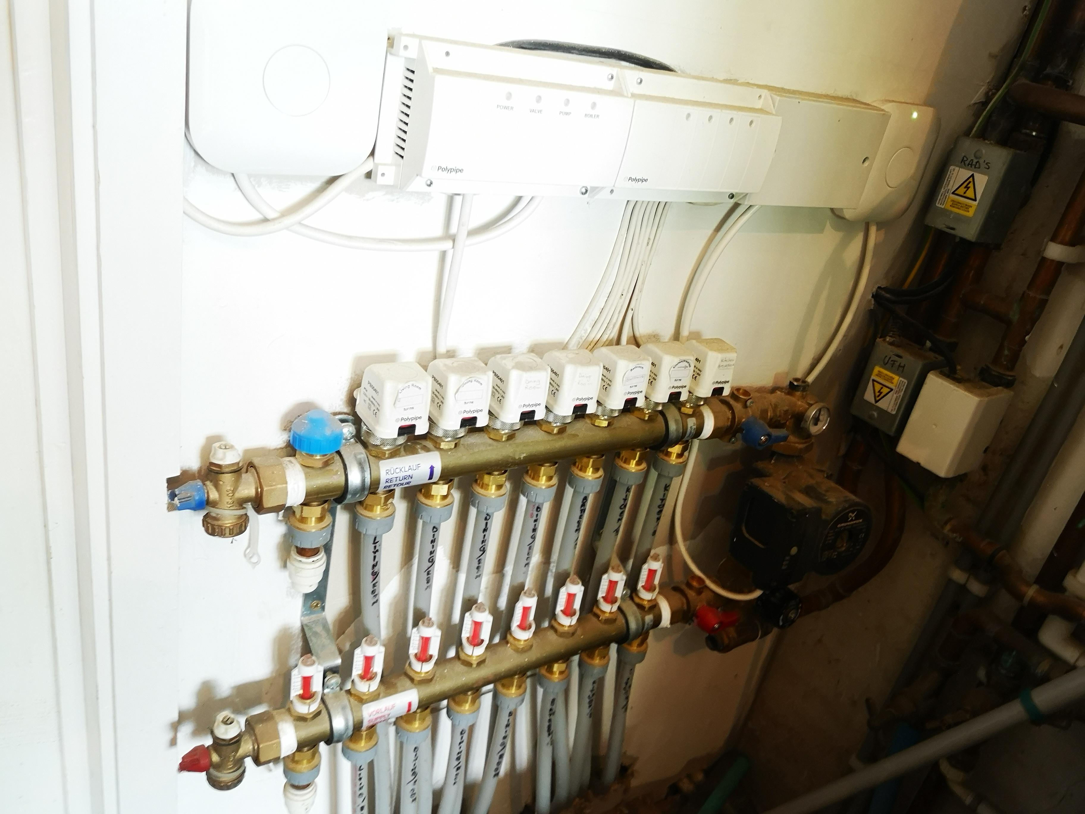

It's the same manifold for both old and new extension

Thanks @PeterW for the advice, much appreciated. Attached is a photo to the left of the manifold, just caps with one spare zone.

The bottom pipe is the one which gets hot first. Is that correctly setup?

I hope that helps, I was told by someone that the pump is the wrong way round which makes sense as the out pipes are warmer than then in pipes. Will be looking to change this
