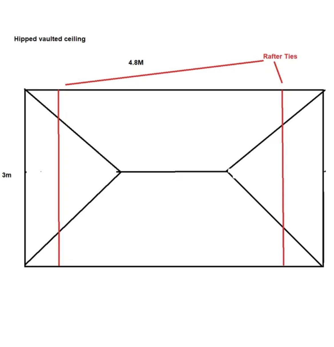

Would this set up work and resist roof spread in a small outbuilding with a hip roof on all sides? Building is only 3m x 4.8m. Wall plate is at 2.2m and wanted to get a bit of extra head height, would be installing rafter ties 200mm above wall plate. If it has the potential to case issues then we will just go with ties/ ceiling joists attached to the wall plate as usual and live with the lower head height.
Thanks @markc I have now spoken to the roof framer. He said the best bet to gain a small amount of extra headroom whilst keeping the structural integrity would be to have ceiling joists on every rafter as usual and collar ties but that he can lift the ceiling joists up 200mm above the wall plate giving us the additional head height we need. He is quite experienced and seems to think this would be more than sufficient to stop the walls spreading. Given we only need a small amount of additional headroom, i think this would work! I hadn't really thought about what happens when you fully vault a roof and take away all the supports, but it makes a lot more sense now.
We are having a block built double skin garden room built. Its under 30sq meters so doesn't require building regs. Carpenters have said they can vault the ceiling no problem when building the roof structure, i would like this but am a bit worried about roof spread as the tiles are the heavy concrete ones. Any idea if we could / should be adding rafter ties? I was thinking something like the below and leaving them exposed which would give us an area in the middle that's fully vaulted but would still tie the walls together? Or do we need them both ways? Any advice would be welcome! Thanks Building is 4.8m x 3m.

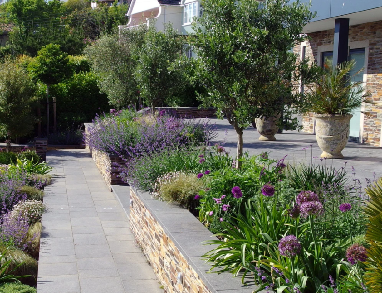

Can this be done under a non material amendment?
J4mes replied to J4mes's topic in Planning Permission
Thanks for the reply, sorry not sure I understand the suggestion, do you mean just change the steps to slopes? The idea we saw was similar to this so we liked the look of it.. -
Hello,I'm hoping someone could advise us on what the best course of action is, we have approved plans for a wrap around single story extension to our bungalow, we are on a sloping plot so the height difference at the back door to ground level is around 0.8m, we have the attached design approved with a raised patio and steps leading down to the garden.We would like to change this by adding raised flower beds along the back of the house, first one at floor level, dropping by 0.4 then dropping again to ground level with steps and a pathway going through them so that we can gradually step down into the garden rather than a sheer drop.This is the plan we would like;We think this may be a non material amendment but are not sure, friends have said raised beds do not need permission as they are not a platform and you will not raising the ground level. We will be having steps and a ramp/pathway through the middle which will be higher than ground level so i think it needs permission.Could anyone advise on the best course of action, the builders are due to start in 4 weeks and want to do the foundations for the steps and wall at the start of the build.Many thanks.
