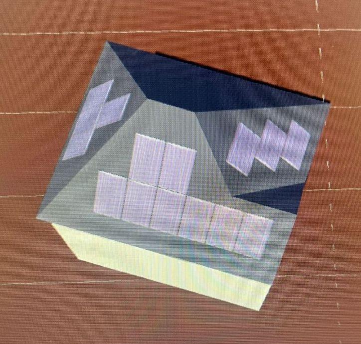

Or if your panels on one string are on different aspects, which is actually shade too I guess! That would give one string with 3/4 panels on, and one with 10/11 panels over 2 aspects, and 2 or 3 optimisers on the smaller east facing roof. Seems like the simplest configuration.. Not tried PVGIS, will have a look at that.
Yes that's the thinking Doug. ASHP in the future, maybe bump the battery up to 15kWh at that point too. Induction hob going in, but previous to that our annual usage was 4600kWh. Struggling with the configuration aspect more than anything. Think it boils down to these distinct options: 13/15 panels (if they fit) and Tigo on all 13/15 panels and Solar Edge (pricey) 10 panels and just one or two Tigos.
I’ve been thinking that the batteries would be the star of the show! Keep the excess generation for later, and also charge up on cheap night rates in winter. can see the value in keeping the system costs down though. Perhaps the most simple one is the answer, no West aspect and less optimisers (just on the East face perhaps). no divert yet, although maybe with the future heat pump. Although could just run the pump rather than divert to immersion.
Finding it hard to chose between Solar Edge, Tigo Optimisers or EnPhase + AC coupled batteries. Can anyone advise based on our layout? We won't get much shading apart from maybe the dormer. I've had Solar Edge quoted, and EnPhase as an option, although this would require an AC coupled battery, which I understand you lose out on battery capacity as it needs to be inverted 3 times to use stored Solar energy, (or just twice from the grid, but that's the same with DC coupled I think). Not sure what to go for. Also not sure I need Tigos on every panel (extra failure points?). Option A told me that 3 elevations means all need optimisers, while Option C have suggested only 2, and those are optional. Quotes so far in detail: Option A suggested 13 panels (one less on the East and West) - Tigos on every panel + 5kW Lux inverter (works with Octopus, a plus) with ~10kWh Pylon tech batteries (I like as it's expandable) - £12.2k Option B suggested 15 panels as shown below £12.5k, but currently a 3kW Sunsynk inverter & batteries of unknown type, TBC Option C has run up a few quotes for me, including only 13 panels (but suggested against the rear ones as they're slightly north inclined) - only suggested Tigo optimisers on the East facing elevation due to the dormer = - Solis 3.6kW Inverter (doesn't work with Octopus?) & 9.2kWh Pylon tech - £12.7k (only 2 Tigos) - Givenergy 3kW inverter and 9.5kWh battery £13.5k - Solar Edge - £16.5k - EnPhase & GivEnergy 6kW / 13.5kWh AIO £16k Any thoughts? it's all a bit overwhelming! (this is Option B's suggestion)
