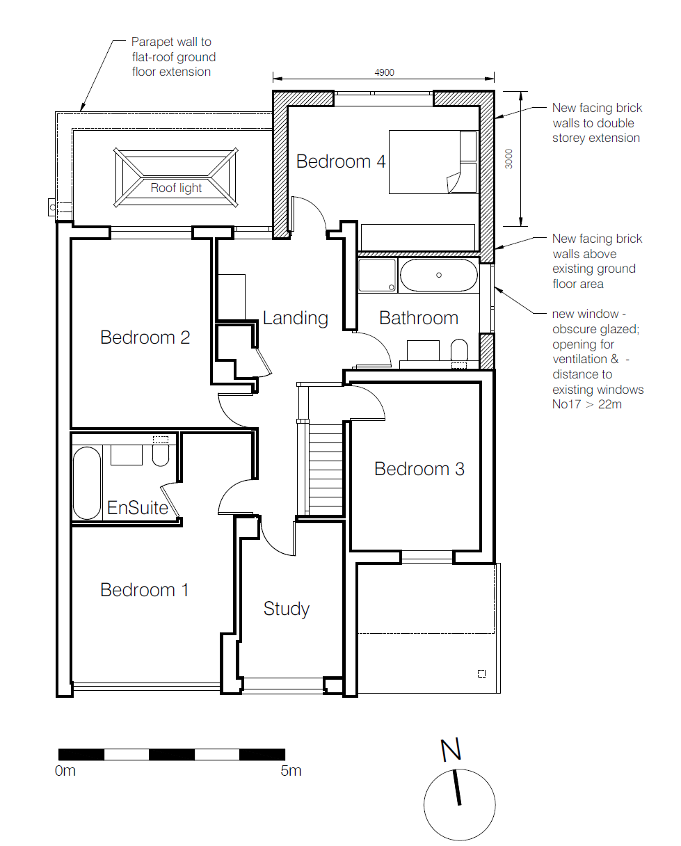

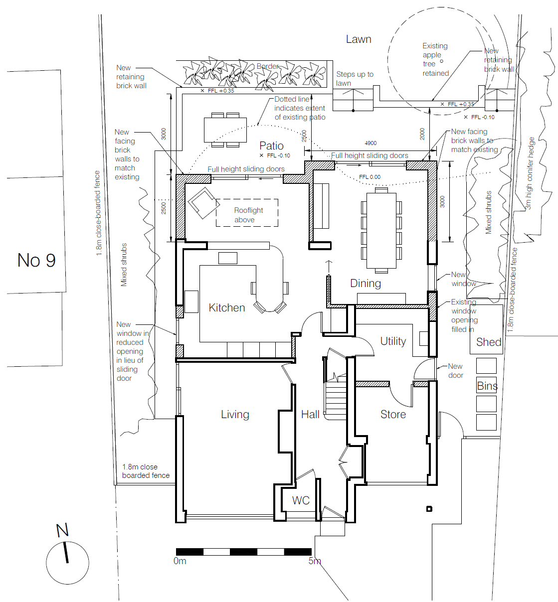

  4. Hi I'm planning a roof-light for my kitchen as part of the extension. The back extension is 2 storey on the right (with bedroom 4 above the dining room) and the kitchen extension is single storey with a roof lantern on the flat roof. The external dimensions of the kitchen single storey extension is 2.5mx5m, internal is 4.5m by 2.2m) (although bearing in mind that the room is connected to the kitchen itself as we'll have a steels over to break through that wall). I'm trying to select the roof light I want but it's difficult to find on the manufacturers website how much space needs to be next to the rooflight (so what's the minimum space between the existing wall and the end of the roof on either side for the roof light? The "parapet wall" is 400mm. So that means there is 2500mm-400mm=2100mm of roof space left to accommodate the width of the roof lantern. I would have thought I'd need somewhere around 300mm of space between the wall and the actual roof lantern and similar distance to the parapet wall, leaving me with a potential roof lantern width of up to 1500mm - is that assumption right? are there any minimum required distances? Hi,
