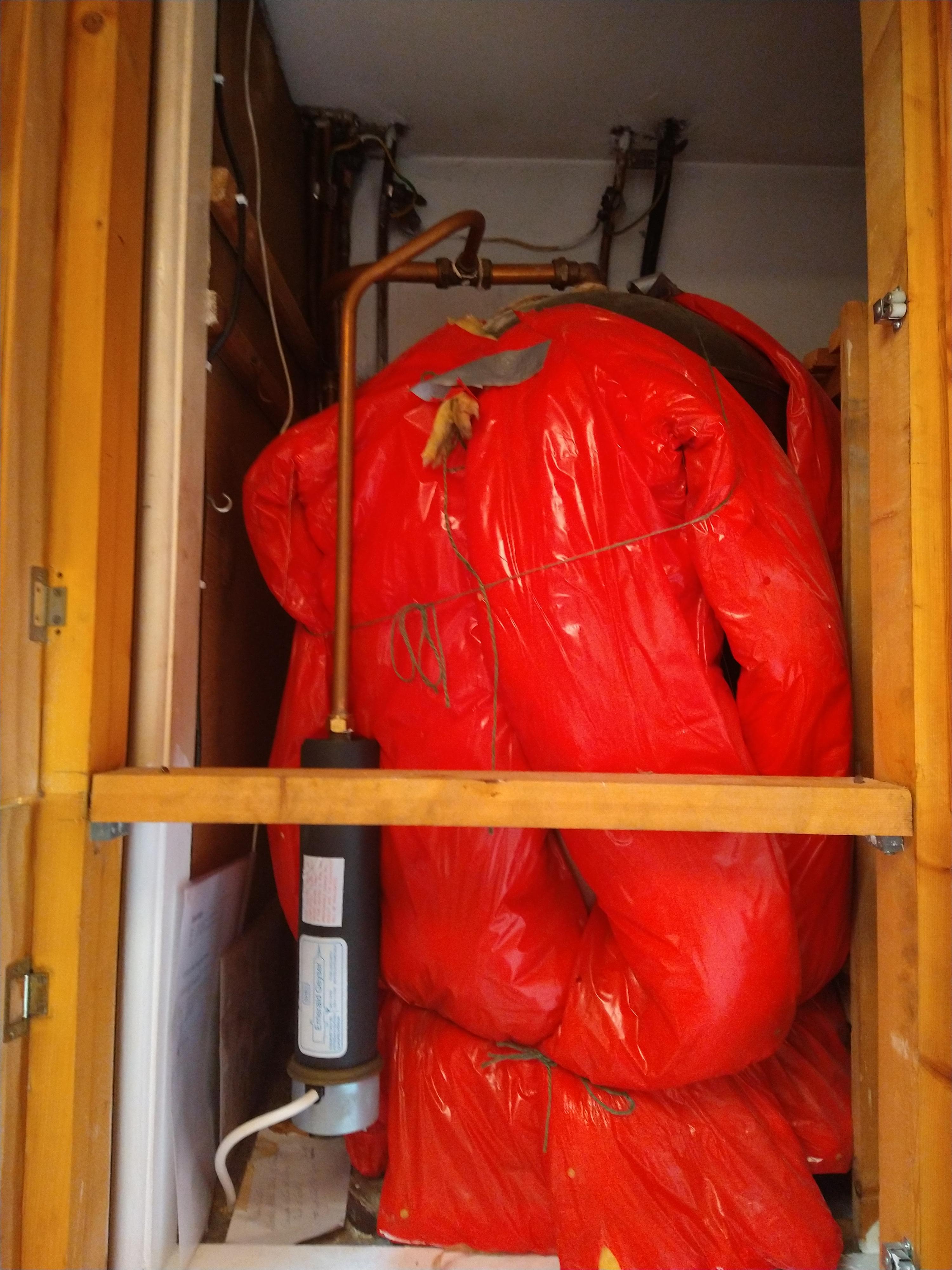

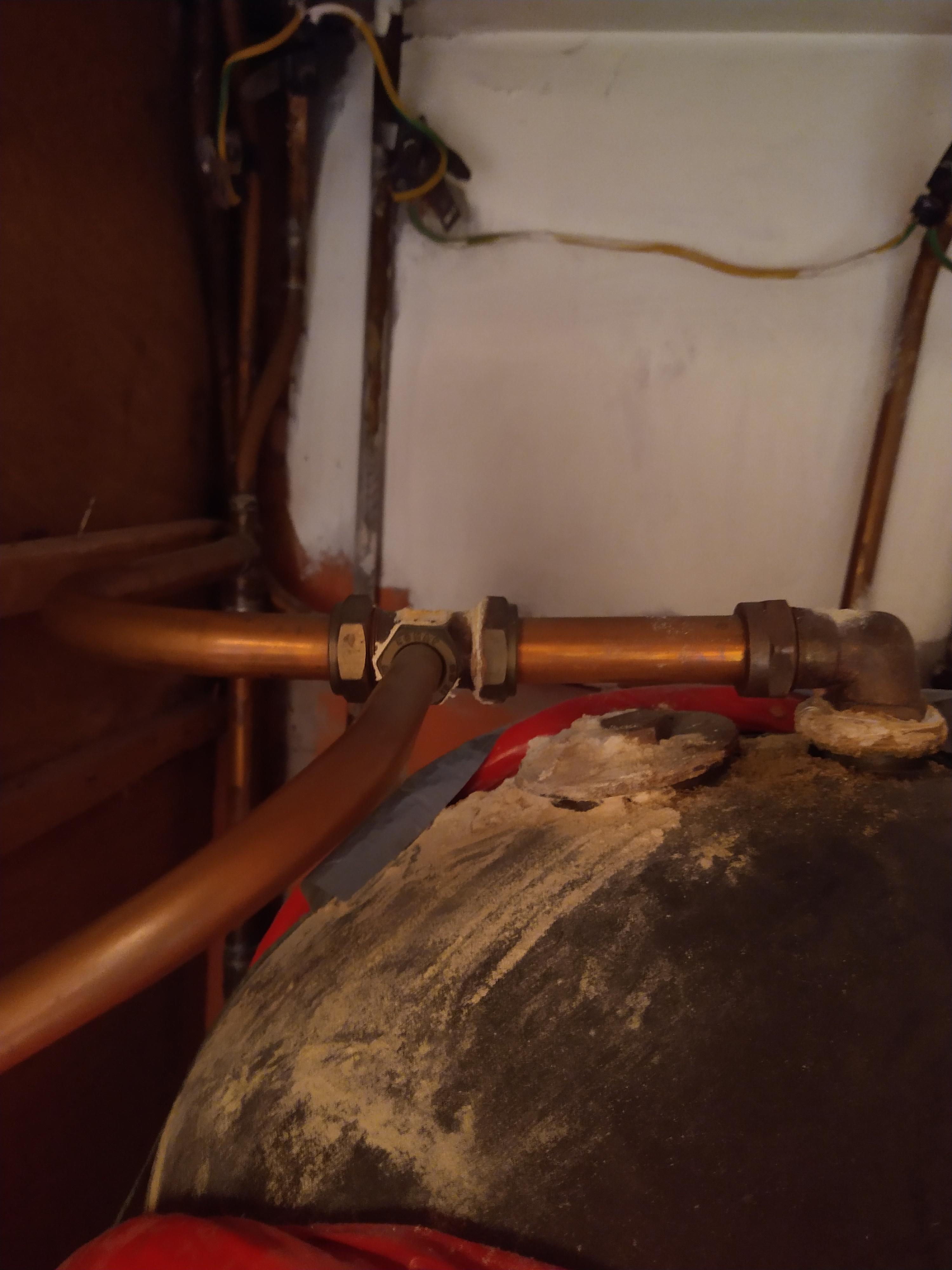

  2. Thanks for reply When I turn on the oil central heating, the indirect heating in the large hot water tank is heating ok, top to bottom. Taps then run with hot water. If there was a blockage between top of tank and the T would I be able to get hot water. I was thinking this also ruled out air lock at top of large tank. It was working for 30+ years. One inlet pipe comes in low behind the tank (this has a gate valve), is then split to go to bottom of big tank and bottom of the Willis immersion. That gate has been reopened. Will get a picture when back in the house and post it

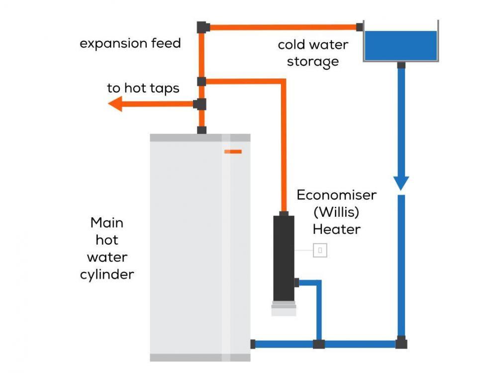

  3. Thanks, will have a look for the thermostat and see if increasing the setting helps I thought the hot water was supposed to build up in the hot water tank. I have looked at someone else's and theirs does. The plumbing in theirs is more like in the second official diagram. Do not under stand why it is not going right.

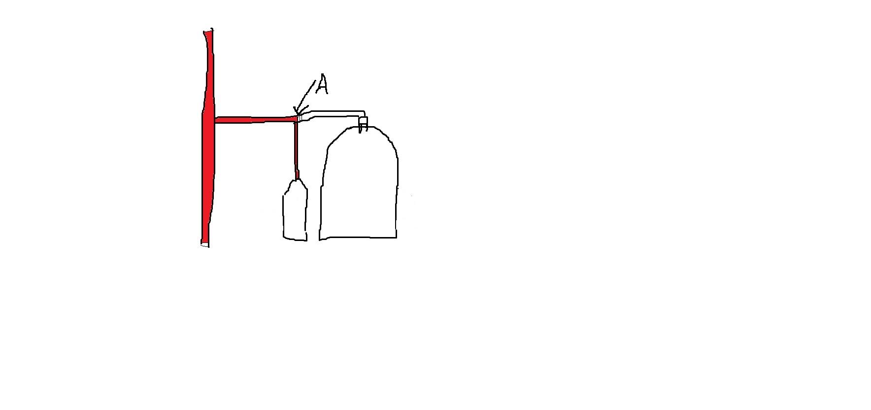

  5. On original diagram at point A it is going left and no heat going right into tank. From my understanding it should go mostly right. Would I be correct in saying need gravity to flow down into tank to build up hot water.
  6. Nickfromwales, thanks for reply. Which way is heat converting? Electric immersion heater The outlet from the immersion heater and the water heater tank is shared into the hotwater outlet pipe. Standard setup diagram, below, makes no mention of an anti gravity valve, but then, maybe not accurate

  8. Replaced a Willis (Belfast) immersion heating in an open vent heating system. Willis is working ok but flow of heated water see wrong and does not generate a lot of hot water. Symptoms are (See diagram): Flow from hot tapes fine (no air locks). Tank heats up using house oil heating system ok therefore no locks in tank. When immersion turned on heated water going to pipes in red, i.e. away from the main tank, only hot water in pipes leading to house hot water tap. Does not generate lots of hot water in volume. Noticed there is a slight incline from the pipe connected emersion to pipe leading to tanks (marked as A in diagram). Possibly caused by new immersion being slightly shorter than original. May be cause but not certain. Anyone any ideas would be greatly appreciated :)
