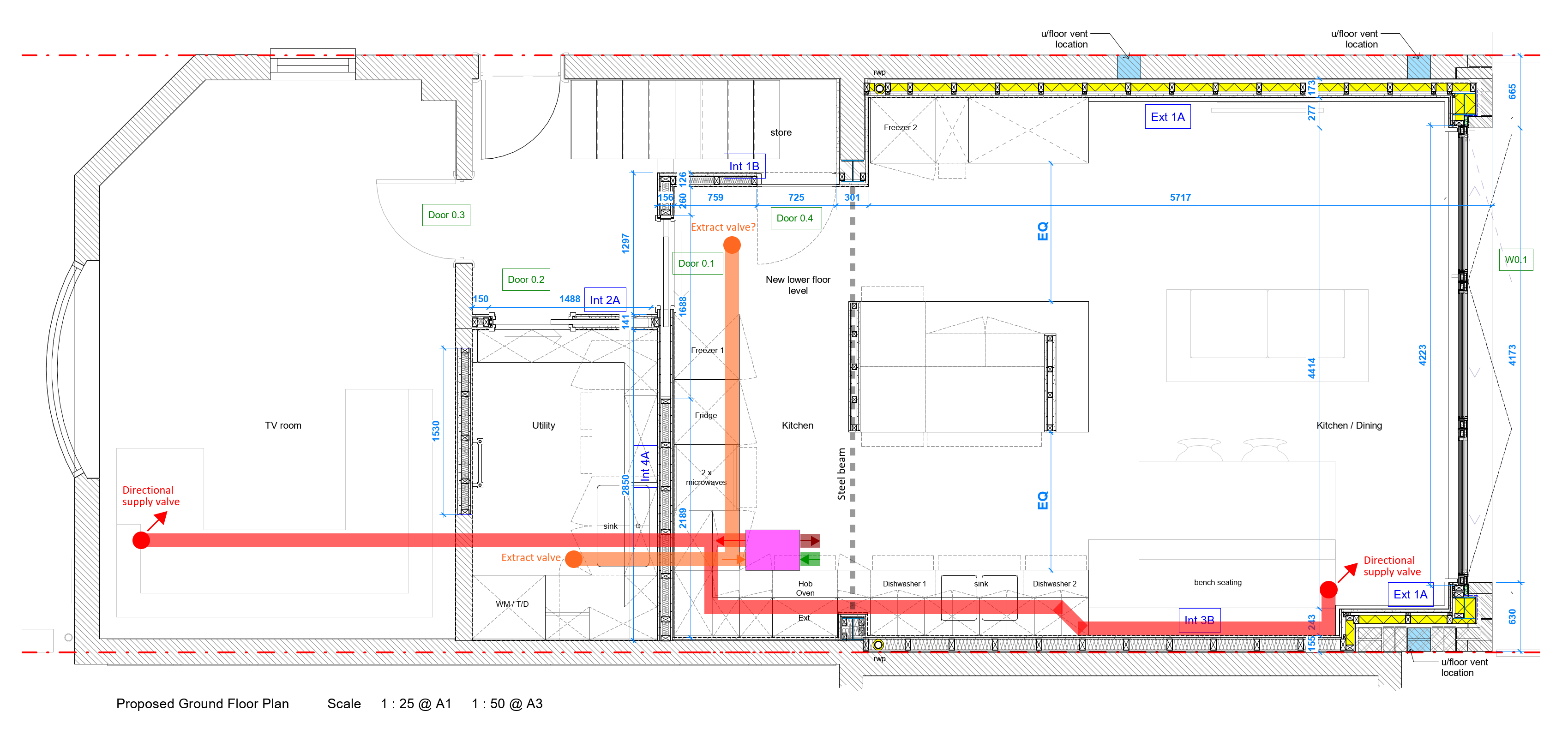

Hello, We are installing a small, basic ground-floor MVHR (Blauberg D-105A) as part of a side-return open-plan kitchen extension to our 1910s terraced house. A full-blown MVHR is beyond the scope of the project. I'd really appreciate any comments on the attached design. A few notes: • North is at the top of the page. There is a steel beam running north-south as shown. We can just get some 125mm duct underneath where it meets the column to the south as shown, boxed off above the kitchen units. The beam is otherwise impassable (within the scope of the project). • East of the beam, the south third of the kitchen has a pitched roof with Velux windows (usual London side-return extension). This also limits valve placement options to the area of the bench seating as shown (hence the proposed directional supply valve to avoid draughts). • Valves can otherwise be placed anywhere in the kitchen ceiling west of the beam. It is not possible to place valves east of the beam other than close to the south wall as shown. • The extension is being constructed with best efforts on the insulation and airtightness front but not to a certifiable standard. My main ventilation priority is the utility room, which will have a condenser tumble drier and be used to dry clothes on hanging rails. I have a CO2 meter and CO2 levels in the house are already poor in occupied rooms. The house does not "officially" need an MVHR, but I would like to ventilate in an energy efficient manner and improve air quality. • The kitchen will have a conventional extractor hood over the hob, vented to outside. Given this, I am questioning the need for an MVHR extract valve in the large open-plan kitchen space and wondering whether having an extract valve solely in the utility room would ensure it is well-ventilated without providing excessive airflow to the 2 supply valves. Would the supply valve location in the south east of the dining area, coupled with the utility room extract valve, set up a drift of fresh air towards the kitchen door to ventilate the kitchen, with the conventional extractor hood used for cooking as required? Such that an extract valve in the kitchen is not needed? • If a kitchen extract valve is needed, where is the best location for it? I thought next to the door so as to be diagonally opposite the supply valve, although I'm concerned this might work against the utility room extract valve. Thanks. JC MVHR GBF.pdf
