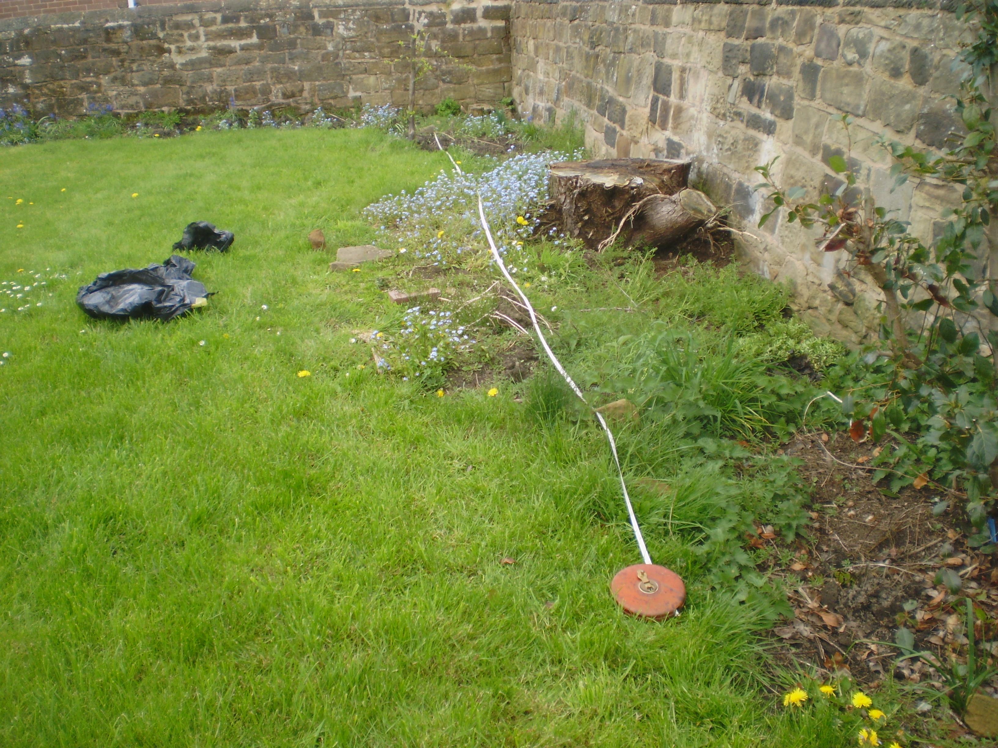

We are about to remove a very large tree stump from our site. The stump is/was a conifer of approx 20 m in height which was felled 2.5 yrs ago and stump killer applied at that time. I am attaching photos to show how near this 90 cm stump is to an old stone boundary wall and the tape on the ground shows approx where the wall of the one storey new building will sit. The stump is encroaching where the trench will be by several cms. My questions are: Should the groundworker attempt to remove the whole stump. Have the tree roots had time to die back. Is this even possible. The tree stump is almost touching the stone wall which we need to preserve and the digger may be unable to remove the whole root ball, so is it possible to do half and half ie remove as much as possible of the stump which lies over the footing area and then grind down the remainder as necessary. Does anyone have suggestions about how to measure the depth of the trench fill foundation that might be required in a situation like this. This proximity of a tree is not covered in the NHBC calculation table as far as I can see. I have worked the depths out for the rest of the foundations but am "stumped" on this one. Any help will be much appreciated. (Sorry, I could only upload one photo - I'm useless at this).
