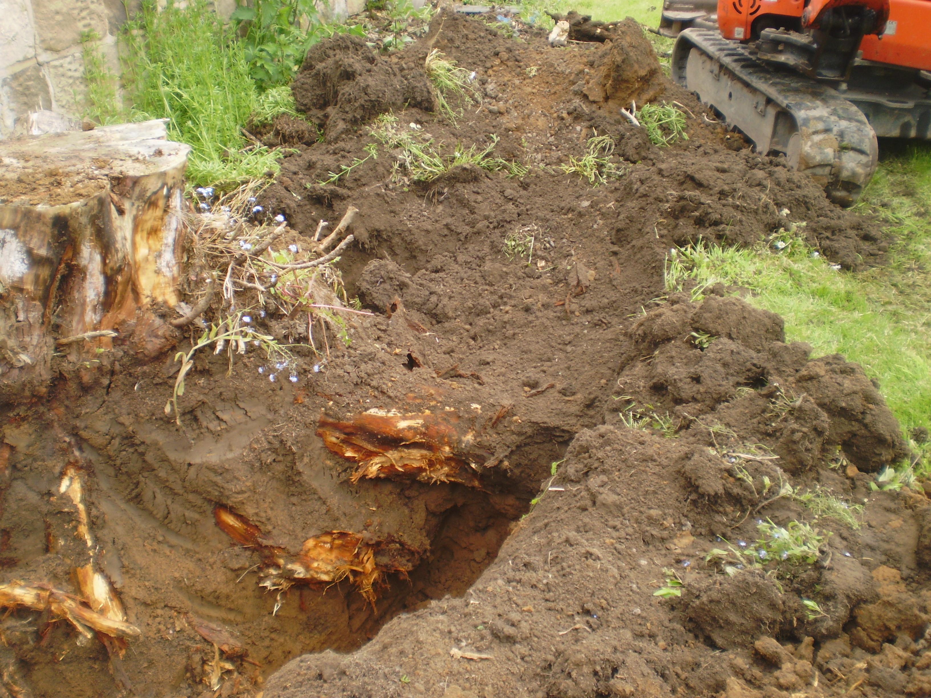

  3. OK - the stump man has been out - he has asked that we dig about a 6 ft square 10" deep area in front of the stump to form a sort of ramp for him to get his machine in. If we do this he will be able to get most of the stump out I think. He is busy for a few weeks so it won't be immediate - £180 which I think is reasonable. We have a different BCO coming out tomorrow to inspect the trench - I'm going to suggest we at least partially backfill the newly dug trench as it is quite near the wall and if it remains just a trench for example say 18 months it might weaken the wall's structure. If he says that's OK, we'll probably backfill completely to be on the safe side. The other BCO said we can't backfill as it would mean we had not commenced work. We are not doing any concreting at this time. The tree stump situation is interesting so I'll post as things progress. Next thing BCO.

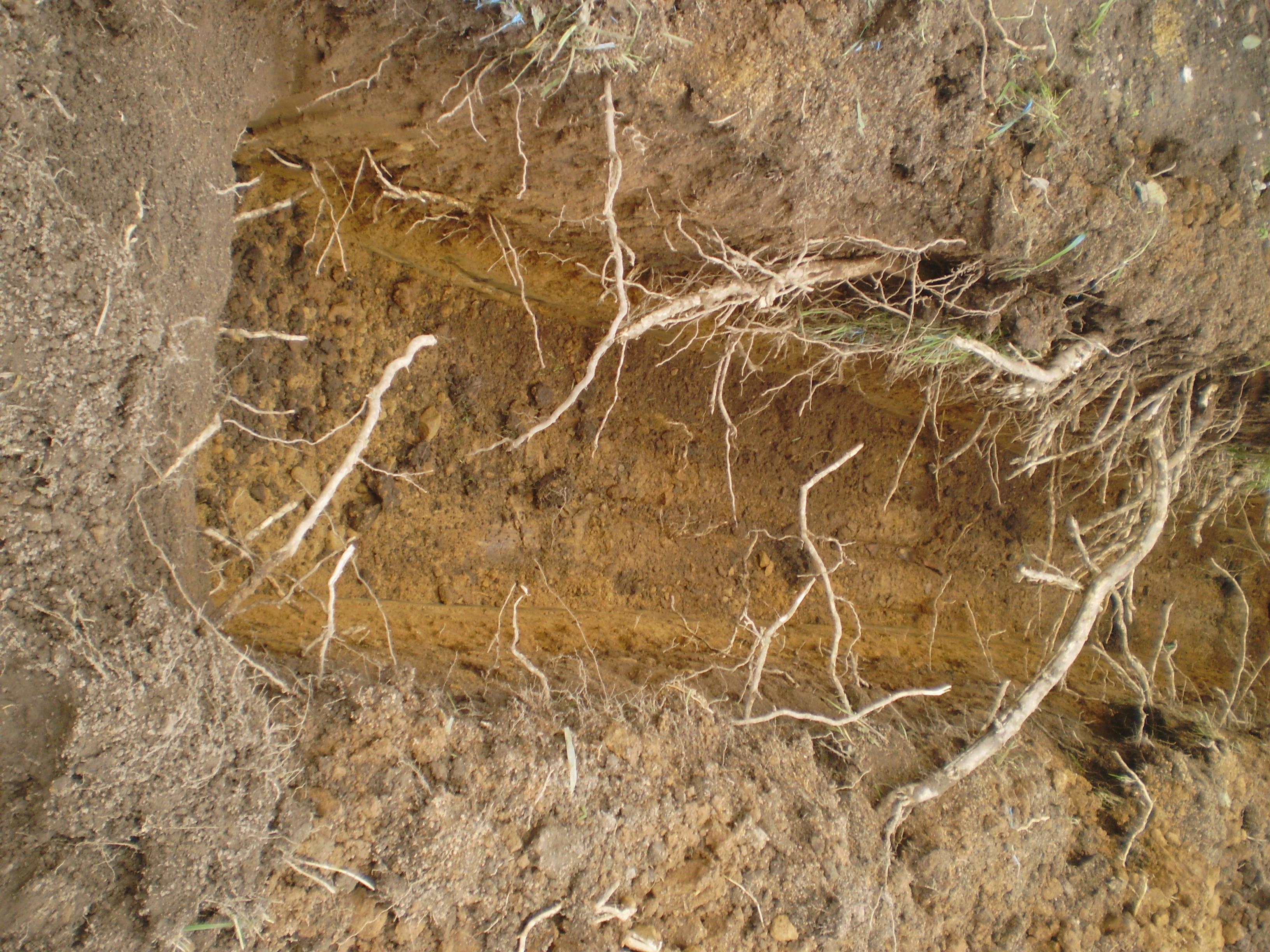

  4. New trench showing Holly tree roots.

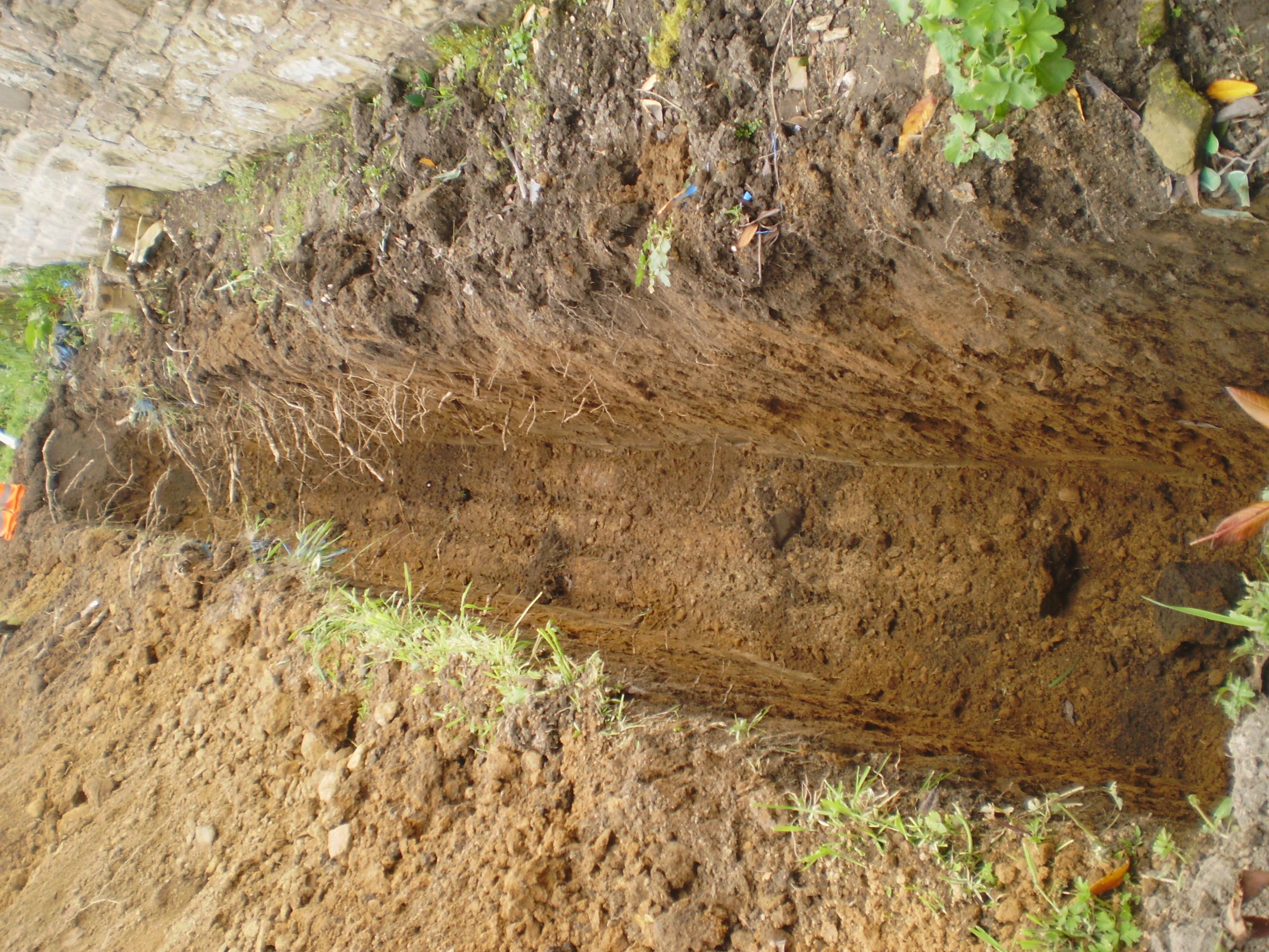

  5. Diggerman arrived at 8.15 am. 8.15 Diggerman arrived. I checked with him what he was going to do and explained that I was concerned about whether the rear elevation measurement on the drawing matched the space available. I have had large laminated plans done so that they had something clear to refer to. 9.30 (After tea and biscuits) they had drawn the southern elevation and I went to check. The measurement across was approx 13 m and we needed 14 to accommodate 12 m elevation with 1 m each side. What they had marked out (and I’m sure would not have consulted me about before starting to dig) was totally off the mark The plot is not square and to do it the way they intended would have made it very difficult for a car approaching the garage doors to drive in without having to negotiate. The diggerman boss kept referring to me being a “whittler” and fusspot. I said surely it’s better to agree on the building’s position before the excavation starts. This is what I mean about the way men in these sorts of trades still regard. It gave me a headache having to stand my ground so firmly. 10 am and not started digging. The BCO has just turned up and not pleased as the trench has not been dug. When I arranged the visit with their office I said I would phone the BCO when the trench was ready to be inspected but the person who did the booking failed to make a note of this so I am in the bad books again. He said he’d rebook it for tomorrow. So all my careful plans to get everything done today as regards trench and BCO have now gone awry. 10.30 diggerman boss went to another job and his employee excavated the newly placed trench. Good soil but a lot of holly roots see pic. He also dug around the tree stump which is enormous with some massive roots. He is unable to take it out so will need to be ground out and the stump buster man is coming this pm to advise on next move, which I will report. The photo doesn't show how enormous the tap root is and which runs right across the proposed foundation.

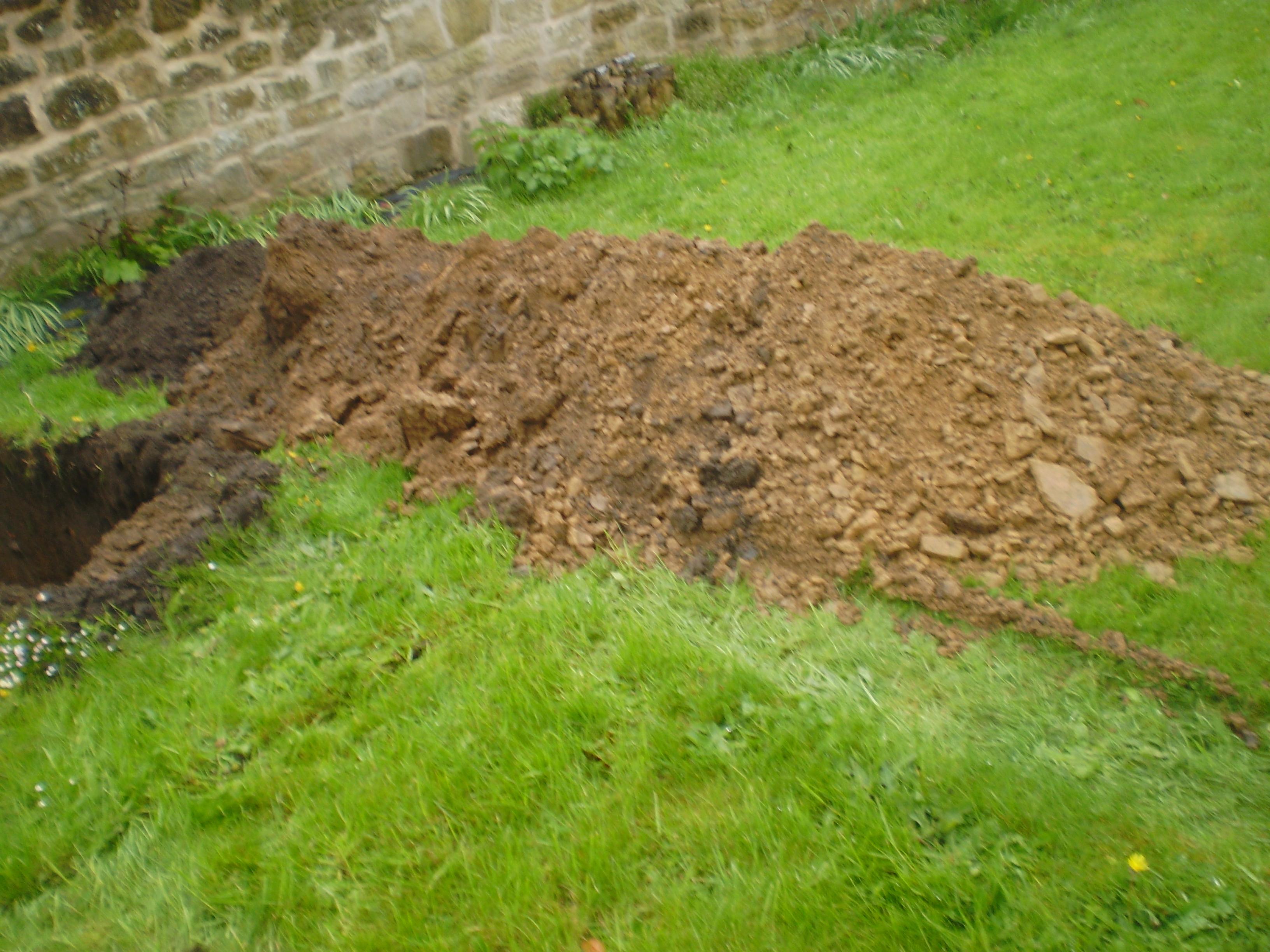

  6. Thank you. So having uploaded the photos is the general concensus that what we are going to do on Thursday (as post above) is OK and we won't be making problems for ourselves when we return at sometime in the nearish future to recommence work.

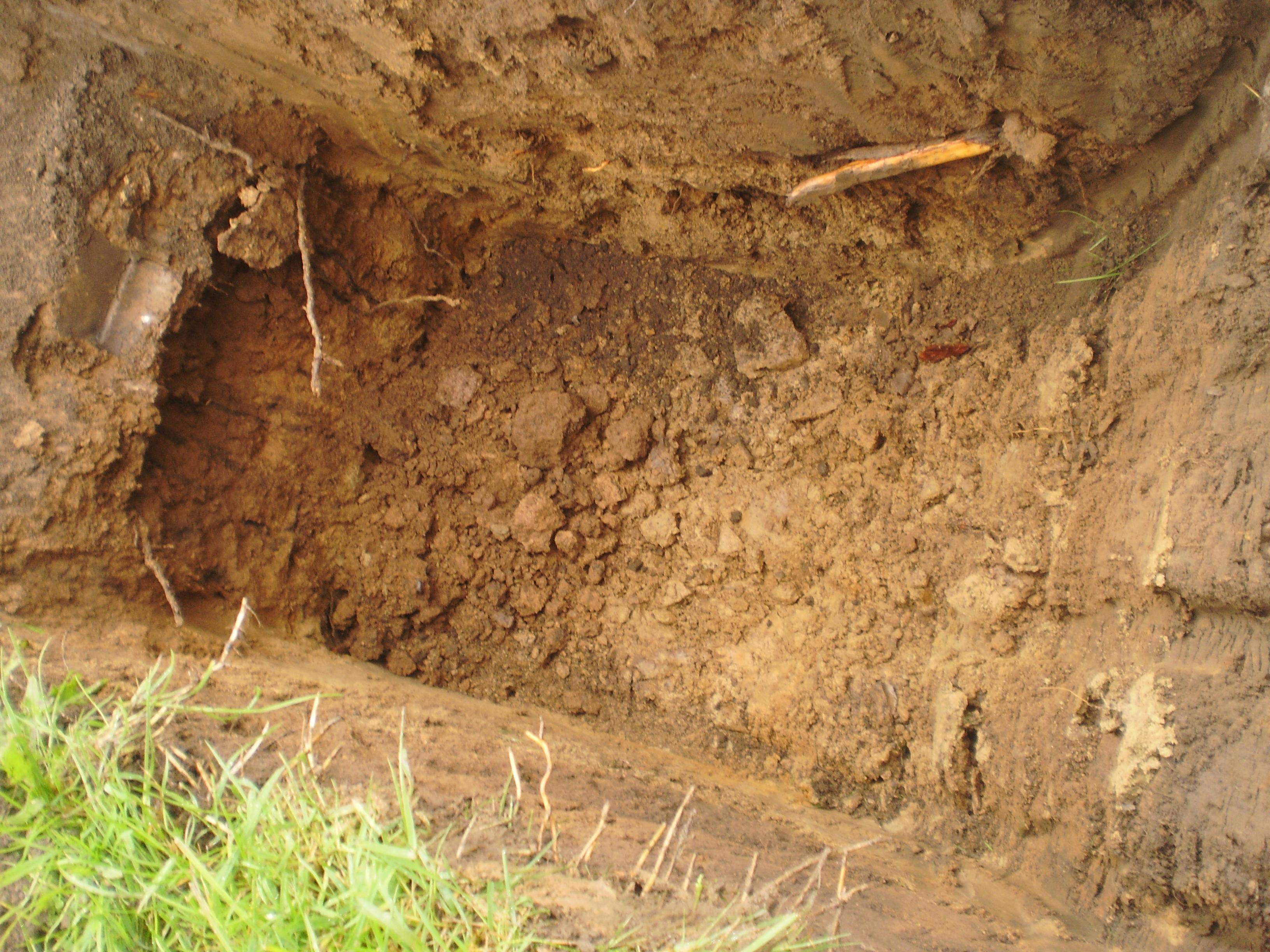

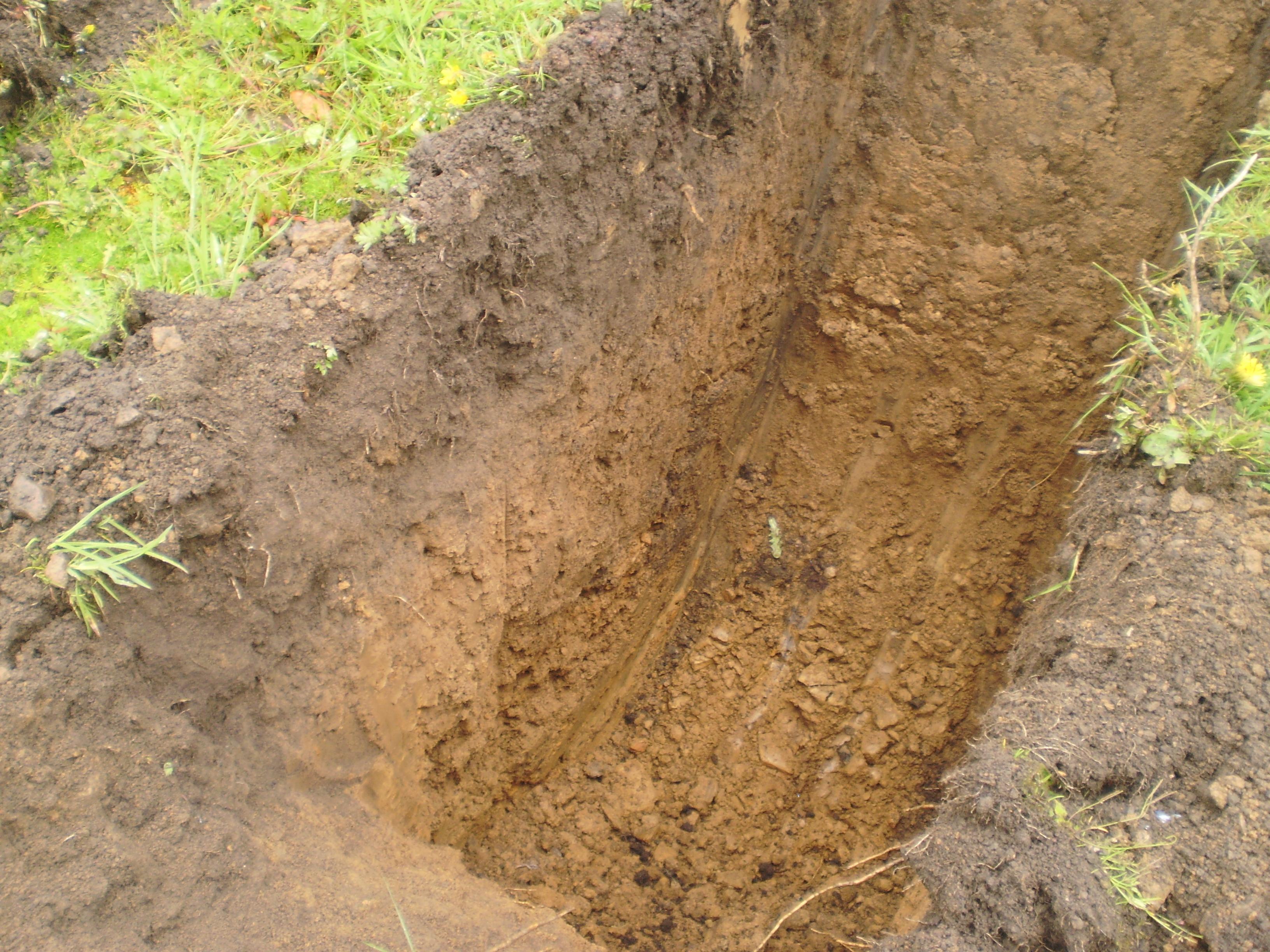

  7. I don't have a mobile phone so using camera. I don't upload many photos so can usually manage. The stuff that has been removed - the sandy coloured part - is crumbly between my fingers, but not fine, and is full of bits of stone. I was unable to push a pole into the bottom as I didn't feel safe. I can't see any clay but I am no expert. Do the pictures help - I've uploaded another one.
  8. Second photo. (I will poke the bottom of the trench with a pole and get back to you)

  10. I would say dry sandy coloured with stones in it. Would a photo help, bearing in mind I only seem able to add one photo!!!
  11. Hi and thank you. Does all this apply if the soil is not clay. We have good soil and the trial pits dug at 1.2 m have no water in them even though it poured most of last week. Also no caving in of either pit. The BCO has said the fill should be 1.2 m deep throughout with him assuming the tree stump is removed or ground down. The diggerman is coming on Thursday to refill the trial holes and dig one trench (south elevation whereas stump is north elevation). BCO will inspect the trench and we should receive a commencement notice, which is what we are seeking (before 15 June 23). Following the trench dig, the diggerman will try and remove the stump by digging around it which will encroach upon the proposed northern elevation foundation area. If he is unable to remove the stump he will ask a grinder to grind it down (he will be able to go deeper as a result of the work done by the diggerman). Because we are not digging the northern elevation trench at this time I am trying, from your drawing, to establish whether what we intend doing will marry up with your suggestion ie dig around stump and either nudge or pull out (unlikely I know) and if unsuccessful employ a specialist grinder to grind it down as much as possible. The area will have time to settle as we are not undertaking further work at this time. The drawings are really useful and we shall refer to them in the future but I would like to be sure the work undertaken this week in removing the stump will not prevent us following your plan at a later date. Many thanks and I have my camera ready.

  18. Thank you. Are you recommending grinding out the stump in preference to removing the whole stump and roots where accessible with a digger (if that's possible). The stump removal man who came out yesterday to quote said he thought a digger would not be able to do the job. He would grind out the stump and put the shredded material back in the hole so there is nothing to take away (which sounds unsatisfactory to me). As well as the foundation we also have a drain running along this elevation. My thinking at the moment is to try with an excavator with an appropriate fitting and if that works refill the hole with the soil from the trench which is to be dug at the opposite side of the site. This will have time to settle and be constantly refilled and compacted until we are ready to recommence the build in the future. At the moment we just want a commencement notice. So to remove the whole stump and roots or grind down the stump - that is the question .......

  20. As I mentioned earlier, if I follow the NHBC distance calculator for medium plasticity/high water requirement tree, the footings are over 2.5 m deep and would require an engineer designed foundation (the stump being right on the footing area would impact I think on at least 3 of the elevations as regards the depth of the trenches). I intend amending my foundation sketch today using the 2.5 m max depth where required). I assume engineer designed would mean piles, so if I employ a SE he may be "duty bound" to say piles are necessary because of the requirements of NHBC. If I phone the BCO he may say to put reinforced bar in but I wonder what depth he would suggest for the trench eg 2.5 m? Best case scenario : Remove conifer stump in total if possible. Soil test comes out at medium clay plasticity and we know the conifer is a high water consumer. (Test cost around £65 last time - 9 yrs ago). Work out trench depths required from tree distance table with 2.5 max depth where required. Reinforced bars, or concrete lintels down the north elevation where the tree stump is. There will be a lot of ready mixed concrete needed but at least I'll know in advance. Discuss above with BCO to see whether acceptable. Does this sound OK?
