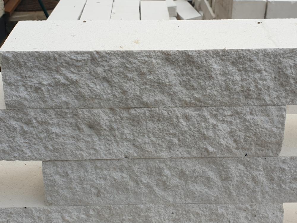

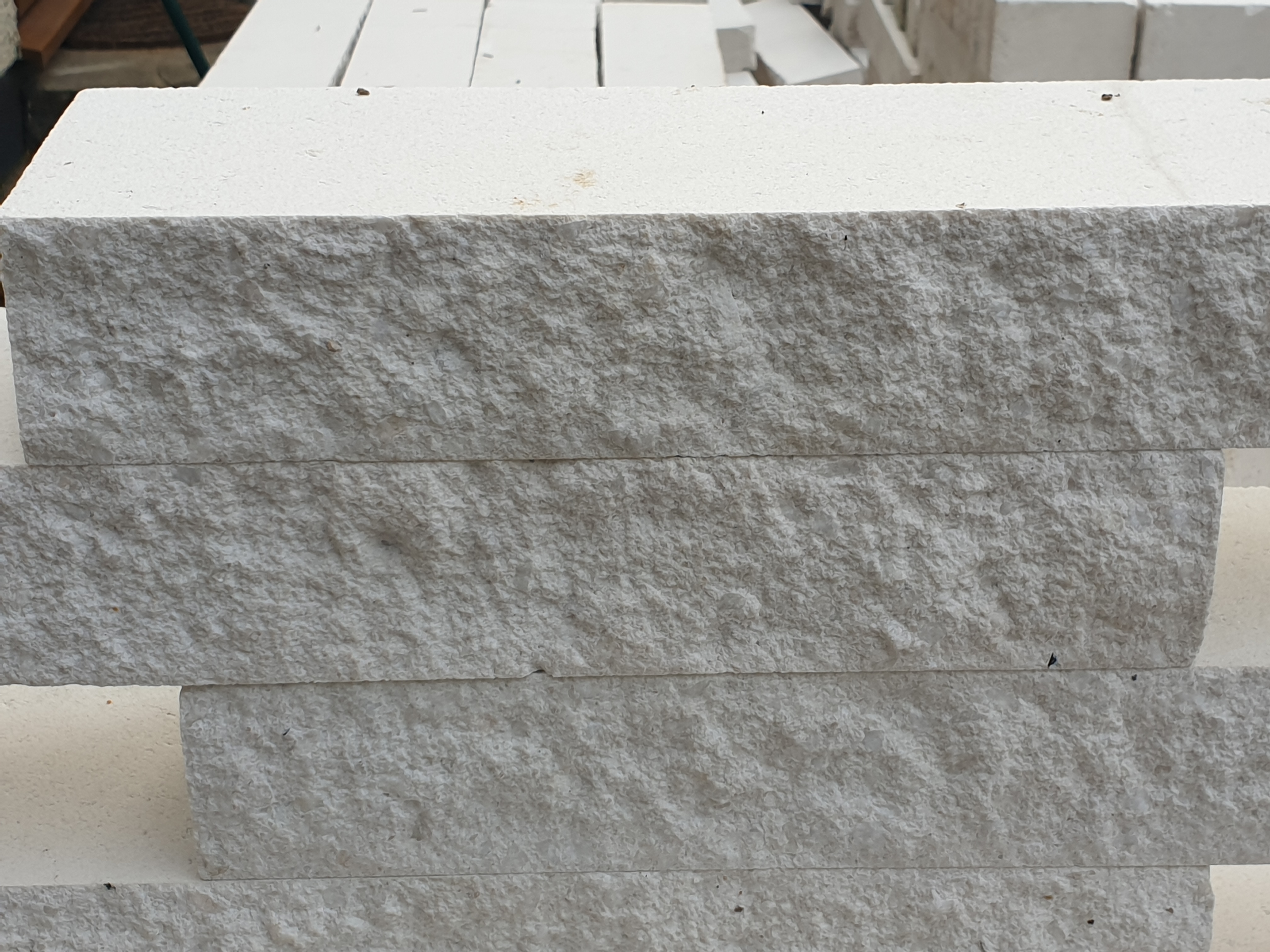

Hi there, No, it's the actual brick. Here is a link to the product - https://www.forticrete.co.uk/products/architectural-masonry/linear/splitface Also below is a picture of the brick and how I want it to look.... Many thanks
Hello, I am looking at getting some masonry stone to build a small feature wall in my garden no more than 3 courses high. The bricks are the split face linear bricks from a company called Forticrete - in diamond white. I was wondering whether it would be possible to lay/fix them with an adhesive rather than normal mortar as I would prefer the finish of not seeing the mortar between the joints? Thanks
