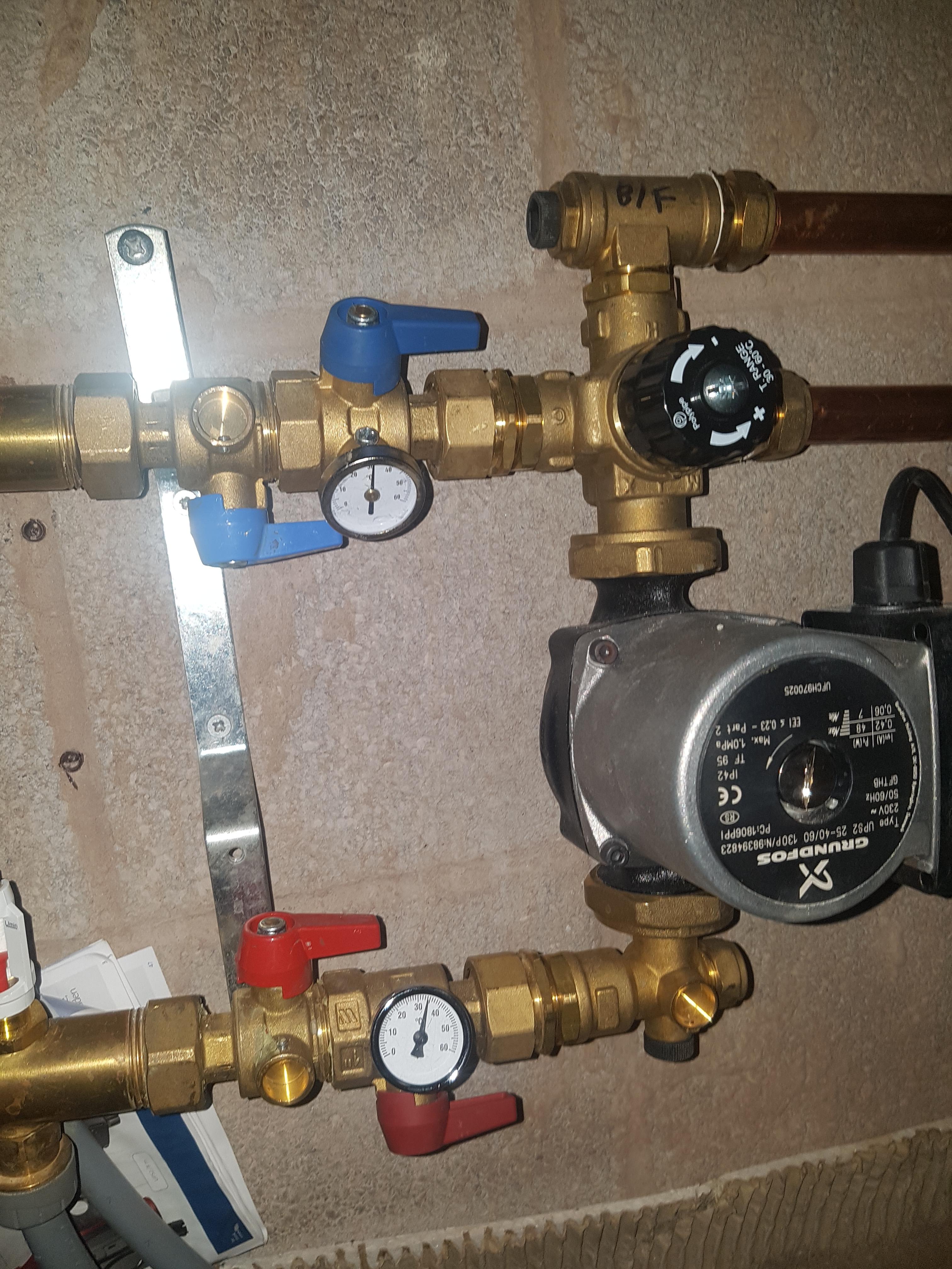

  5. Yes it does! Immediately on changing the the temperature there is a noises, the flow gauges bob up and down then go back to just the one. I've been telling them that I've only been having the problem since the valve was replaced and the flow has been a problem since. It does improve immediately after getting air out but not for long. I've asked for the mixing valve to be checked and all they say to me is that the valves are basically never faulty. @Nickfromwales thank you for the advice and the tech term... the system is pretty old and I can't really afford to pay for someone to change it right now, especially with how much this ahs been costing me. You ask this: "Has the system been re-treated with inhibitor after / during each plumbers visits?" and my honest answer, is that I'm not sure. where exactly should the automatic air vents be placed so I can be very clear to my engineer.. then I can have him do both at the same time? I read yesterday they should be after the pump but there is obviously no space for that. You say on both bars... would it be at the ends? Thank you so much everyone. I think I need to insist on the valve being changed and ask for the air vents to be put in. I will keep everyone updated and lets hope it works. I can't tell you all how grateful I am. It's been... not fun.

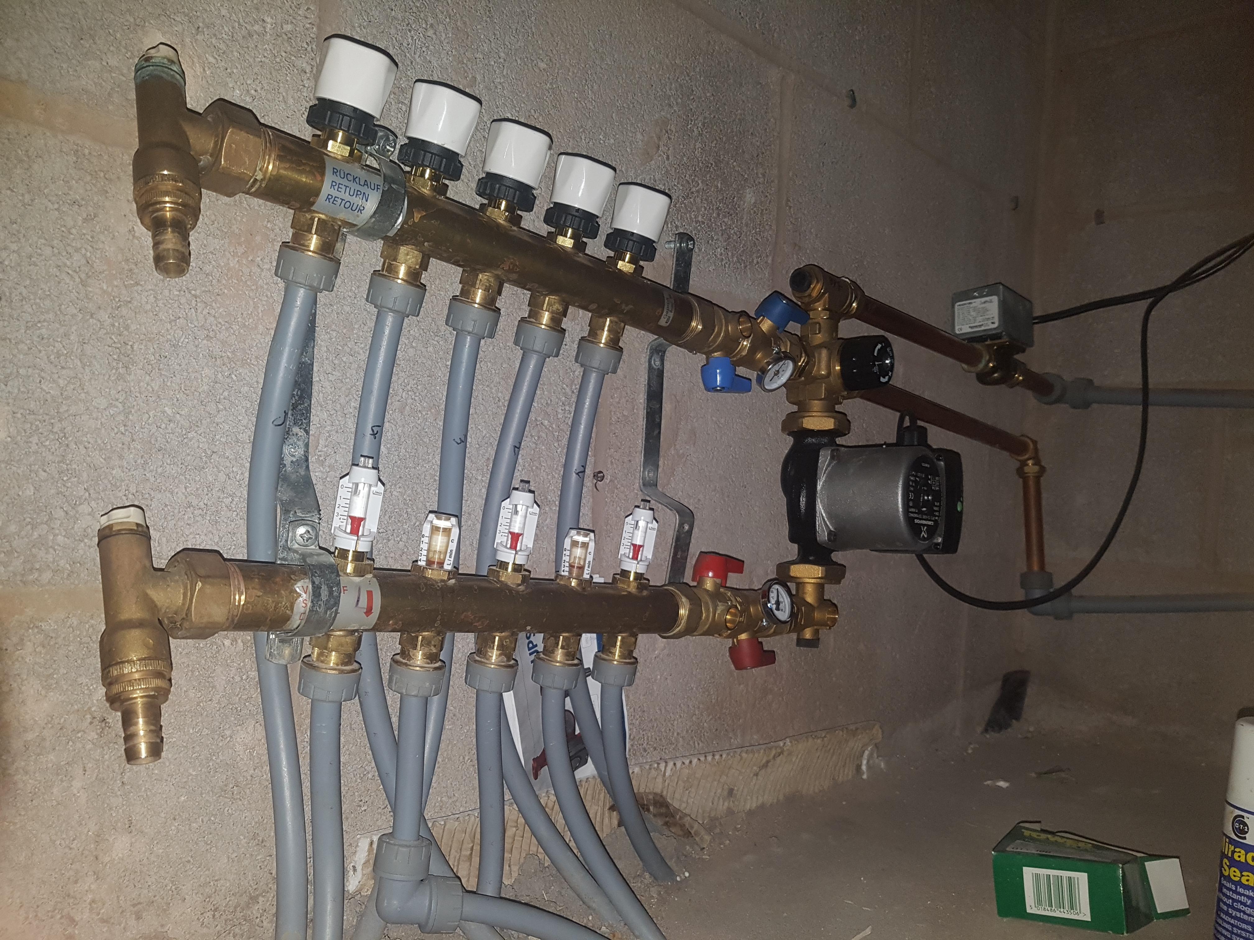

  14. UPDATE: I crawled into the space and first felt the pipes: 1) pipe into Manifold Mixing valve red hot 2) flow pipes, luke warm (barely warm at all) 3) return pipes were cold I then turned the knob as suggested, (bit by bit) and its now gone to 40 (and a return of around 35-36). I guess I wait a little now to see if anything heats up? (picture taken before I turn the dial/ knob around again, the next two turns got to 40) (p

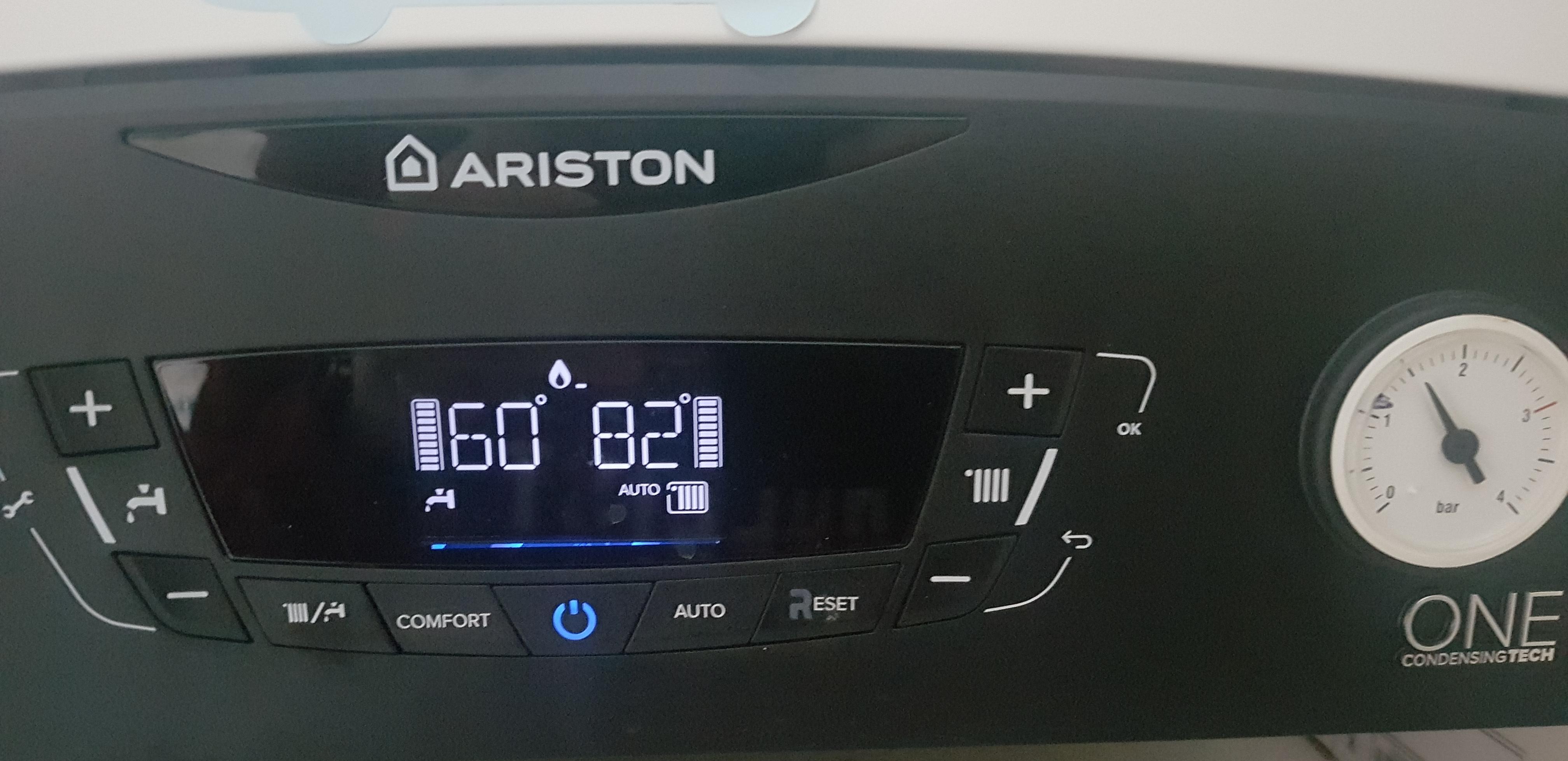

  18. Hi all, over the next few posts please see some pictures of the manifold, the temp gauges (as they were after running for 3 hours today) and the pump/ thermostatic mixing valve. Also attached a picture of the panel on the boiler. The little flame and bars in the centre at the top come on when demand hits the boiler and after less then 1 minute it goes off, I don't think it should do that and I don't believe it does that with the upstairs until temperature is reached, but as i say: I am really not an expert and I am at the end of my tether and a lot of money on engineers down the drain. Just want to day the boiler was new in March 2019,has been serviced and I didn't have this problem (with the floors etc) until the mixing valve on the manifold was replaced. As per ProDaves suggestion I am in South Staffs. Thank you again. I'm honestly grateful for all help. I don't know what I'm doing but the engineers have been out 4/5 times, re commissioned, drained and still the problem persists.
