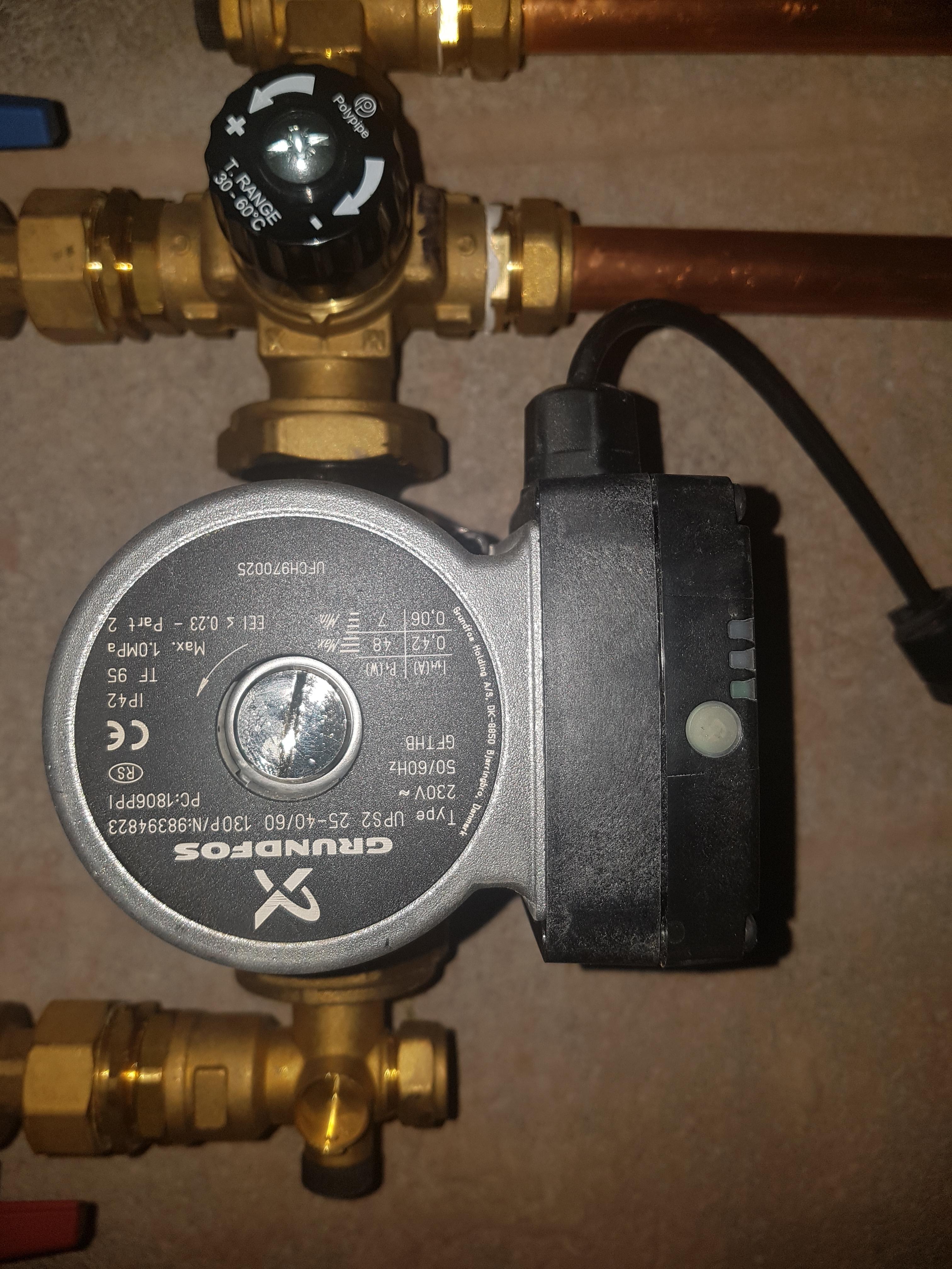

  8. Thank you, here is a picture of the pump. Also set to 3. I do feel as though the pump is fine as once I had got the mixing valve to the 45 degrees the floors became beautifully warm. Seems there is something changing the flow over time. This is what happened last time too. Drained, refill loop by loop, warm floors for around 24 hours then gradually less warmth then basically no warmth across 2-4 days.

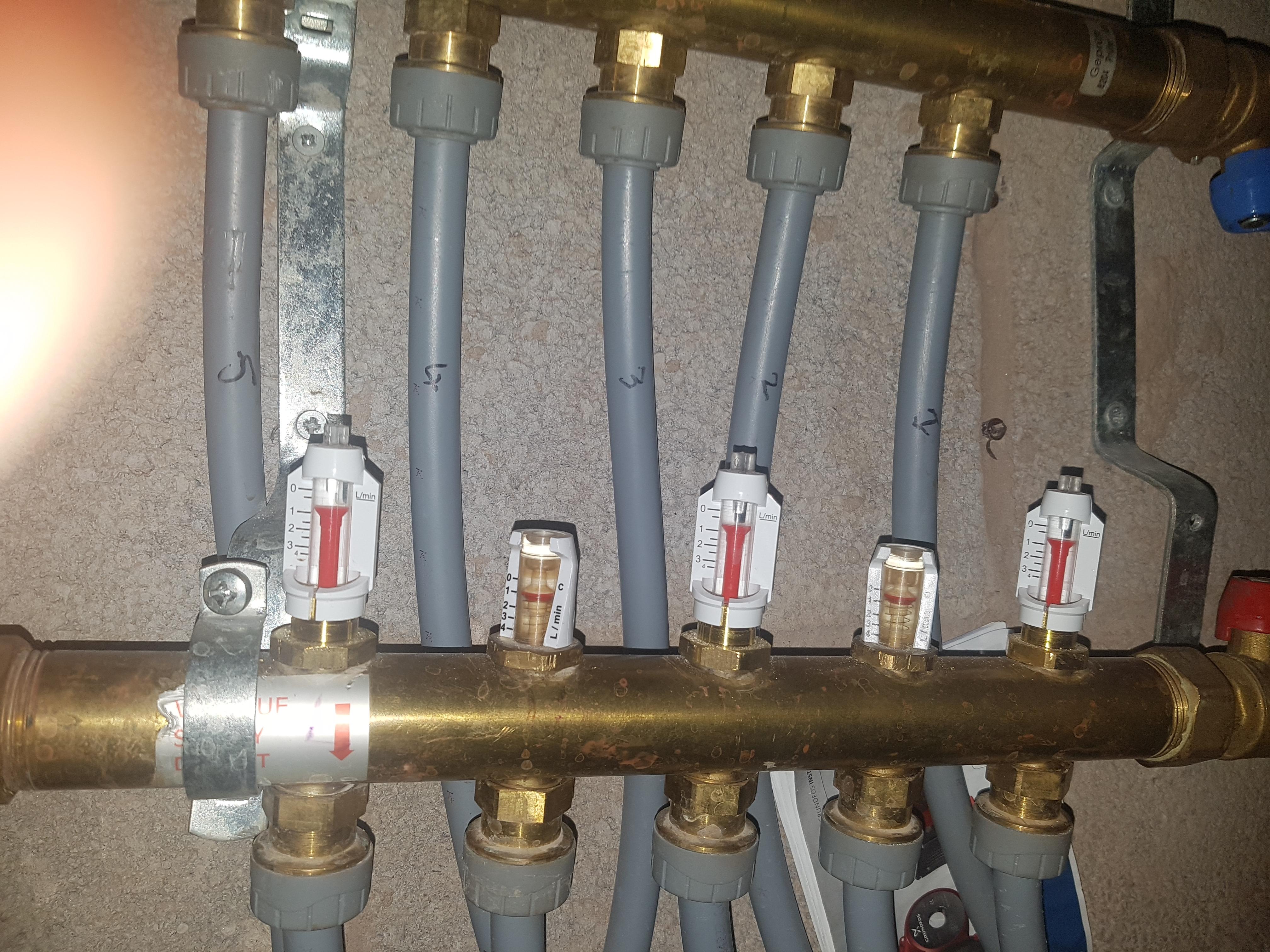

  9. Unfortauntely, it seems my original problem remains. - Yesterday: adjusted the mixer to allow 45 ish degrees on the temp/pressure gauge - Over a period of a few hours temperature increased to 22c in the house - At 9pm I turned it from manual to auto. - Settings on wall thermostat are 20.5c during the day and to not allow temp to drop below 16c over night. - Mild weather meant that the house did not fall below either 20.5 or 16, and so the boiler did not kick in this morning. - At just after 9am, I switched to manual and increased temp demand on wall thermostat to 22c to see if the system was now working. - demand sent, boiler started, pump started BUT the gauges only 'dropped' to 1 or just under 1 (picture attached)... which will not be enough flow to keep my floors warm and after 2 hours, nothing has changed. Floors basically cold. - Yesterday when the floors were nice and warm it was 1.5-2. I just spoke to my engineer and explained the problem. Frustratingly, his response was first: "The guy from Ariston (boiler) said that perhaps the heating hasn't been wired into the boiler properly as two zones" - Obviously I challenged this. If that were the case it would never work. It worked last night without upstairs running (upstairs is set to a lower temp as I hate sleeping in the warm!) Then he said: "That's why I turned the mixer right down before I left, as the flow was decreasing when I turned it up so wanted to get flow through" - I then repeated that at 39c it wasn't sufficient outgoing temperature to run around the pipes within the loop and actually heat them. 45-47 seems to be the magic number and further to this, yesterday after I first altered it, it behaved correctly and worked fine. It was only after it shut down (as no heat required) and fired back up, the problem returned. Then he said: "I'll need to check the pump is the right one and is working" - To which I replied that if the pump was the wrong one then it wouldn't have worked yesterday. So, I feel that I am back to square one. There is clearly something throttling the flow. The system has been drained, running through cold water from an outside tap and into a drain, twice. And once through the boiler. After each time, it works (if the mixing valve is set art the right temperature). But then, over the course of a night, it stops again and the flow throttles. I should point out that on the first draining there was a lot of air, on the second there was air again but not as much. Any ideas? is air continually building up, and, if so, what might cause this? I have only been having this problem since the valve was replaced in February 2020 Is there a problem with the valve? I should add that it's unlikely there is a leak anywhere as the boiler pressure has not dropped in all the time since the valve was replaced.

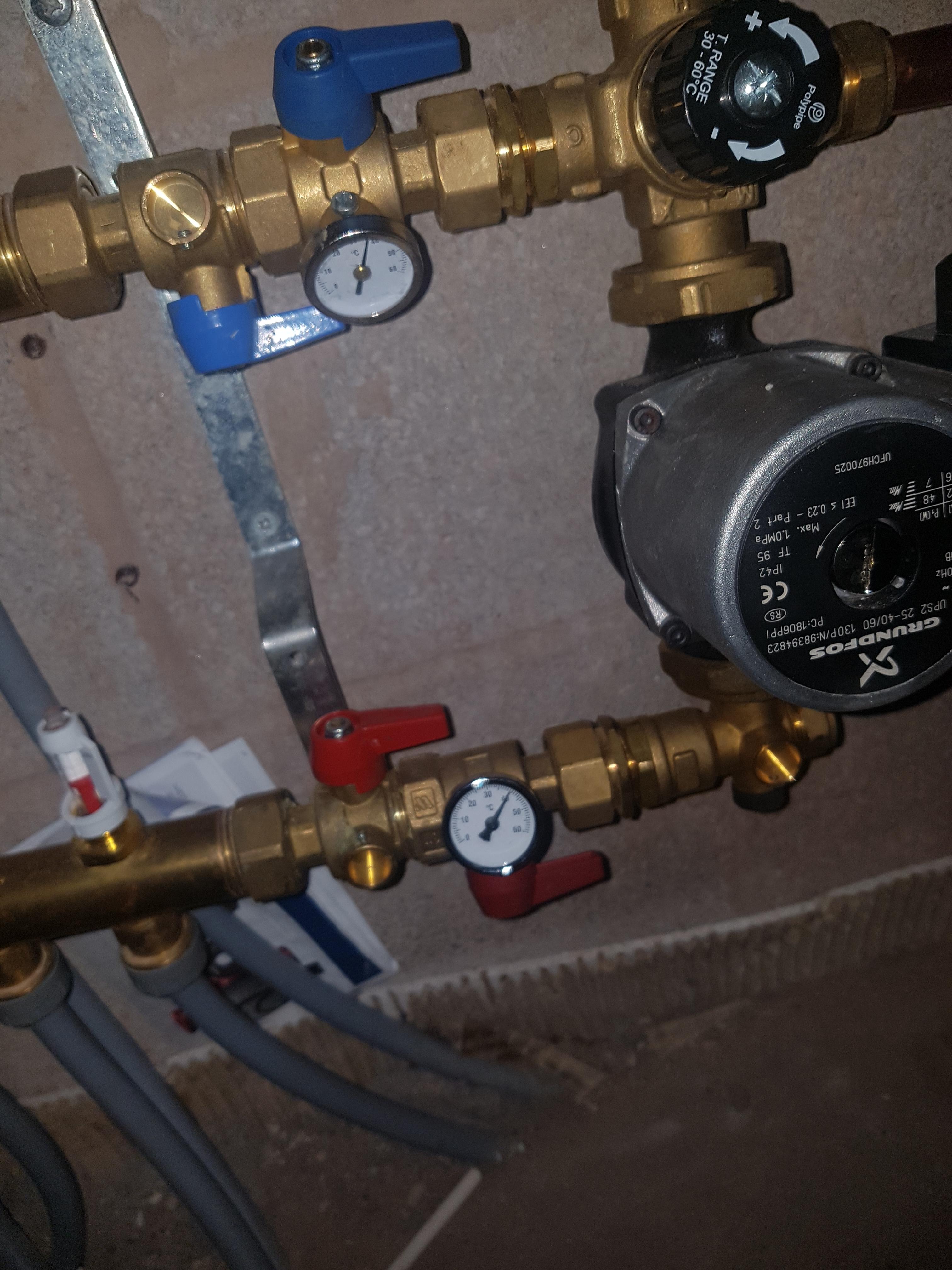

  14. UPDATE: I crawled into the space and first felt the pipes: 1) pipe into Manifold Mixing valve red hot 2) flow pipes, luke warm (barely warm at all) 3) return pipes were cold I then turned the knob as suggested, (bit by bit) and its now gone to 40 (and a return of around 35-36). I guess I wait a little now to see if anything heats up? (picture taken before I turn the dial/ knob around again, the next two turns got to 40) (p
