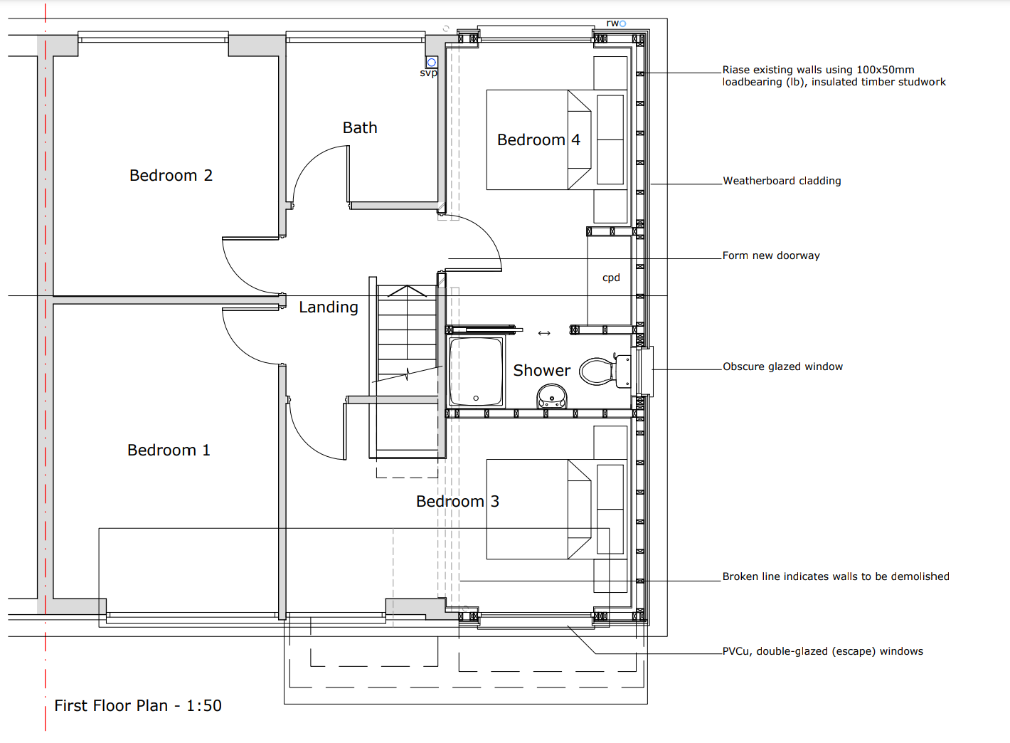

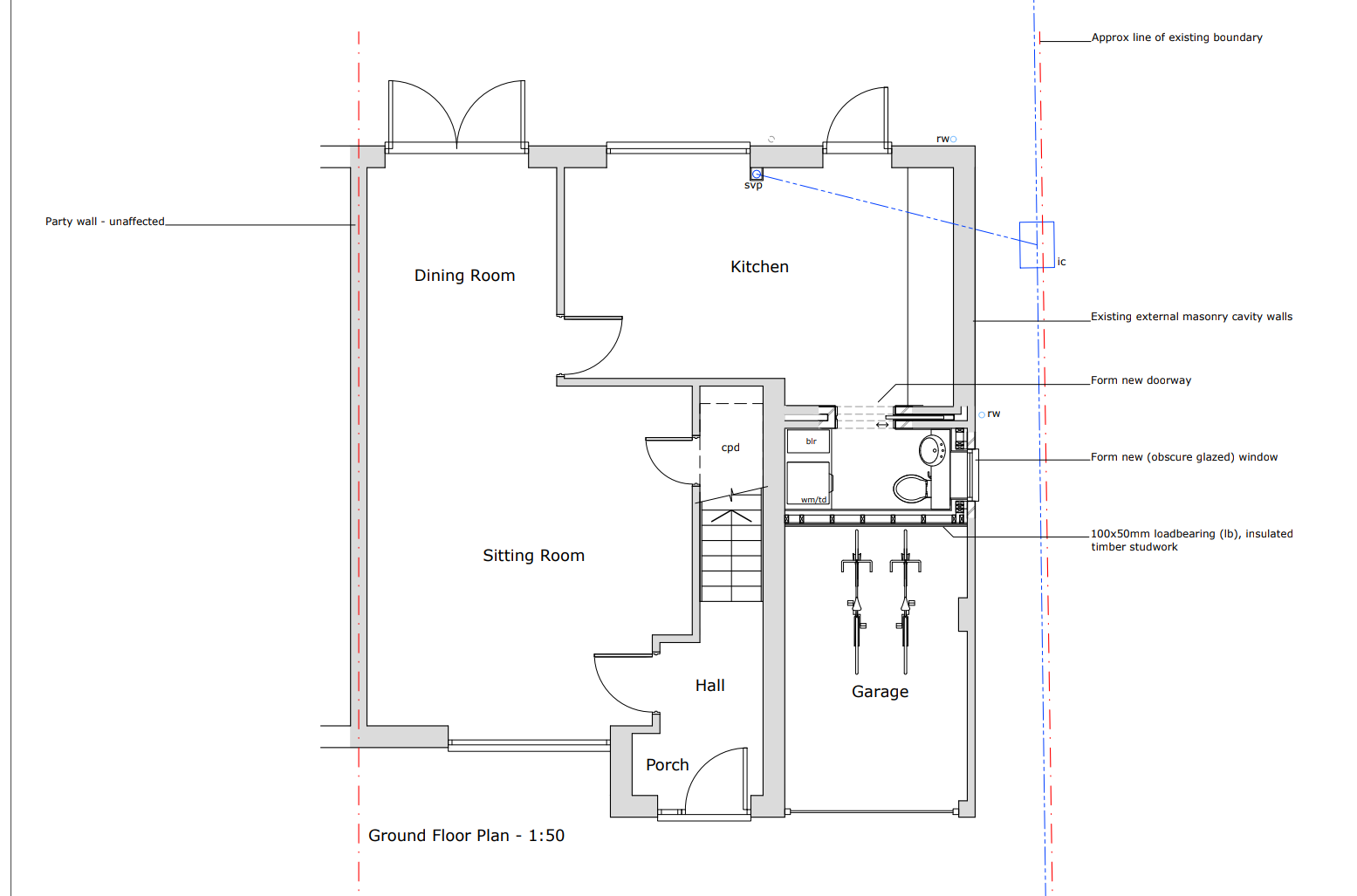

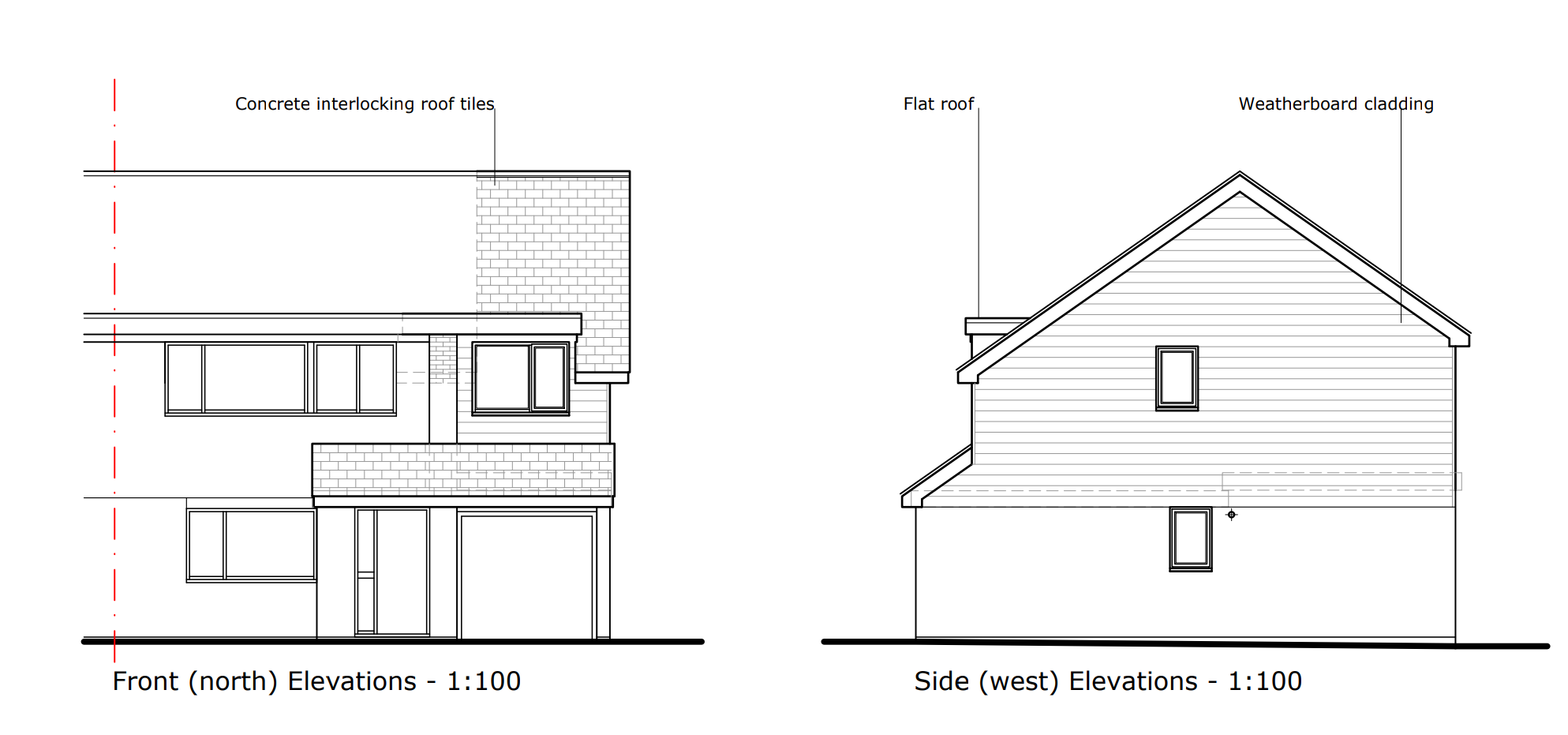

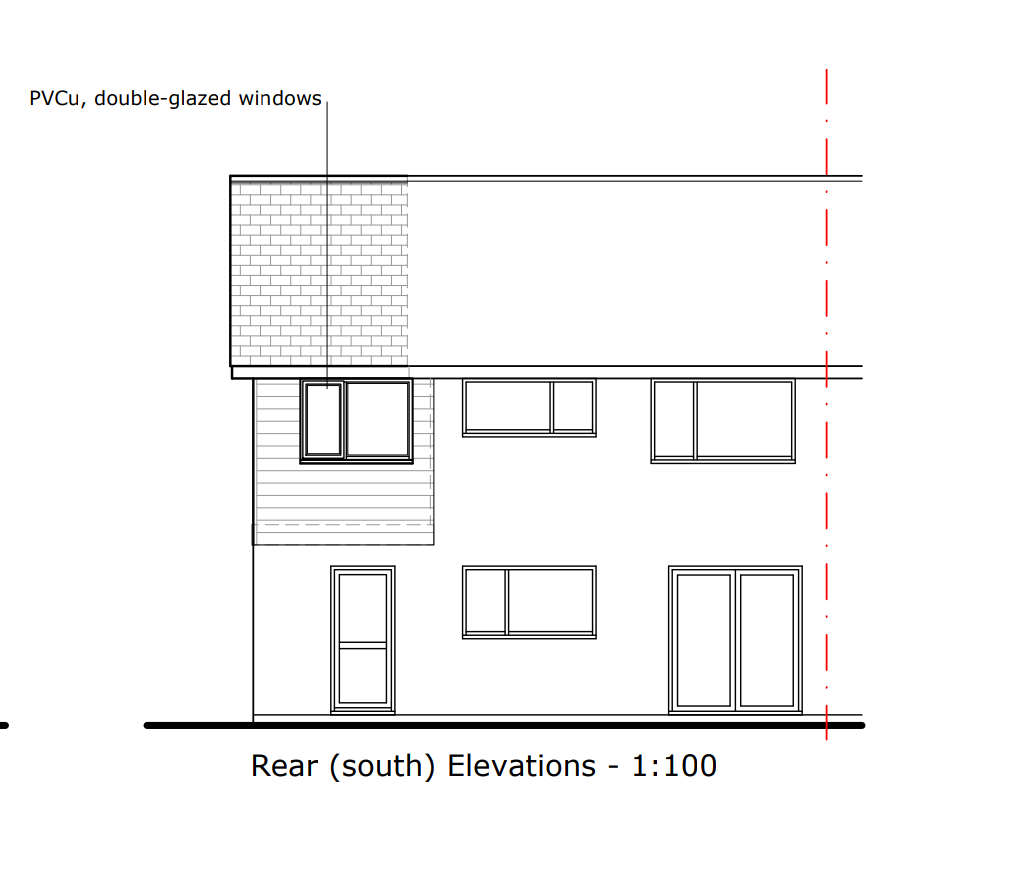

  1. I can't seem to edit my original post, so I have attached our drawings. These are the approved drawings so I have to go with timber frame upstairs. Hence the query of do I go with a builder who will build a timber frame or go with a SIPs specialist?
  2. Good Afternoon all Been directed to this forum by my father who found this community very helpful when undertaking their self build a couple of years ago and he thought someone on here can offer some words of wisdom. We live in a house that was built around 1940s, it is a semi detached house with attached garage to the side. All 4 outer walls are brick with the inner walls being dry wall. This leads me to believe that the roof is bearing all the load on to the inner skin of the outside walls. We have received planning permission to extend out over the top of garage and kitchen, in essence expanding the upstairs 'box room' at the front of the house and put a double bedroom with a small ensuite at the back. Has anyone else had past experience of SIPs vs builder when doing similar work and care to share your experience and wisdom? Its a big outlay for us and want to ensure I don't regret going down the wrong path! Thanks in advance Adam
