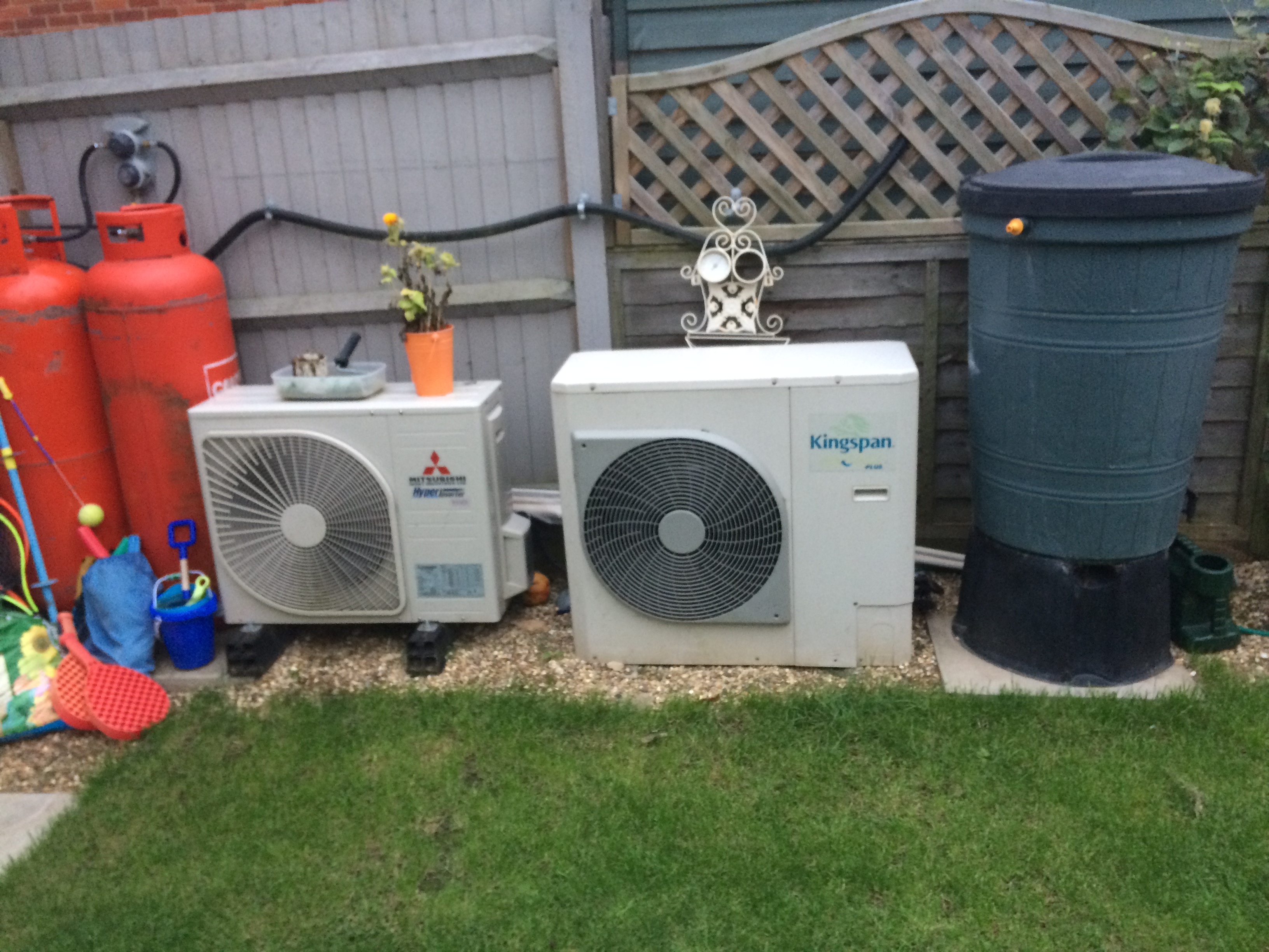

  8. Well I'm please to say I've got the pump up and running. I swapped over a couple of thermistors, checked block connectors and the pulse motor valve. That seems to have done the trick and the heat pump is working better than ever. Just wish it would have worked a year ago. The only thing to do now once it's had a proper run and I'm confident it ok is look at fitting a control unit and replace the inhibitor/antifreeze in the wet side. A bloody mole came up under the pump and closed one of the isolation valves blowing of the return line and resulting in the system draining all over the gstden. What are the chances of that! We don't have moles any more....

  10. Looking at the fault code from the Carrier Comand unit, if it's the same, 4 flashes then it's the same fault code, Refrigerant sensor failure/out of range.
  11. Thanks for the reply. I think I need to get the unit working before I spend money on a command unit. It was working with the settings it had until it needed regassing. This has now been done but the above fault is now tripping out the unit.
  12. Thanks, I have had the diagnostic indicator, the fault codes are what I picked up from that manual.
  13. Hi all. I was just having a tinker trying to get out heat pump back up and running and noticed it's coming up with a different fault. The diagnostic indicator is coming up with the following; 1 flash - no idea what this means, there is nothing on the fault codes for 1 flash. Off for 2 seconds; 4 flashes - Actual refrigerant sensor BPHE (TR) Failure/Out of range. Does anyone know what these mean and how I can test it? Thanks in advance.

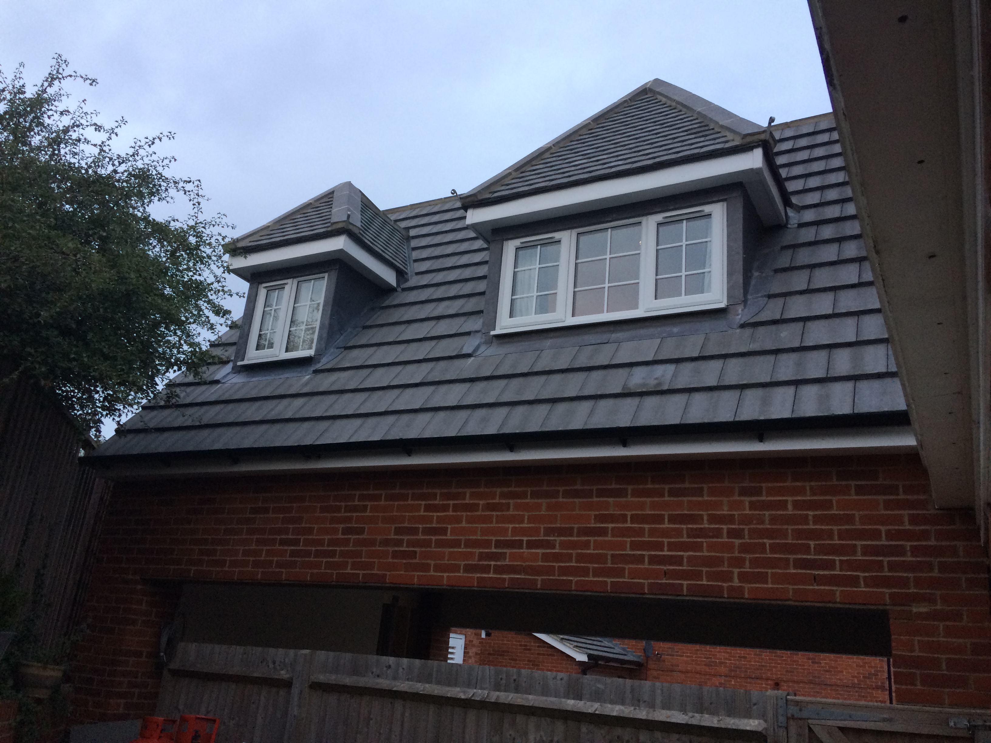

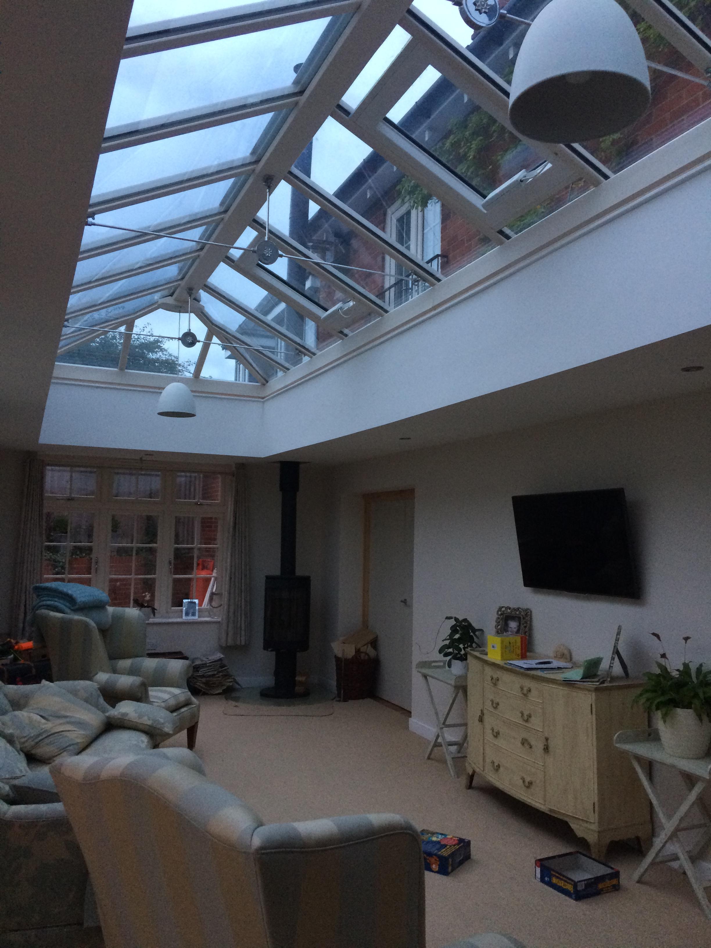

  18. Thanks for the reply. The house has gone from around 870 sq feet to around 1400 sq feet. One extension is an orangery with a full length glass rooflight, and the second is a cart lodge style with far more insulation than is needed due to the proximity of a railway line. The downstairs is fitted with an air conditioning unit and a stove. We where not that cold last winter, the heat pump hardly worked due to low refrigerant. This was fixed by a friend who's an air con engineer and he adviced the compressor had been damaged due to low refrigerant. It had been topped up about a year before due to constantly defrosting that was put down to a leak. As the unit is massively underrated now I don't think it's worth trying to rectify the faults. I had been bidding on the eBay listing for the 2 x 8 kw heat pumps but as the price went for the cost of an oil boiler didn't go any higher. We have a gas hob, I didn't get on with electric.

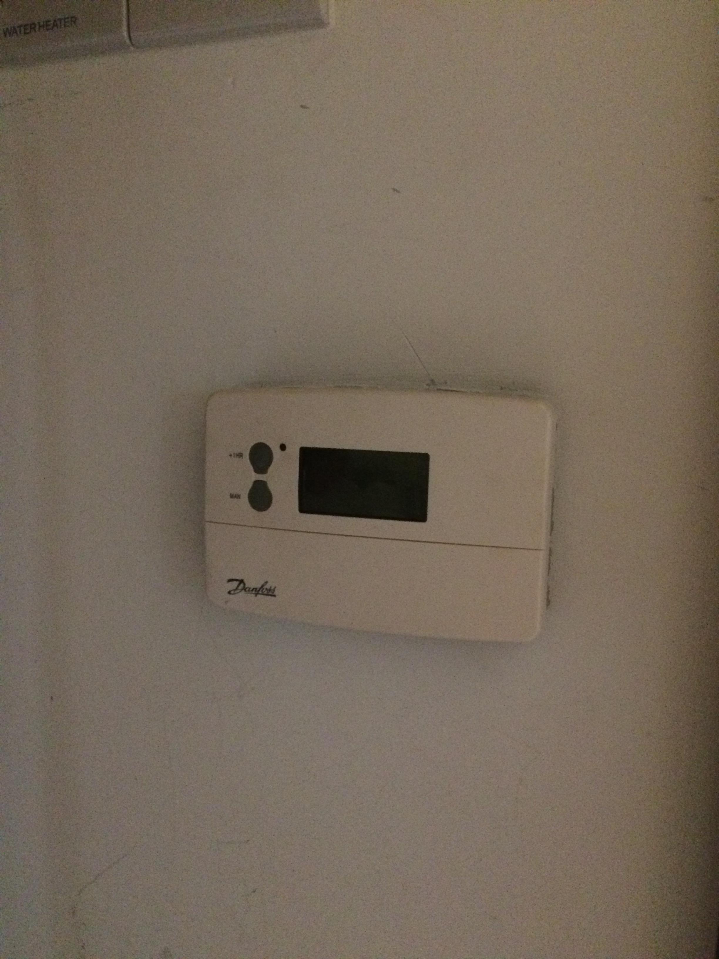

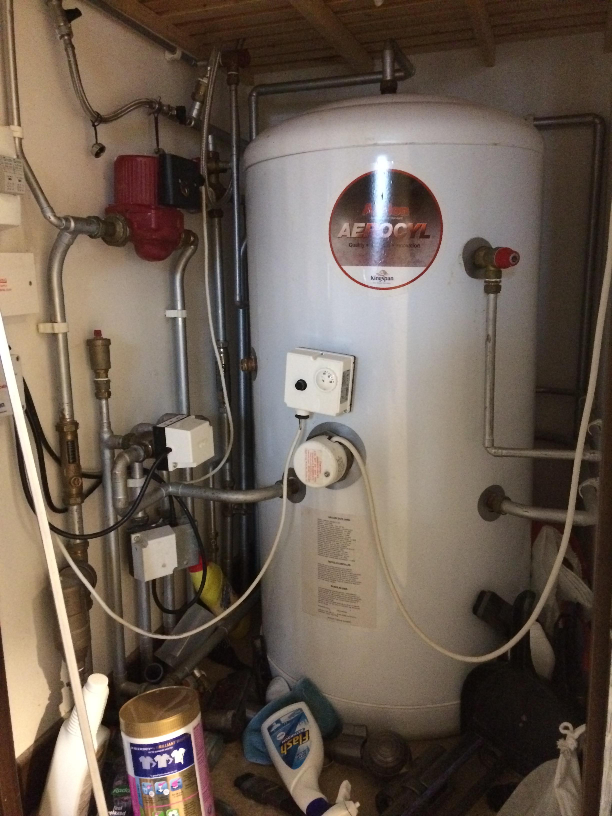

  19. Hi all, first time poster here. We have a new build that is fitted with a Kingspan ASHP to a Kingspan cylinder. The system is only 5 years only and due to poor install has never worked correctly. We are on a development of 14 houses and all of them have had problems, some having 3 heat pumps in 5 years and one replacing the Kingspan for another brand after Kingspan pulled out of the market. Our compressor has failed, to be fair, we have had two extensions over the last 5 years so it was well undersized but that leaves us at a loss of what to replace it with. Following the last extension I plumbed in pipework and electrical cables for a Grant oil fired boiler but I just want to make sure we are doing the right thing. Are there any ASHP's that we can directly replace the outside unit with? We have a 150l indirect cylinder, I know this is small but we only have 3 in the household and use the immersion when we have guests and need to. The system is controlled using Danfoss control units in the airing cupboard, upstairs and downstairs and is linked to a Grundfoss pump. Any help would be appreciated before we replace the outside unit with oil, once we ironed out issues with the system it eventually ran ok. Thanks.
