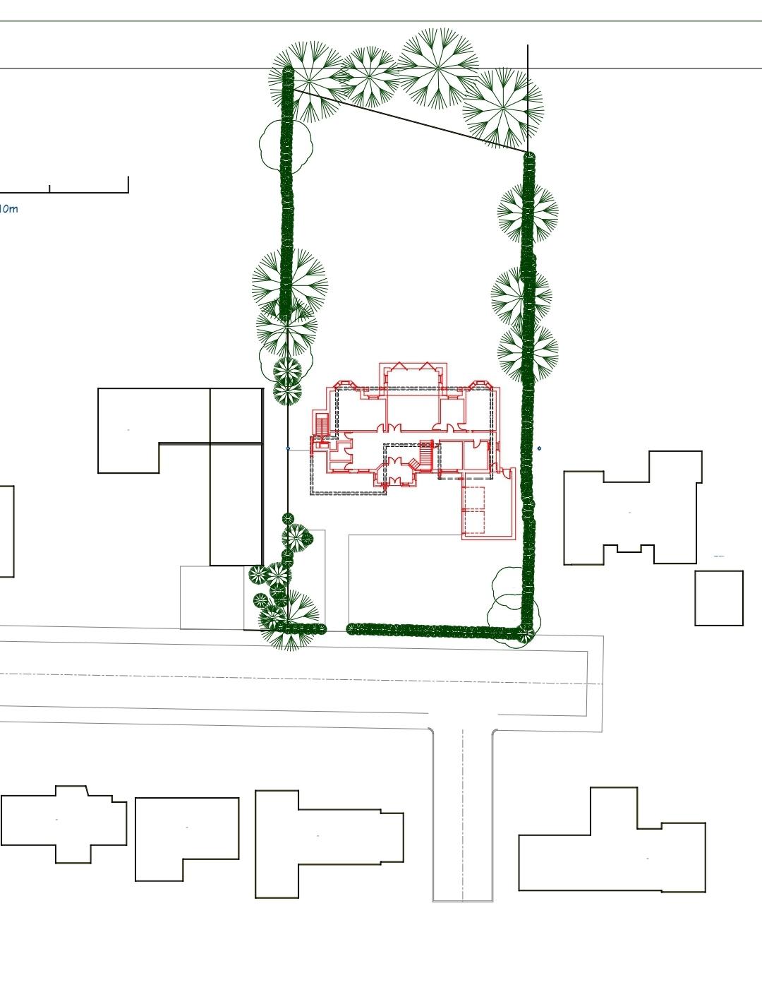

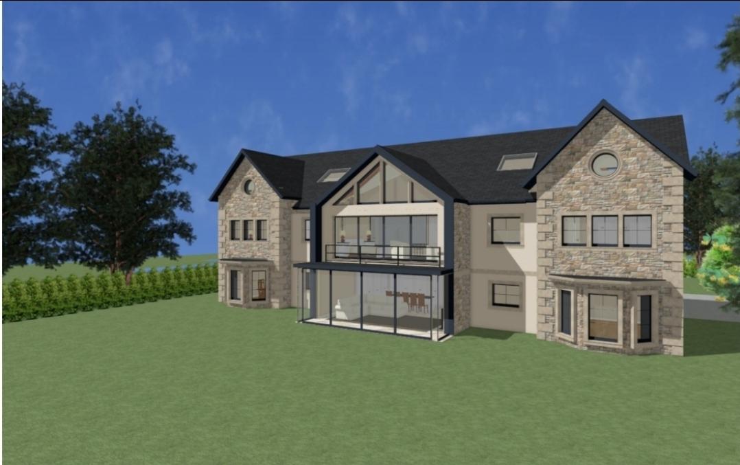

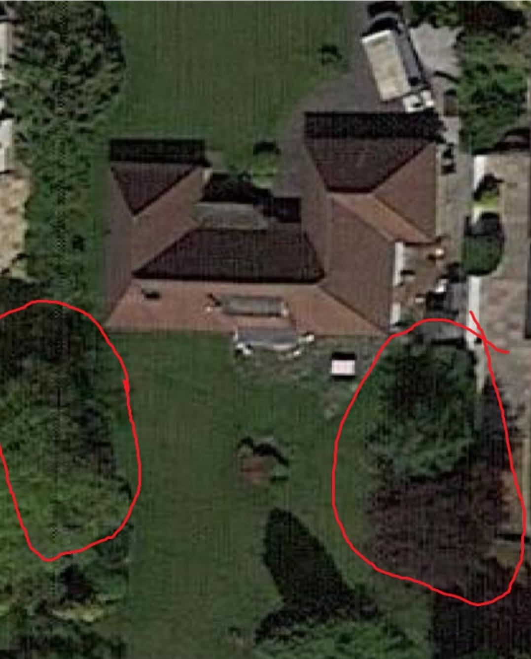

New Member

  2. Hi do after a lot of going back and forth with the po I made the bay windows to rear ground floor only. The po doesn't seem to like the back design of the middle gable. I checked the size and oversight. It doesn't effect light. Neighbours can not see it from the back of their house. Only if they go deep at the back of their garden. PO stats In terms of what is not proposed – I still think the gable protrusion in the middle is too wide and bulky. As noted I’m happy with a single storey flat roof extension (with balcony above if desired) instead with a similar footprint. Before he made me change the design because he didn't want me having a balcony and made me put a flat roof with a big window in the middle. I think the new design looks a lot better and it's a modern design with the large middle gable. I think he just wants me to stick to a simple design. I'm thinking if I should just submit as I made it and try fighting for it or should I just get plans submitted as his saying in the preassesment stage and see how I feel about it. Maybe fighting for the redesign later? I would like to start build mid June.
  3. I've not learned how to do the bay window roofs yet. New to this self build so all is a learning curve. It's hard to tell in the render but wanted a taller section of bay windows. Top and bottom. To give the house better design and apperence. Maybe something like the attached pic. The trees are not protected. So if I put in obscure side windows on the bay windows. Got the trees there. That would mean I could potentially convince the PO I think?
  4. Thanks appreciate the info. I didn't think about doing a section 73 for it later. I was considering obscure windows. Just looks abit odd from outside when looking at the house. But comprises needs to be made I guess.
