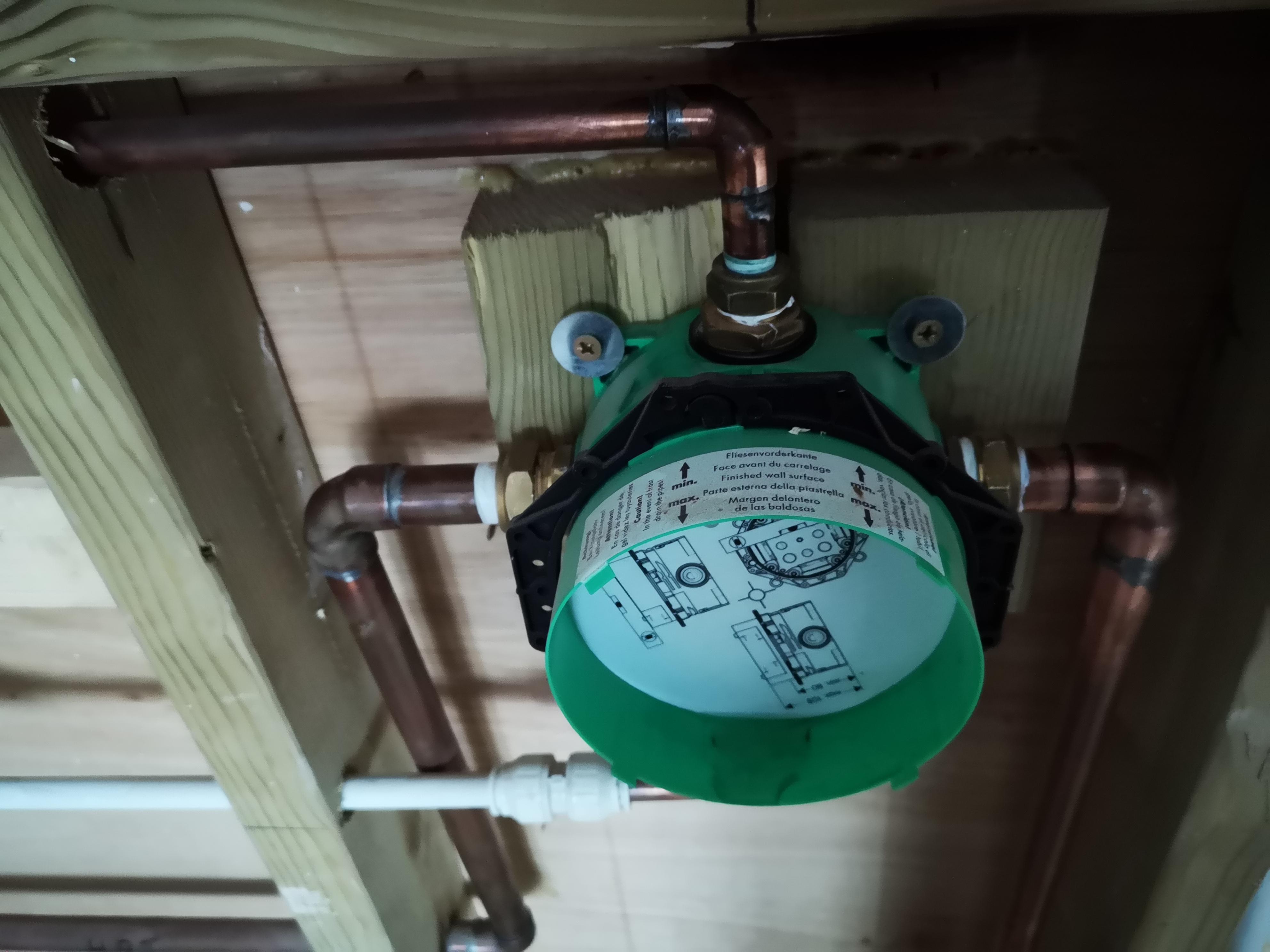

Hi All Be really grateful for your comments on this one please. We've got our tiler coming on Wednesday to do 3 bathrooms but the builders are struggling with first fix. We came to site yesterday and the Hansgrohe ibox was dripping - looked like it was from the top but could be a leak from the bottom of the ibox - not clear. Please can I ask what is generally done in order to test the pipes and connections to one of these? I spoke to our bathroom shop and they said that the top cover of the valve is needed to test the ibox for leaks, as it is not watertight without it and it will leak. I'm just very nervous about whether the pipes are going to be water tight before the tiles go on. The builder said they had tested the pipes so when we saw the leaks, we were rather concerned. (Some of the leaks in the photo are from the caps put on the end of the pipes, so nothing to worry about, but the ibox one was quite worrying) Thank you very much!!

Many thanks Nick - that's really helpful. Tiler is installing ditra anyway so that's good. We'll make sure heating is turned down!!! I thought it was a bit high - should trust our instinct next time.
