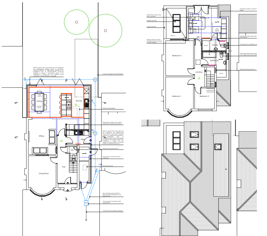

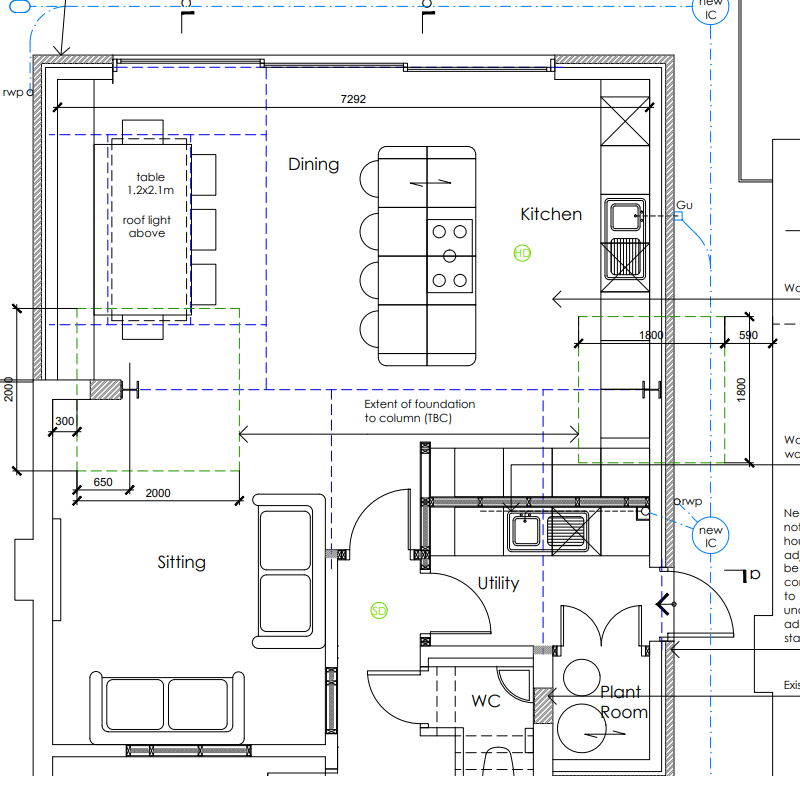

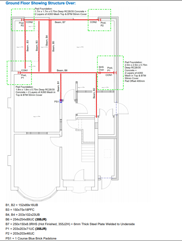

  2. Thanks both. Helps to get a bit of a sense check, and assumed it was due to the full removal of that back wall. I'll explore the possibility of linking the two pads as suggested to see if this will help brink it in further from both neighbours.
  3. It is indeed, that's what everyone who has seen the plans has said. Admittedly there is a large steel across the entire rear wall of the house so I guess we should have excepted it to be substantial. Although I do wonder if things like the direction of the span of the floor joists in the upstairs bedroom affect loading, and these have never been checked with a site visit at any point. Indeed. Unfortunately we didn't build our house on sand as in the bible....we me acquired an already build house on sand...oops. Although I hear that sand can be preferable to clay. Moving the house to better ground conditions seems excessive just to get the kitchen we want ?
  4. Thanks for your reply.. That's what I figured. There will be a steel across that rear opening regardless, whether that steel sits on steel goalposts or loadbearing masonry, I assume the load transferred to the footings is still similar and so the sizes should be similar. The issue the architect is raising is more the relationship to the neighbours garage, and that the pads the structural engineer has desingned would undermine the garage footings. Their isn't anything we're too worried about with the rear opening, as if need be I'm happy to compromise on the size of that opening. Say going from the current 5.5m opening to a 4.5m opening. It's North facing anyway, but I'd liked the idea of a kitchen and living space that worked well with a garden patio in the summer. The bigger concern is the structure around the existing rear elevation. The pads the structural engineer designed initially encroached on to the neighbours drive (so a no go), and we subsequently tweaked them, however there were still concerns that the design would undermine the foundations to the neighbour on the right of the property. Interestingly the structural engineer has designed the footings assuming clay, however next door have told us their soil was sand, and a hole I've dug in the garden along the proposed rear elevation suggests the same. The pads and opening across the entire existing housee do make a complex build, but we're wondering if they are significiantly over engineered, especially with the ground conditions? I've shown the footing design below.... might be more appopriate for me to post in the structural forum.

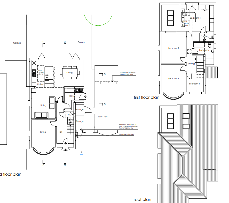

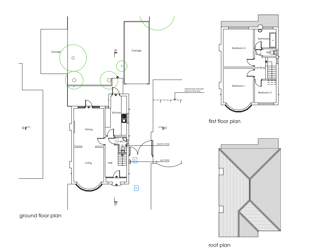

  7. Hi everyone New to the forum, and wanted to chat about some questions we have on our extension. We are getting different opinions from different professionals and it's quite confusing. The background is, we have bought a 3-bedroom detached house on a lovely street in Nottingham. Its circa 1930's with 9inch brick solid wall constructon. Many of the houses on the street have been substantially extended, but ours is yet to have any work done. My partner's Dad is planning to do a lot of the work as he is a carpenter by trade and has spent his life building timber frame buildings and renovating houses. We have planning permission, and we were planning to start this month, but discussions around the internal layout and its affect structurally have caused concerns to be raised by the architect. The existing plans are below. followed by the proposed plans. The initial proposed plan shows the new kitchen on the left as you look at the house and was the architects suggested layout. However we were'nt happy with the relationship to the living space, and the size of the kitchen considering the extension, we asked to explore removing one of the external stores and moving the utility to allow space for a bigger L shaped kitchen that has some separation from the living space. Obviously this is more complex structurally as long goal-post steel has to go in to support the entire back span of the existing house, wheras previosuly the the utility room wall was load bearing. The architect has also raised concerns about using timber frame as the foundations for the new extension would be bigger, and another goalpost required over the rear bifold/sliding doors. Whereas with loadbearing masonry apparently a steel goalpost would not be required and the foundations smaller. We are now struggling to decide between the layouts. My partner's father has got a second structural engineers opinion (a structural engineer he knows and works with regularly) and both believe the revised layout is workable, but the architect is strongly against. Any advice would be warmly received. To timber frame or not? To Kitchen flip or not? Existing Plan.... Initial proposed Plan Revised internal Layout
