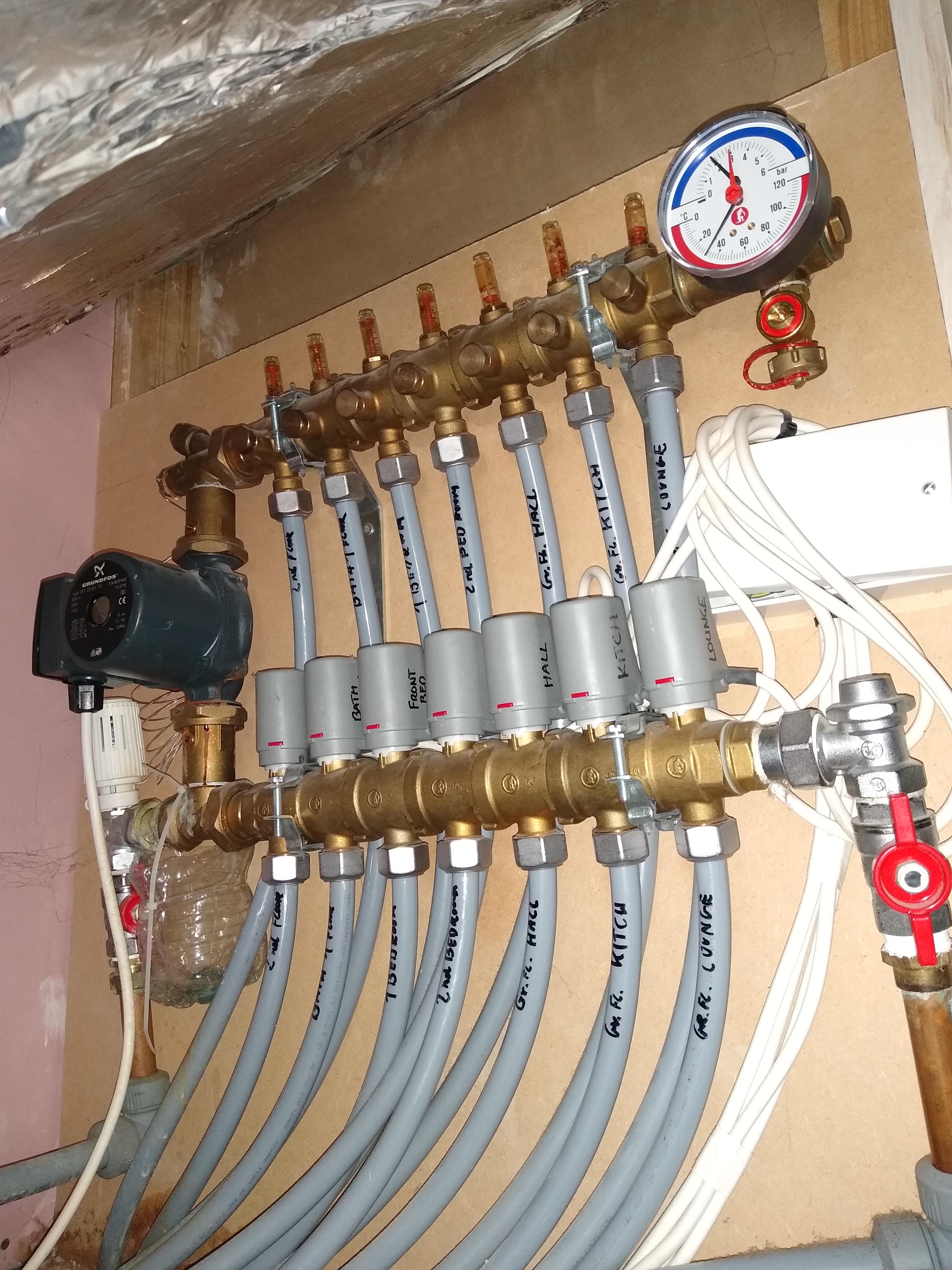

New Member (2/5)
0
  1. That looks a tidy install and much more space around it than mine which is crammed into a the eave of a roof space!

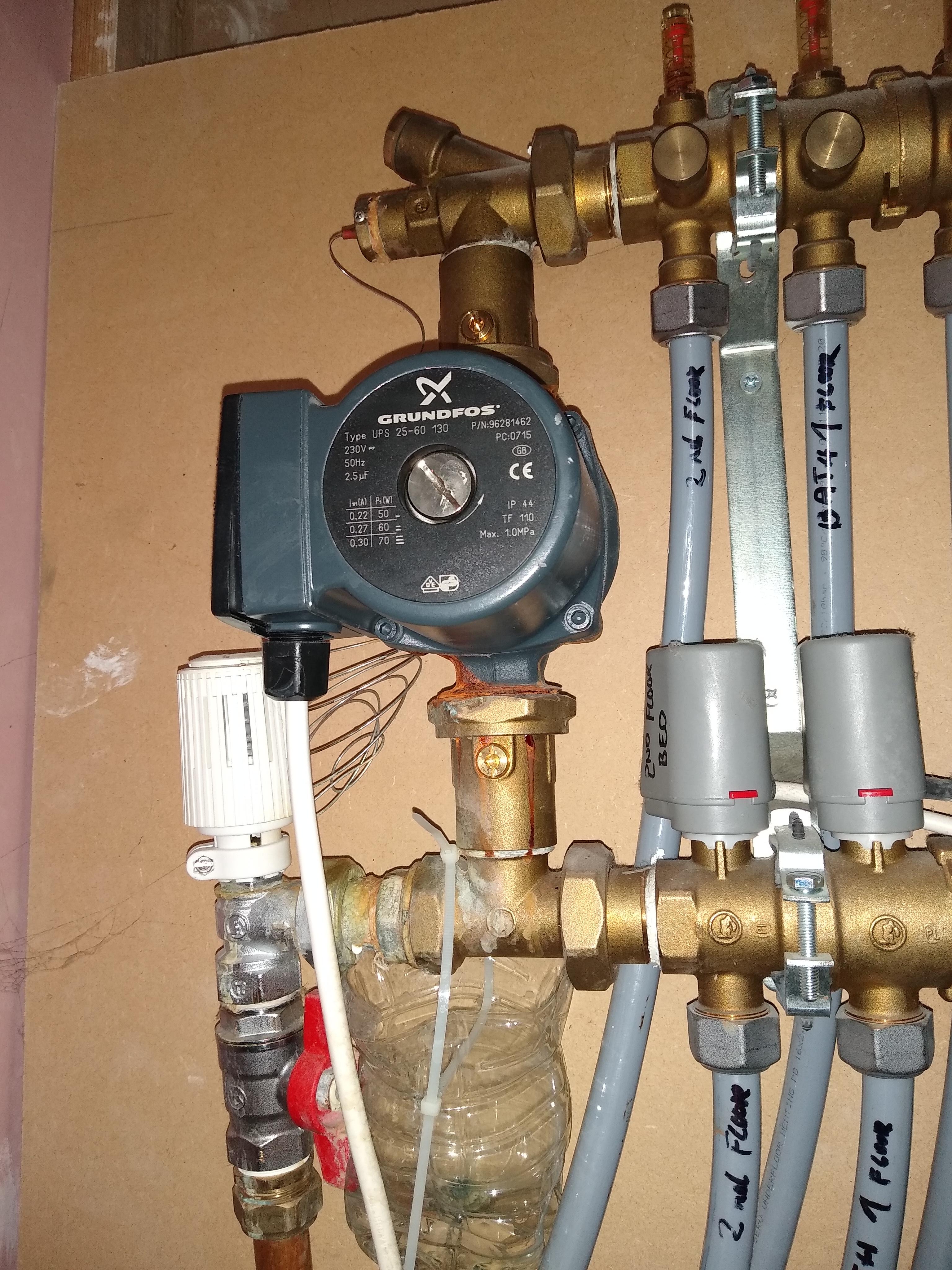

  2. That's a worry about the pipe fittings, there's a spagetti junction of pipes, elbows and connecting pieces at the boiler and that's only the ones I can see!
  3. Definitely will be fixing the leaks at the same time. You can't see in the photo but there is a connecting piece on both the supply and return line 50 cm from the manifold. Could I just undo and swap over the pipes rather than rearrange the manifold?
  4. ?? no point in repairing leaks until my new valve comes and I've decided whether to swap over the pipes!
  5. Many thanks for the very quick replies. I believe the pipe underneath the red handled valve on the right hand side is the return to the boiler, This is about 50 degrees. On the left hand side underneath the thermostatic valve with the white head I believe is the supply, about 35 degrees.
