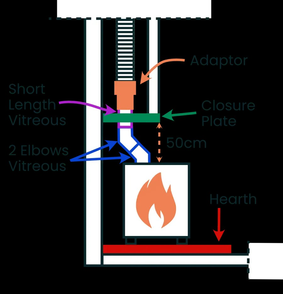

Err i kind of already started 😅 Yep got them both I'm comfortable doing the masonry work as it's all cosmetic. Just need to find the accurate info on what clearances (top bottom and sides) are allowed to be so I can get that bit sorted out since I plan to lower the wood beam as well as re model the brick work. There's already a flue liner, register plate, stove with notice plate and all the other hardware installed from before so I'm happy to get a hetas person in to make/advise on the required changes Needed for the reinstall/sign off.
I posted a few months ago about a pre installed wood burner that I inherited when but was experiencing poor performance with the heat output etc. I've recently started dismantling the brick work around the fire place in the hope improve things but this has raised some additional questions around the original install... Firstly, by me modifying the install.( I plan to fit a rear flue adapter to replace the current top outlet configuration in order to bring the stove forward into the room a bit more) Does this mean I need to get the install re-certified? If so what's the process as a diyer? Second there are a few questions around some aspects of the original install... 1. The register plate sits in a groove cut into the masonry and is pretty secure. ( You need to push it up and wiggle it out at an angle it to remove it) however it's not mechanically fixed in place... Should it be? 2. The flue pipe that joins the stove to the flue liner is an offset bend made of two pieces that slot together. When I dismantled them to remove there was no sealant between any of the joints. (Ive never had any issues with smoke entering the room or my co alarm going off) Just wondering if they should have been sealed for good measure? Lastly the clearance around the stove to the masonry... When I removed the stove I realised that it was fitted with a rear heat shield that was actually touching the back of the recess. I'll be removing this and fitting the rear flue adapter thus creating a gap at the back of the stove. Is there a specific minimum distance the stove needs to be from the rear and side masonry? Can't find anything pertaining to non combustible surfaces. Tia

So it looks like I've got a charnwood C4 or C5(would have to measure up to confirm when I get a chance) Yes it looks like it does support a rear flue adapter based on the info online. So that could be an option. Given the super limited clearance ive got no idea how they managed to fit the existing flue pipe to the top of the stove and fit it all in. Feels like this was definitely fitted into an undersized recess I think my first thing I need to do is get some of the brickwork out of the way and get a better idea of what I'm working with and my options. -

So I did some more investigation and thinking about how I might be able to pull the stove forward into the room a bit more. The current install has a double bend flue connection pipe similar the one pictured Would it be possible to replace that with a double 90 degree bend? The only thing is I don't have that 50cm gap shown in the image so not sure how I'd be able to get access in order to swap the parts. Any ideas? -
