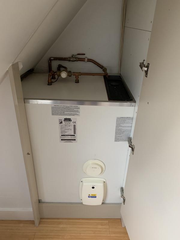

  1. It's a first floor flat, just above a restaurant. The ASHP would be located on the roof of the restaurants extensions where they already have air-conditioners and other outlets. Will check that out. Thanks!

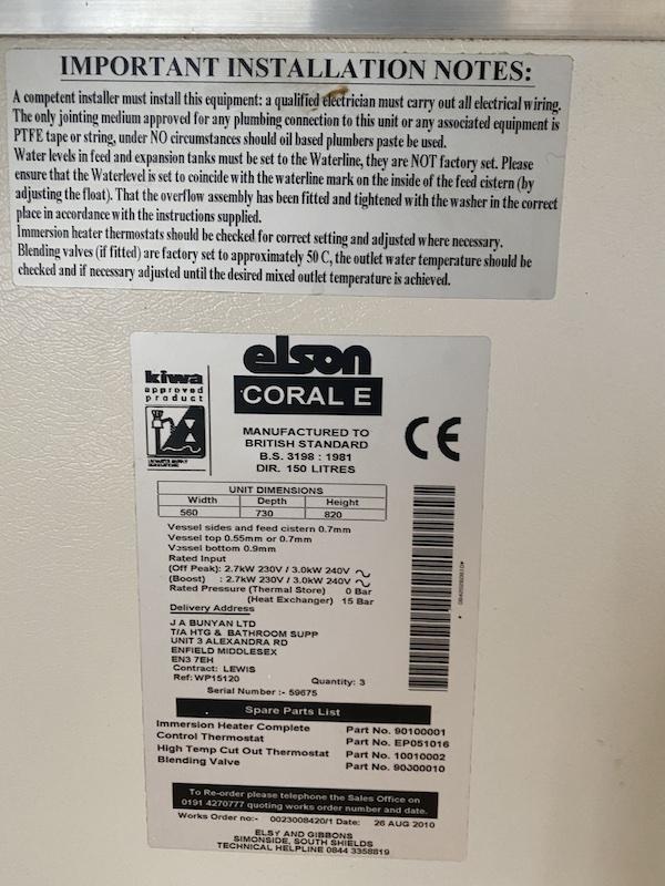

  2. Hi all, Hope you are all alright this crazy year. Very happy I've found this forum. After many years of saving, and looking for more flats than we would ever think we would see, my and my fiance have finally found a flat we could both agree on... Not the easiest of things! The flat we've bought is electric only and the heating is done by electric heaters. The hot water comes from an Elson Coral E which holds 150L. We are looking into putting in underfloor heating to replace the electric heaters. Do you know if an underfloor heating system could even be connected to the Elson Coral E? Since there is outdoor space we would like to, at a later stage, add an Air Source Heat Pump to the system. Is there anything we should consider when choosing the model, type, or brand of underfloor heating so it will integrate well with an ASHP? Any gotchas when it comes to this? Also, the interior space for a new cylinder is quite limited. I read on one ASHP fitters website that they require a full height cabinet. Do you think this could be an issue when converting to an ASHP and a suitable cylinder? These are the dimensions of the Elson Coral E, but as you can see on the picture, there is room for something taller. Width: 560mm Depth: 730mm Height: 820mm I've also attached a close up on the spec sticker of the Elson if that could be useful. Many thanks, Gustaf
