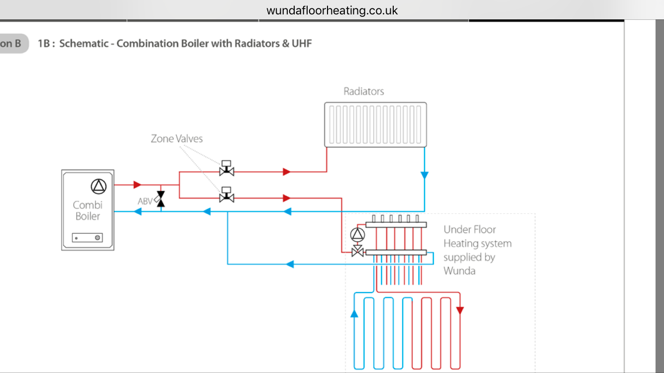

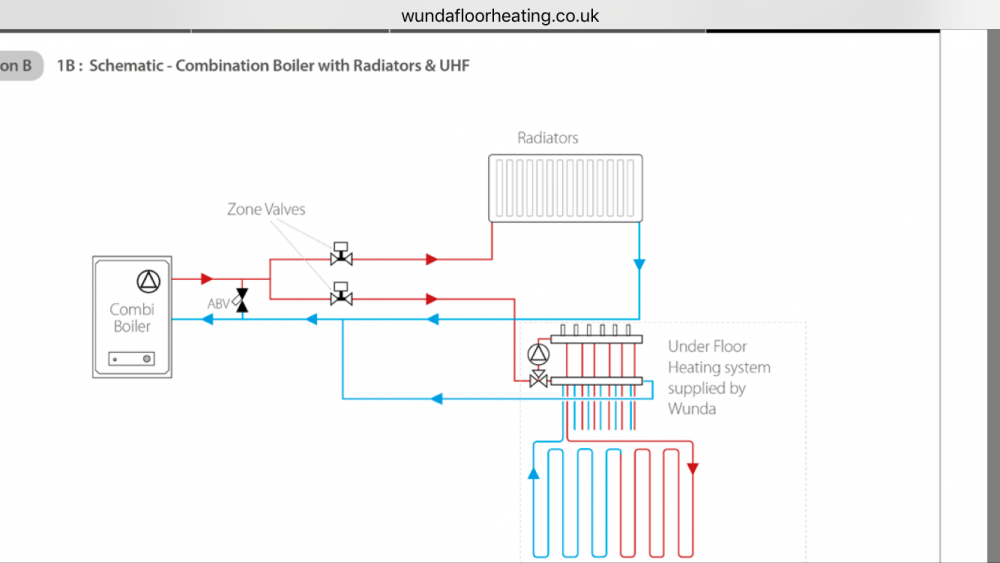

  4. Thanks for that. I know I know I need a buffer tank but I've looked high and low and without ripping my entire bathroom apart again (not and option lol) I have nowhere for it. i came across a picture finally last night off wunda
  5. It's 2 55metre runs. My boiler is sat right above my ufh manifold in the same room. My main question is.... do I need the circulating pump on the manifold with it being connected to a combi boiler? And to run a thermostat on rad system and thermostat on ufh do I need 2 2port valves?
  6. It's a Worcester boiler so I'm guessing pump is in boiler. do I want a 2 port valve on ufh and 1 on rads? So I can control separate?
  7. Ok I know everyone is going to tell me buffer tank but im looking at the system without a buffer tank. I am planning on running a underfloor heating system in 1 room and rads in rest of house. Running of the boiler with a separate stat on the ufh. It's a combi boiler. do I still need the ufh pump on the manifold and also do I need to put any 2port valves in anywhere to run the 2 Seperate stats

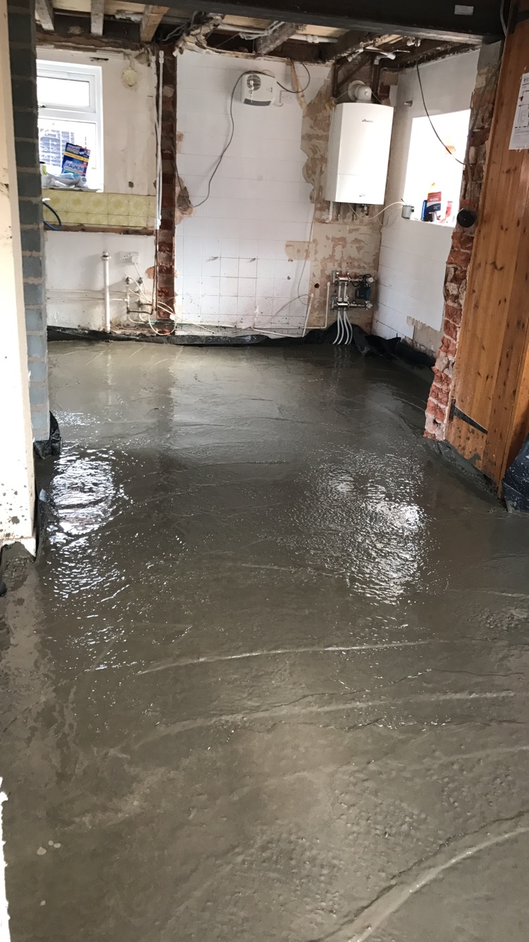

  16. Well had to delay the concrete until 3pm due to plumber not turning up so decided at midday to pressurise it myself. Now sat at 3bar concrete laid and trouled! Not fussed with finish off concrete as got some free self leveller which will level the finish

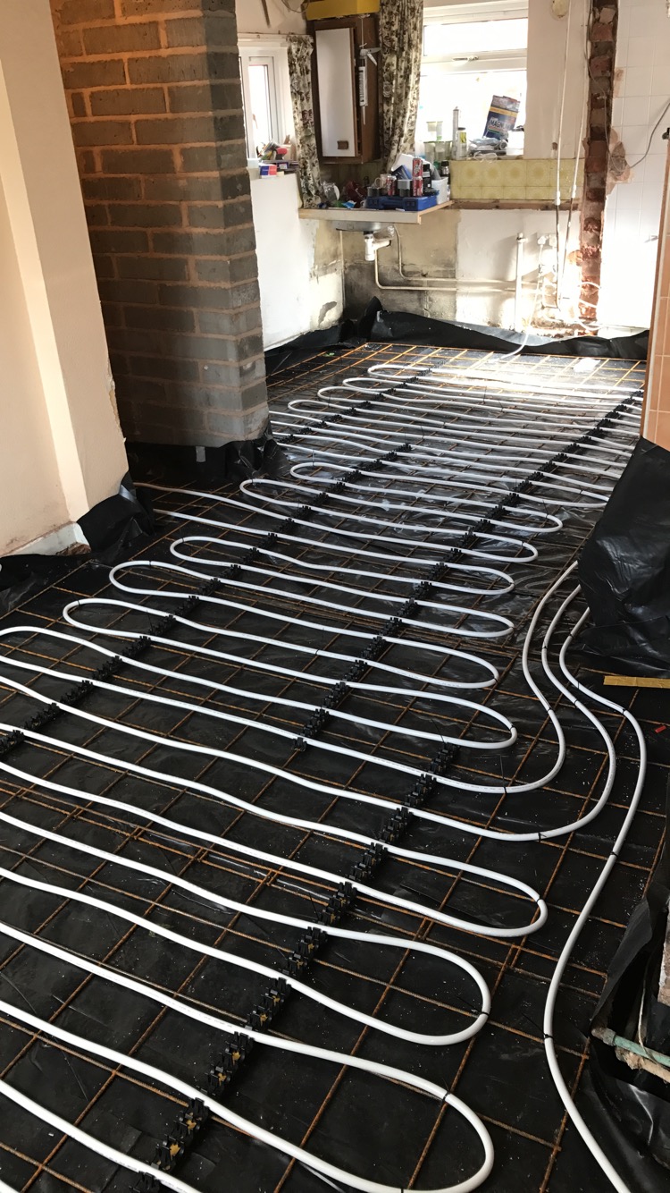

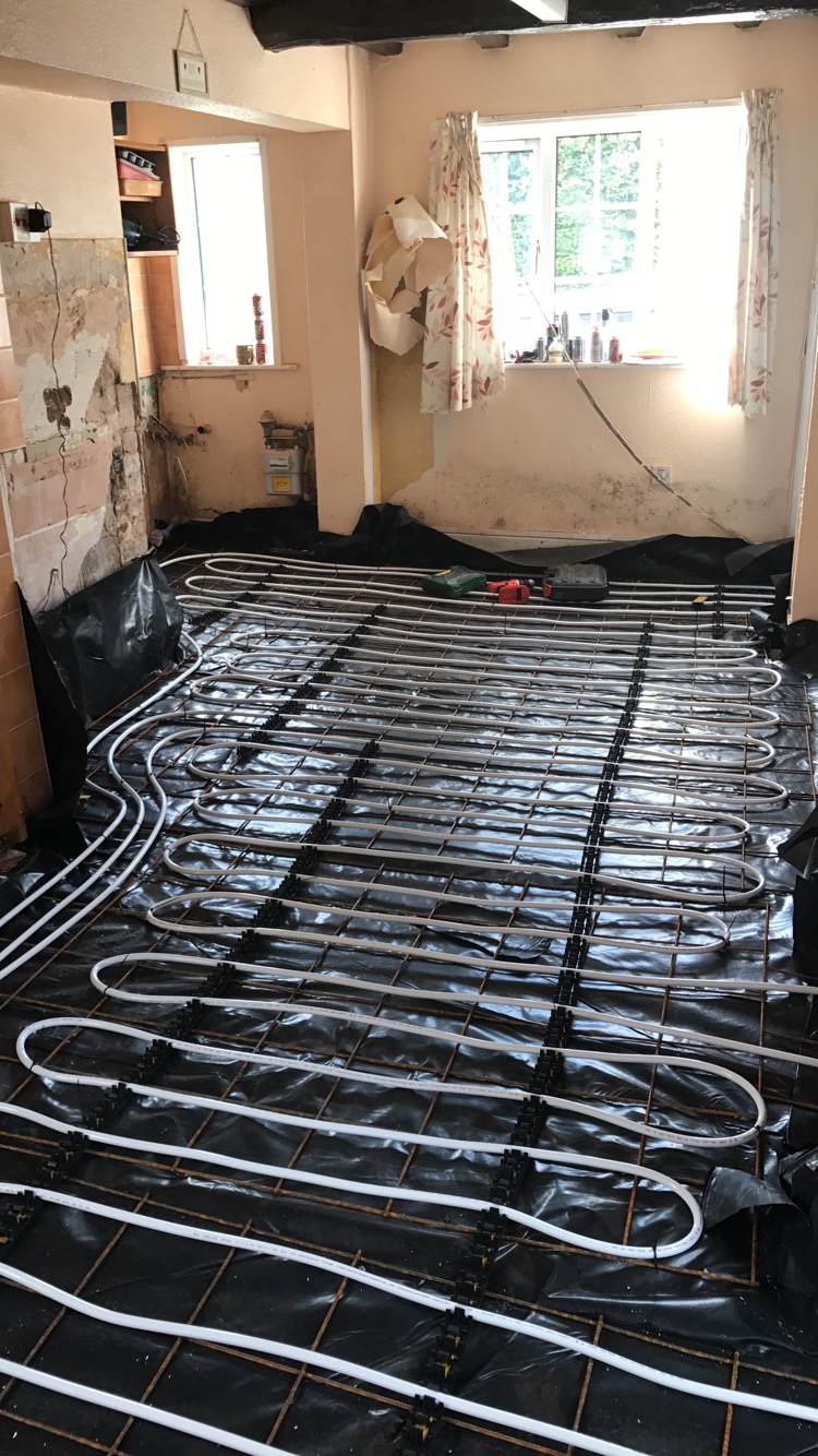

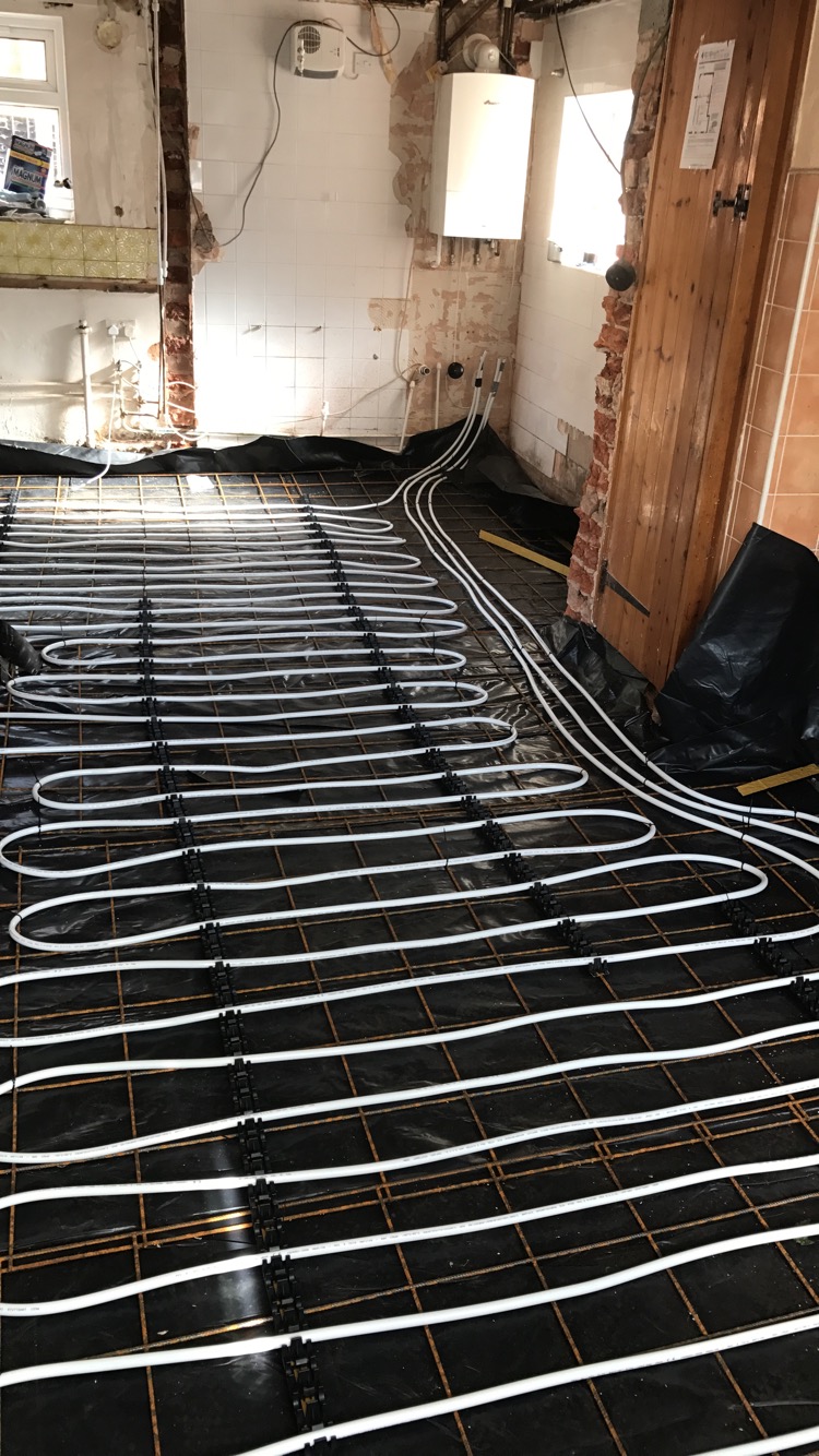

  21. Mainly because of the awkward layout of the room i ran the different layout options in loopcad and the method your talking about had 3 very tight bends in it. So I opted to have two runs in the chosen method and both or around 50-60m in length
  22. I wish there was trickery involved lol I wouldn't be so [ever so slightly tired] ! ???

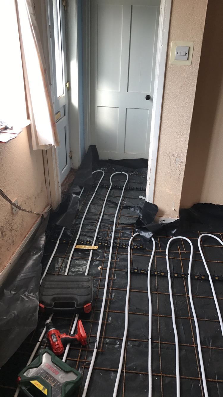

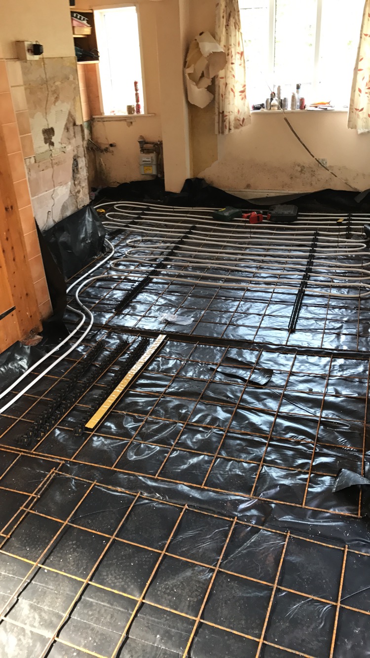

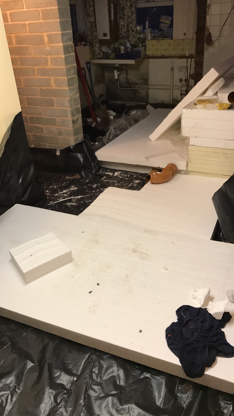

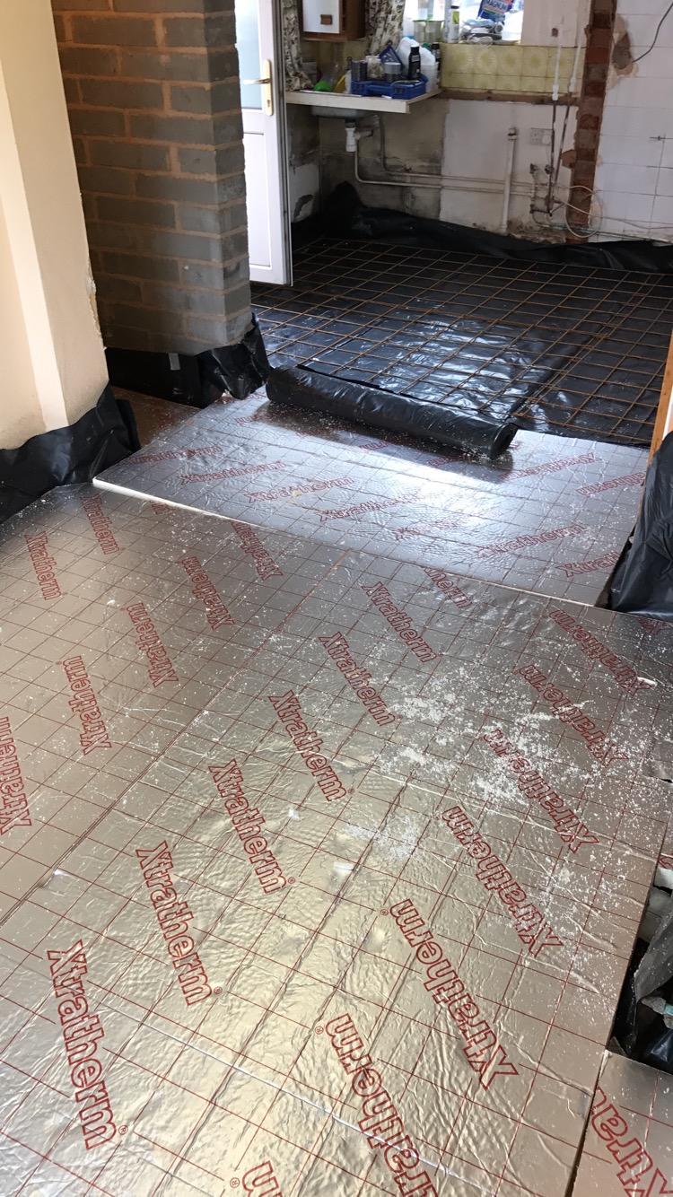

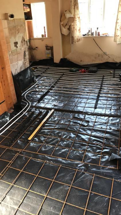

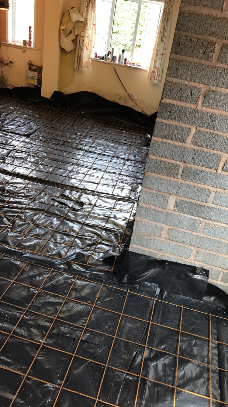

  23. so finished insulating and got all my pipework laid.

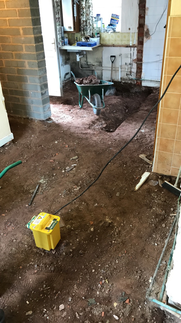

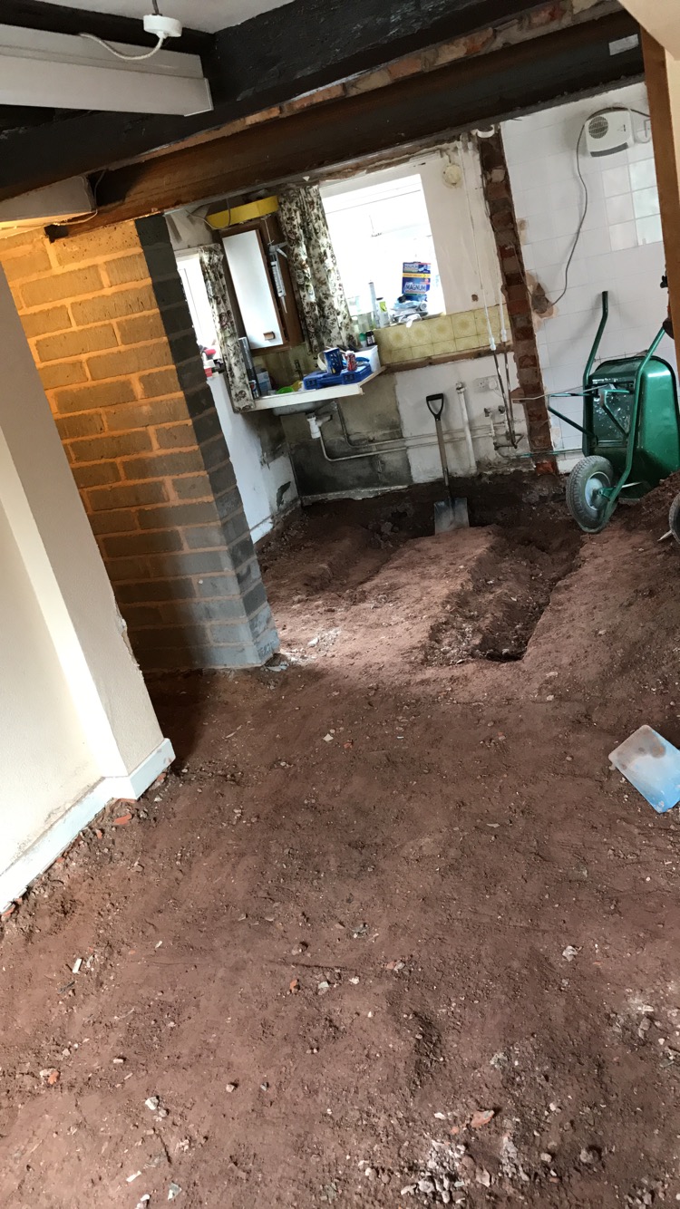

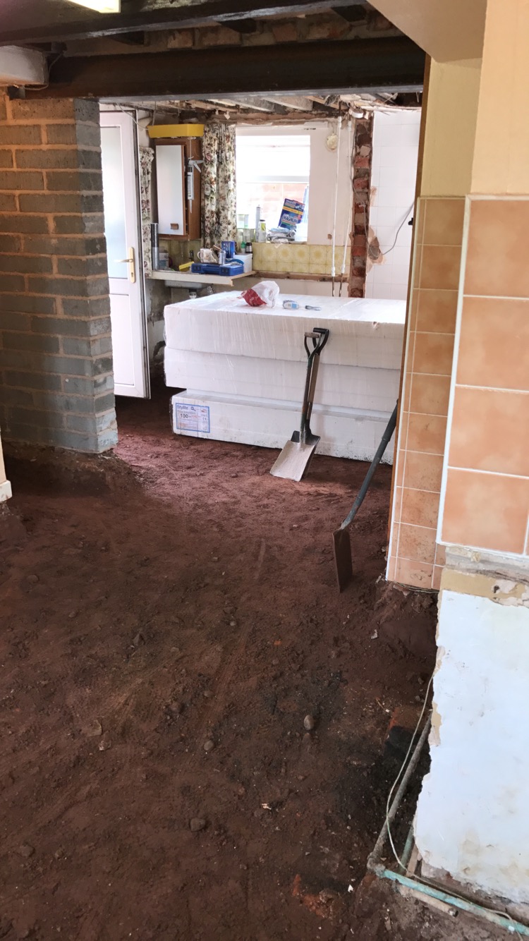

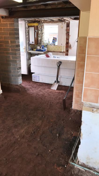

  24. Ive bought the slightly more expensive concrete mesh men from TP. As for the mesh height it shouldn't be any higher as it sits into the stands so hopefully to top of pipe will be 56-66mm! Finished digging today and started DPM and insulation! Got a bit of drainage work to do first thing then get rest of insulation down! Target for tomorrow is all pipework laid
  25. So today was the start of the floor dig. Managed to get a breaker on what turned out to be a 4 inch quarry tile and concrete slab to expose the soil base. Tomorrow we dig down the final 5-6 inches
