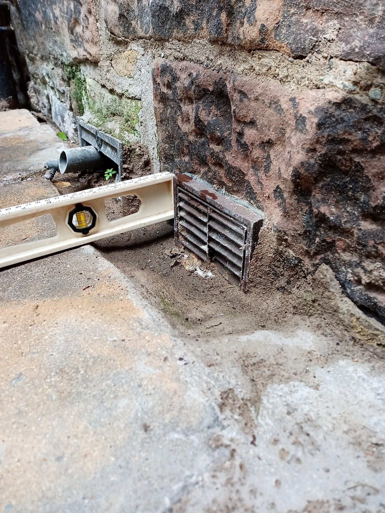

  1. Thanks for all the input folks. Wish I knew more about the construction of these old buildings! Got some full-time patio pros who did an excellent job at a similar property down the road coming to take a look (should have used them in the first place rather than someone who seemed to be more a "landscaper"; ho hum you live and learn). It's basically the same patio as was there before but the slabs were pretty much just laid on earth as a quick-fix for a grassless back plot (think some sand or gravel went down, but no membrane) about 20 years ago. It was grouted but I think a lot of water just drained away down through cracks. It's not so dissimilar from what neighbours have.... there's certainly no "French drains" up against the building. But the last time we had damp problems it around 15 years ago when a storm ripped the gutters off the back wall roof above it (and most of the roof felt too!) and by the time that was properly fixed (it took months) the back wall had gotten quite damp and everyone (there's 4 floors above us) needed plaster stripping and dehumidifiers running. Keen not to have a repeat of anything like that though, so want to get on top of this pronto. BTW, received wisdom is that sandstone construction tenements of this age do not normally have a damp course; supposedly the sandstone's breathability enables it to deal with it: see e.g https://mysweethomes.co.uk/tenement-damp-why-the-standard-answer-is-usually-wrong/ and https://dampdetect.com/rising-damp/edinburgh . Fortunately we've never seen anything like the "rising damp tide-marks on ground-floor flats and stair walls" one of those mentions as a common issue.

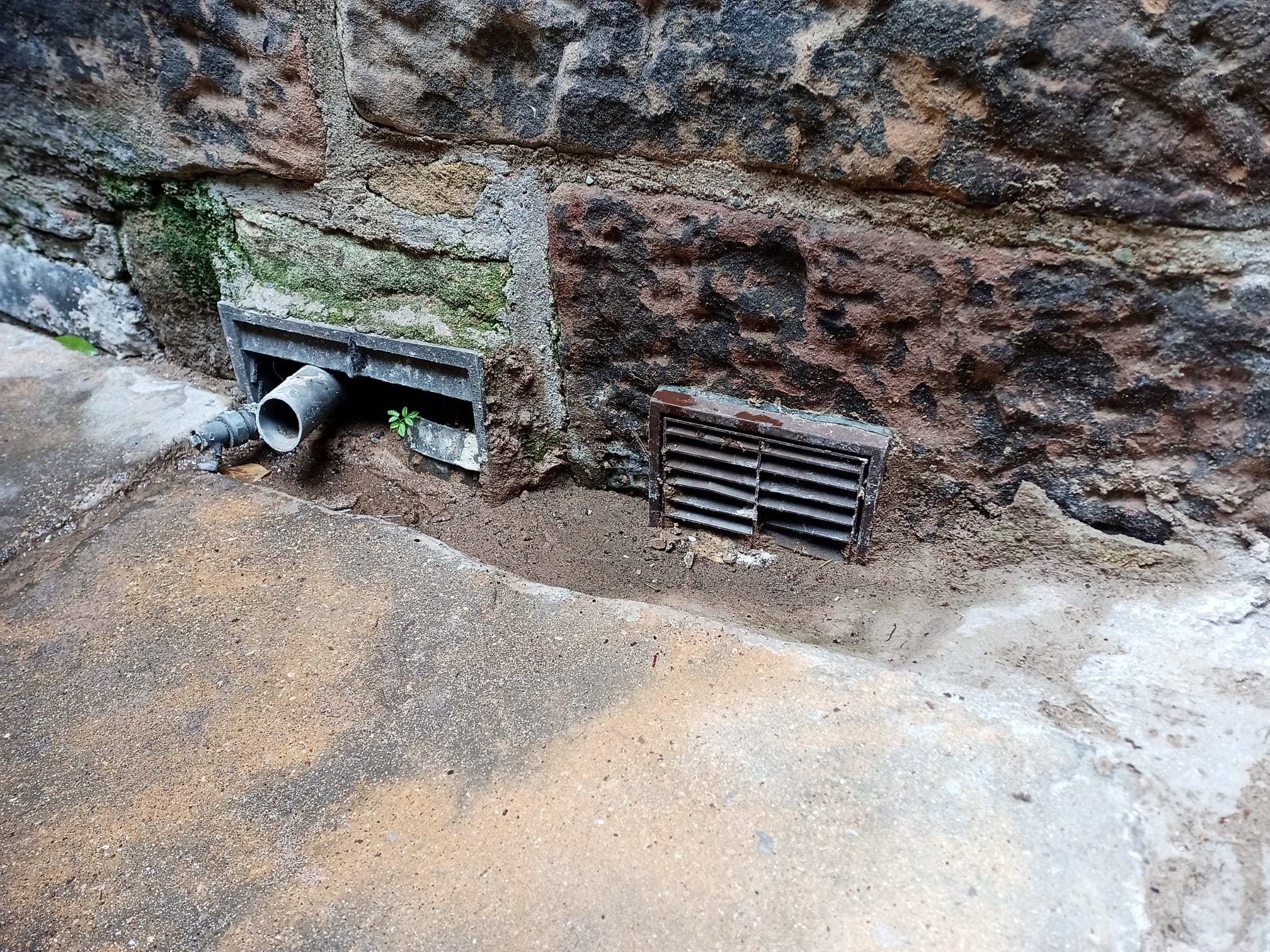

  2. Recently had a decaying bit of back patio behind our 1890s Edinburgh tenement taken up and relaid. Apparently there wasn't much under it before and by the time the guy (recommended by some gardeners we use) had put down a base he was happy to put it all back on, the whole thing was an inch or two higher than it had been before. Unfortunately that means there's now a dip around a couple of low vents in the back wall. One of them (on the right in the photos) is from the bathroom extractor (it runs down and under the kitchen floor behind this wall); I've no idea what the other one is. I noticed the dip had collected pooled water earlier this morning from heavy rain last night, although it had all disappeared (I hate to think where!) by the time I got round to taking the attached photos a few hours later. (The spirit level in the second photo is just something to make it easier to see how deep it is.) Any thoughts on how to deal with this? My first idea is to put some sort of little "hut" over it (with enough louvre to allow the vents to still vent) and make sure it's sealed enough around the sides to not allow water to flow in under it or down the walls. Open to other suggestions though. (And my Google-fu is not having much luck finding where I could buy such a thing ready made if they exist... just endless meter boxes and simple vent covers). Thanks for any ideas
