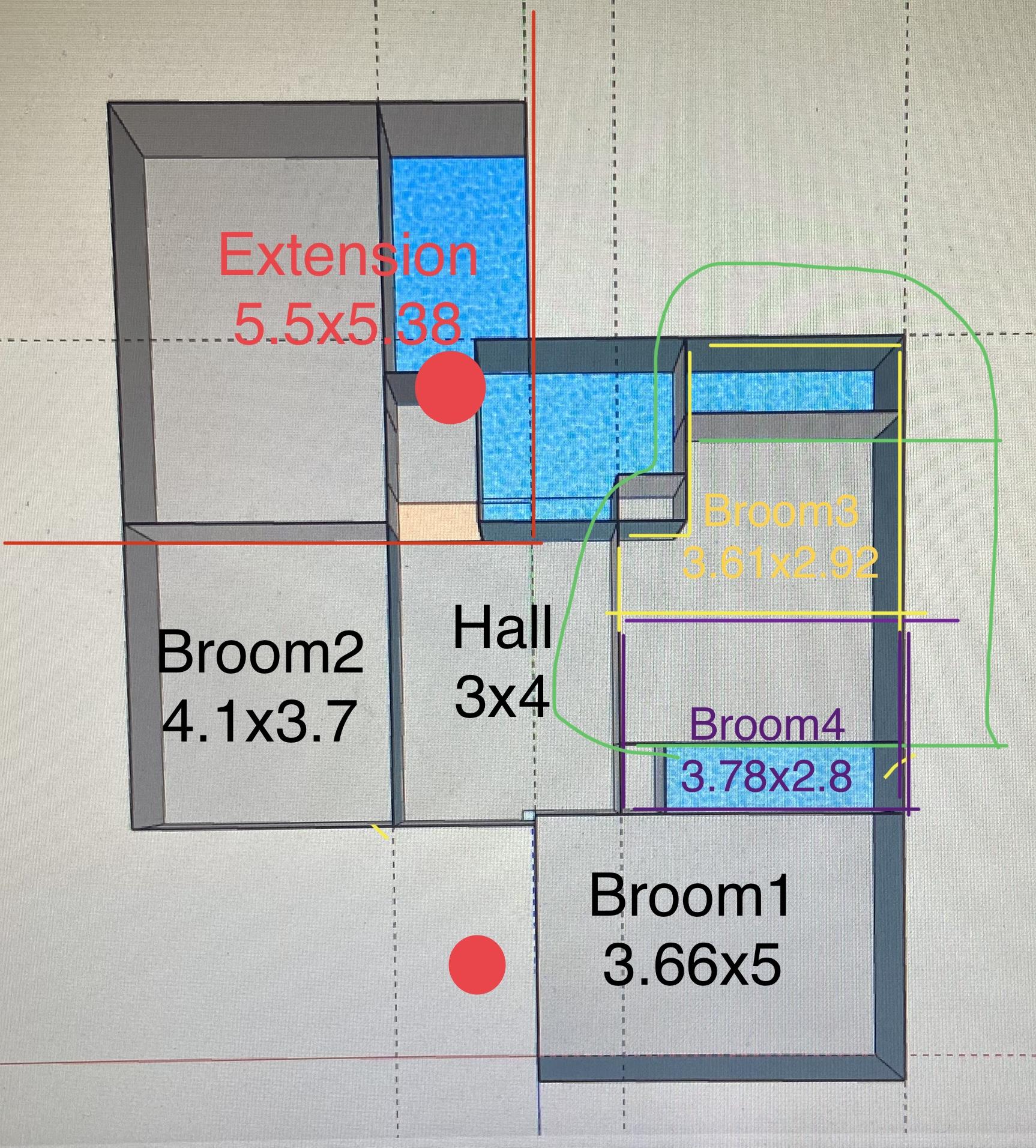

Bedroom 2 is quite large already (I don’t have measurements but I’d guess 4mx3.5m ish) my drawing makes it look small in comparison to the other side of the house. I had thought about extending the garage up originally (I assume it would have to be knocked down and re-built to make sure the foundations are ok). Making that area upstairs an en-suite and walk in dressing area off bedroom 2. That would also be extending the gable end of the roof which is easier by the sounds of things. Having a roof light downstairs is appealing too and we could come out further than the existing garage. -

I have thought about this - we could come out and make the 2nd living room a bedroom with en-suite, and re-arrange upstairs to add an en-suite but we’d be losing a bedroom upstairs so I wasn’t keen. Really I’d be happy with a single story upstairs ? but that’s a bit gravity defying. I also considered going into the loft as we have a large hall. But our eaves are too low. -

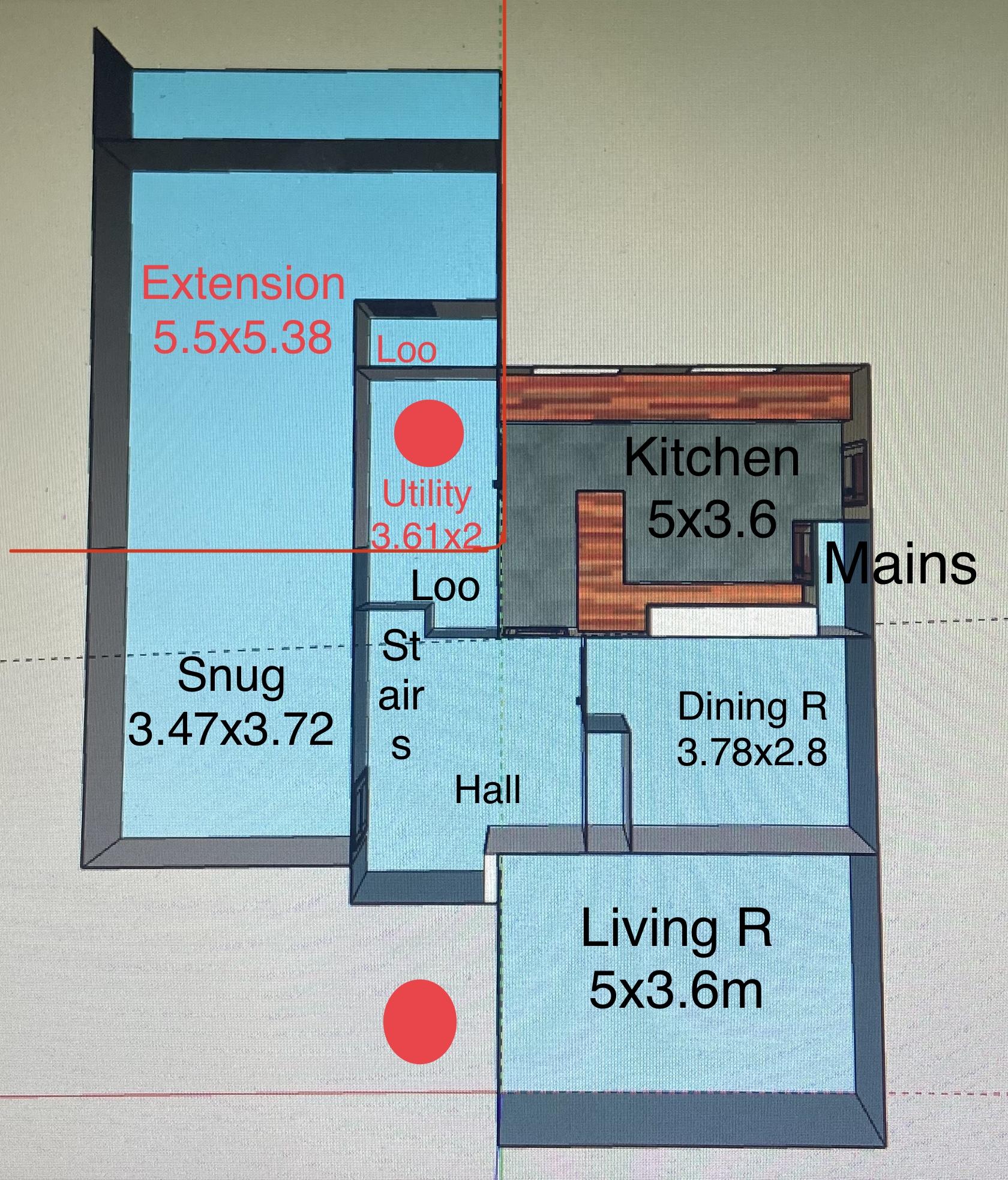

Hey - thank you. I understand that, but the space between the extension and garage would feel a bit wasted - maybe we could make it into a feature patio or something. Though the way the hall is set out we’d struggle with the upstairs layout I think if we extended that way. We have 4 nice sized bedrooms upstairs but only one small bathroom. Three teen girls! For the size of the house we just don’t have enough showers. So would like 2 en-suites and I’d love a walk in dressing area. Downstairs we’d like a large family kitchen/seat area. I’ve added some hand drawn sketches - I have done a sketch up but can’t access the account at the moment. The extension idea is 5.4m wide x 6m long. Bedroom 3 - 4x3.2m Bedroom 4 - 3.5x3.2m Bathroom - 2.5x2m (best guess based on standard bath length and width) LR - living room D - dining room S - snug (second living room) K - kitchen in the middle is the hall - stairs to the right and downstairs loo. we have access to the waste both at the rear and by the front door centrally - it runs under the house. The idea is to make the extension into the master bedroom with en-suite and walk in dressing room - husband would like a balcony, neighbours have one and we don’t over look anyone so I think that’s possible planning- wise. -

Like this? It’s not very clear - I’ve also added another wonderful sketch from me - rear is the bottom of the pic. -

Thanks for this! I hadn’t considered the light coming into the current kitchen window being over shadowed. Which is why an architect is needed ?! Our garden is north/north east facing and really big - around 55 meters long. We have a garage to the left of where the red extension would be already but that’s obviously single story. rear is the bottom of the pic I’ve attached - realised I’ve switched the perspective -

Morning all, posted my amazingly home drawn sketch up drawings a while back of my double storey extension design (rectangle). The husband wants to ‘wrap it around’ I think from my research so far this will be very costly. I was wondering if anyone had experience of doing this? It would be a rear extension (not side and back) but our home is T shaped - pic added. Red area is what I think we should do, green is what the husband would like - he’s got his eye on bifolds the whole way along the back. So we’d be taking off a corner of the house - I realise I’ll need experts but just was after any opinions to help make our initial decision. Would a rectangle be a Lot cheaper than wrap around? Any other comments more than welcome.
Hey ? I’m just in the process of finding an architect now to discuss the space. Yes we need 4 bedrooms.
Afternoon, I posted late last year to start but can’t seem to find my original post. I’ve used sketch up to show the house as it is now and overlaid the extension plan. Main issue is that there is one small family bathroom which is really out of sync with the size of the house. Red dots indicate the manholes they link under the house - so we’ll have to move the one in the back garden out further. We toyed with the idea of a wrap around extension so coming out and across the front of the existing kitchen - but that would involve taking down a corner of the house which I imagine will add a lot of cost and expertise needed for the build. I was wondering if anyone had any layout ideas that might differ to mine? Particularly where I’ve suggested bedroom 3&4 are merged and a small en-suite added to bedroom 1 - there’s no outside wall access to drainage. There is a chimney breast between bedrooms 3&4 which will have to be removed.
