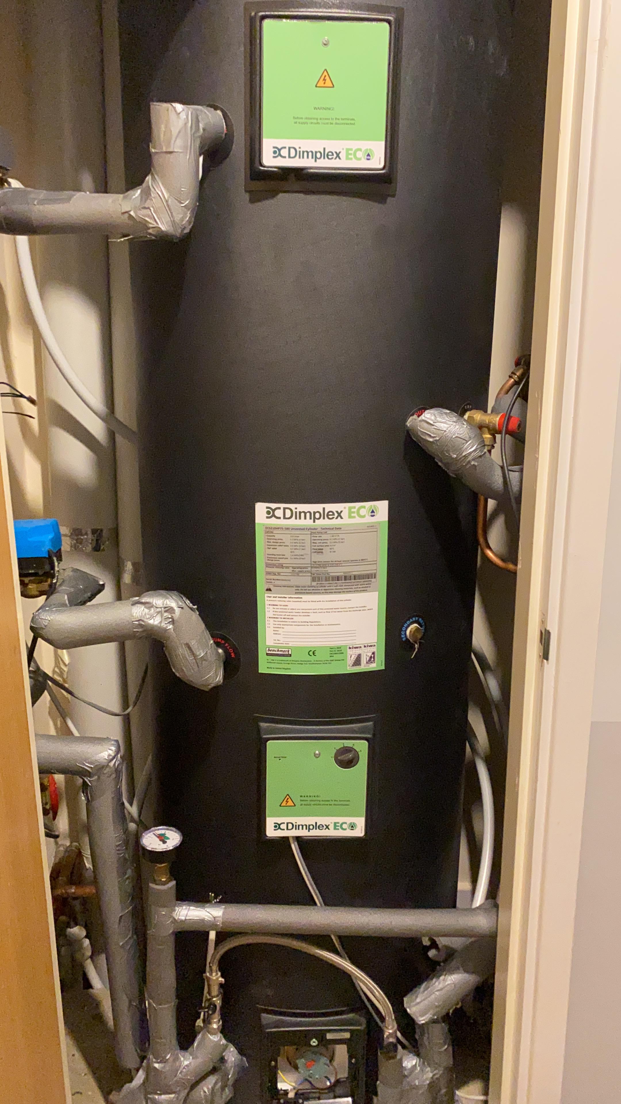

  4. There is an immersion yes but I wasn't sure if this was a separate part of the tank and not to be used, not sure why this wasn't wired in by the original installer.

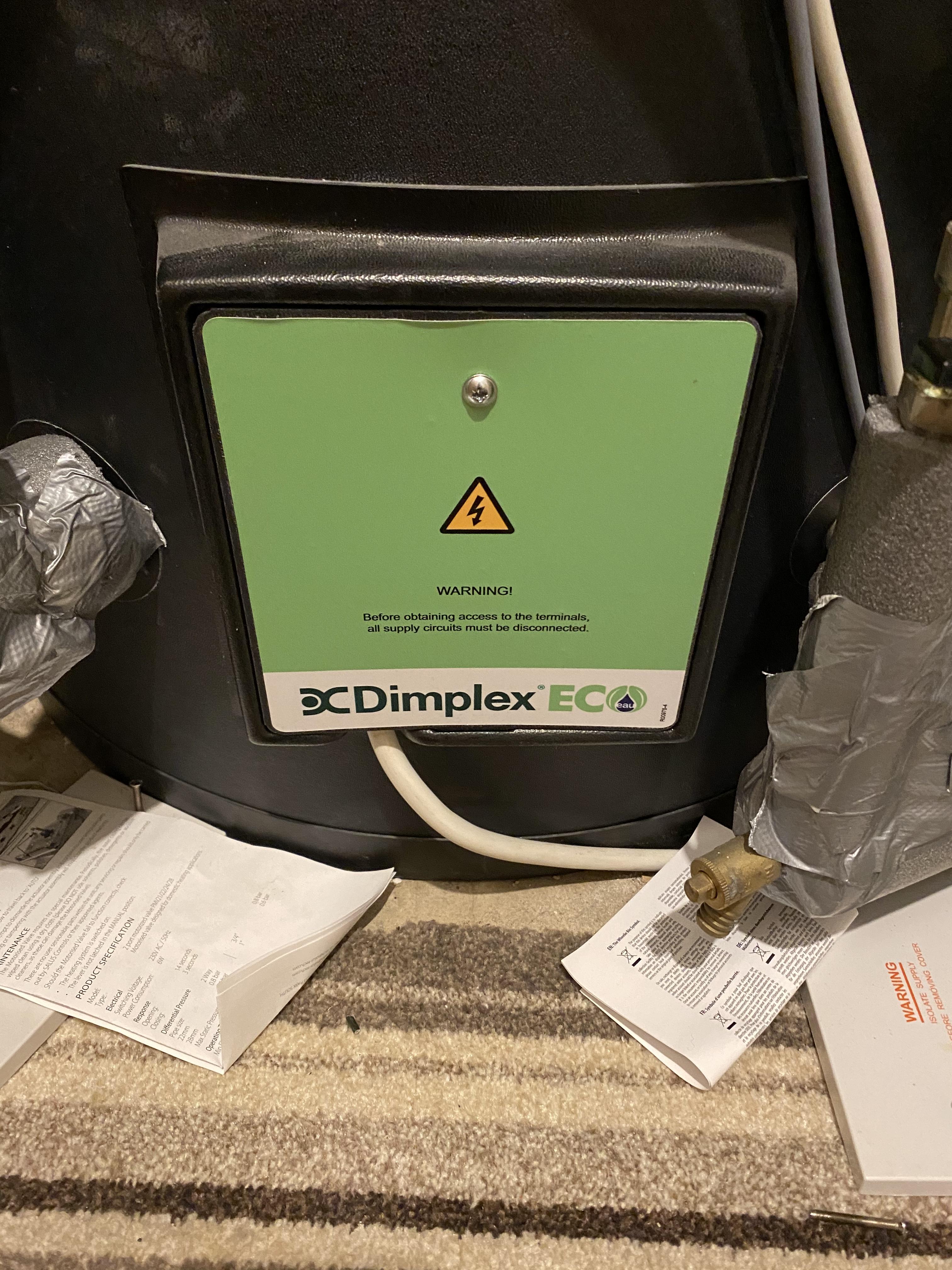

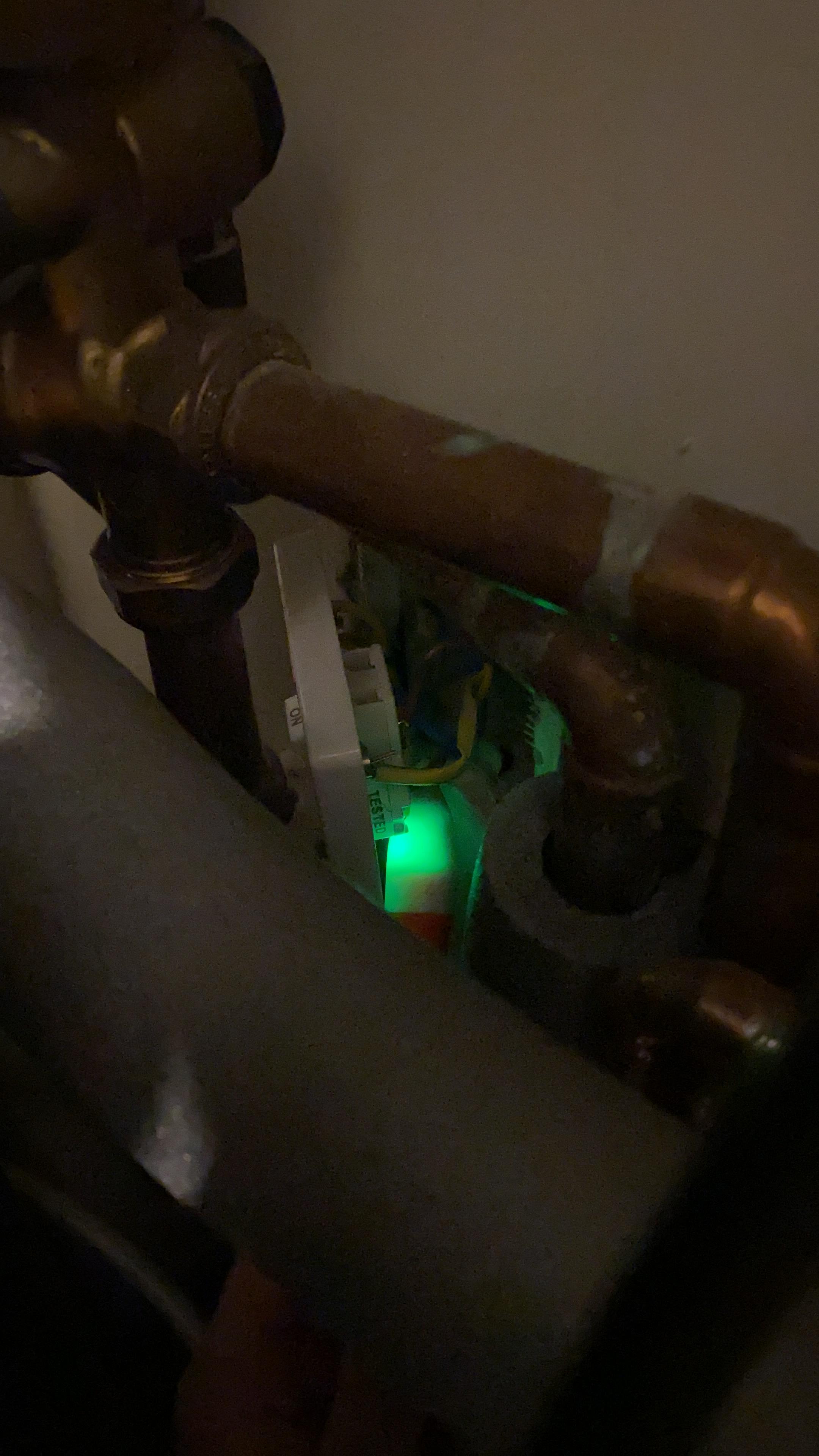

  7. Sorry that tank picture didn’t actually show the immersion cable leaving the tank, it just showed the sensor ones above it This cable in this picture goes to a fused spur on the wall which doesn’t appear live, which I assume is because the ASHP is dead.

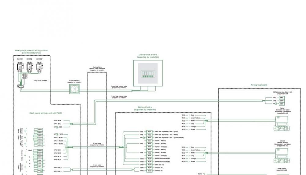

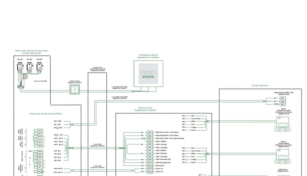

  8. Thank you all for the help, I assumed that the idea behind the immersion was for a separate source of power in case of emergency. The wiring diagram in the ASHP manual does show a 3 core cable going to the immersion. the cable going from the immersion in the cupboard does go to a switch on the wall but there doesn’t seem to be any power coming from it at all (my basis of this is the voltage testing pen hovering over it and staying green) There is no ‘immersion’ RCD switch on the Consumer Unit, just one for central heating and one for ASHP. So it’s definitely not on its own circuit. I have attached some photos that I hope will help. thanks
  9. Hoping someone can help. Waiting for a Dimplex engineer to come and diagnose a problem in my LA-6 ASHP. There is no power coming from the unit (A PCB may be fried but thats another story) The problem is that I think the DHW unvented tank immersion is powered by the ASHP (or not powered in this case) so currently I have no heating OR hot water. Is this normal setup and is there anything I can do temporarily to get hot water? thanks in advance Buzz
