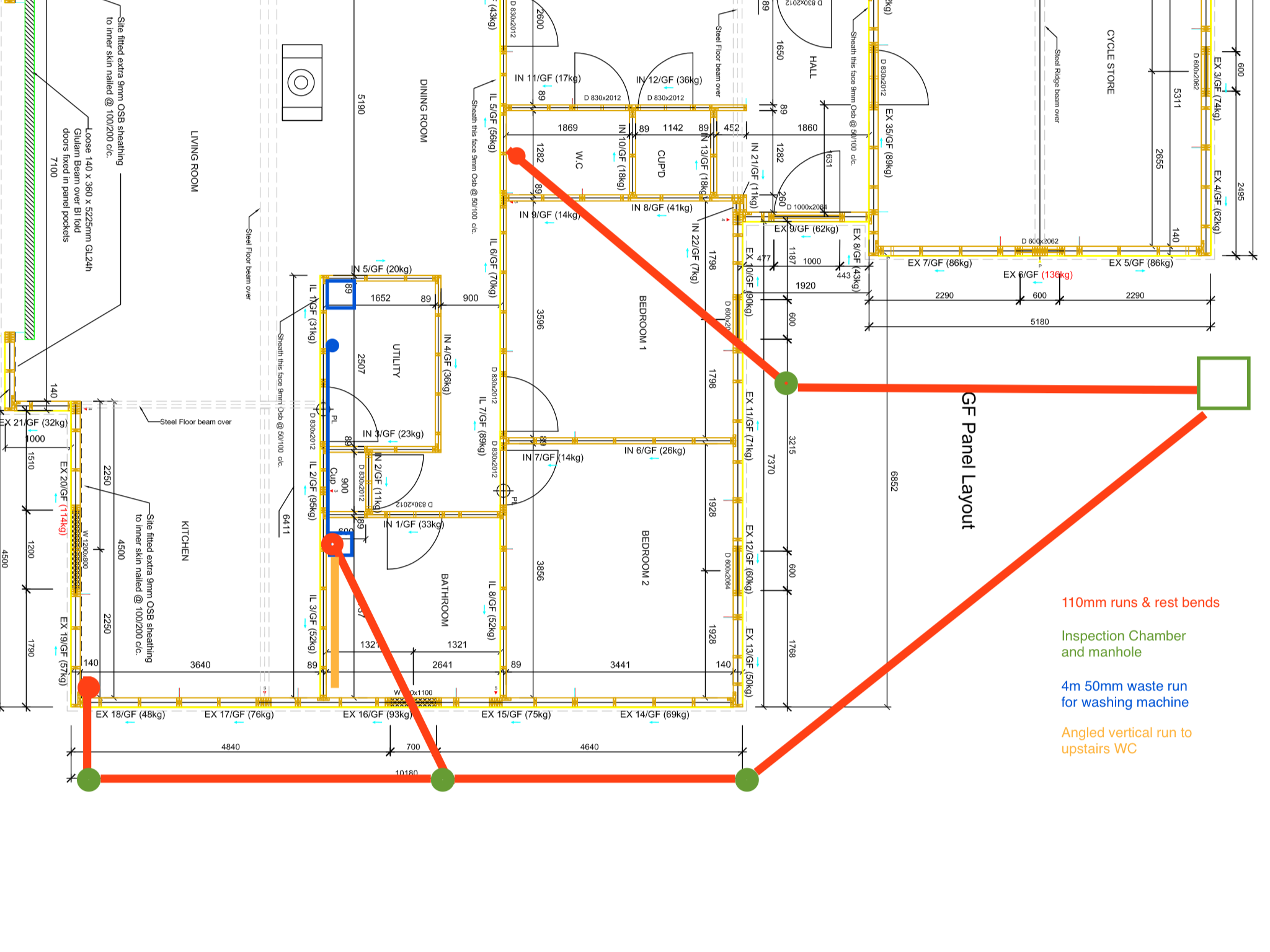

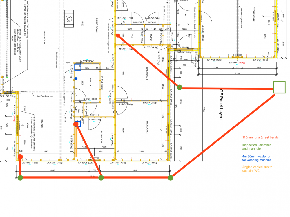

Hi, Apologies that this is probably a very basic question, at least I hope it is. Please see my rough drainage plan ahead of beam and block attached, would appreciate any suggestions/feedback. I think I may be able to lose one of the inspection chambers with either a sweeping bend or by coming out further to allow a straight run. My main query is that the two soil pipes entering the inspection chambers in line will exit the build at the same height, I need the fall between the 2 inspection chambers to be around 130mm to maintain 1:40. Is the correct/best way to do this to increase the drop just prior to entering the inspection chamber using a 45 degree angle? I'm trying to visualise this and just want to think ahead before putting soil pipe in place under b&b. Thanks!

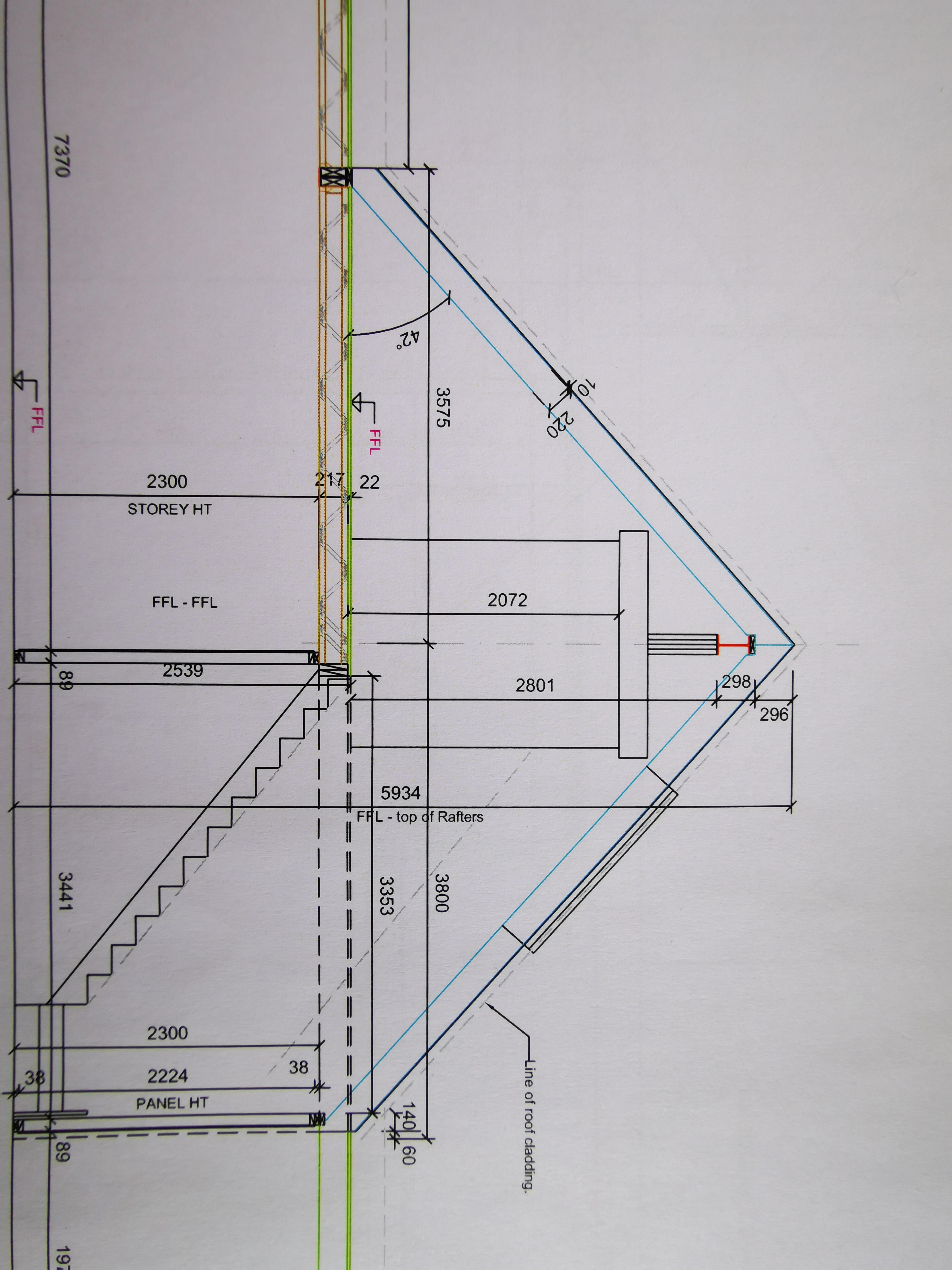

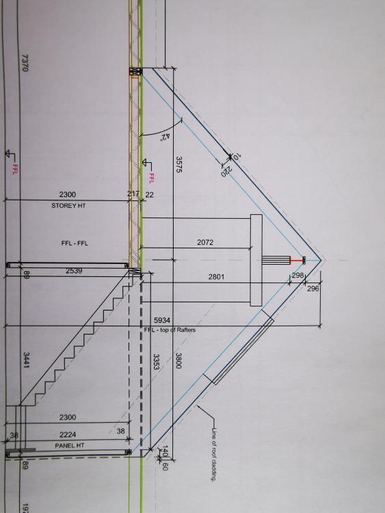

Thank you both, I think I'm comfortable enough that we can make this work without having to incur fees for changing the timber frame design. My key concern was if I'd missed something that would present a problem with no solution, as long as there is a viable and practical solution I can work through the detail. Cheers. -
Afternoon all, I've been reviewing our prelim drawings for our timber frame build, one area I'm looking at is how the pitched roof will meet the flat roof. Build is essentially a bungalow with mezzanine used for bedroom/dressing/bathroom. Plan is for warm deck with EDPM and extensive living roof but will the pitched roof effectively meeting the flat roof (attached) cause an issue? Can't visualise how it will work and initially thought there would be a drop down and the pitched roof would have independent guttering. I'd rather look ahead and change this now than deal with a bigger headache... if it is one! Many Thanks.
