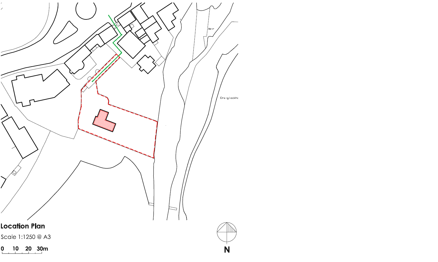

  2. Thanks all for the helpful responses. The build has turned into a bit of a nightmare after the access we had negotiated through the neighbouring flats finished. We were delayed during covid and we lost the window of easier access. Now trying to make an alternative plan. With ICF I don't think it would make sense batch mix or pour without a pump. I had hope a line pump could be viable and using elevated scaffolding to hold the line above to pouring level. However, I am aware this can be problematic pumping the concrete up to height. Its a fairly large build with a lot of concrete so maybe the only options would be to explore the spider boom option. Or go with a labour intensive method like Stick built, but it's been difficult finding contractors who are keen to hump everything into the site. Some SIPS companies are happy enough to bring in slightly smaller SIPS to the site, and use a tele-handler to erect, but still not without its complications. @Nick Laslett, thanks so much for finding those Spider booms, I had been looking all over and hadn't found anything similar. They could potentially be the a viable option provided I could get one up to Scotland for a reasonable price. I have options to pump concrete from the street through the lane and potentially through from the flats WNW of our house's location, I will explore with those providers and see if they can help.
  3. Hello All, I am wondering if anyone would be able to offer some support. We had a quote from an ICF provider and he seemed keen to take on the project. However, it now seems he doesn't want to continue due to fact our site has limited access and we won't be able to get a boom pump in. The winding access lane is big enough to get a JCB / Big transit in but thats about it. We have loading bays and space to pump concrete from the main road using a line pump to the site but no way I can see to get a boom pump close enough to lift the line to pour the ICF walls. The longest section to pump would be around 90m from the road and the second floor walls are 7.3m high. So I was assuming we would have been able to pump it in with a traditional pump and supporting the weight of the pipe with scaffolding during the pour. I have heard of people using a line pump and supporting with scaffolding. Has anyone done this and can vouch for feasibility? Or has anyone got any better solutions. Picture of the site attached with the green line showing the standard access route. Many thanks for any responses.
