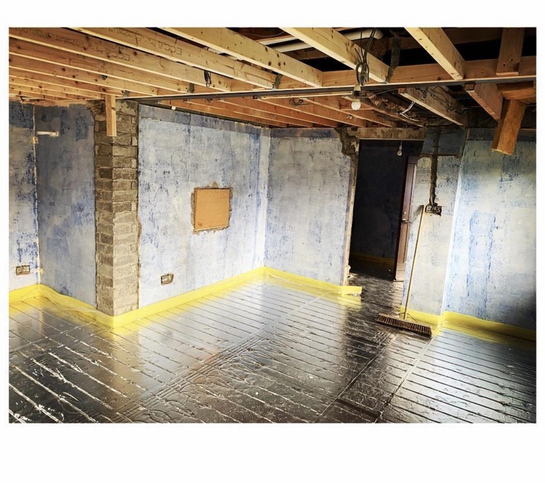

UFH 8 zone Heatmiser System Under Floorboards
AshleyH replied to AshleyH's topic in Underfloor Heating
Got to be honest I don’t think the laid that first? Would the insulation board the pipes are run through do the same thing no? We did last winter when we left the set point constant, we’ll give it ago this winter see how we get on. I’ll keep an eye on how much gas usage we use going forward. Thanks for the info you’ve passed on it been great. I’ll keep you updated!- 57 replies

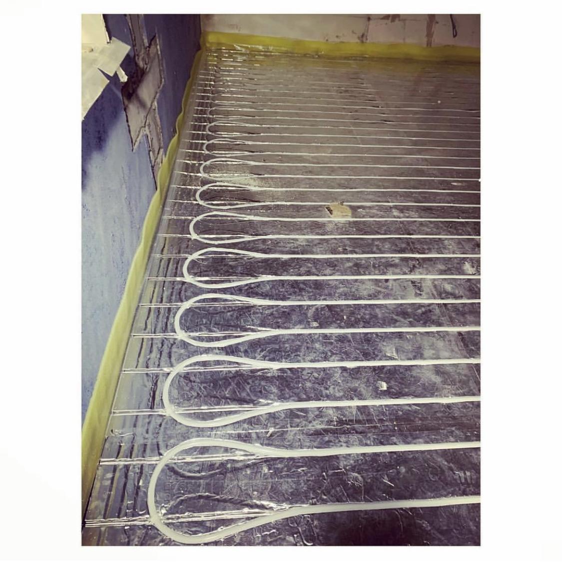

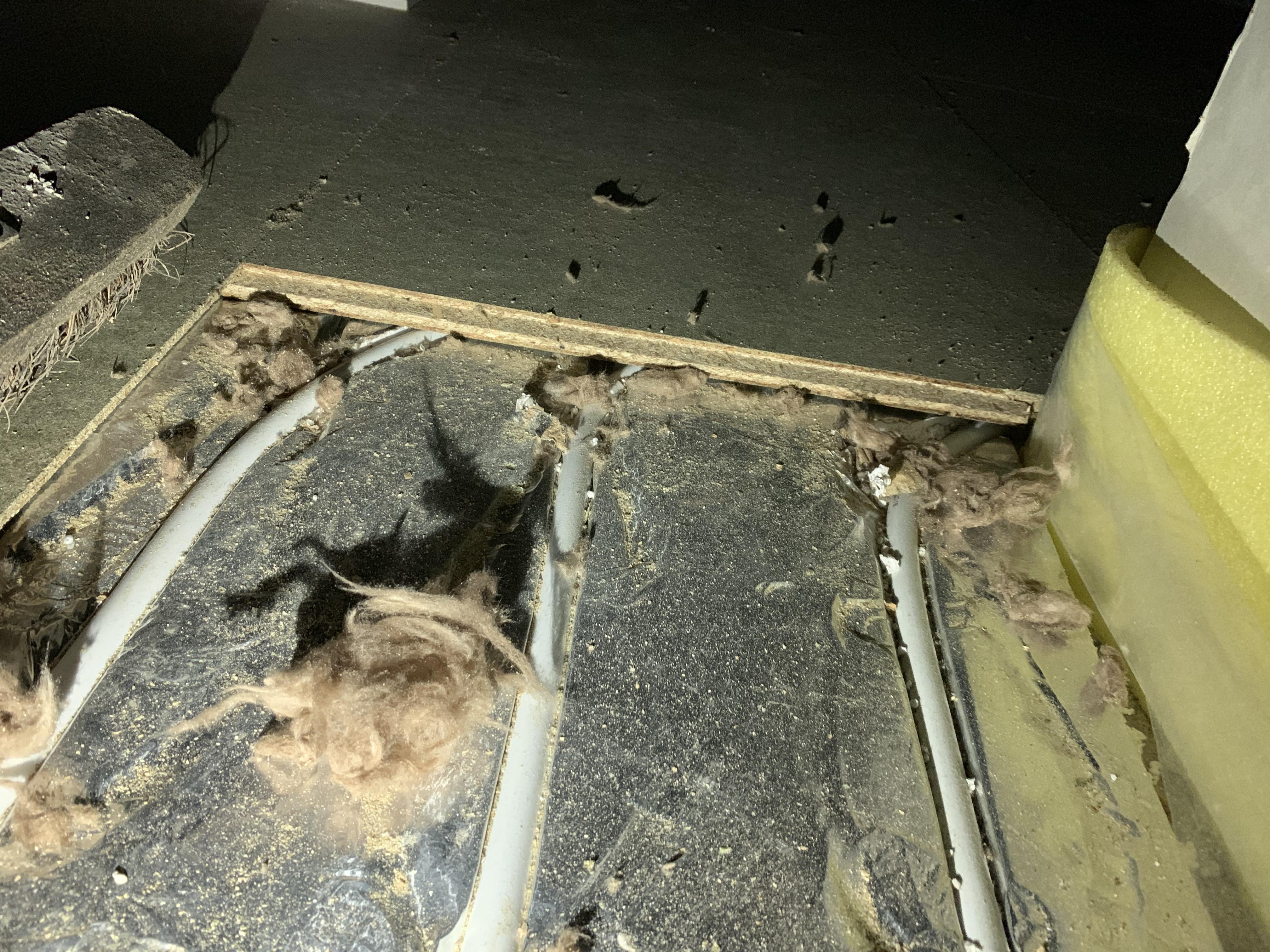

so basically the house was totally renovated, the concrete floor were left and they used insulation boards to run the UFH pipes in, tbh I don’t think they put any insulation underneath the boards? Not that I’m aware of anyway? Could be wrong? Then the floorboards, ply and finished floor. yes I remember them worry about head height so that’s a possibility! There’s no chance I can get the flooring up now to get insulation underneath the boards ?- 57 replies
- underfloor heating
- ufh
(and 1 more)
Tagged with:

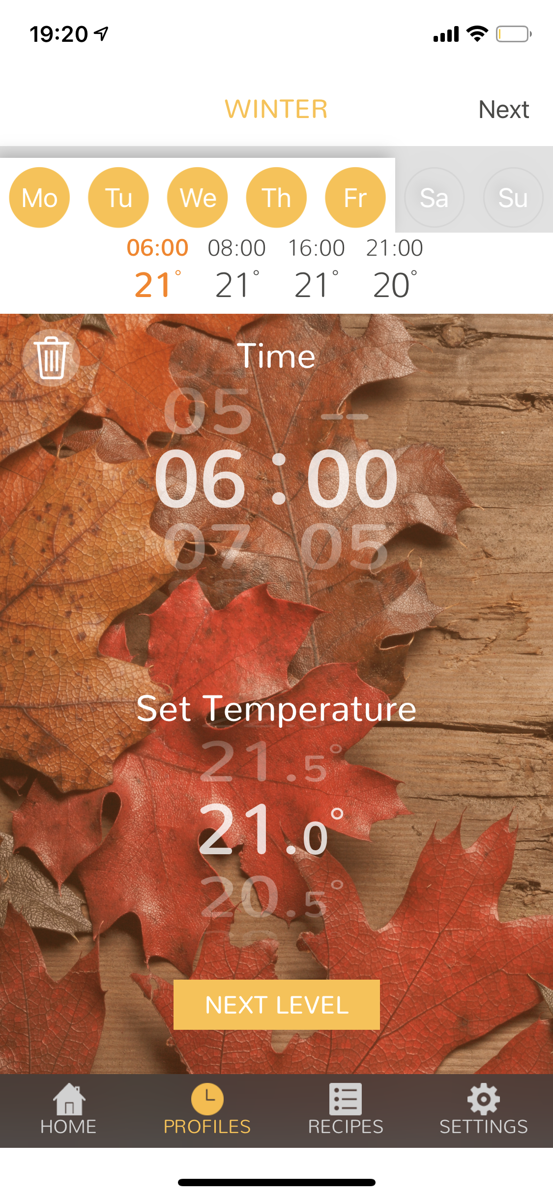

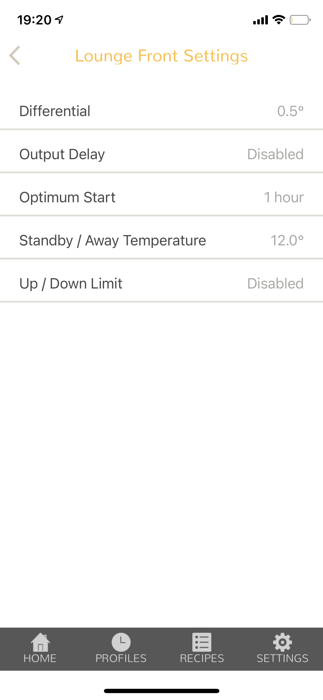

Thanks for the info, what’s your differential set to 0.5? Yeah I set them to this so it would be warm by 7/8 and 5/6 when we were home? Should I keep the overnight temp up overnight and throughout the say even when we aren’t here? I just don’t want to be wasting energy? Do you drop your overnight temp at all?- 57 replies
- ufh
(and 1 more)
Tagged with:

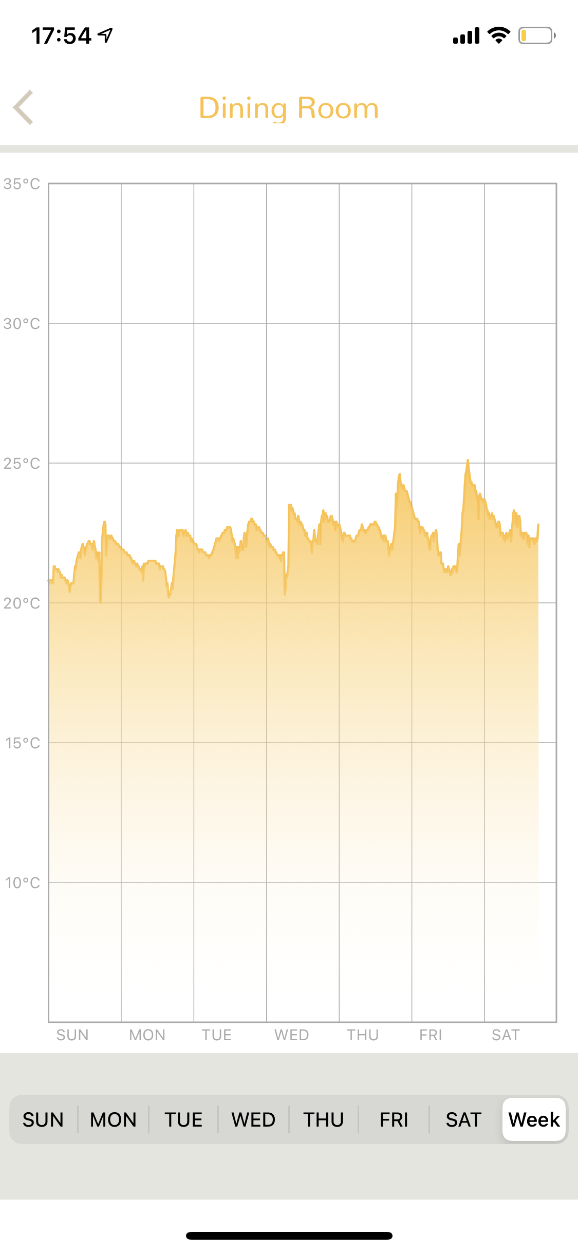

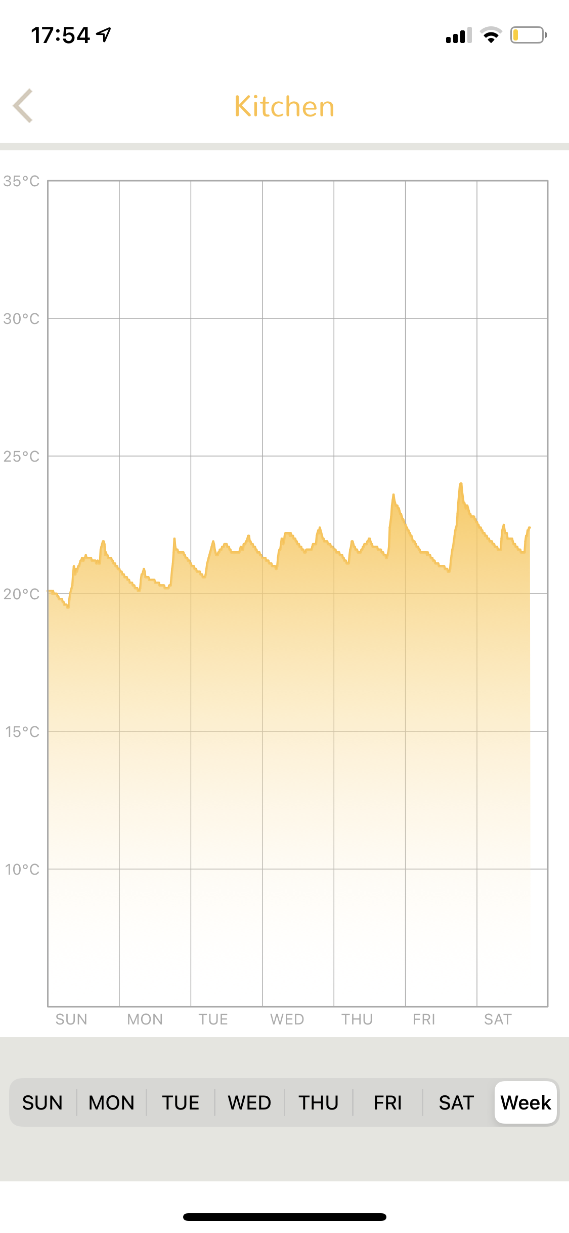

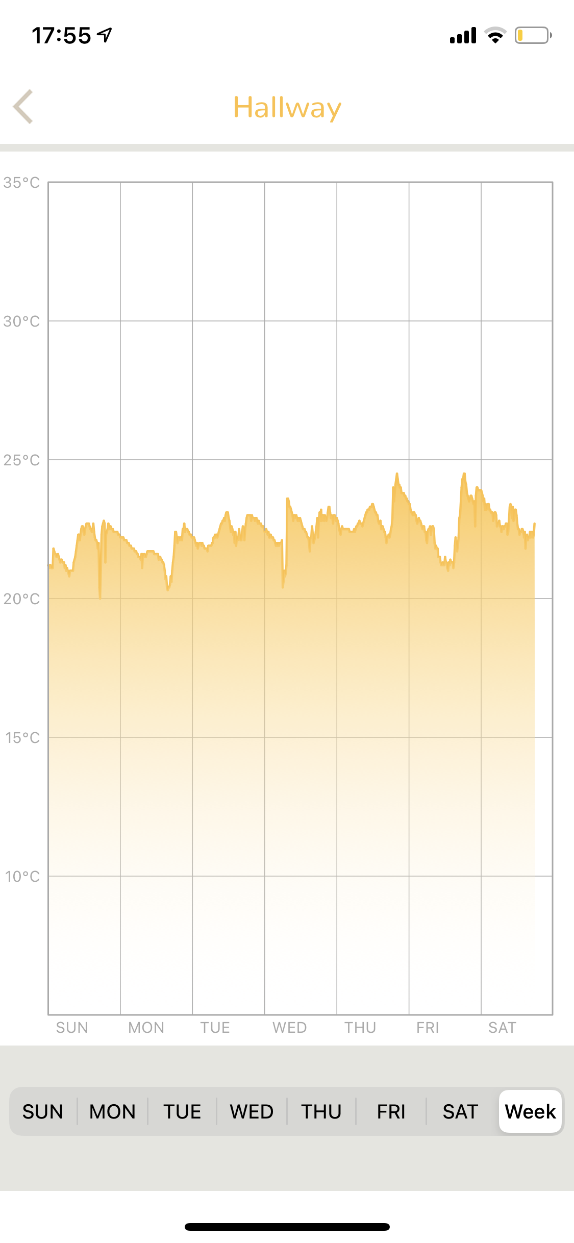

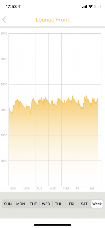

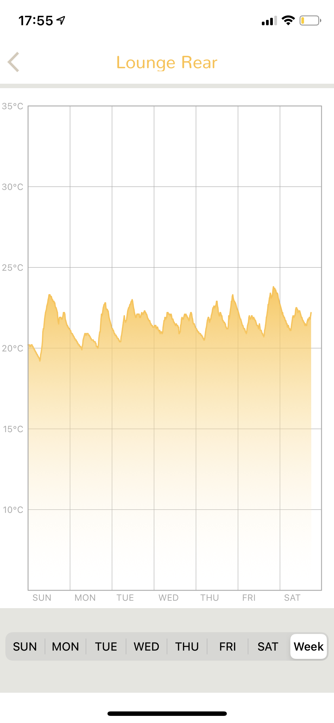

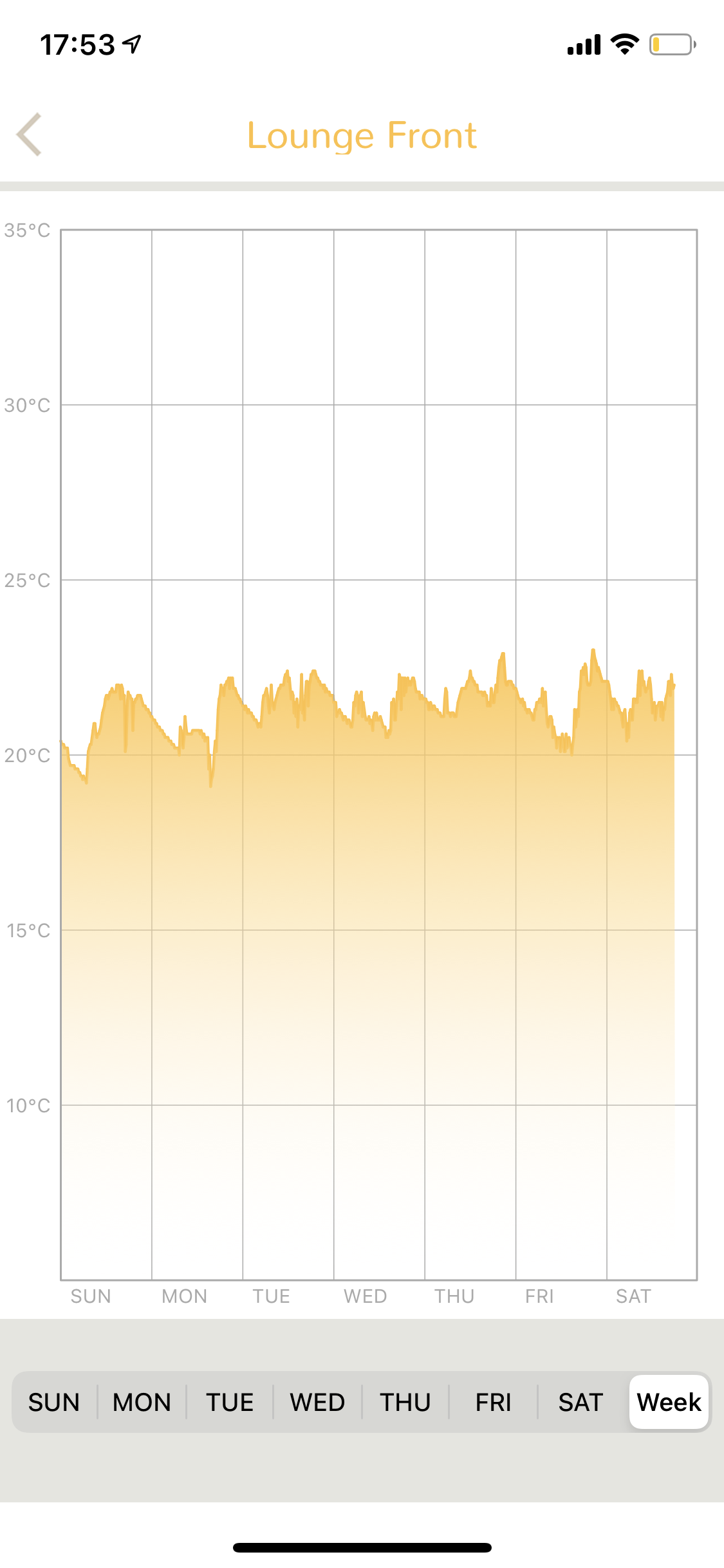

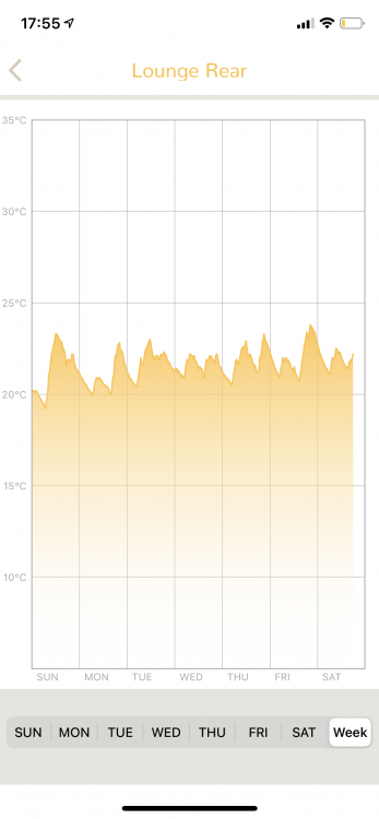

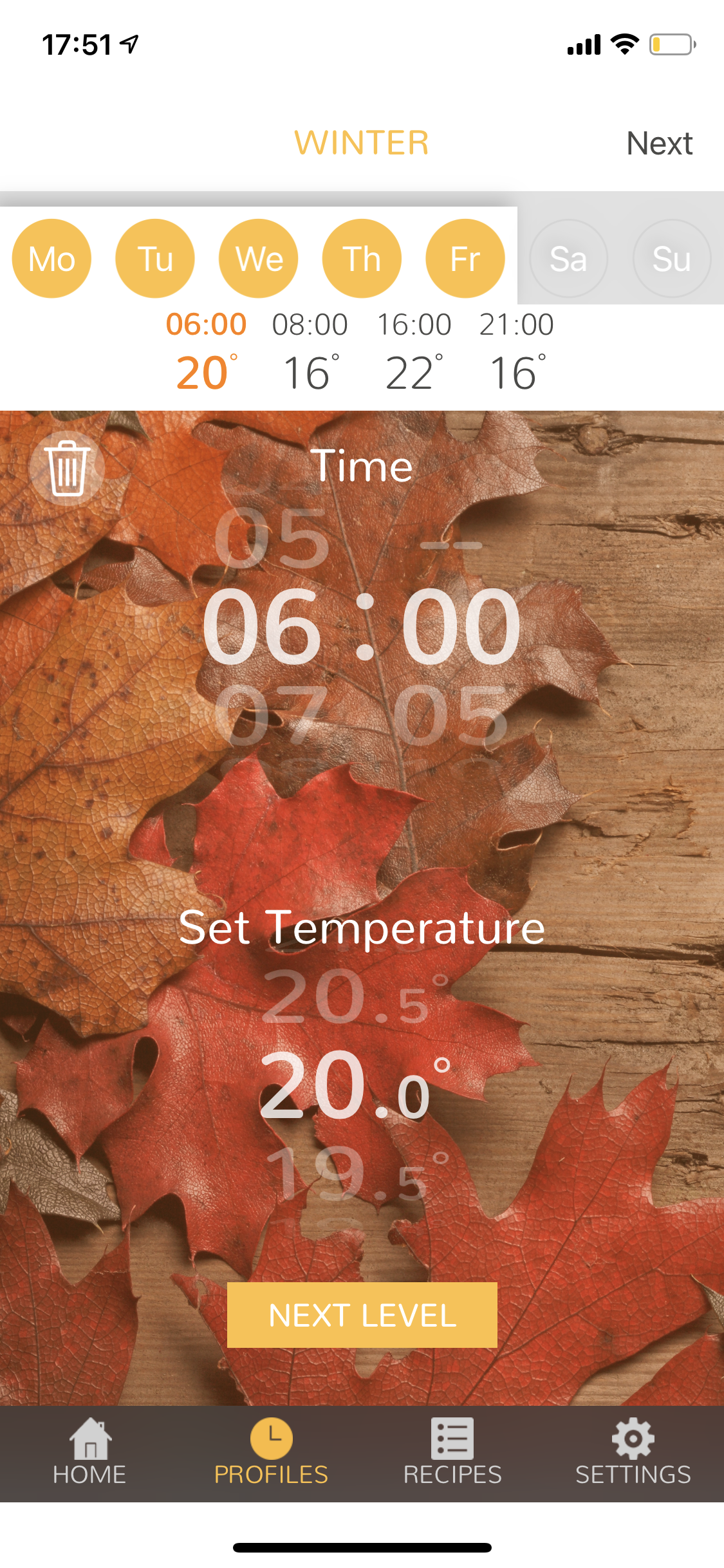

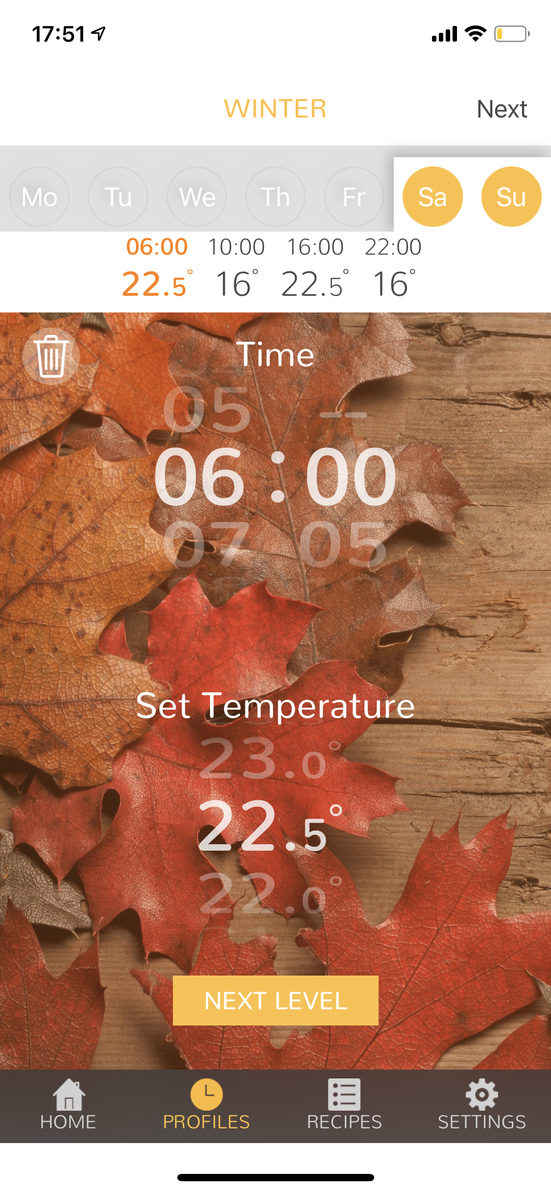

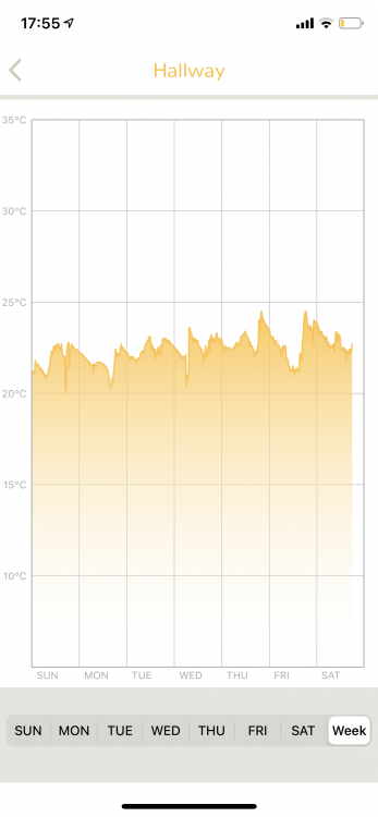

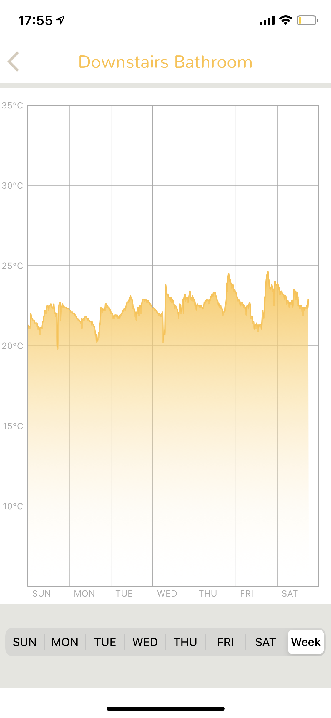

thanks for the info, I’ve attached the trends over the last week, baring in mind there are some sharp spikes where I have been playing around with it! Also I’ve attached the profile I’m using, we aren’t in the house during the days only in the evenings so I’ve set it to heat up as below? Would this be more energy efficient?- 57 replies
- ufh
(and 1 more)
Tagged with:

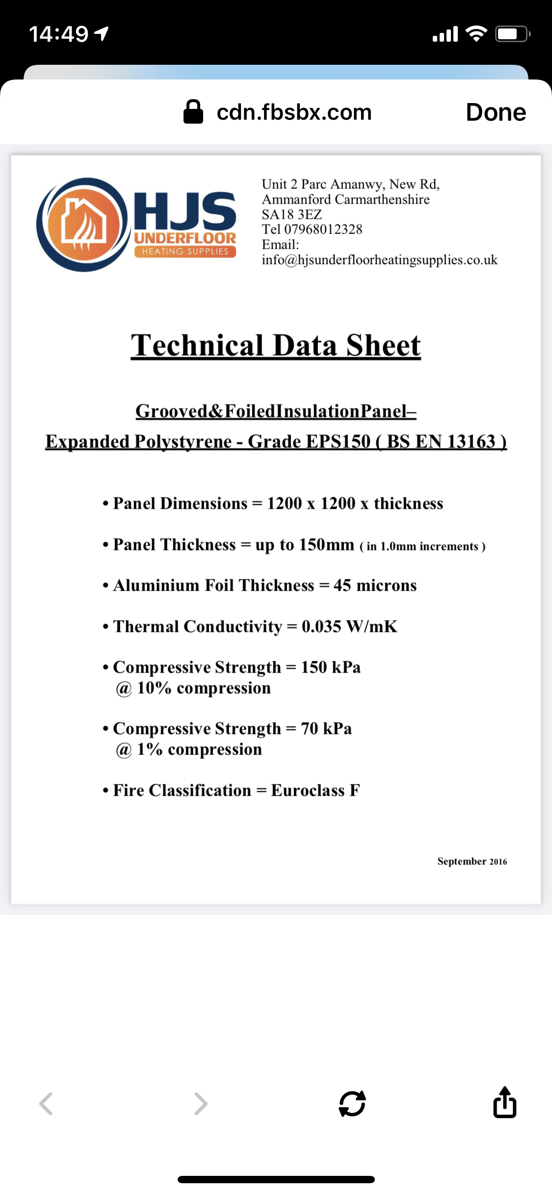

it was laid onto the concrete floor I believe but that was the Same throughout. I’m not sure what Thickness it was it was supplied with the kit. im not sure tbh, I thought the idea of the boards was to deflect the heat up? I reckon it could have something to do with the room which isn’t the warmest doesn’t have anything above it, all the other rooms have rooms above them? Possibly why the heat isn’t holding well? It’s still warm just not as warm as the others? I have found though a slower flow rate heats the room up better?- 57 replies

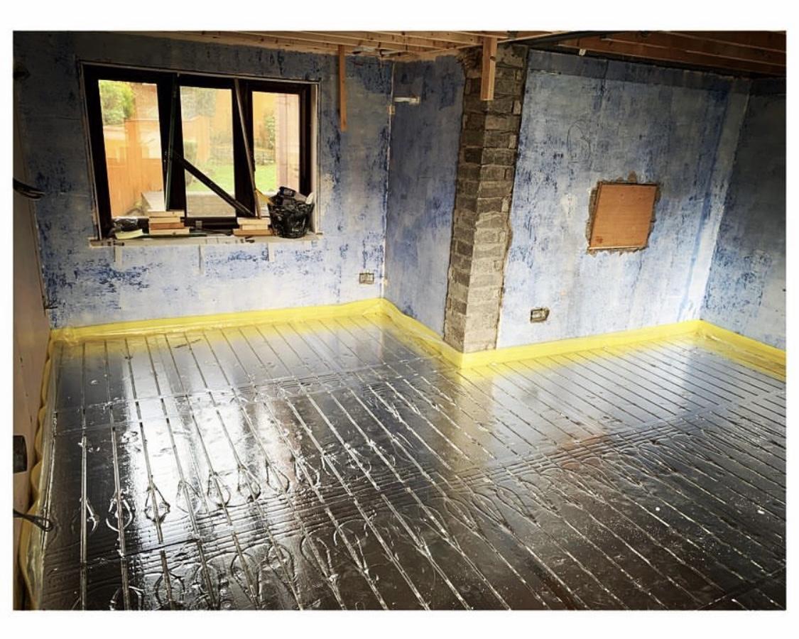

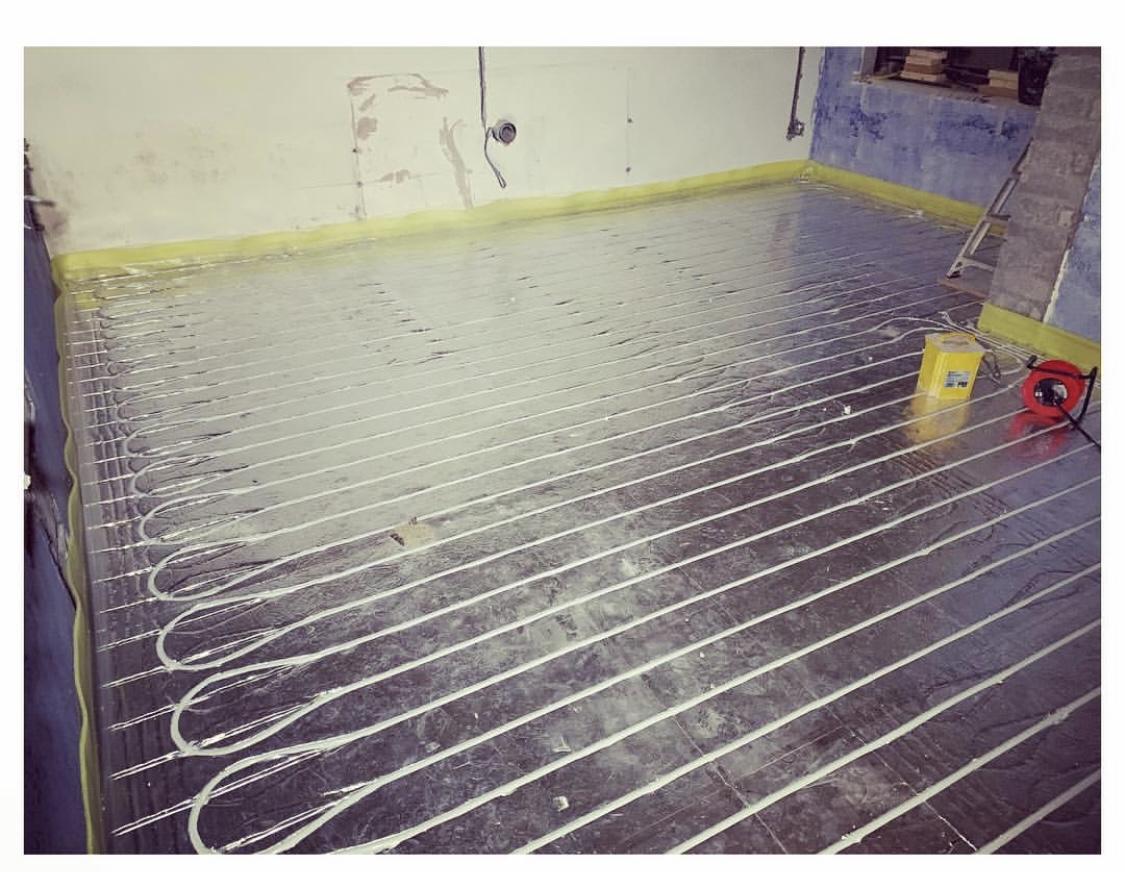

This is the ground floor, we renovated and used the thermo insulation board which the pipes are run in, ontop of that we laid floorboards throughout and played over the top for the tiles and wooden flooring.- 57 replies
- ufh
(and 1 more)
Tagged with:
