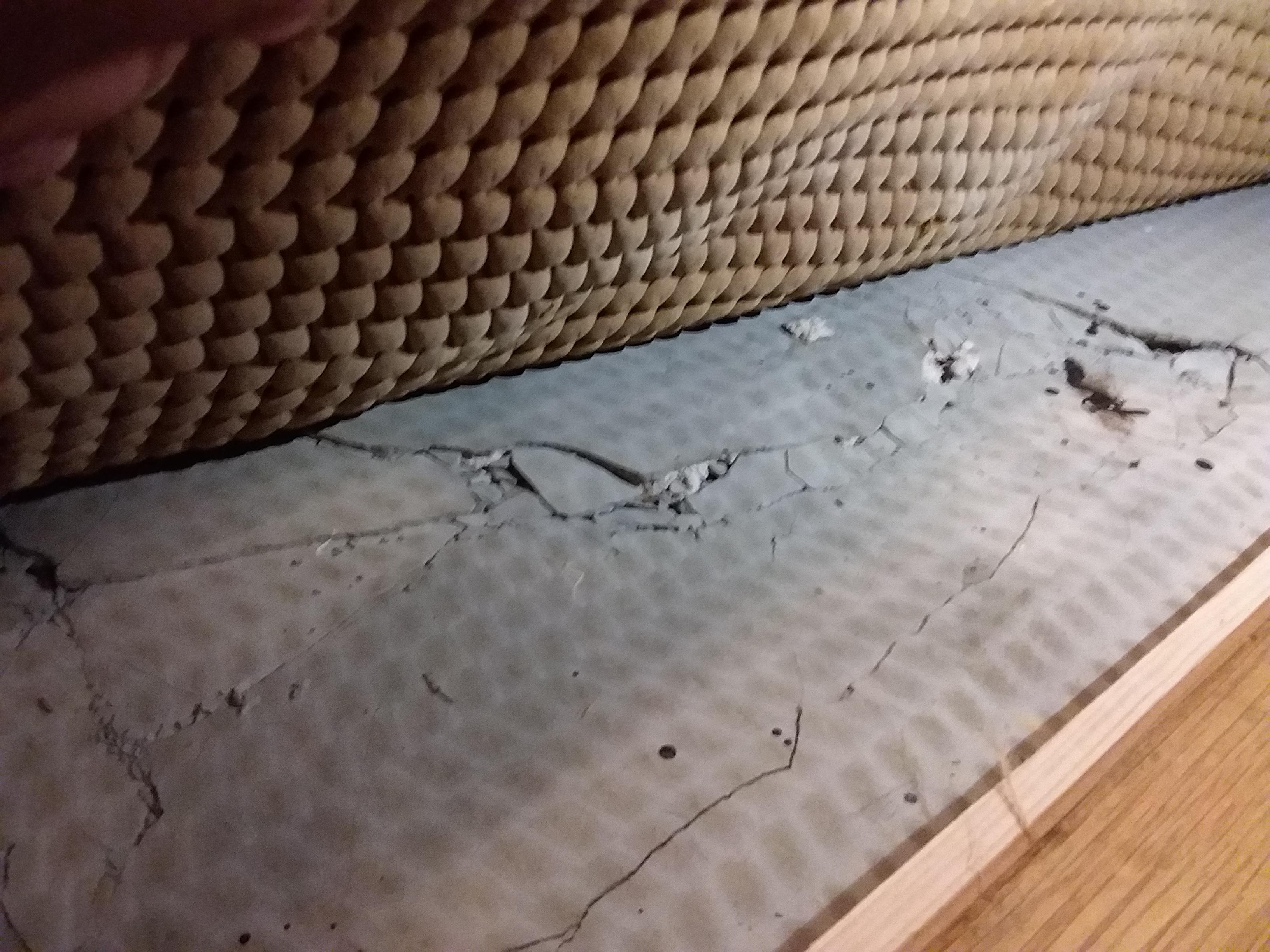

SKB's Achievements

  1. Hi Ian, thanks how much would it cost in your opinion? My living room size is 6.5 m length and 3.6m width. Hi Nod, the brick work and plaster have no cracks at all. I have checked both internally and externally.
  2. Would you suggest digging down in areas where there are dips to see if there is an issue with the concrete slab? If no issue then would you suggest laying fibre screed?
  3. We think it could be a compacting issue, it's hard to tell as we never did this extension. The previous owners did. We've lived here for 5 years and have noticed more dips and cracks appearing. The worrying bit are the dips that are appearing. We've been given advice to dig down a section and see if it's affected the concrete slab.
