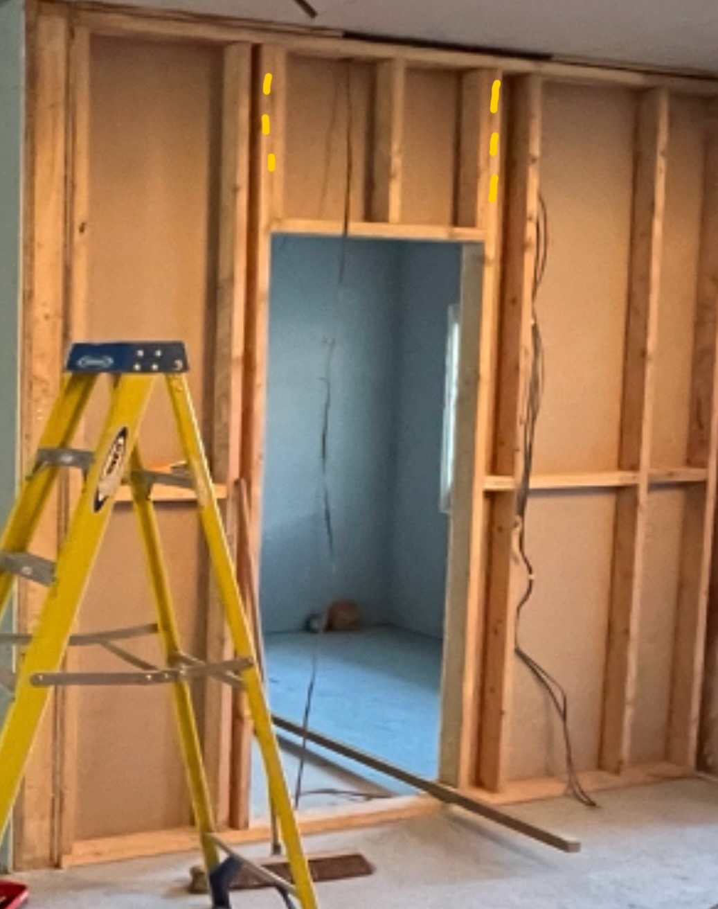

Hi! I am wanting to install a pull-up bar on an internal non-load bearing wall above the door frame but not sure if it will take the load. I’m about 70kg. I would be looking to attach it to the long vertical studs that run up from the sides of the door frame as see below: The wall itself is a 45mm x 95mm non-load bearing panel. The pull up bar attaches like so with holes 170mm apart: any advice most appreciated!

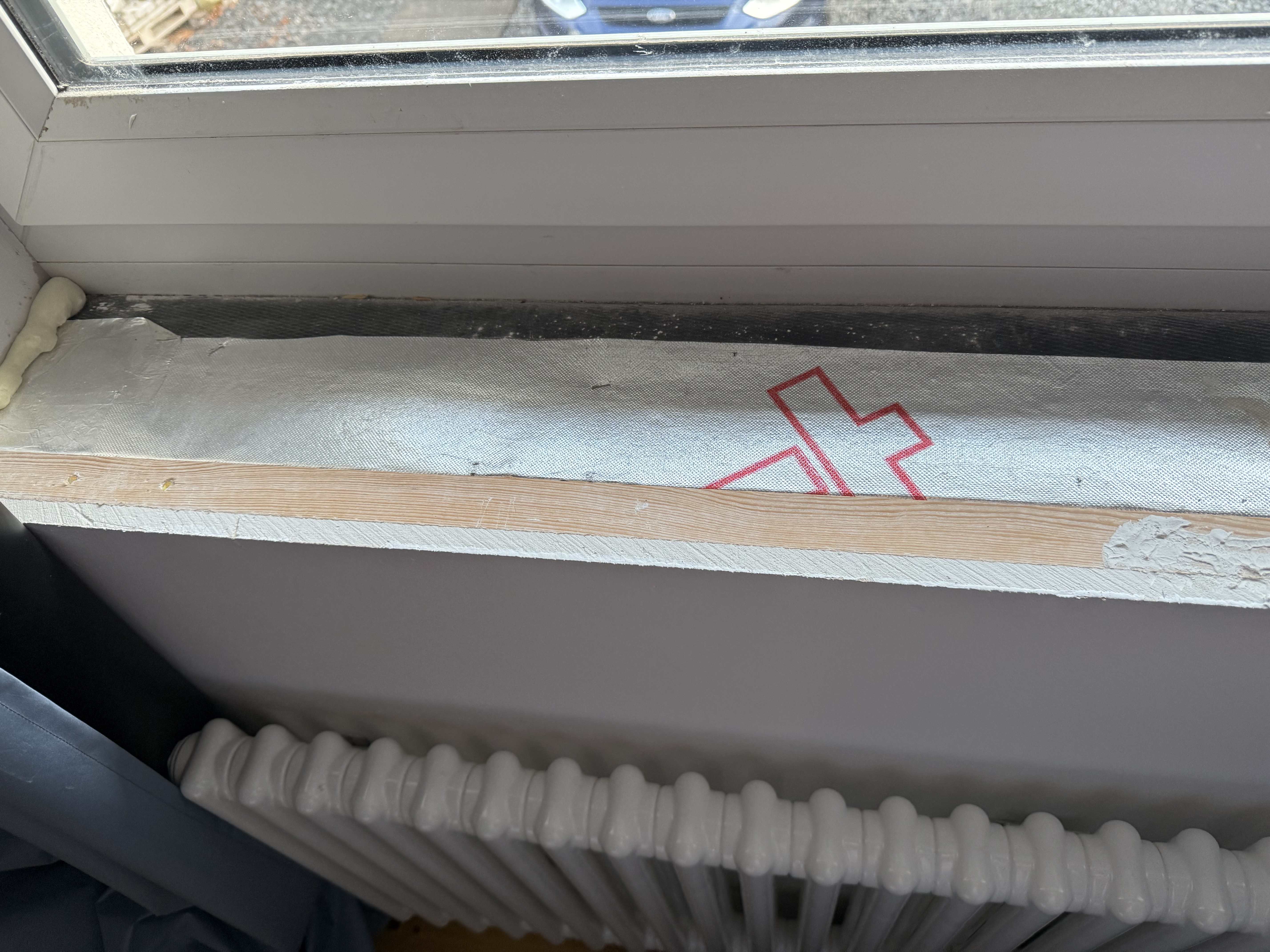

I reckon it’s just the silver breather as you say. From what I can see there is no cavity. There were gaps left and right between the vertical plasterboard at the sides of the window and the sill which I filled up with foam which you can see in the photo as there were draughts coming through there but everything else was fine. I read a note from our timber frame company that asks is what type of paslode nail we want to fix the sills. So I guess they suggest we nail them?! -

Thanks for your reply - no gap into the cavity, just (im assuming) some black DPC. So you would put some plasterboard flat on top, screw it down and then stick down with glue/adhesive? -

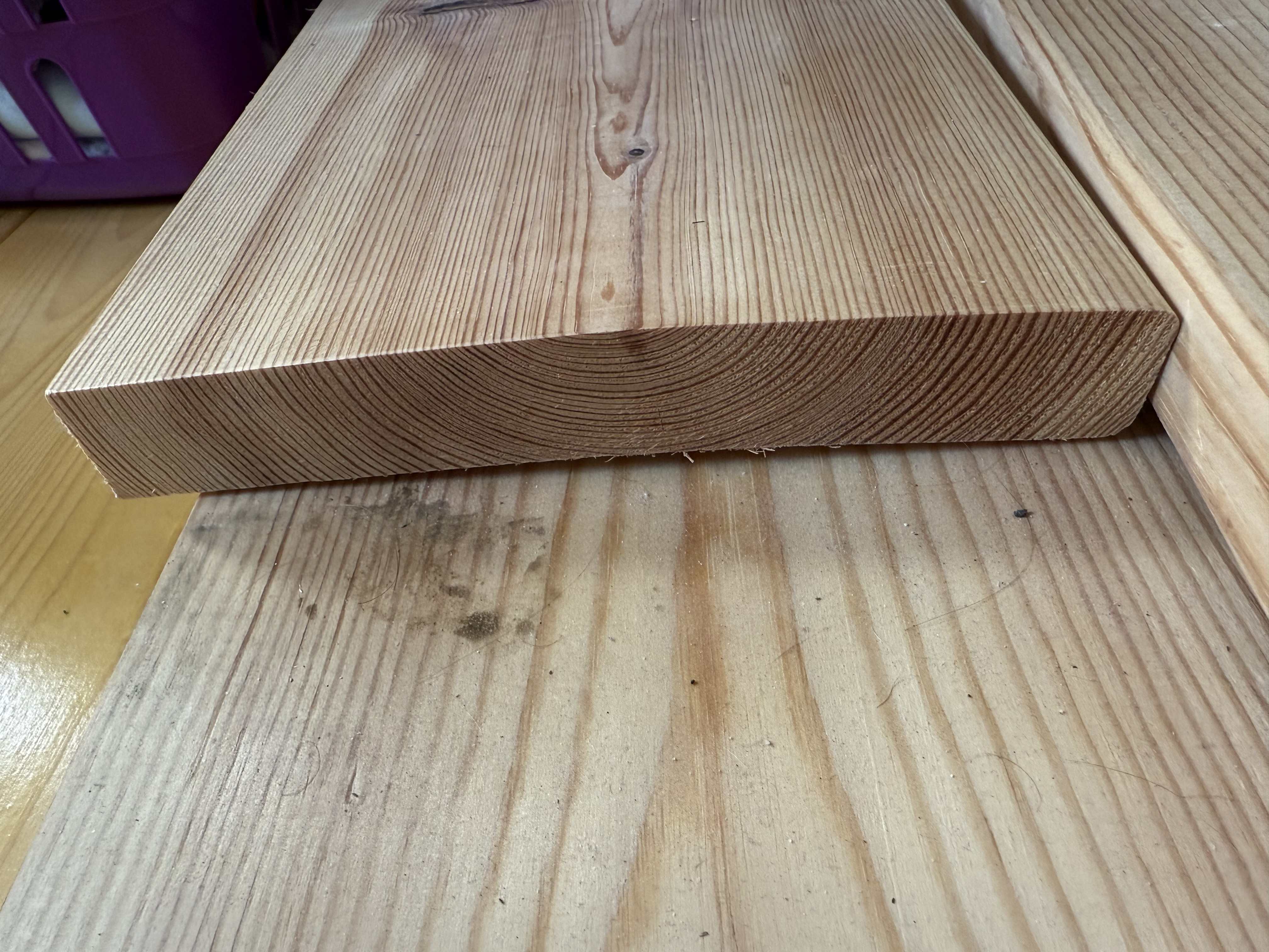

Hi! Would appreciate some quick advice with regards to attaching some wooden sills to our recently constructed timber frame house. You’ll see in the attached image that the timber frame is there under the plasterboard and the silver insulation. I have pine ‘planks’ to go on top of this that form the window sill but I’m not sure the best way of attaching them to the frame below. Can I for example screw/nail them through the silver insulation to the frame underneath? Or should I keep the insulation completely intact? If it helps the house construction is timber frame with block work. Thanks so much in advance!

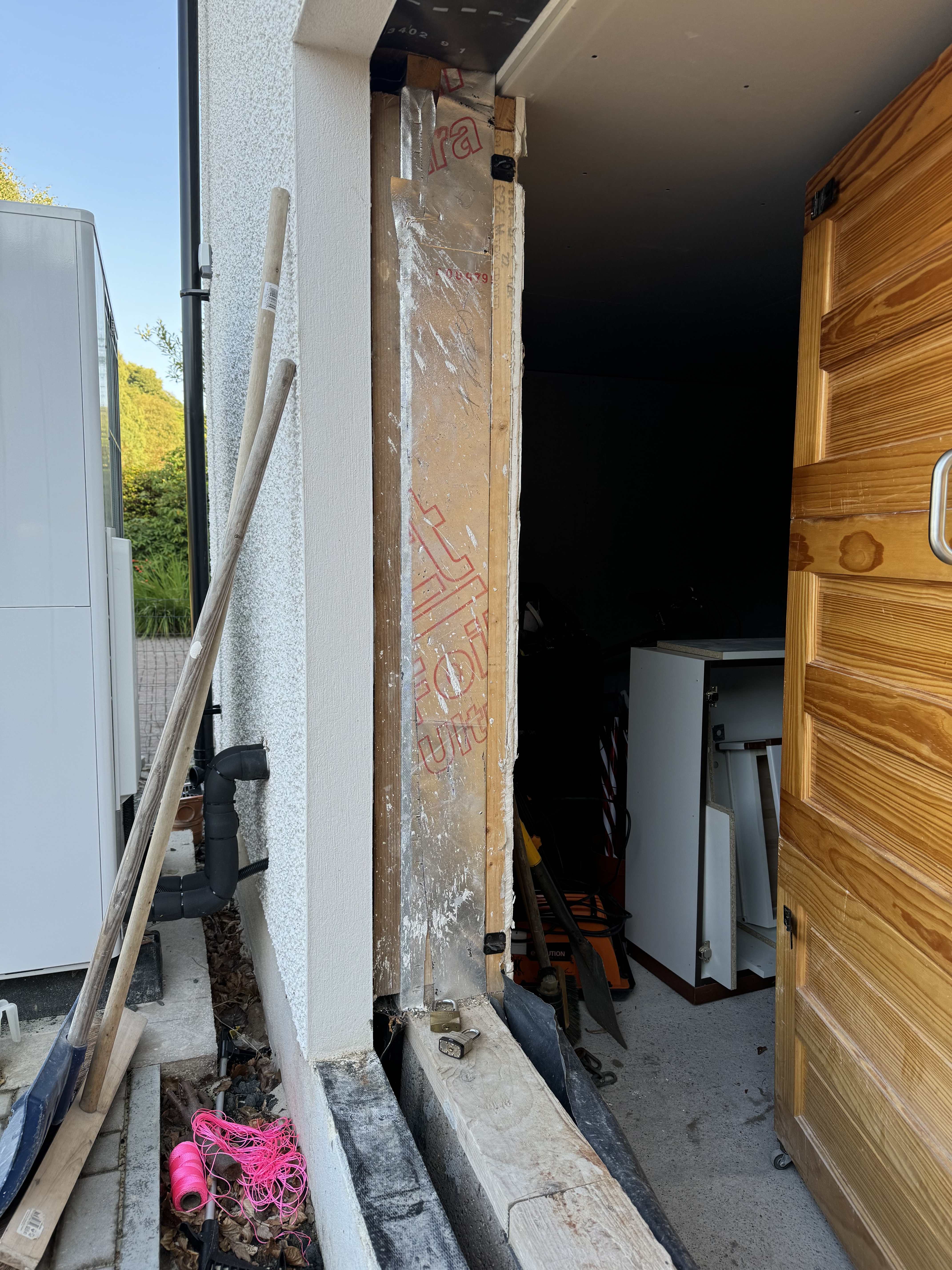

Our contractors have left this outside door way to our garden store unfinished. I will be getting a concrete block for the bottom part but not sure about how best to finish the walls. Its outside so will be exposed to the elements. it’s a timber frame build with brick surround so the inner wall in the picture is mostly wood. Any advice most appreciated!

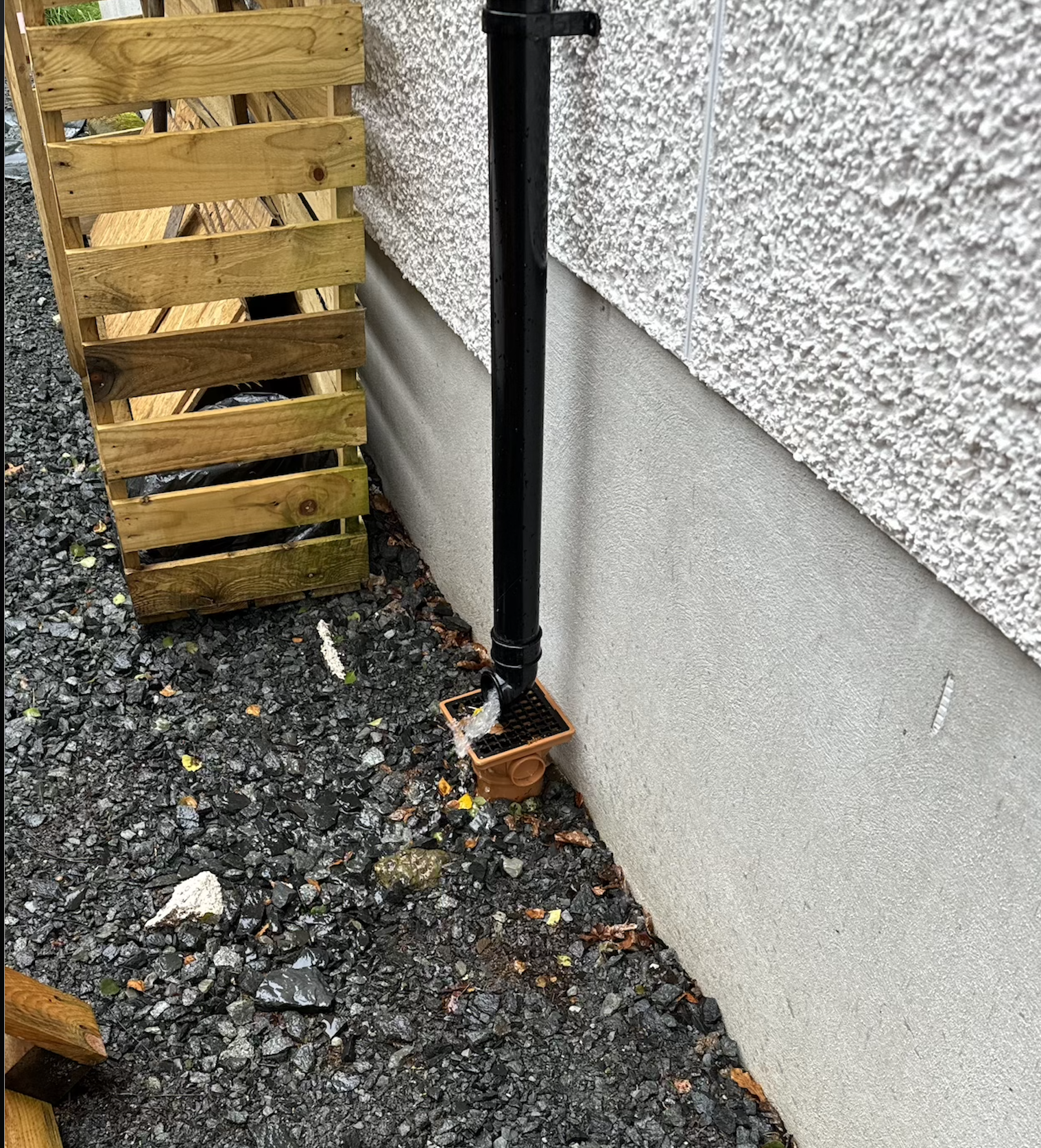

Hi! Just wondering what the best approach would be to prevent our guttering downpipes overshooting their hoppers. Don't want to introduce anything that the BCO may complain about. Is it ok to drop straight in without a curve? Thanks!
