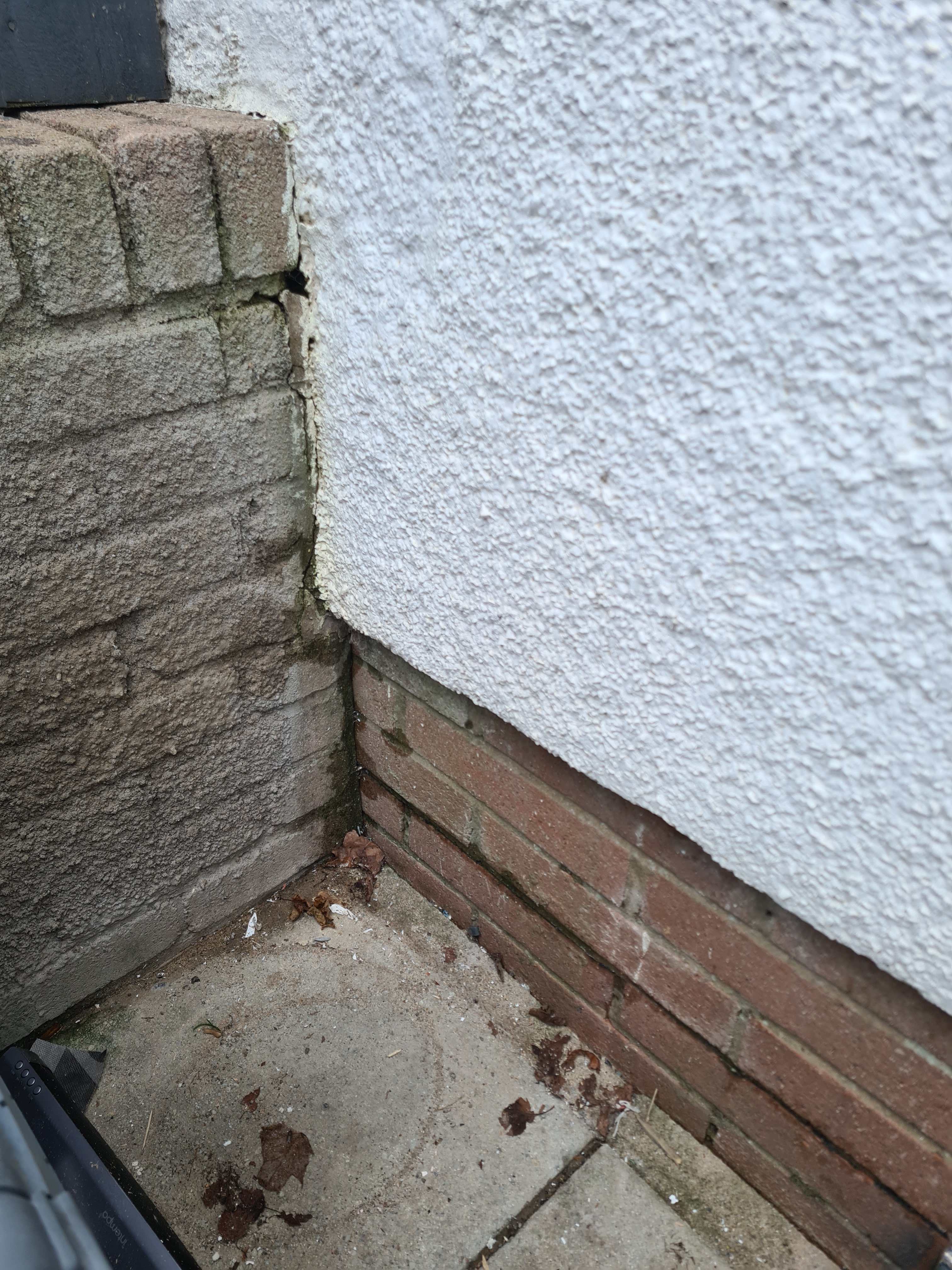

  1. Hi, following on from a previous post, to make kitchen warmer I spotted this wall after we removed a shed that ties into the house. I can see the dpc is full of water hasn't rained since weekend. I have a feeling that the garden wall is soaking water into the house wall it is a cavity but still it can't be good and probably creating a cold bridge also. Is my thinking right ? Will I see a benefit from cutting out an inch or so so theres nothing connecting to the house? Pic attached
  2. Hmm I did think this and your right they sit on the bricks each side one wall which goes deep into the ground
