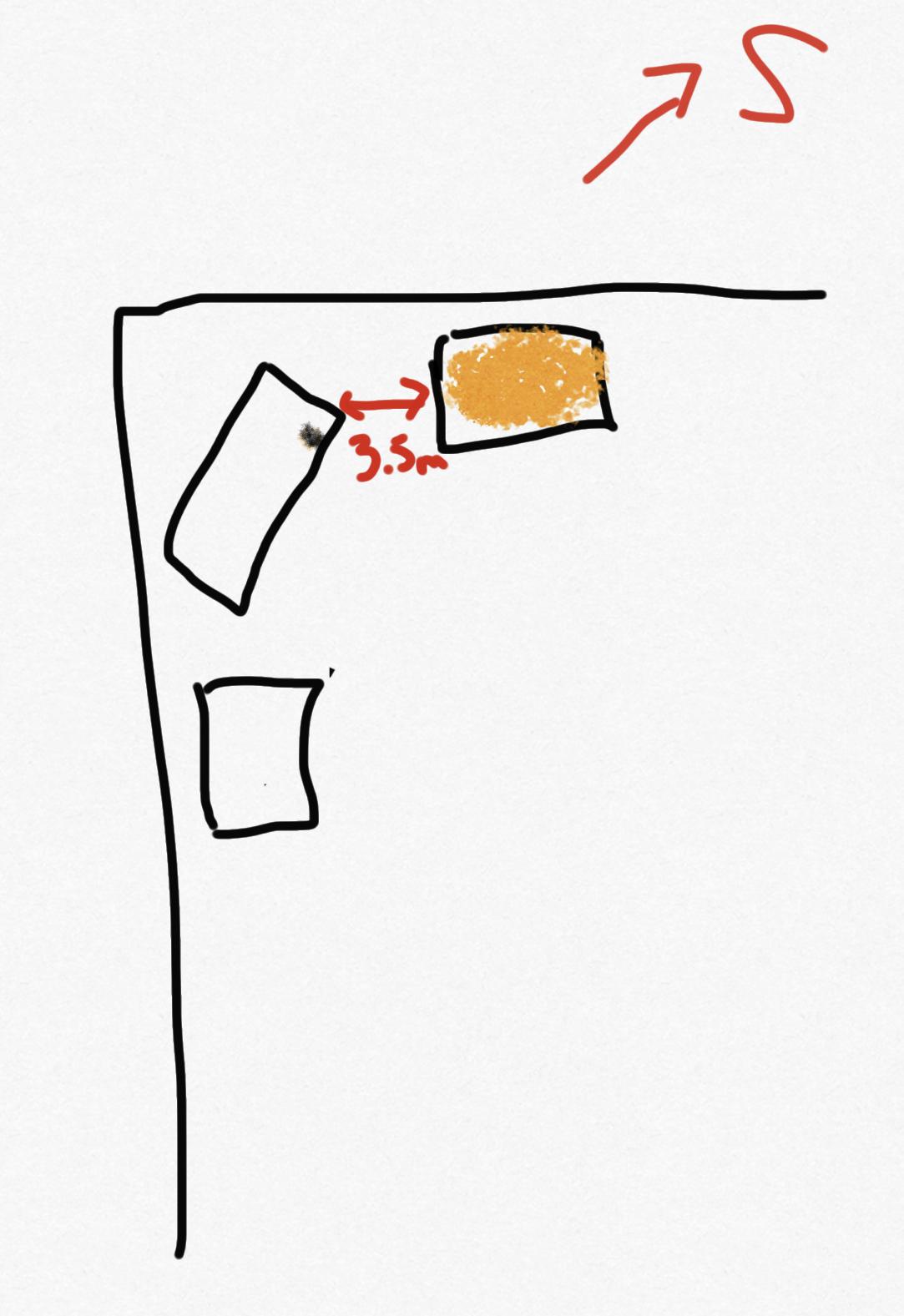

  9. Yes the houses are detached the distance between my house and the corner plot house is 3.5 with a fence at 1.75 meters from the respective buildings I’ve added where South is on the drawing. We would be okay on the 7 meter rule for permitted development but we would exceed the 3 meter limit on double story extension so this would definitely be a planning situation.

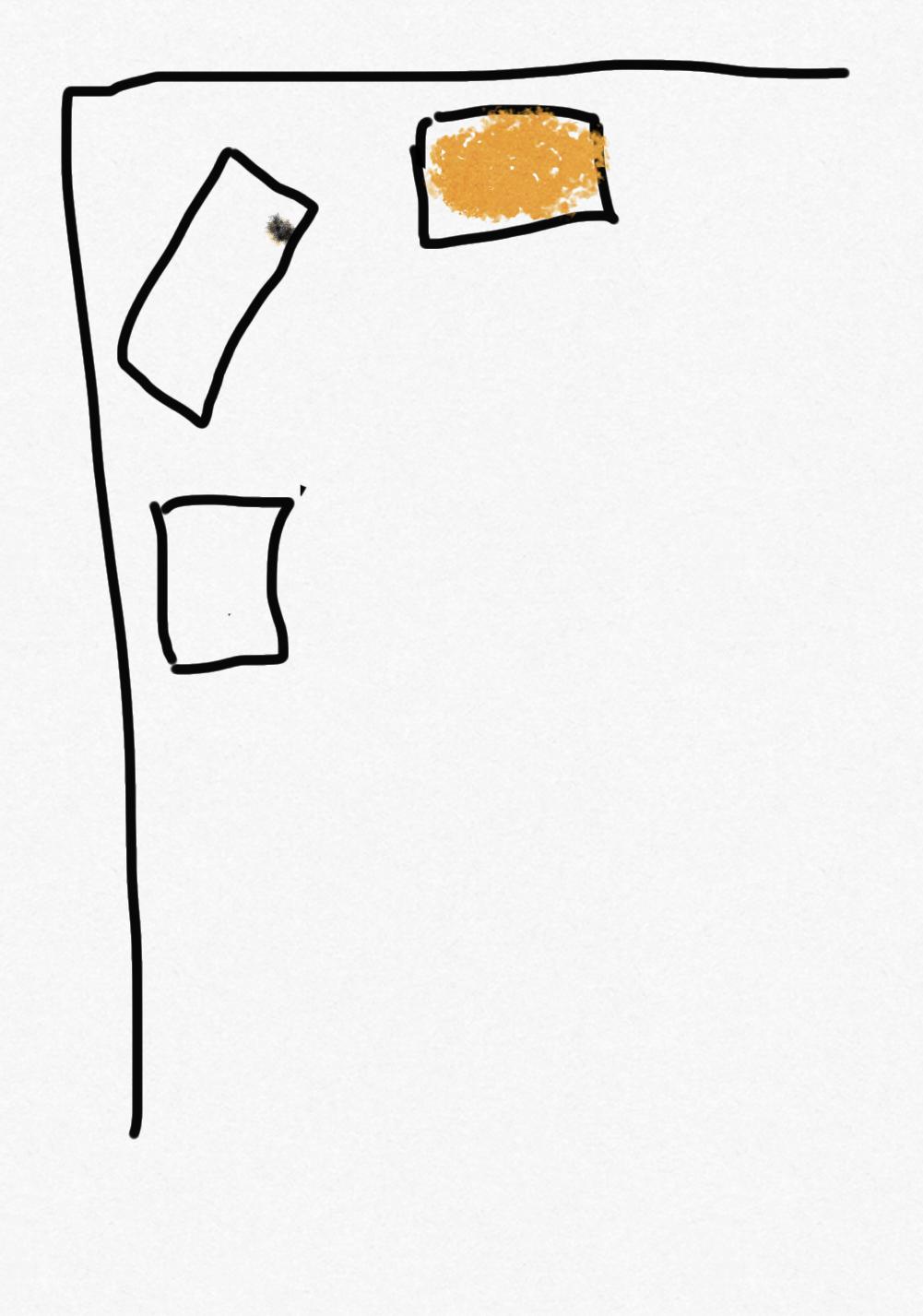

  10. Attached is a crude drawing on my situation. My plot is the plot in yellow and I’m currently adjacent to the corner plot and the corner plot sits at an angle on the plot facing the corner itself. I’ve marked the nearest habitable window of the corner plot. I’m hoping to do a rear double story extension of 4-5 meters which if you take the 45 degree rule literally would encroach on the 45 degree line. We would not be able to do much extending at all if we had to observe the 45 degree rule in this situation. The 45 degree rule normally contemplates that properties are sitting on the same plane facing the same road. In this case that’s not the case given how the corner house sits on the plot. Anyone have any thoughts on how planners would look at this. I cannot find any information about the applicability of the rule in this type of situation.
