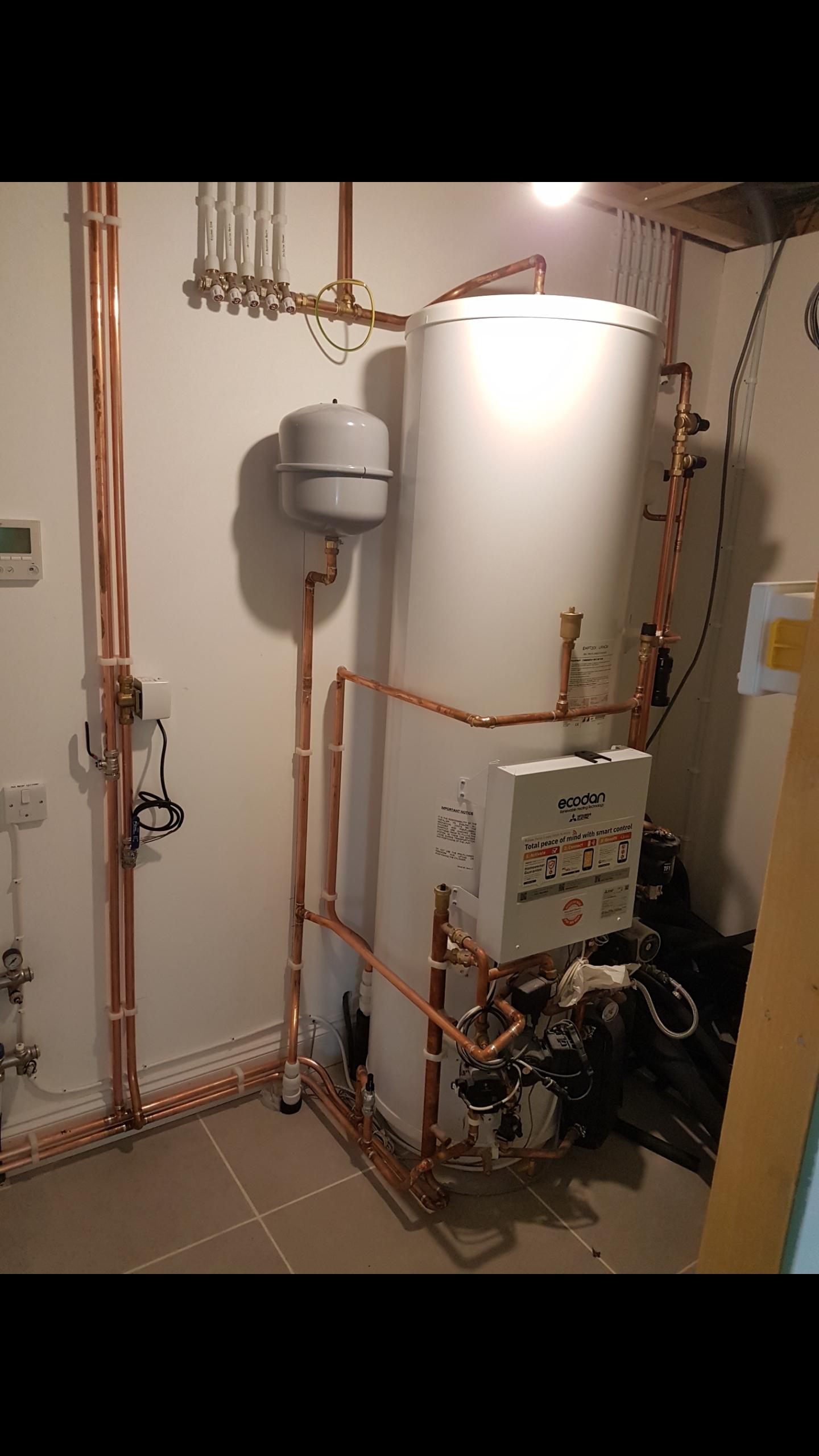

Expansion is 12 litres, so should be fine? Do you think 90 - 100 litre buffer will be ample. -

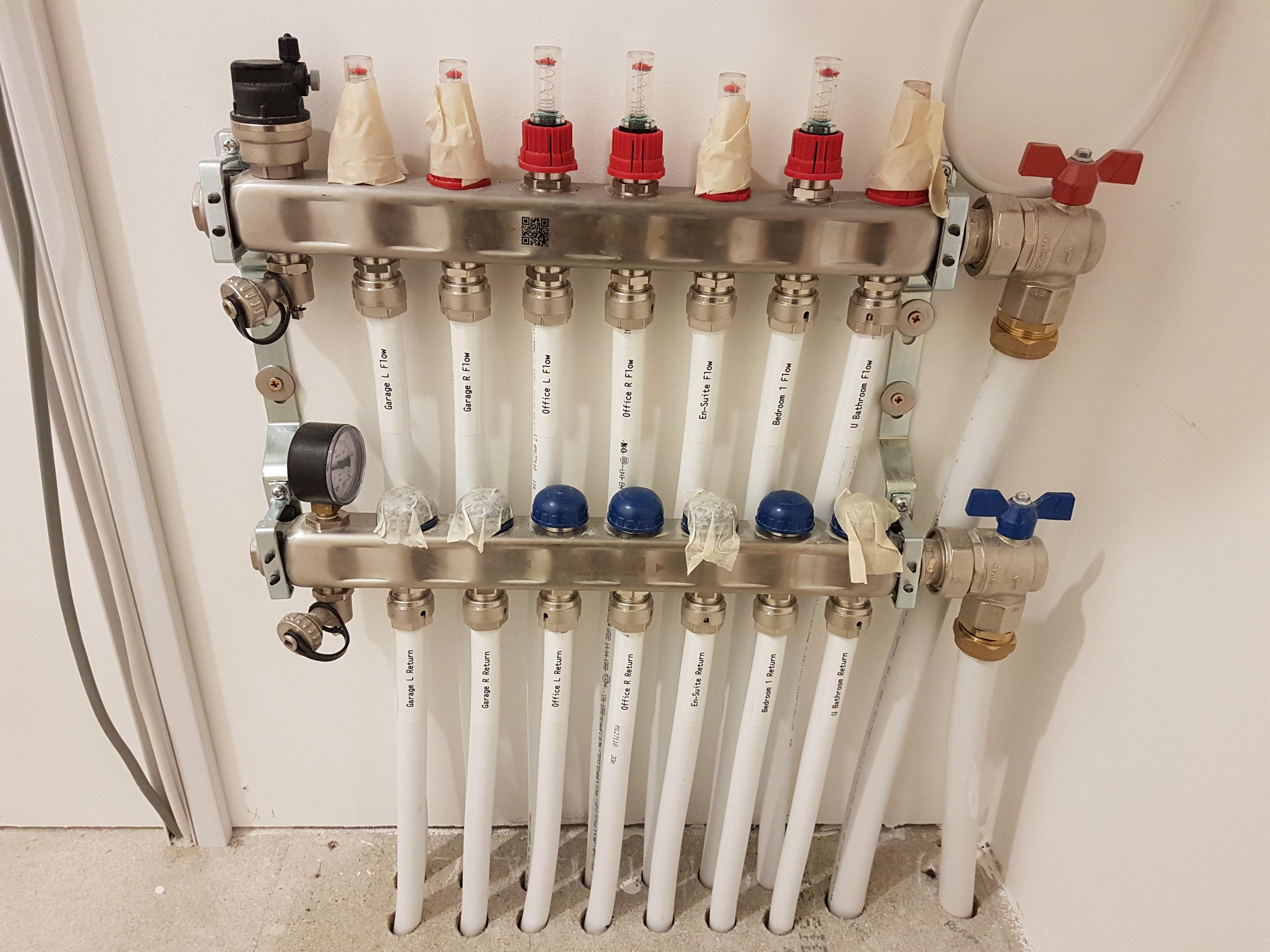

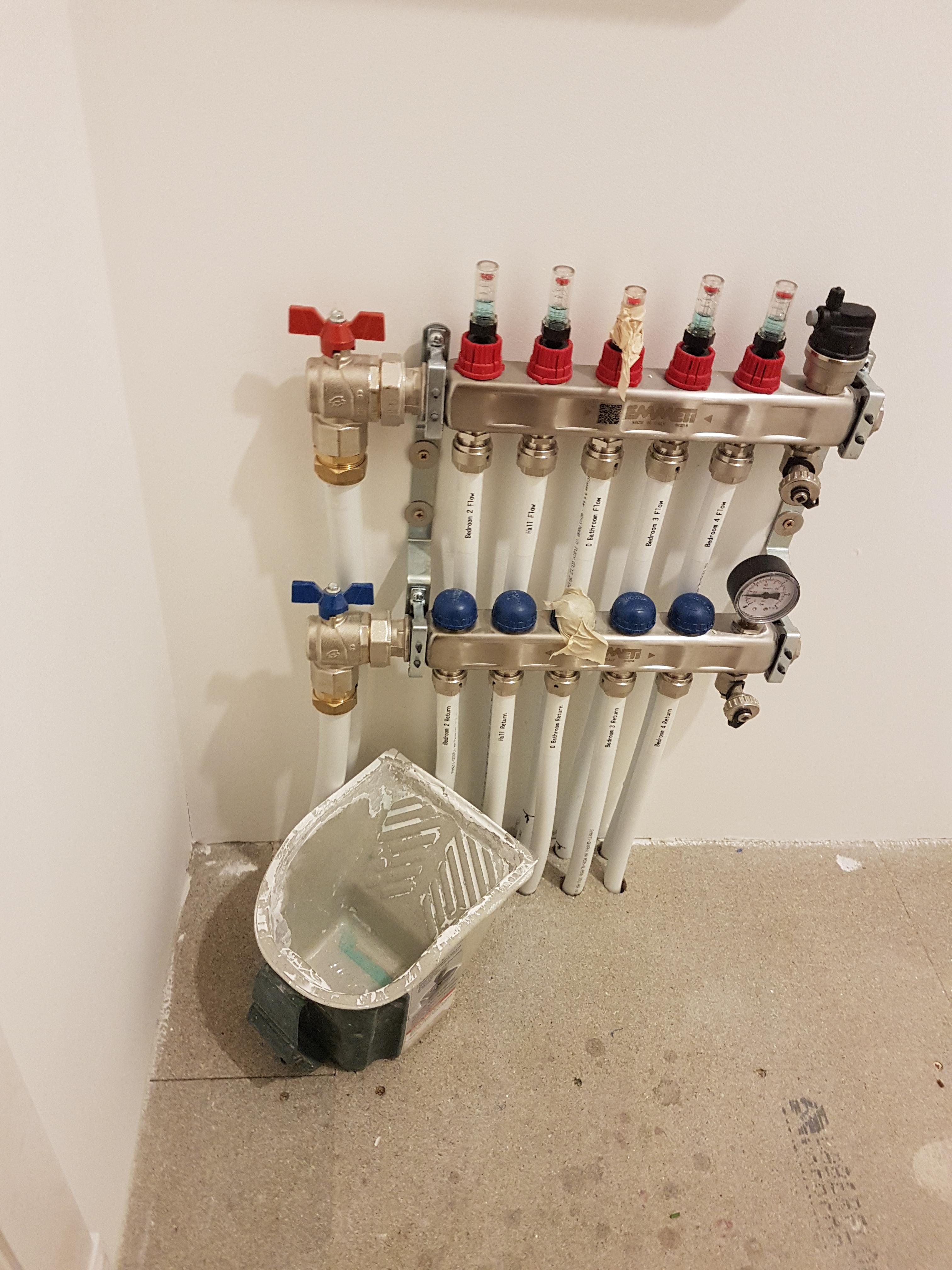

Think it's about 1.8 bar when not running, drops to 1.5 bar when running. No pumps on rad circuit yet, but going to add some. The 2 pipes going up the wall go into a tee at the top into a 7 port manifold then it goes to the other side of the house into another 5 port manifold. First manifold gets some movement in the flow meters but the second one doesn't. Currently researching this also as where the manifolds and pipes are would be hard to get a pump in unless I take the pipes to the other side of the manifold, and add a pump there. -

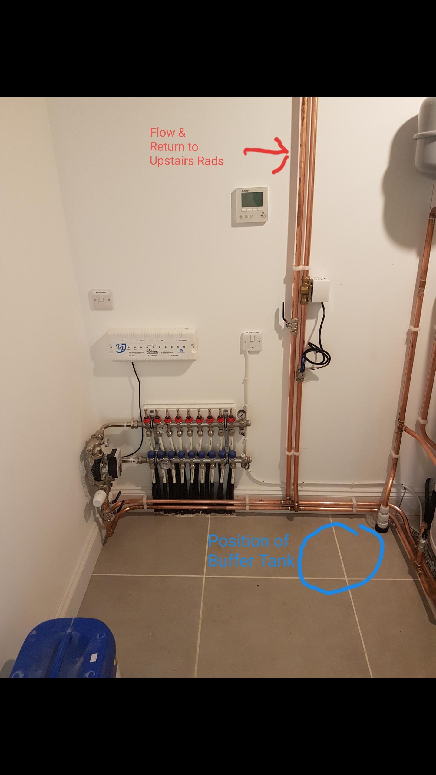

@PeterW Peter, the drawings were just for reference as to where the pipes went not on where to break into them. The position of the buffer is the only feasible position to put it as the room is quite small. Keep seeing 2 or 4 pipe setups for buffers so I assume I need the 2 pipe version. Any recommendations as to what buffer to buy, My guess would be something along the lines of 100L ish. -
Hello, I'm looking for a bit of advice on adding a Buffer Tank to my ashp setup. The way my heating is set up I have individual control of all rooms in the house via thermostats, downstairs via ufh zones and upstairs radiators via point to point plumbing manifolds. Which in itself probably promotes the use of a Buffer. System specs - Mitsubishi ecodan 12kw Pre plumbed 300l cylinder 95m2 of ufh 249m2 of heated rooms all in. So the question is where is the best location to break into the pipework to install a buffer and looking for recomendations as to Manufacturer, model numbers etc. Pictures are just after installation before someone mentiones insulation etc ? Thank you.
