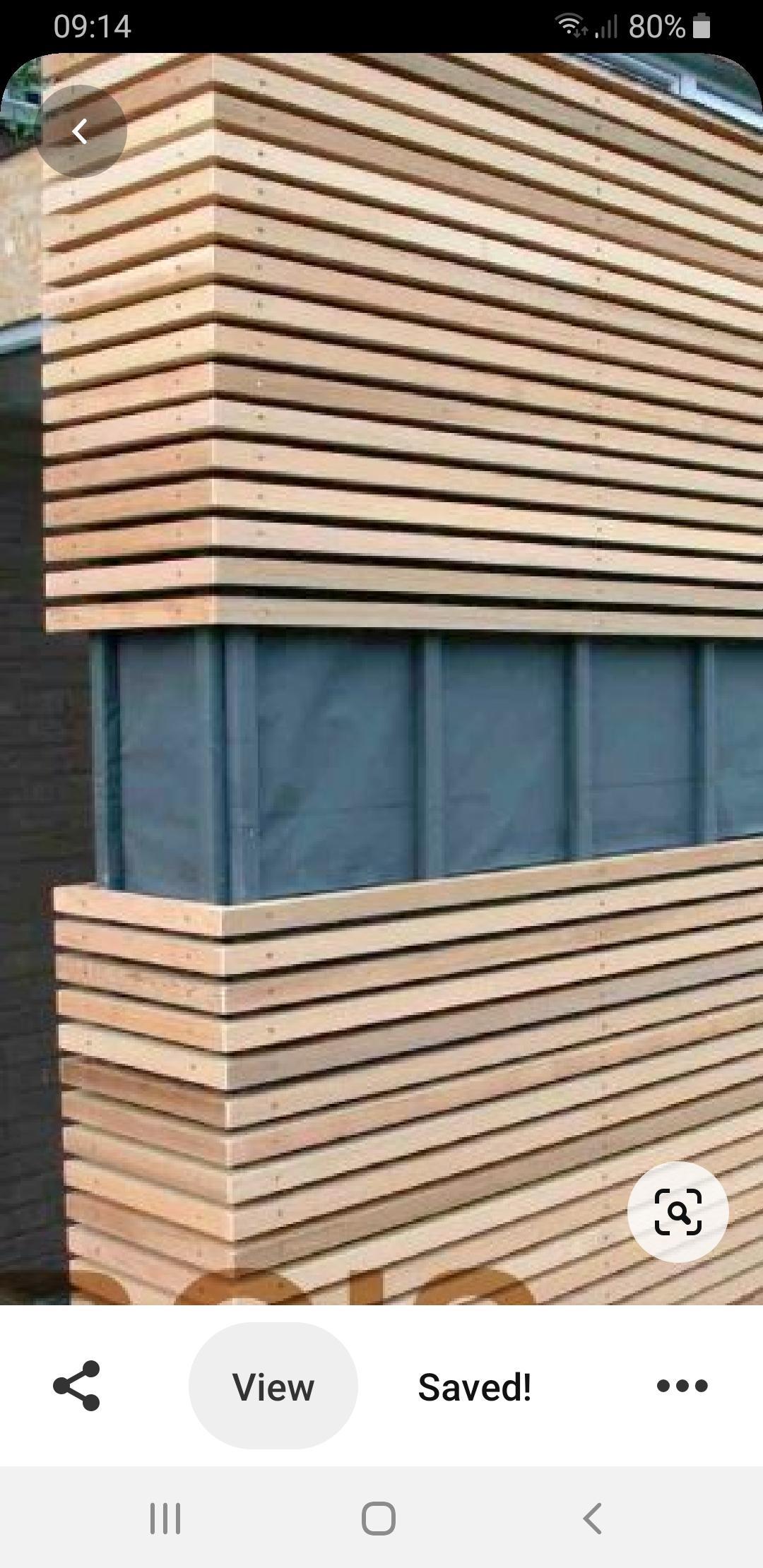

  11. not sure i've got an option unfortunately if comments from lenders are to believed. i've not costed for the blockwork accurately yet but have estimated £6k inc. labour for 160 sq mtrs (based on several online calculators). In terms of mortgage savings- around 2% rate from highstreet lender should be possible given location, non-trad construction and loan to value. Specialist lender who would accept SIP + cladding with no masonry would be 3% if lucky but closer to 4% in reality, and construction type would deter re-sale if i ever had to move. Over 5 years that would cost me an extra £8k @ 3% or £16k @ 4% in repayments so makes sense to go for blockwork now even if it is hugely frustrating and unnecessary. Broker i've used for several mortgages and she has really done a lot of leg work on this construction method for me.
  12. very nice- that's what we wanted but Planners not up for it. Where did you get it from if you don't mind me asking? I'll check out Dupont- thanks
  13. i think with rendered block outer skin you should be fine with highstreet lender and thus lower % rate. My mortgage broker has spoken to about 20 lenders and it seems with masonry element then about half are happy with SIP construction. Timber cladding on masonry reduces pool further though but that's the look we want (and Planners!) Last time i spoke to Protek they wanted £5k for my warranty but that was without masonry element, timber only construction. Hopefully they'll reduce it a bit now. Was your SIP kit BBA approved if you don't mind me asking? I am probably using a company in Fife for kit but they are not BBA approved (yet) and i'm a bit wary of consequences.

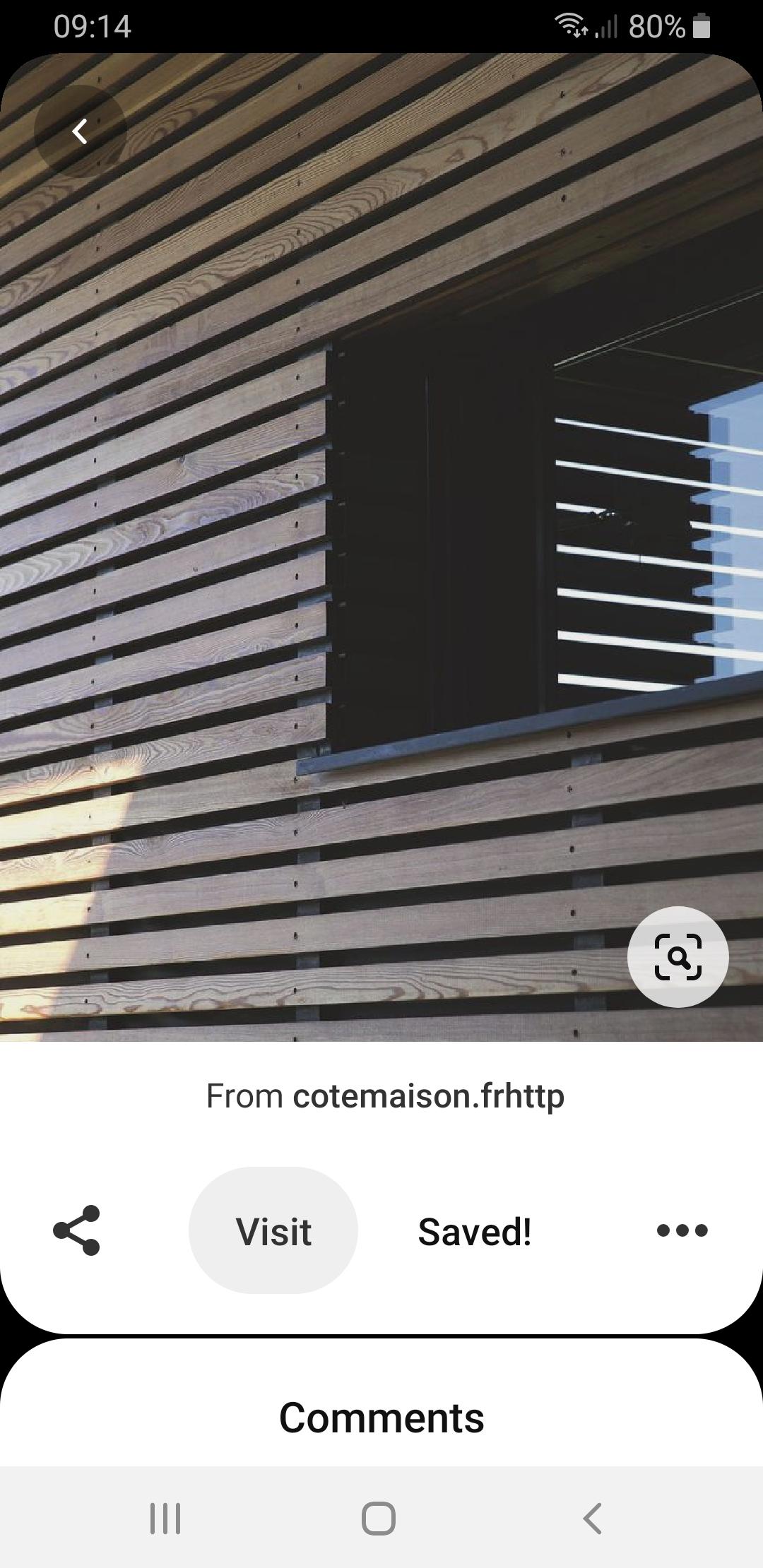

  14. Thanks for your comments. Construction will be 160mm SIP kit, membrane, 50mm cavity, 100mm lightweight block, something black, 18mm batons then 22mm horizontal larch . That link to Proctor Group is great- i've been looking for weeks and hadn't found anything but that product sounds good. Paint flaking was a concern for me too. Ideally larch will be nailed on to batons so yes would be impratical to remove every 5-10 years to paint the blockwork. I had considered corrugated black steel on to blockwork then batons then larch, but i think the mortgage lender will get spooked with use of larch + steel sheet. I could use the Proctor membrane on top of corrugated panel to conceal it i suppose and lender will be none the wiser. Proctor membrane straight on to masonry sounds like the way to go, using black batons to secure membrane down, but Proctor data sheet says 5000 hours UV tested which is only 208 days direct sun. Obviously UV resistance not applicable at night time, and the gaps between larch only 18mm so gap for UV to penetrate is small and position of sun will make angle of 'attack' tight, but still doesnt sound like the Proctor product will be much better than 5-10 years expectancy like paint option. I'll email them to ask rather than blethering here! black bricks are nice- but too expensive unfortunately to then be covered by larch
  15. Hi, I'm building a house in Scotland using SIP construction for insulation quality, airtightness and speed of build. Plan is to clad in larch externally like image below. But speaking to several mortgage companies who will take on the long term mortgage (after self-build mortgage finishes in 9 months) it seems most are very wary of SIP construction with only timber cladding. A couple of highstreet lenders have said it's a 'possibility' (halifax and santanter) but most want masonry external skin. If i go to non-highstreet lender who are more understanding of purely timber SIP build the interest rate seems to be more like 4% rather than 2% so it makes a major difference to mortgage payments. I've therefore decided (just to satisfy mortgage lender) to add a middle skin of lightweight concrete block between SIP frame and larch cladding. My question is do you think the concrete block can be left painted black behind the larch, or will i need a more substantial finish on the concrete block because the larch installation has such large gaps (15/20mm spacing). I don't want to have issues with moisture travelling through the masonry and condensing on the SIP or at soleplate. Very frustrating to have to add the totally unnecessary masonry but over 5 years i calculate mortgage saving will be around £10k and i think block cost will be around £5k. Thanks.

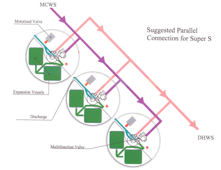

  17. yes that is what i thought too, so i would always have 500L main cylinder with potential 500L backup when required. A UVC manufacturer sent me this diagram today though for parallel connection- i read from this i would need all 3 cylinders to be heated at same time to same temperature to balance my hot water feed? If one cylinder is cold the cold will feed into the main DHW pipe and lower the temperature of everything?

  20. i would defo go for a 500 litre tank now, but i need to have enough water for potentially 8 showers a day, all with high flow rate, so i'm just not sure 500L will be sufficient. If i can daisy chain another UVC though then that would allow me to upgrade in future (and stop getting my knickers in a twist just now.) The guy i spoke to at OSO said i might need 3x300 litres UVC capacity, but i think until bathrooms are in and house being used i will not know for certain how much DHW is being used/ replenished quickly enough to cope. I'll speak to Trevor- thanks
