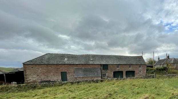

Hi, I'm trying to wrap my head around a barn conversion I want to start soon. Stone barn in Scotland, very thick stone walls- structurally ok. Slate roof/ timbers well past their best and i need to raise ridge height for first floor head room, so existing roof & trusses are coming off regardless. I have full PP. To convert i saw 3 routes- a) drop a SIP kit inside. fast, slim and thermally efficient, but tricky to get 100% correct with existing window openings etc, and adjustment on site is not really possible i believe. circa £60k exc. assembly, but includes most internal walls too. b) ICF- thermally efficient again, reasonable fast, prices quite high and that's excluding a roof. easier to tweak on site to fit existing walls & openings. circa £68k exc. roof, 1st floor joisting & internal walls. c) stick built on site with local joiners. takes a longer time, but easy to work with existing structure. Including insulation and trusses significantly cheaper than a or b. So option c) seemed easier, but now I'm reading that stick built would perhaps prevent me getting a 10 year warranty and/or straight forward mortgages? There is a good chance I'll sell within 5 years. The ease and speed of using SIPs is very appealing, but i suspect these benfits will go out the window if i have to adjust the panels on site. Are there other viable build options I've missed? Is adjusting SIPs even possible? I specifically asked the SIP company to give me oversized (too wide & too high) openings for windows & doors so I can bring them in on site with stud work to suit existing openings, but maybe I'm just opening a can of worms. Thanks!
