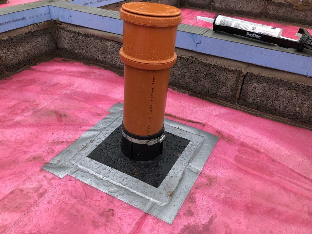

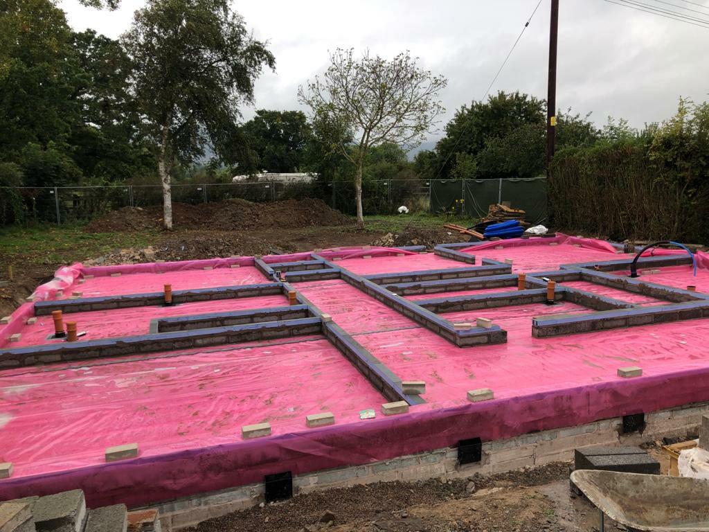

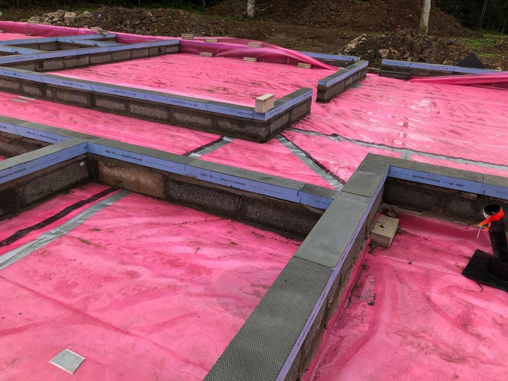

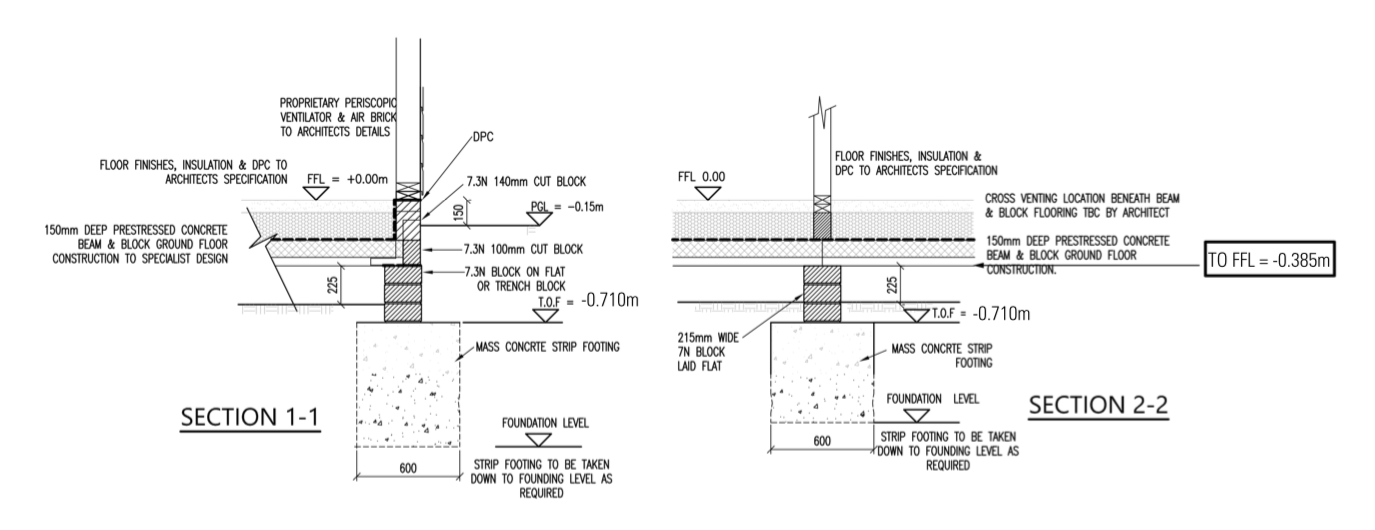

I thought I would update this with some pics. We pretty much have done it as the above drawing. Engineers drawing is attached too if it helps anyone else.

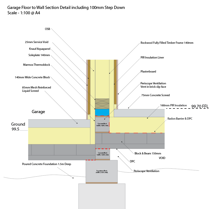

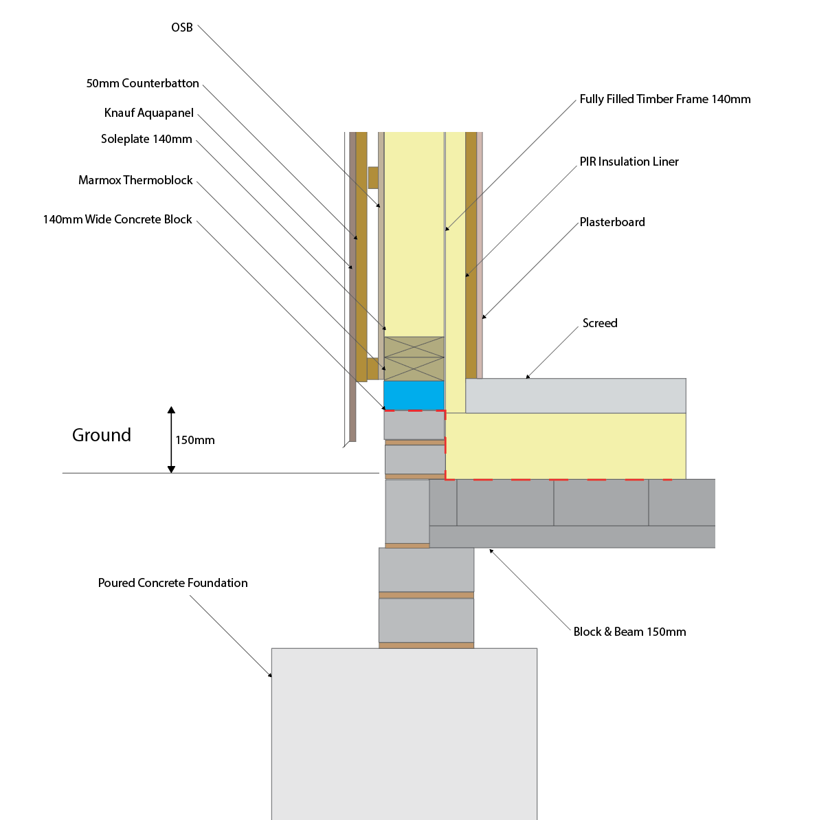

I had to make some amendments to accommodate the drop in height for the garage. Do these look ok with the wall sitting on the floor like this.

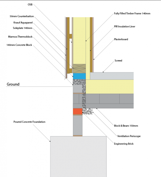

Where would you put a Radon barrier? Just where the DPC is or just in place of the DPC to replace it?

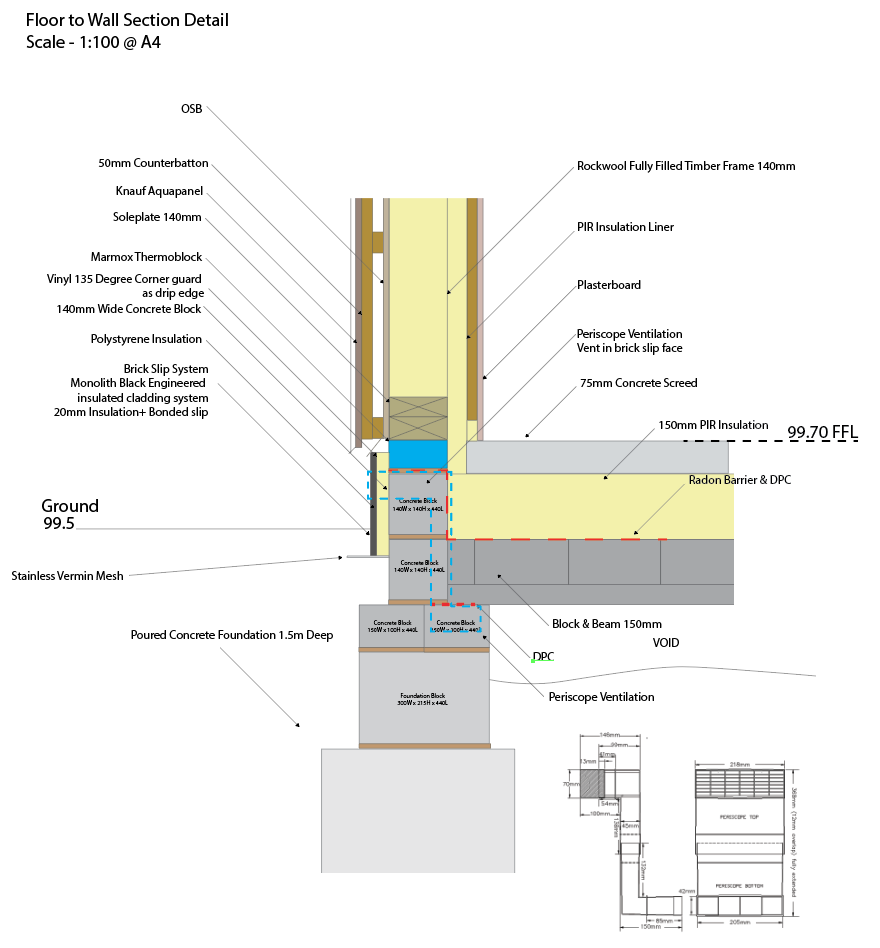

Thats super helpful Russell as i was looking into doing something like that but wasn't sure it would work with brick slips etc. Great to know people have done it. Does this look ok? Just added the 25mm rip too.

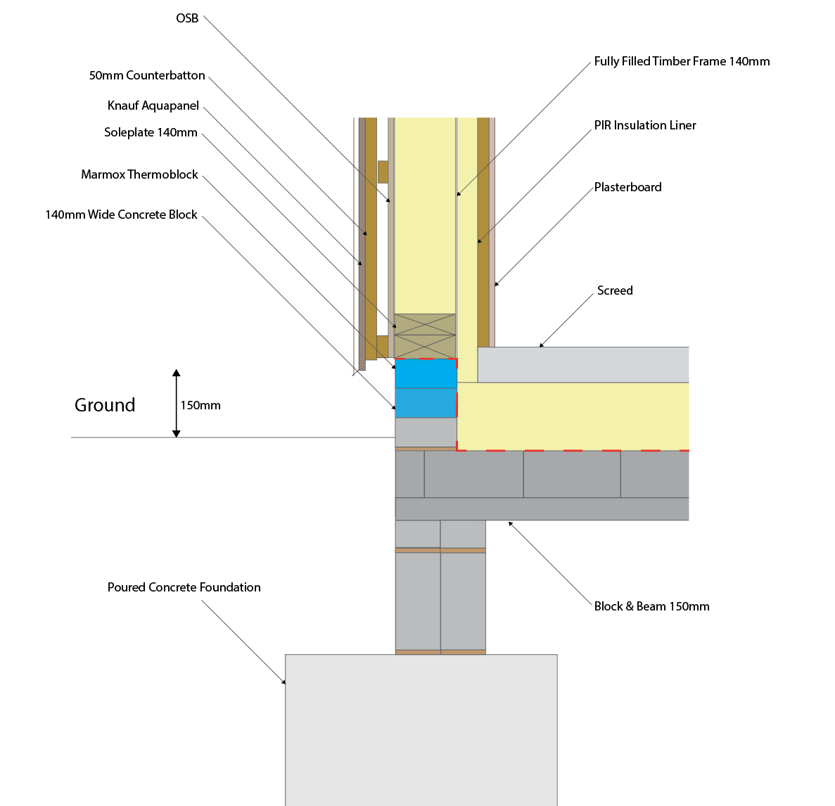

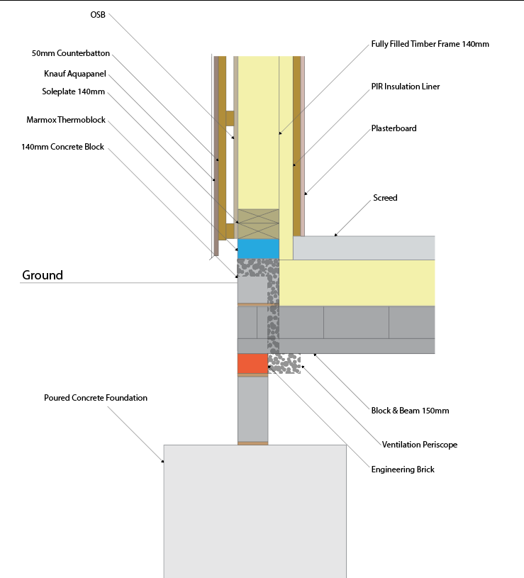

Thanks for taking a look. It's just a rough sketch I have done that i want to get right before sending it to the engineer tomorrow (it is to scale though yes), as they won't be looking at insulation, but more the structural side. My issue is we have a height restriction and i don't want to raise the internal floor too high as we will have to lose room height. The DPC has to i believe be 150mm above ground level, which means the frame has to sit roughly where it is i think other wide the frame would be pushed down a course. I have made a few changes, but it requires a vast amount of the Marmox which will be quite expensive so would be good to get any thoughts. Ive made some tweaks here. How does this look to you?

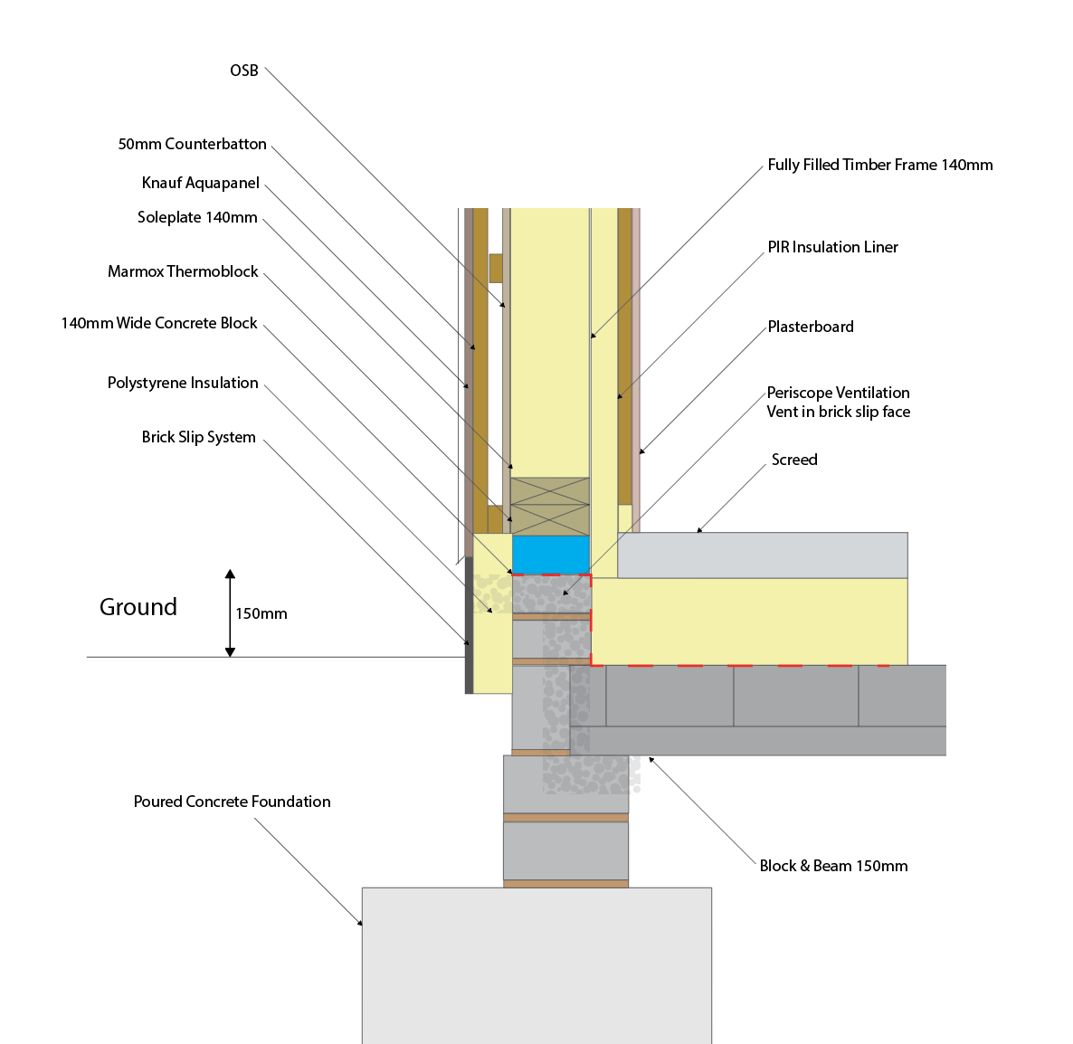

I’m building a modern timber frame house.. not to passive house but as best as i can. We wanted to go insulated raft but our site is no good due to the very close hawthorn hedge and soil conditions to so we are going with block and beam. I have attached a very rough detail and wanted to get some thoughts before sending it to the engineer. We are planning on putting drainage in beneath the subfloor to ensure there are no issues there. Does the Thermoblock location look ok where it is, just below the frame? It feels like there will still be bridging through the block-work beneath it. Thanks!
