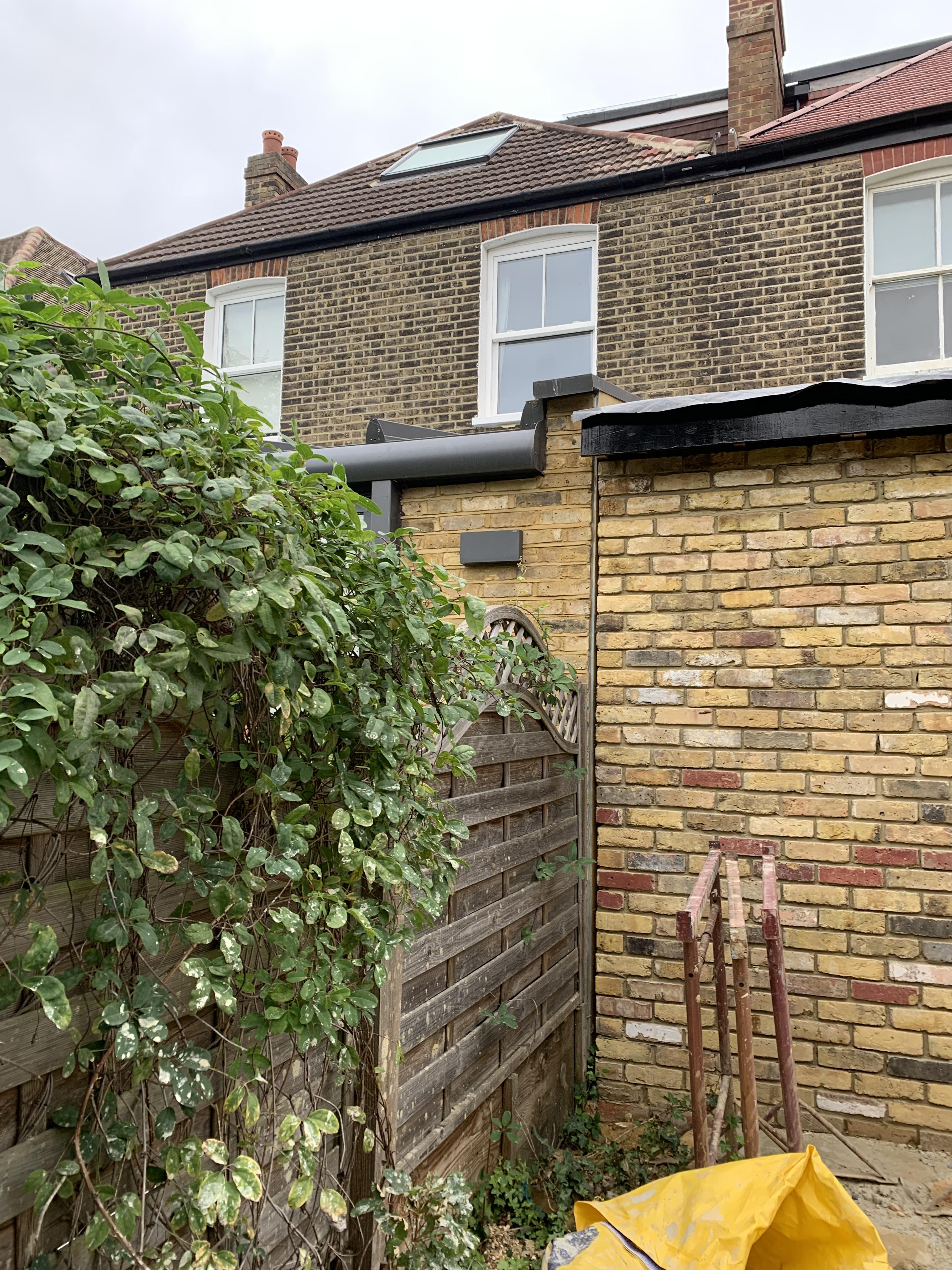

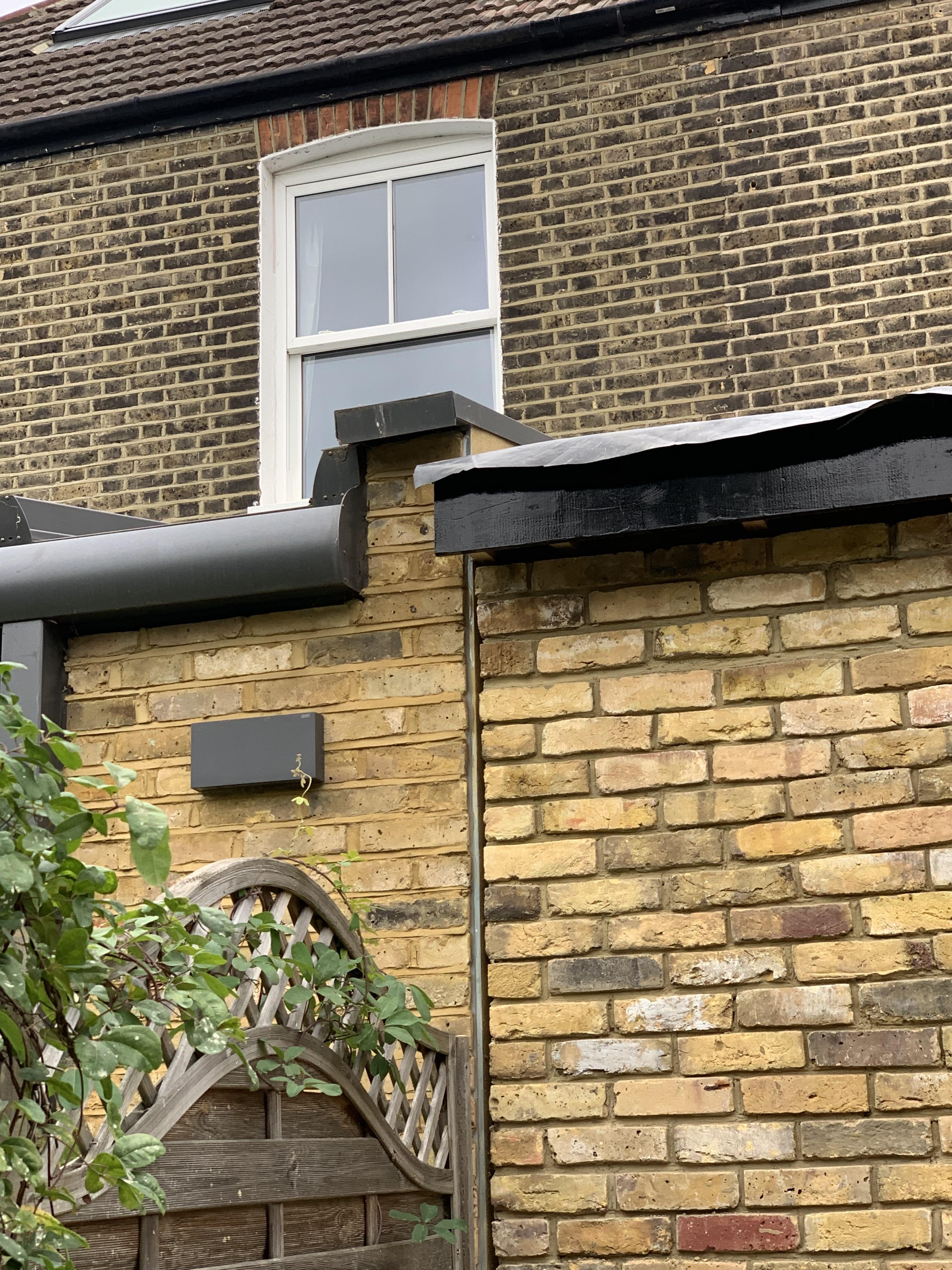

  1. We are able to build a wall inside and do a taller parapet detail. Not sure how to cap it or slope it? We asked if he consented to putting lead across the top but he did not reply.

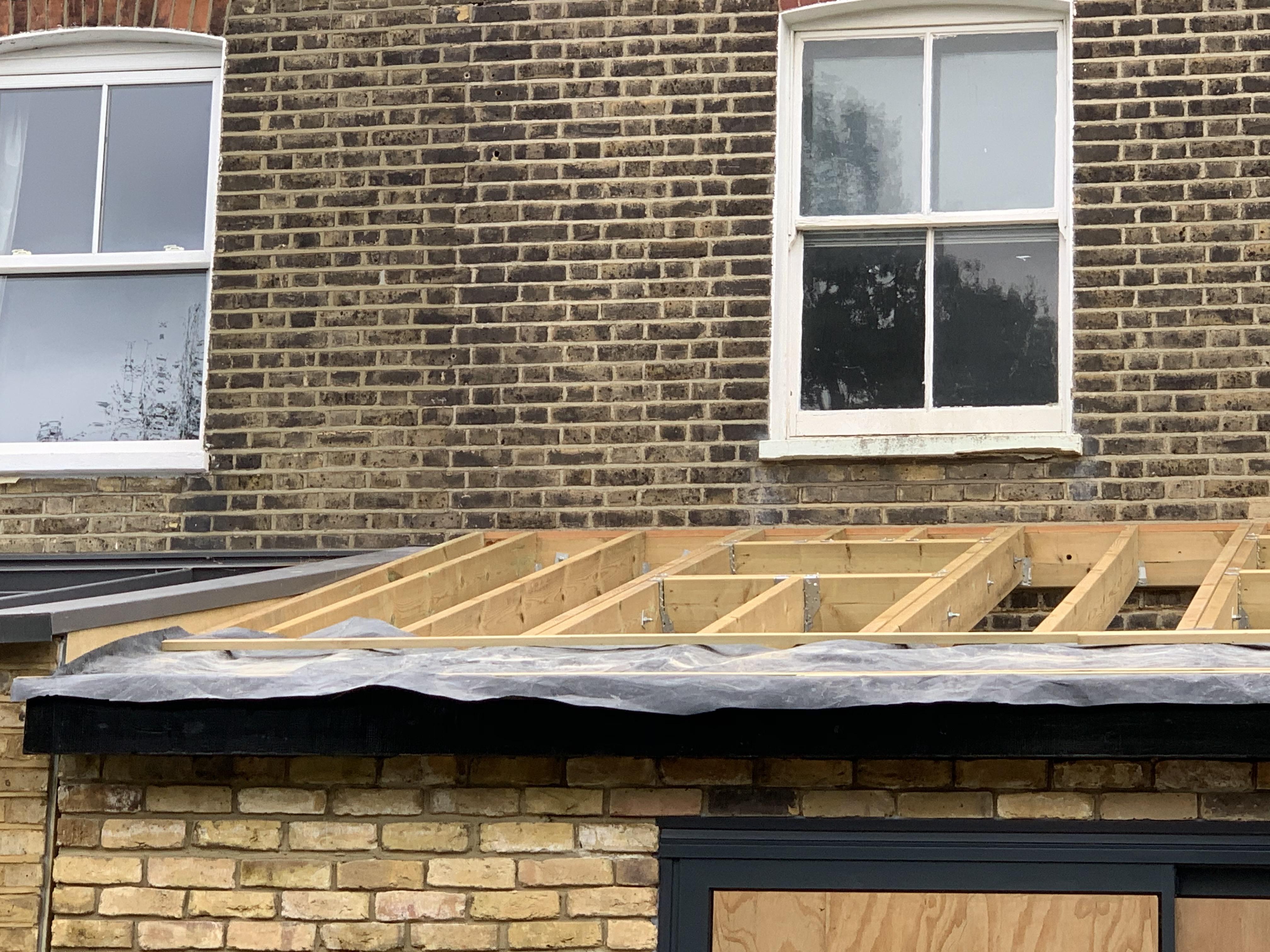

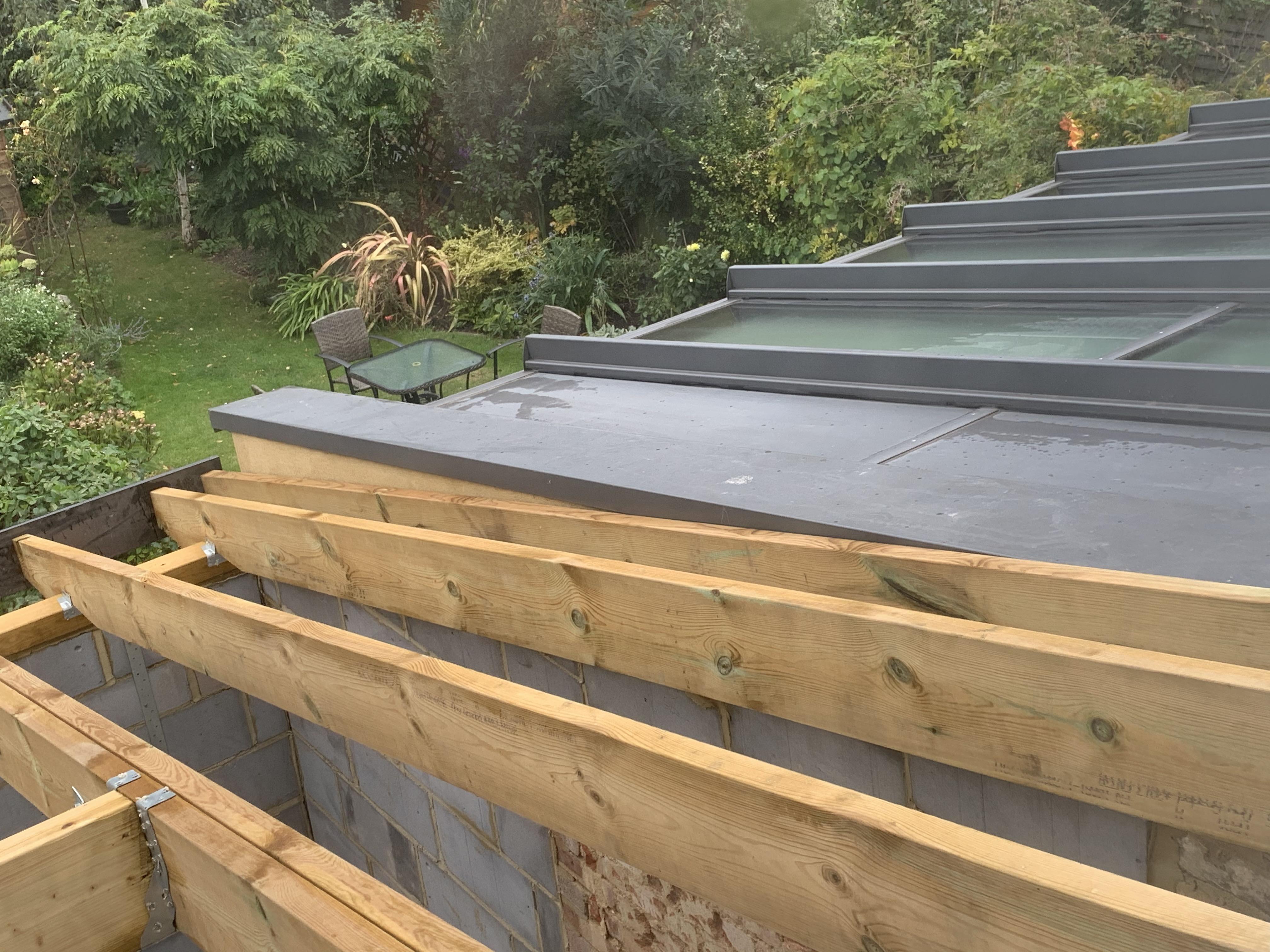

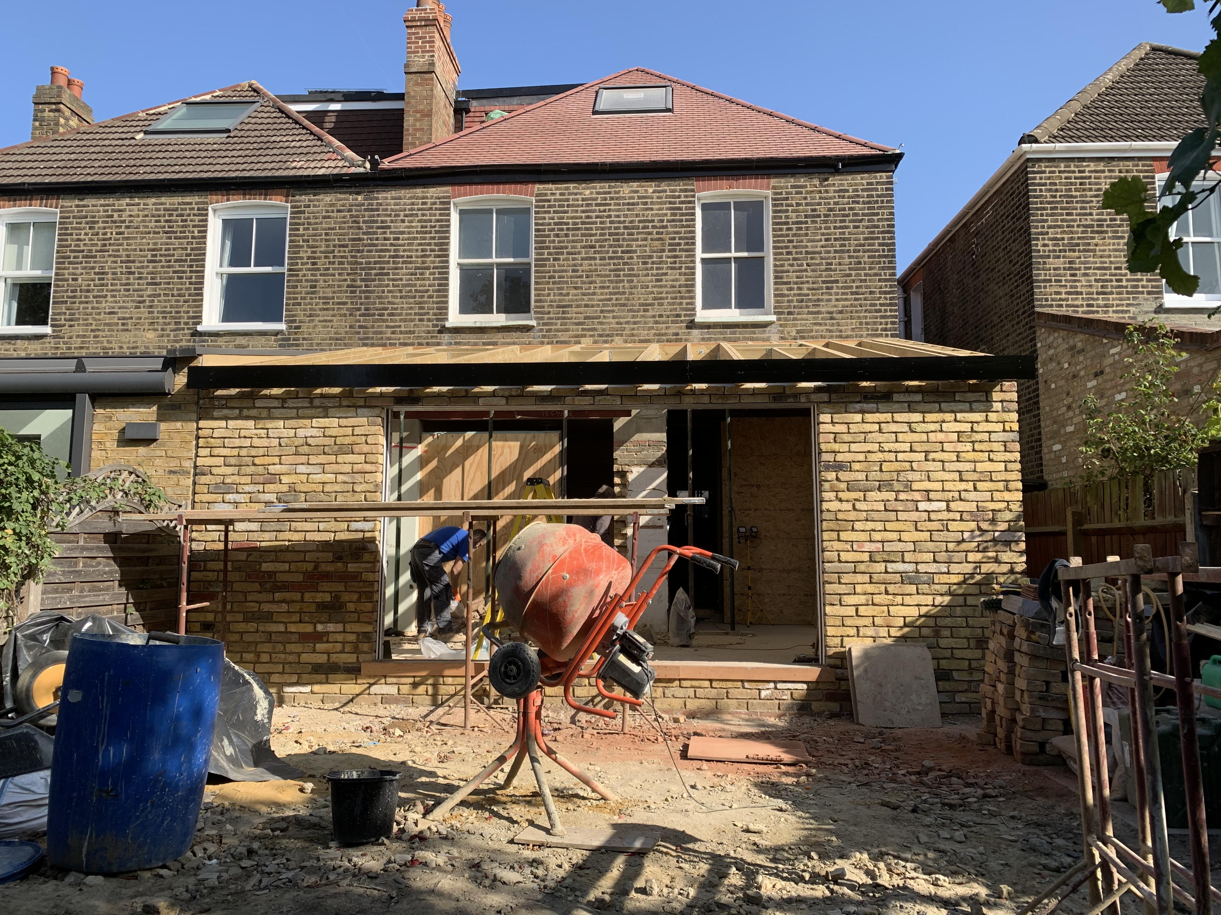

  2. We are building a single storey rear extension wall next to our neighbour’s single storey rear extension wall. The neighbour has a pre-finished aluminium capping to their parapet. We intend to form a pitched roof abutting right up to theirs forming a weathering detail - but this is proving decidedly difficult! Our roof pitch will not match theirs. Their roof pitch I estimate is 12 degrees and ours, 15 degrees. Therefore, the lowest part of our roof at wall plate level does not enable a 150mm cover flashing to be formed between the neighbours extension wall and our roof (we can only get say 60-70mm upstand). At the highest level at rear original house external wall abutment, there is healthy say 300-400mm difference in levels down to their parapet which would enable a detail to be created (subject to their agreement) dressing on to their parapet. But the ‘cross over’ space between the two creates a troublesome area difficult to weather properly. It is not really an option to take off the neighbour’s aluminium capping. I understand an option is to form my own parapet which would resolve the issue, but I may lose internal floor space. Any ideas?
