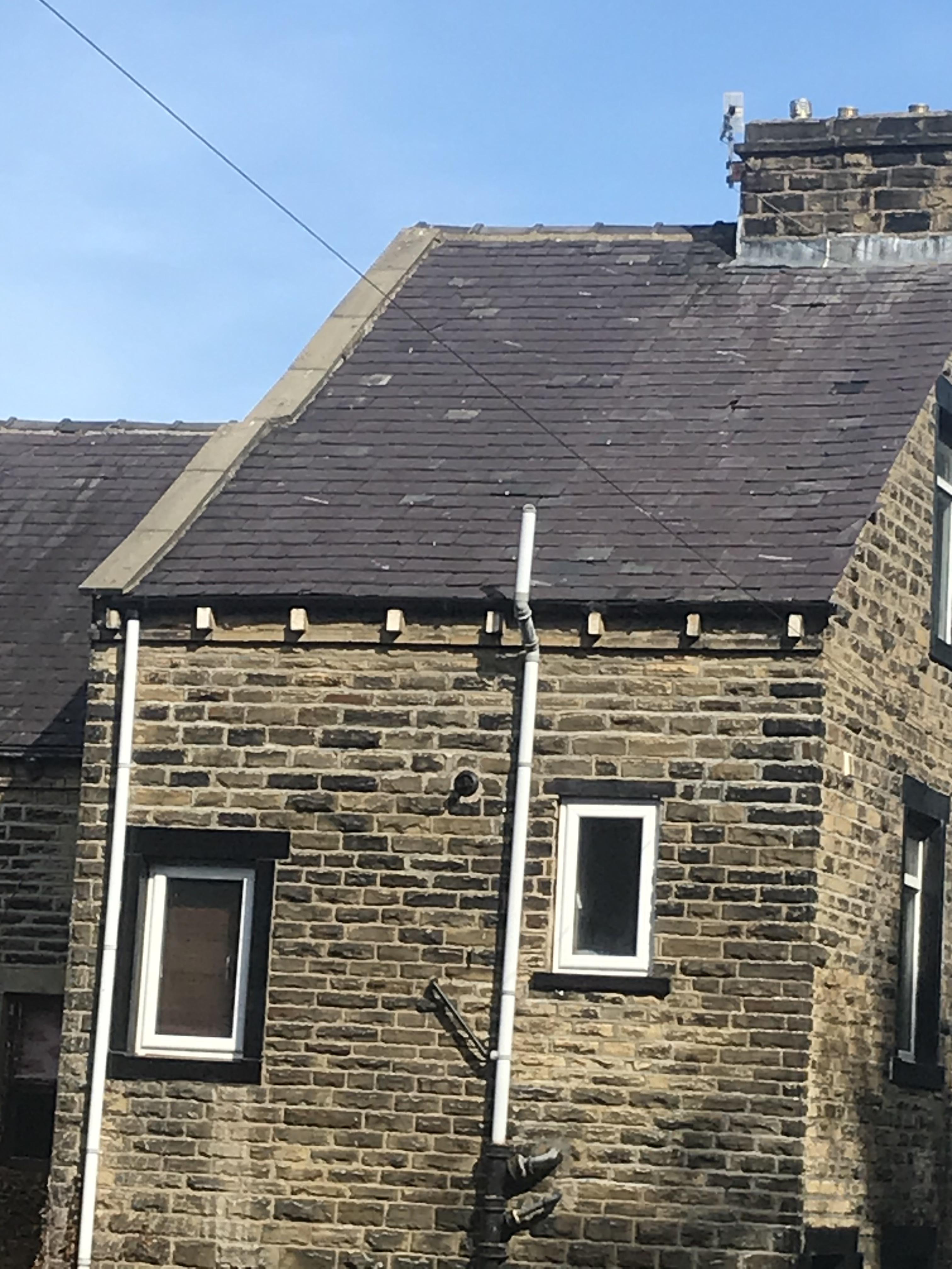

Why ? Because there is a room in there. I have added 50mm 6 yrs ago on the underside of the old lath/plster ceiling. So now i'm doing the roof i want to add 50mm more. It would be more, but the rafter depth is 75mm, so i need to leave a 25mm air gap. Not ideal i know, but if i get some air vents in then it should be ok. Someone on facebook said to put 2 slate vents at the bottom and 2 at the top. Seems pretty straight forward to me. -
I am reroofing a pitch on a house i rent out. I am taking off the old tiles and will sell them. I am using spanish slate to replace. So i will fit 50mm insulation between the rafter and leave a 25mm air gap. Then fit tyvek supro breathing membrane, then lats, then tiles. Do i need to put some ventilation in ? If so do i do it across (from side to side), or from ridge to eaves. I am just not sure what to do. I will be reusing the current ridge tiles, but could buy 2 breathing ones, if this type of ventilation is needed.
