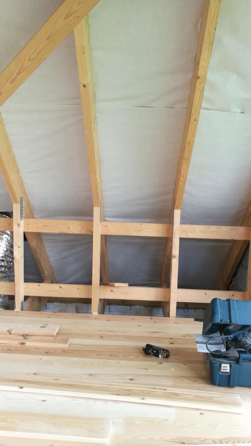

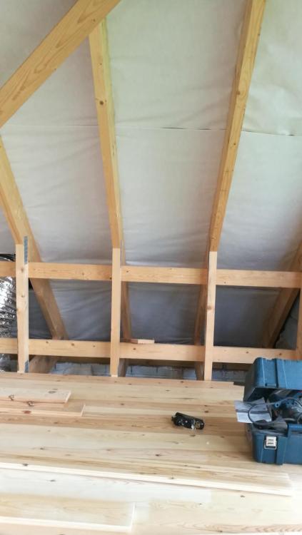

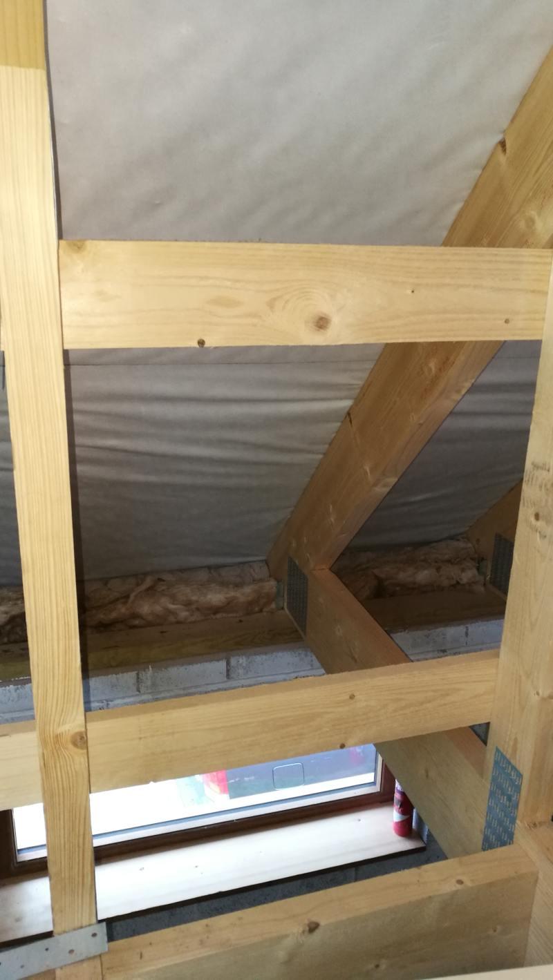

  14. I have had a garage built, with an office room above, and need to insulate the roof - similar to a loft conversion I'd guess. - please see my post here: Can anyone recommend where in West Mids to get the PIR insulation from?
  15. Hi there, I have had a garage built, with an office room above. I now have to insulate it, once the electrics are done. The Building Control guy said I need to use 125mm Kingspan/Ecotherm etc PIR, and then nothing else would be needed. My original builder said to put Kingspan in (but not as thick), and then use insulating panels under the plasterboard. I prefer the BCO aproach, as the room above is small enough, without putting additional panels in to make it even smaller. Is either option correct? Also, when putting the PIR in, do I go right down to the wooden beams that are sitting on the concrete? (see second picture below), or do I need to leave a ventilation gap anywhere? Thanks.

  19. Thank you both. I did wonder about getting it vertical, and was planning on doing what you said Joe. Pete, do compression fittings allow the pipe to be rotated in the fitting after it's connected, or do I still have to get the tap put on first?
  20. Here's a basic plumbing question for you. I have this outdoor tap, and pipe with a connected fitting. How do I attach the tap to the fitting without it leaking? I've tried the rubber washer on the outside of the tap thread, and the fibre washer on the inside, and it still leaks under low pressure. Should I be using PTFE tape on the thread perhaps, or am I using the wrong kind of washers? Thanks.
  21. Thanks Tony. I'll discuss it with the building regs guys.
  22. Ah ok - and would I put that under the Redwood floorboards, or above the ceiling plasterboard of the floor below?
  23. It's a detached garage, and the room above will be an office. It' won't be used to live in. Does that make a difference to the regs that I need to meet? Another silly question - Why is a vapour barrier needed? Are you talking about under the floor? The ceiling below (i;e. the garage ceiling) will be covered in fire proof plaster boards - there's no risk of moisture coming up through the floor (unless there's something I'm missing here)
