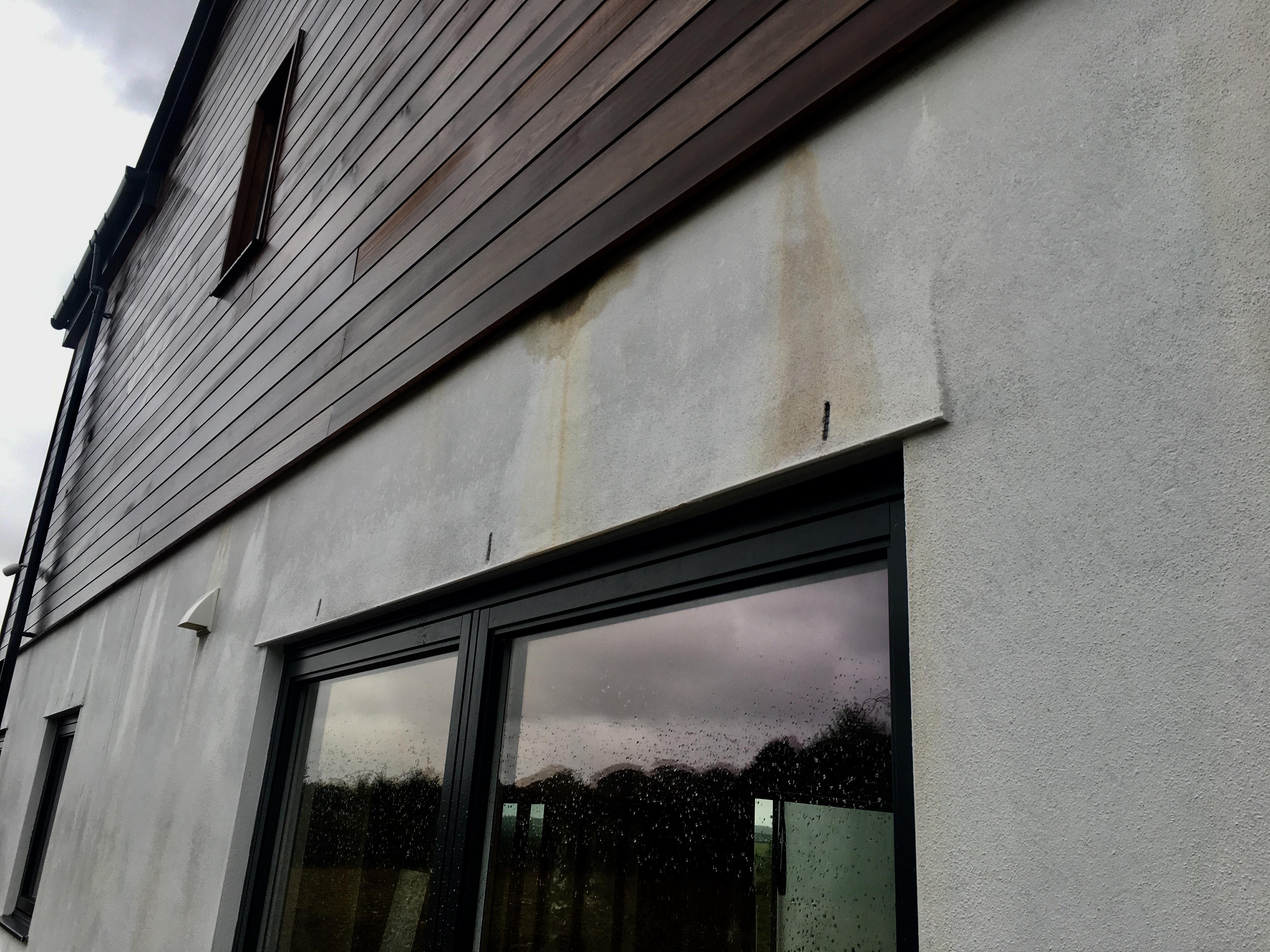

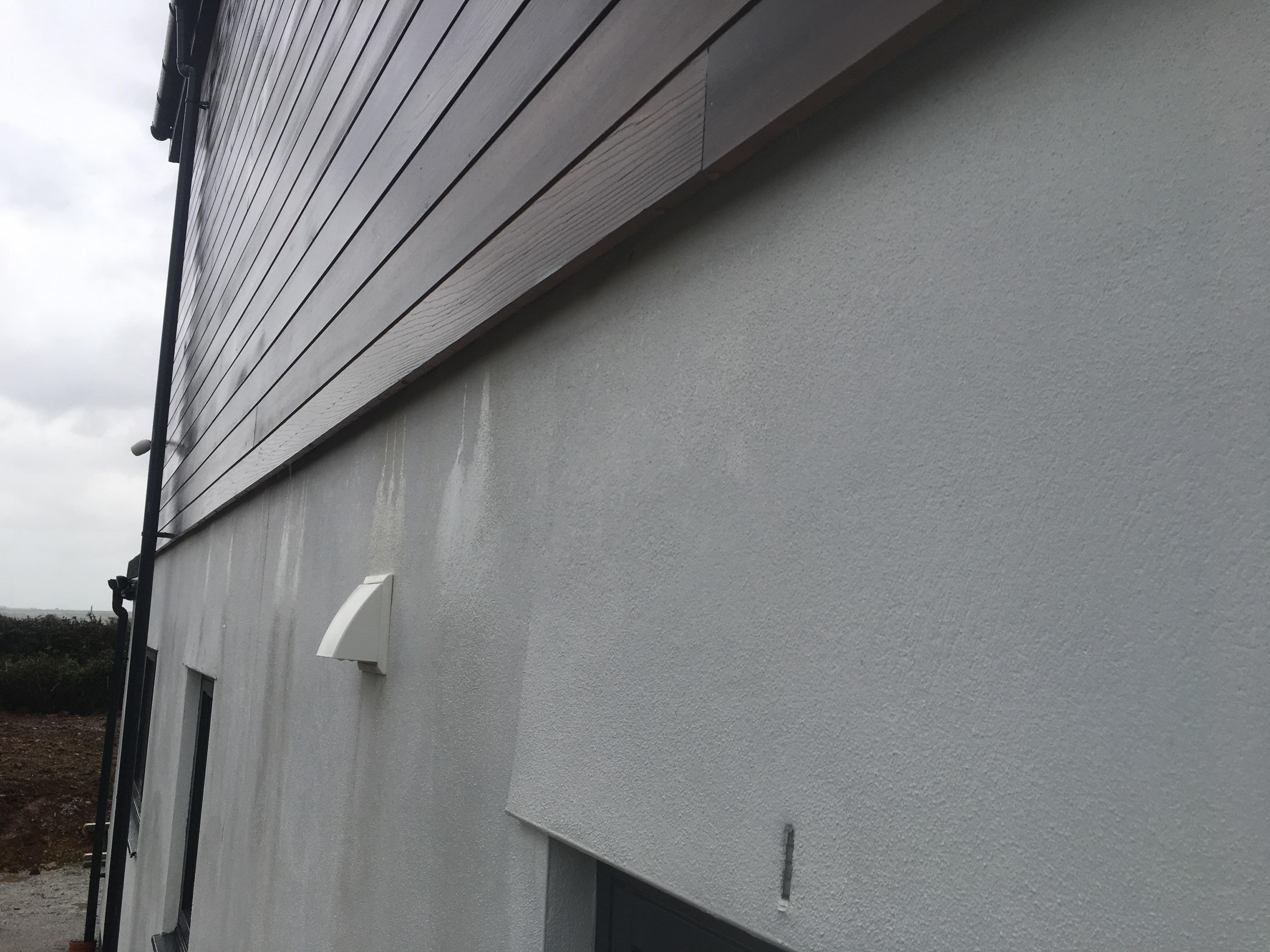

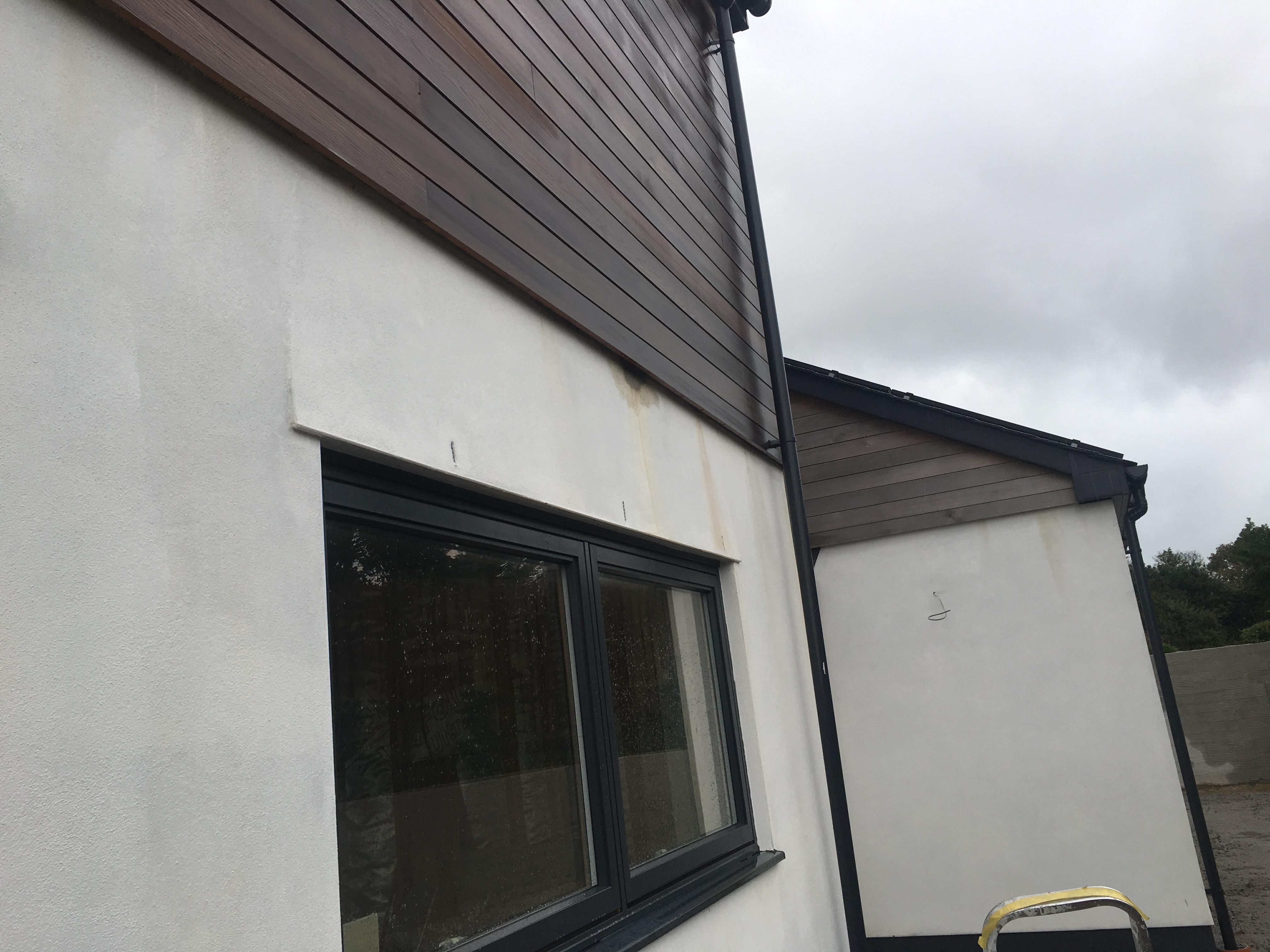

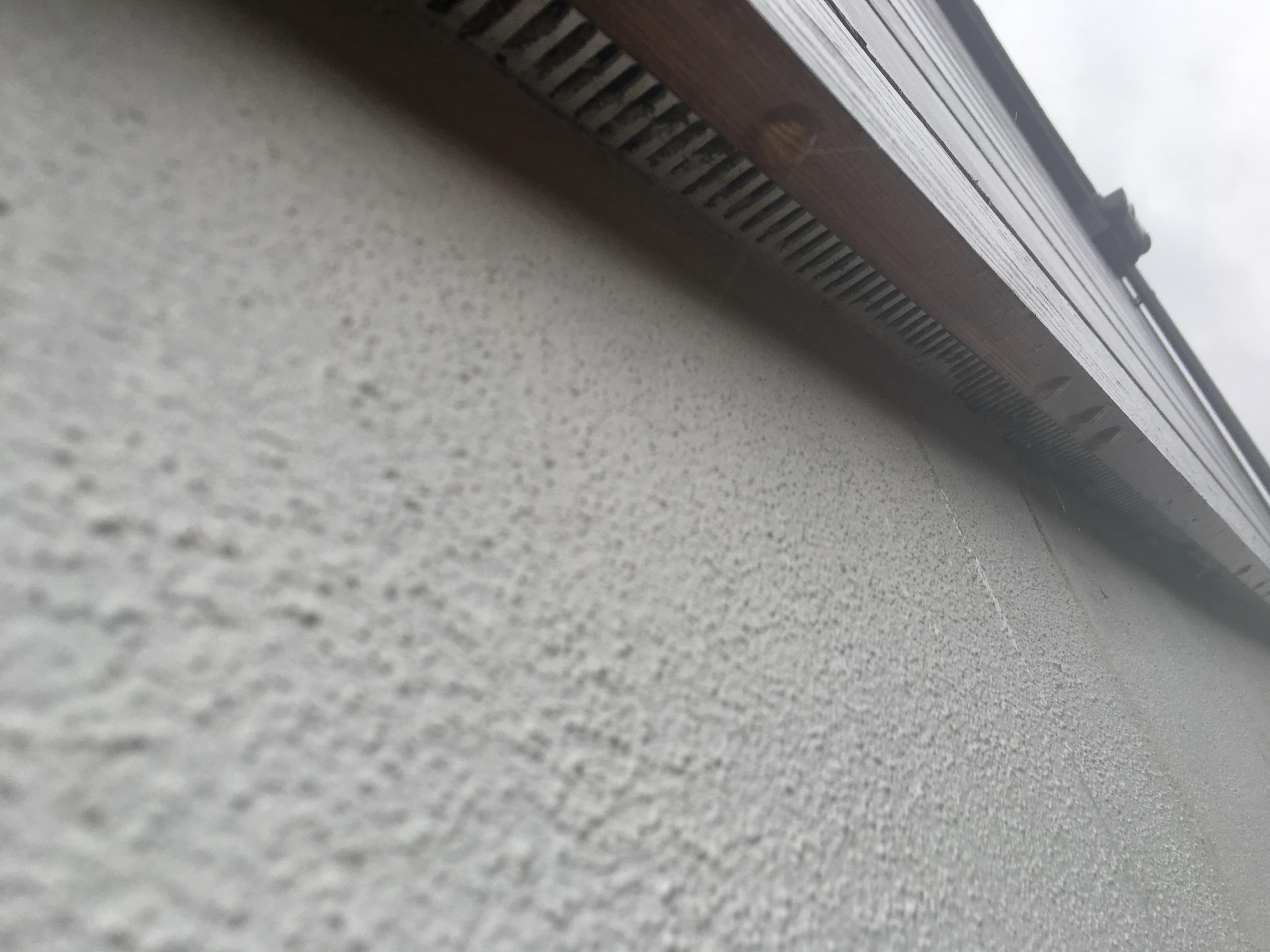

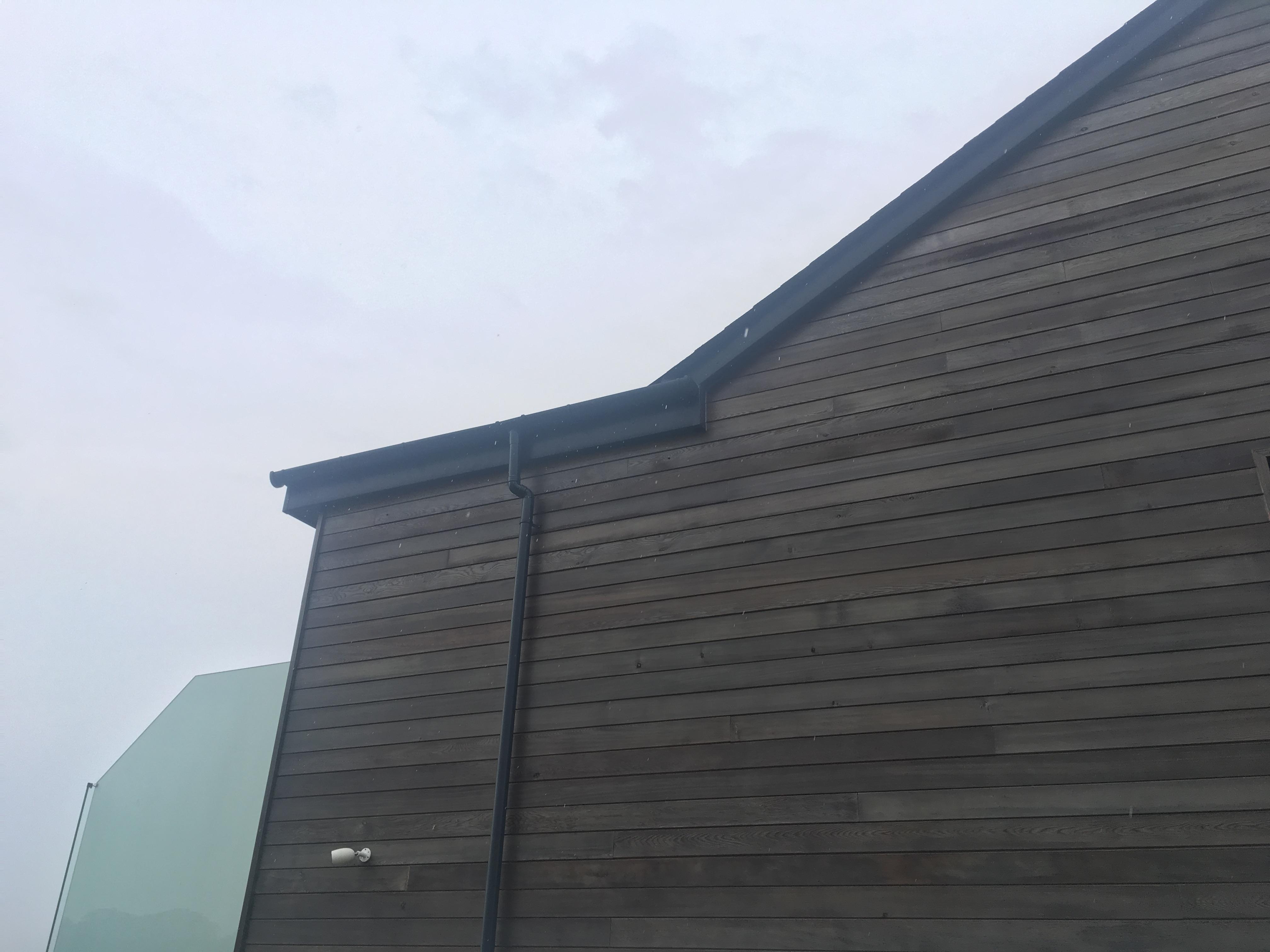

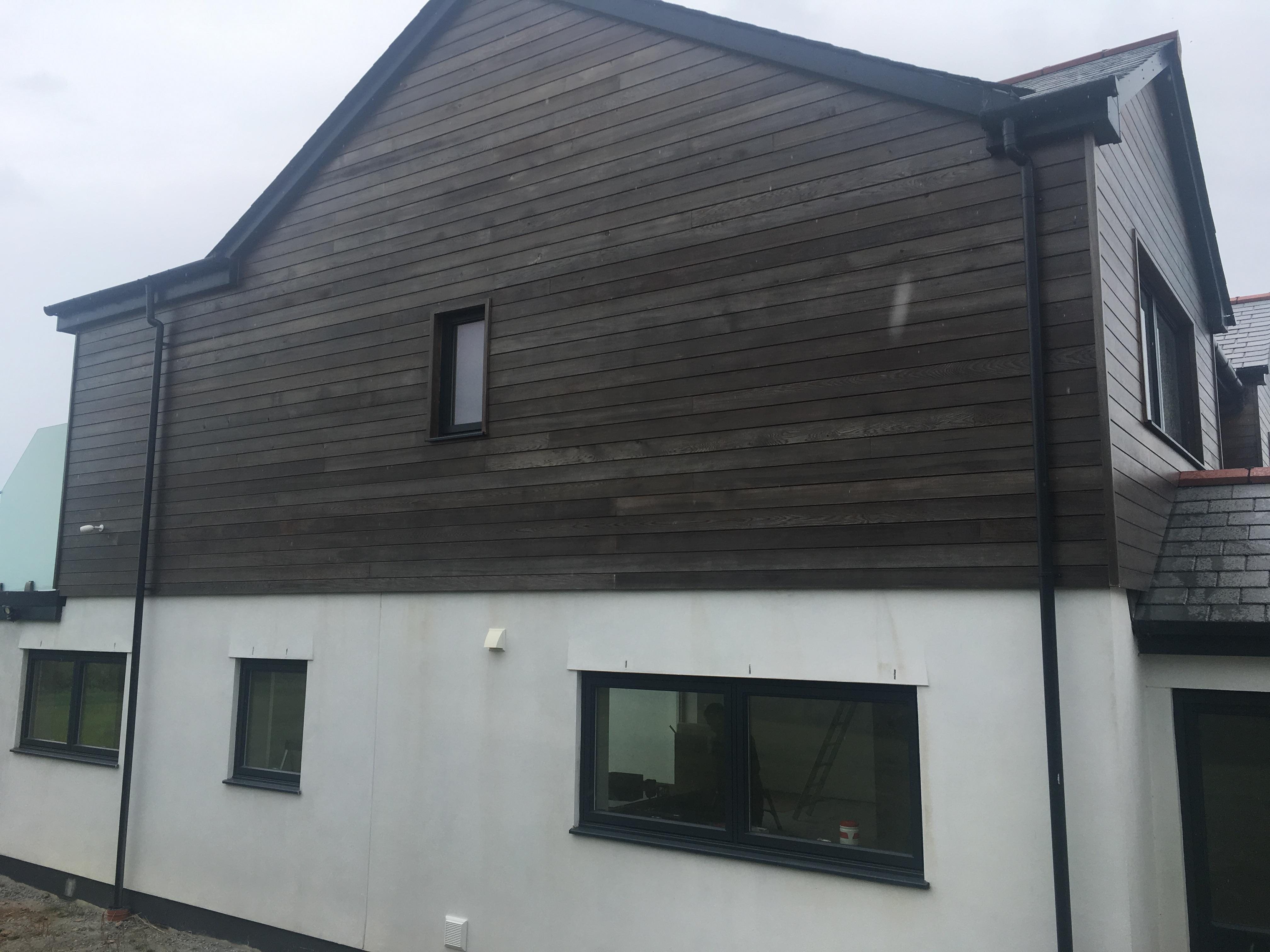

New Member (2/5)

  1. I think there were weep vents put in there but even if it was leaking from there, there shouldn't be any rain getting into the cavity above the window. Also, it is happening in multiple places away from the windows. I've been up there and had a good look at the roof line - there is nothing obvious. The felt looks like it is lapped over to prevent any water getting in under the tiles. The soffit is fixed to the timber frame - it's timber frame with a block skin. The blocks are then built up to the underside of the soffit. There is compriband tape sealing the gap between the cladding/blockwork and the soffit.
  2. Thanks, Peter. I think there was some rain getting in at the bottom of the cheeks on the window reveal but I think I've stopped that. It's still happening elsewhere, away from the windows so it's a bit baffling.
  3. Thanks, Dave. It's pretty wet at the minute but when it dries out, I'll have a go.

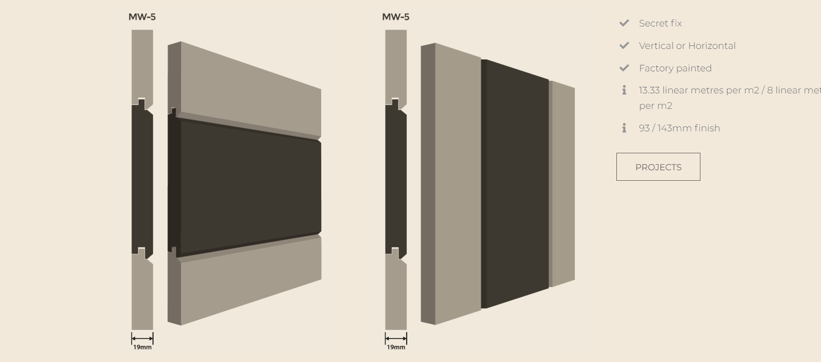

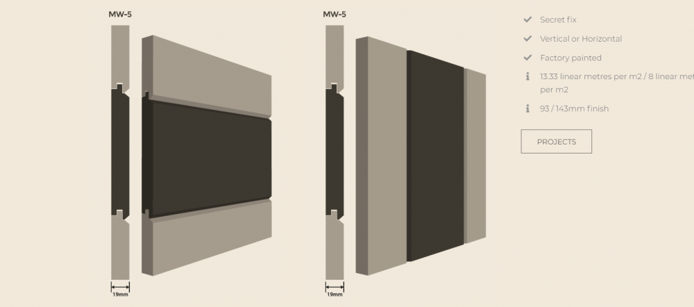

  4. Hi Tony, Here is a drawing of the profile.
  5. Hi Declan, Just taken these shots, hope they help....
