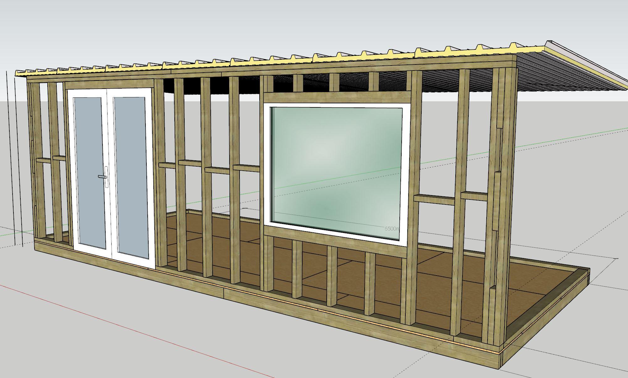

  4. As per the title, is there any reason why I could not use cavity slabs in a garden room flat roof? The roof is a cold roof, I have 125mm roof beams and am allowing 50mm under the deck for air so have 75mm for insulation and the cavity slabs are cheap and easily cut and fitted. I don't have the budget for PIR boards.
  5. Hi, im debating what insulation to use for my garden cabin build. My floor has 70mm PIR but i'm thinking about wool for the walls and ceiling. My roof is a cold roof so will adhere to the air gap above the wool etc, but can the walls be full filled with wool?

  10. Hi Dan, I'm sat here starting to actually put the design into SketchUp, makes it feel a bit more real! I'm doing a build very similar to Aly 3m x 6.5m and used as an office/studio/garden room. I think it does require building regs but i plan to have a chat with the council about this at some point. My current quandary is what to use on the roof. I'm limited to 2.5m height so cant use a warm roof so its either cold roof or insulated roof panels. The latter is appealing as they dont require roof joists as they are self suspending but the risk of wind-suck (!) makes we weary.
