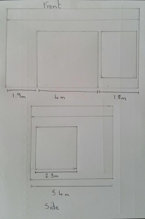

  9. Hi all, Im almost done on the construction of a garden room, im close to getting to the roof part of the build. Ill be having a corner window, but am unsure what to use to span the gap at the top? I was thinking of having a load bearing corner post, which a window friend has said he can get hold off, and spanning the wall plate across to the corner post and then to the other wall. Will this be enough for part of the warm roof to go on top? I was thinking a 100 x 50 wall plate, but should i double this up above the corner window for more strength for the roof beams to go onto? Thanks for any advice. Cheers Joe

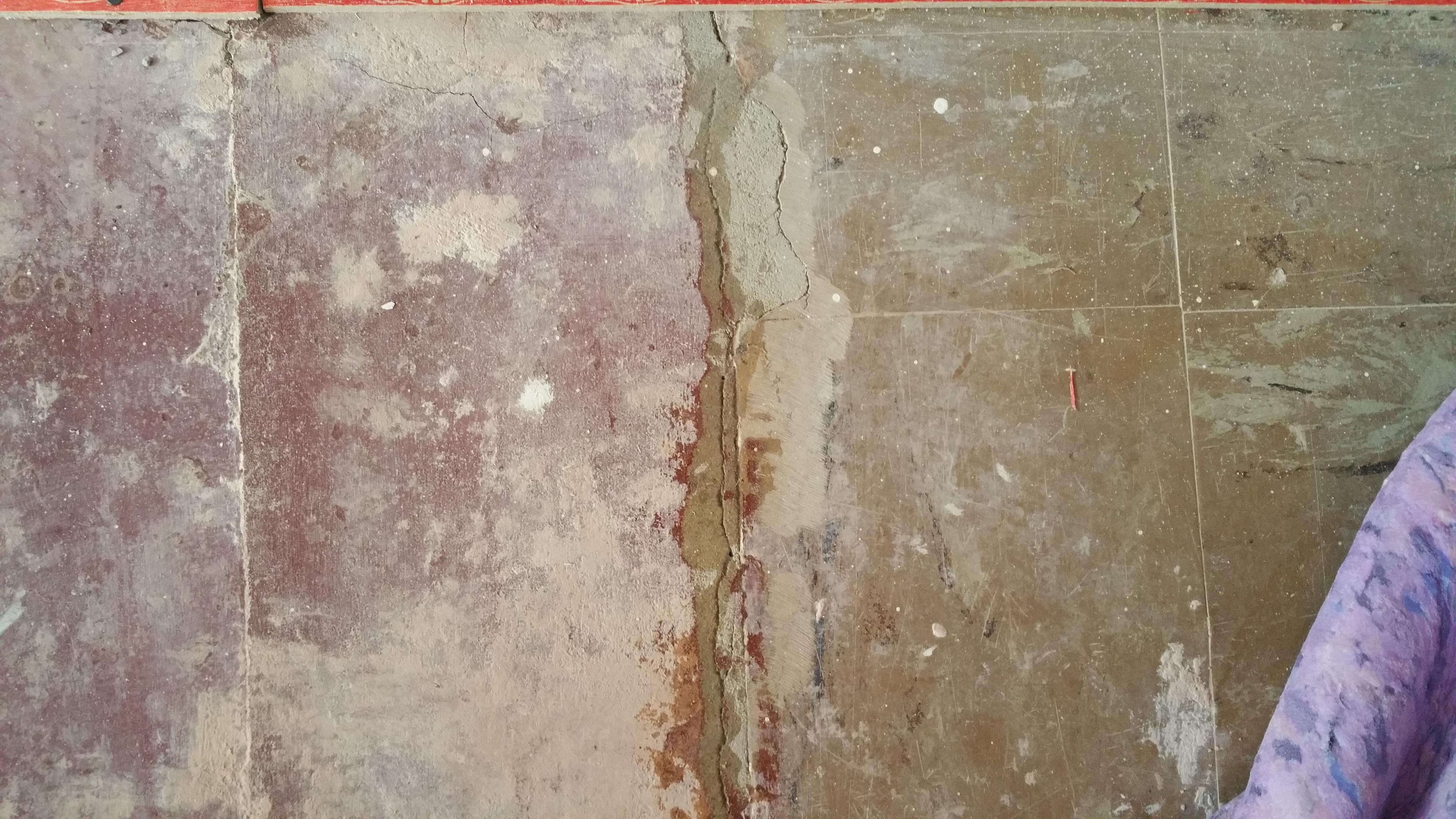

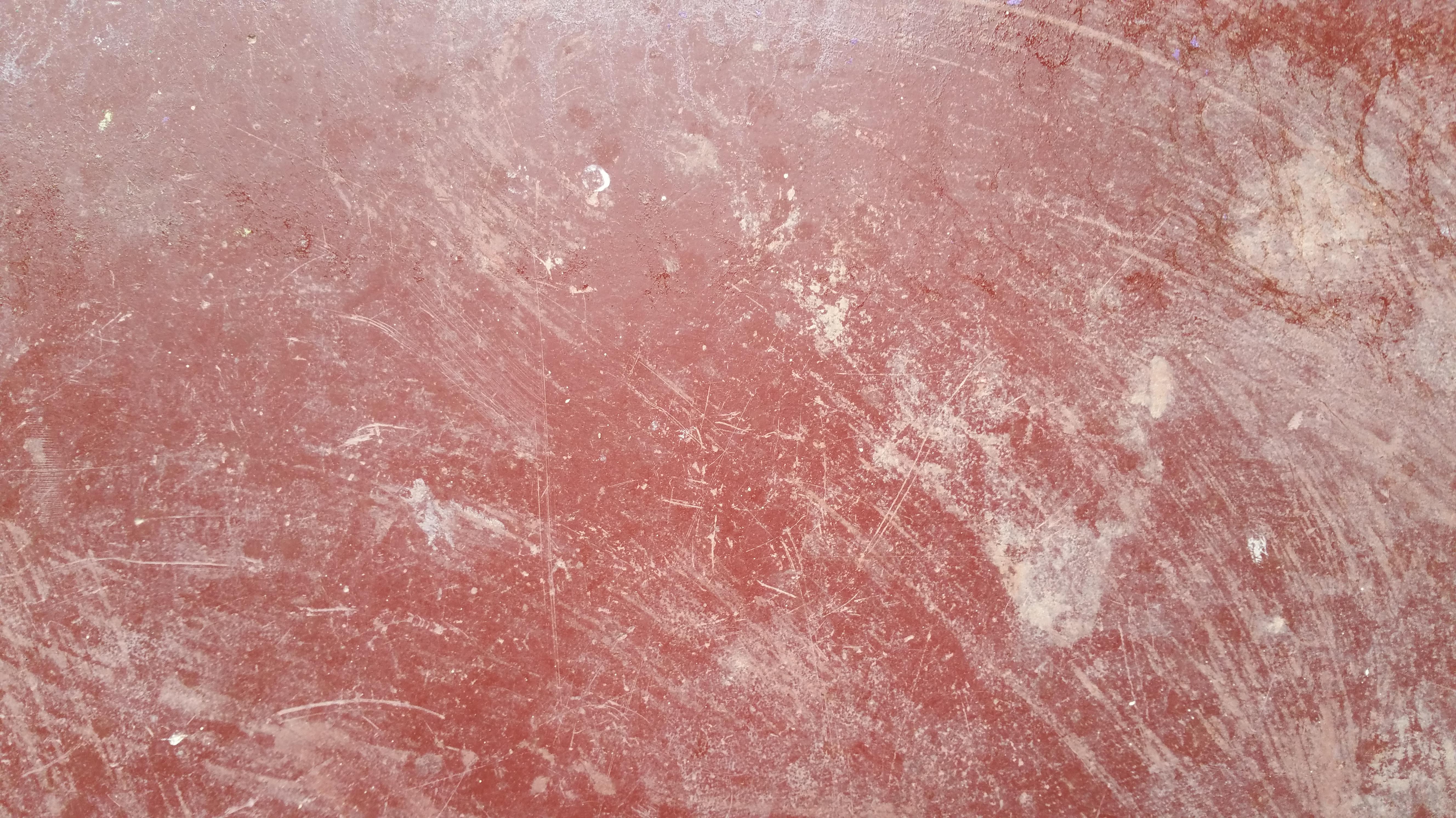

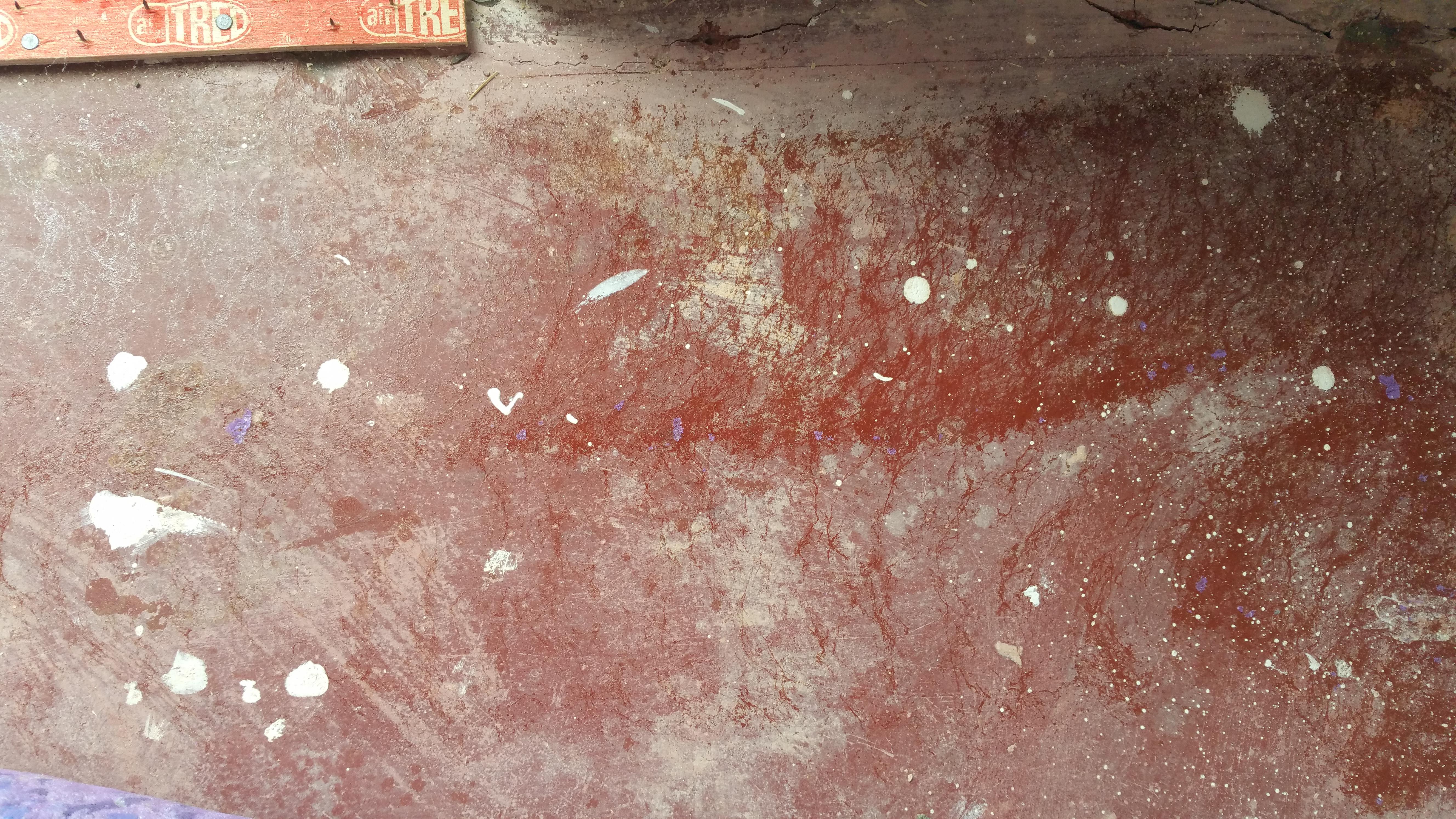

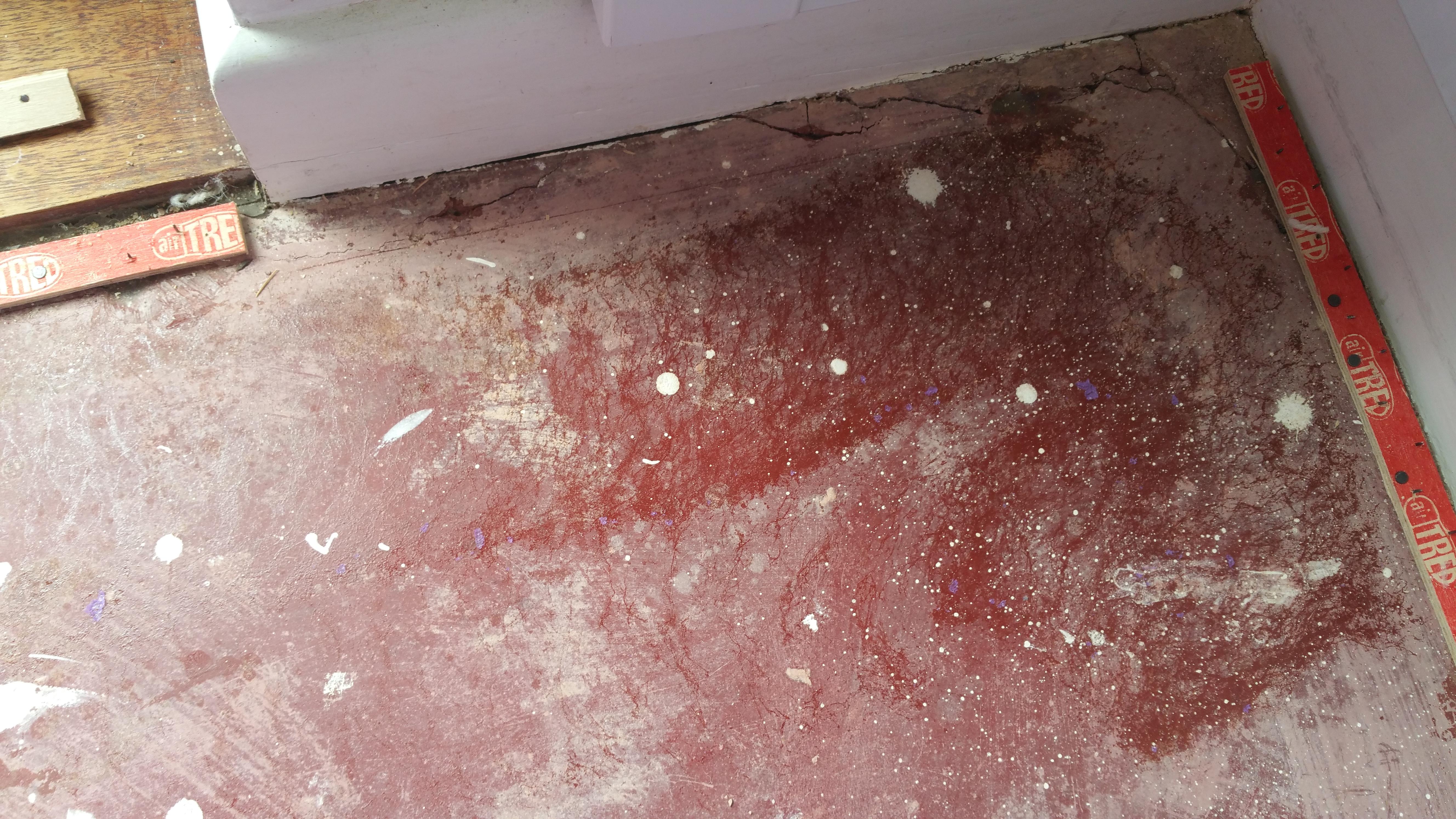

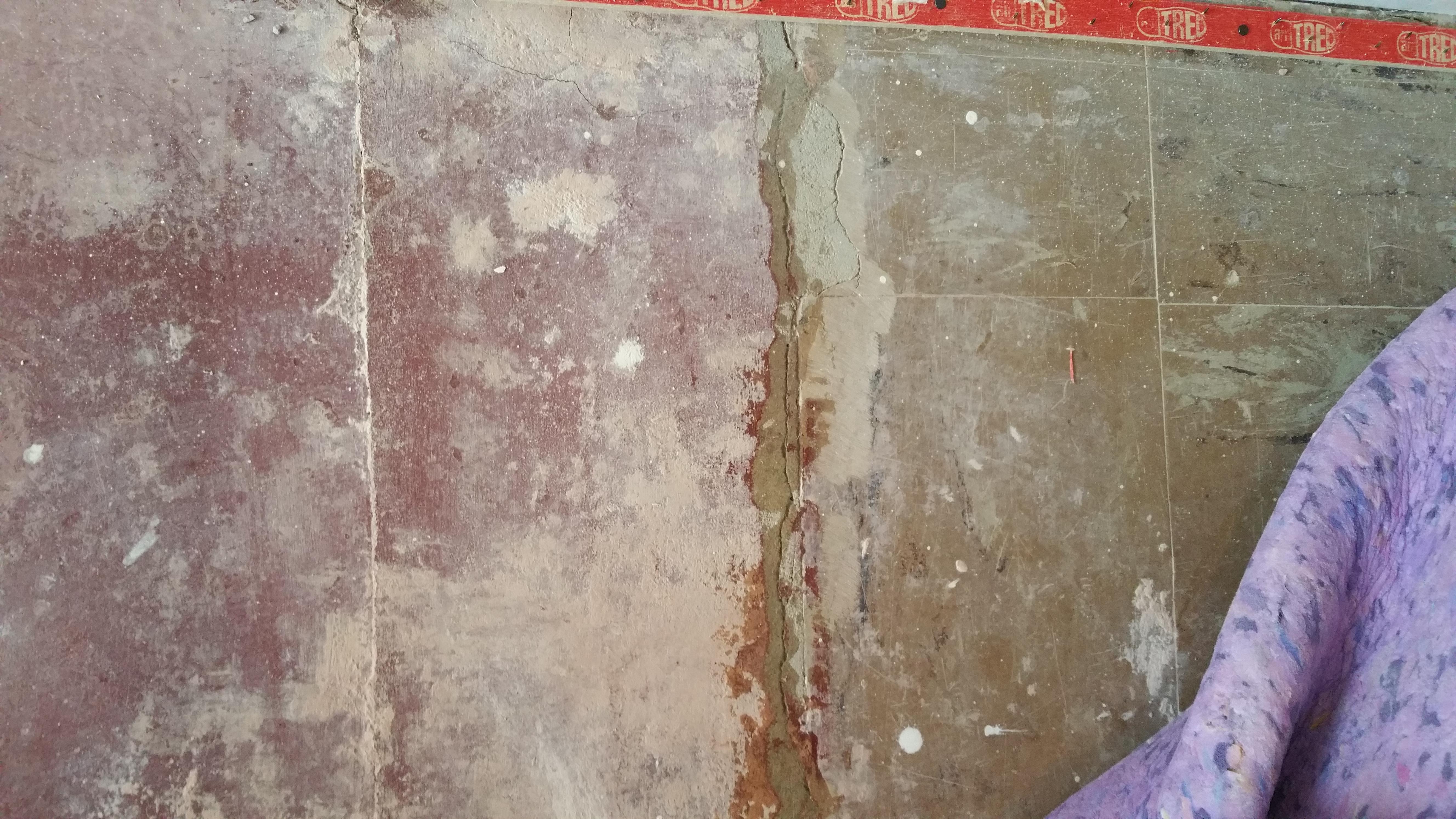

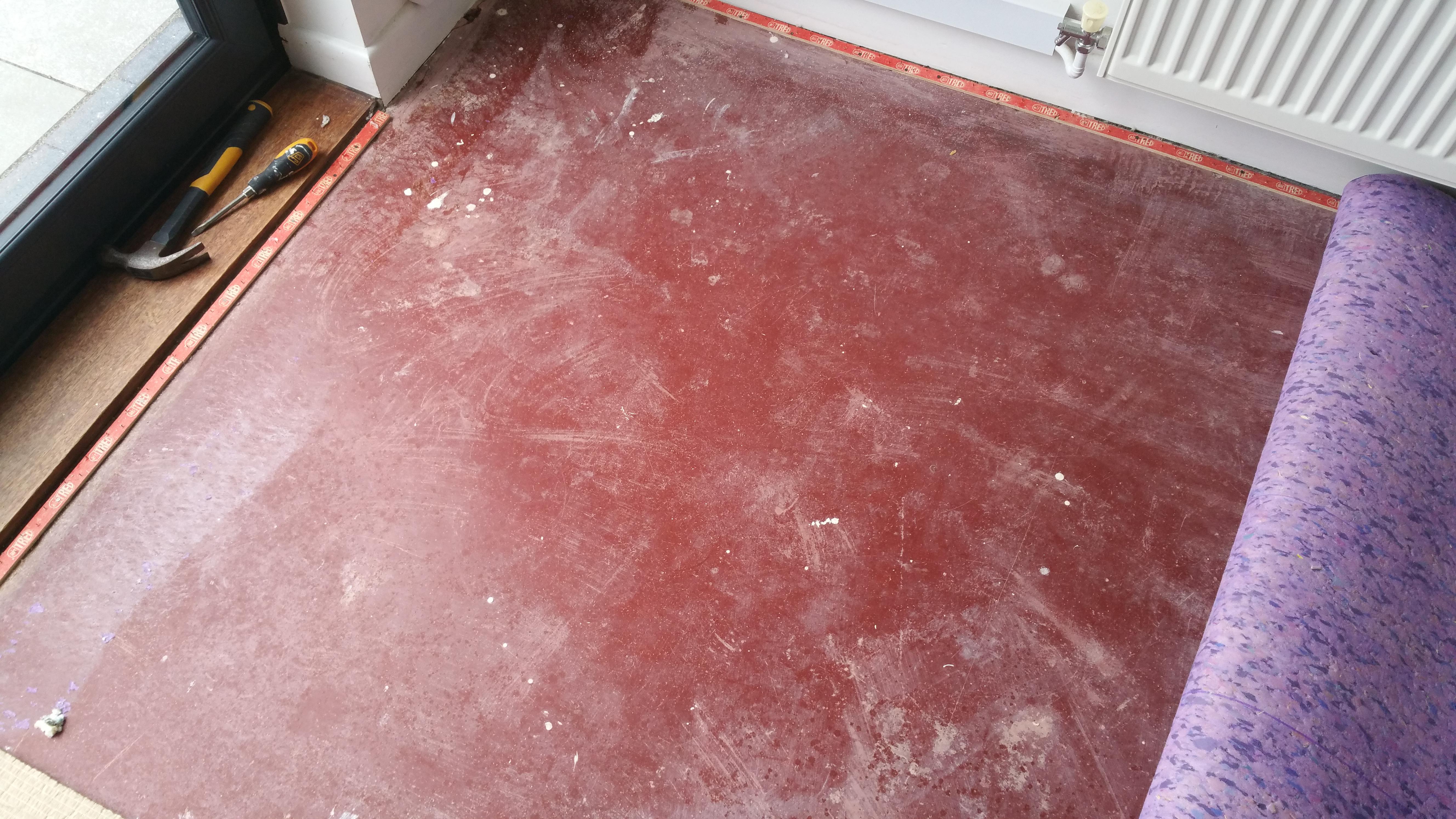

  16. Ive had a bit more of a research and i think it might be a magnasite floor? It may not be the red ash as first thought? Still looking into it but it may be only a case of about 1-2 cm that will need to come out. Like i said i need to look into it a bit more. No job ever seems to be easy in this house. No matter what we get done something is there to cost more money and time!
  17. I plan to drill some holes to see how deep this stuff goes, but if I did go about digging it out what would I need to do. Obviously get all the red concrete out but then do I lay the vapour barrier and have concrete poured over the top again to give a level surface? Thanks everyone for the help so far. I am wondering if it would be best in the long term to dig it out.
  18. I'll be really happy if it's as simple as that! I really don't want to be digging out the floor. You may have made my day. I'll look more into what you've suggested. Thanks for the information. I found it really hard to find anything about it online. I knew someone here would know something about it :D. Thanks
  19. Hi all, We are looking at getting hard floors put down in our front room/dining area. We've had someone over to get floor samples/ideas, when i told him about the red floor under the carpet that we have. He said that after ww2 they were running low on concrete and so started using a different type of material which is hell for hard floors because of vapour being released. A carpet allows the moisture through, but hard floors could potentially eventually get damp and pop up because the moisture can not pass through it. He told me all this before i told him the house was built in 1947 which falls in line with what he had to say. Im not questioning him at all and i trust what hes saying. Hes gone through alot of effort to find out as much as he can about the floor for us. Hes basically said we could have the hard floors but there is a chance that in the future suddenly we have floor boards springing up from damp, so he wanted us to have all the information so we could make an informed decision. I wanted to see if anyone on here had any experience with this stuff (composite floor i think he said??) and if so what did you do about it or what do you know about it? Im tempted to drill a few holes to see how deep it is (From parts of it cracked on the edge i think about a cm deep...atleast on the edges) and if it would be possible to dig it out and have concrete filled in with new vapour barrier etc. Obviously all this is added cost to a job which is already pricey. Anyone have any ideas or experience with this stuff? It only seems to be in the dining room although under the front room area there are tiles so i couldnt say what is under them until i get them up. Although it does look like the red concrete or whatever it is is slightly higher then the tiles as youll see from the images. So maybe it was poured after the front room was done?! Thanks for any help Joe

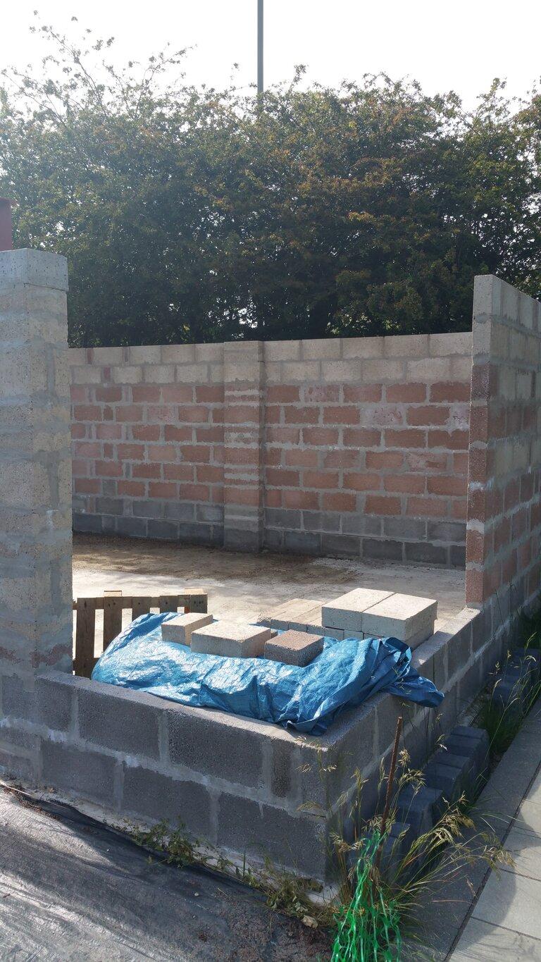

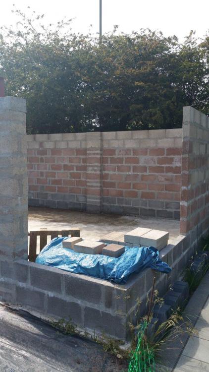

  21. Hi all, I'm building a workshop at the end of the garden. I was planning to build it with single skin dense concrete blocks with a timber frame inside for a small amount of insulation etc. Which type of block would be better though, the dense concrete block or dense hollow breeze blocks? My second question is, the back wall will be about 9 meters long. Do I need to set columns into the wall for strength and if so what is the distance I would need between them? Thanks for any help. Joe

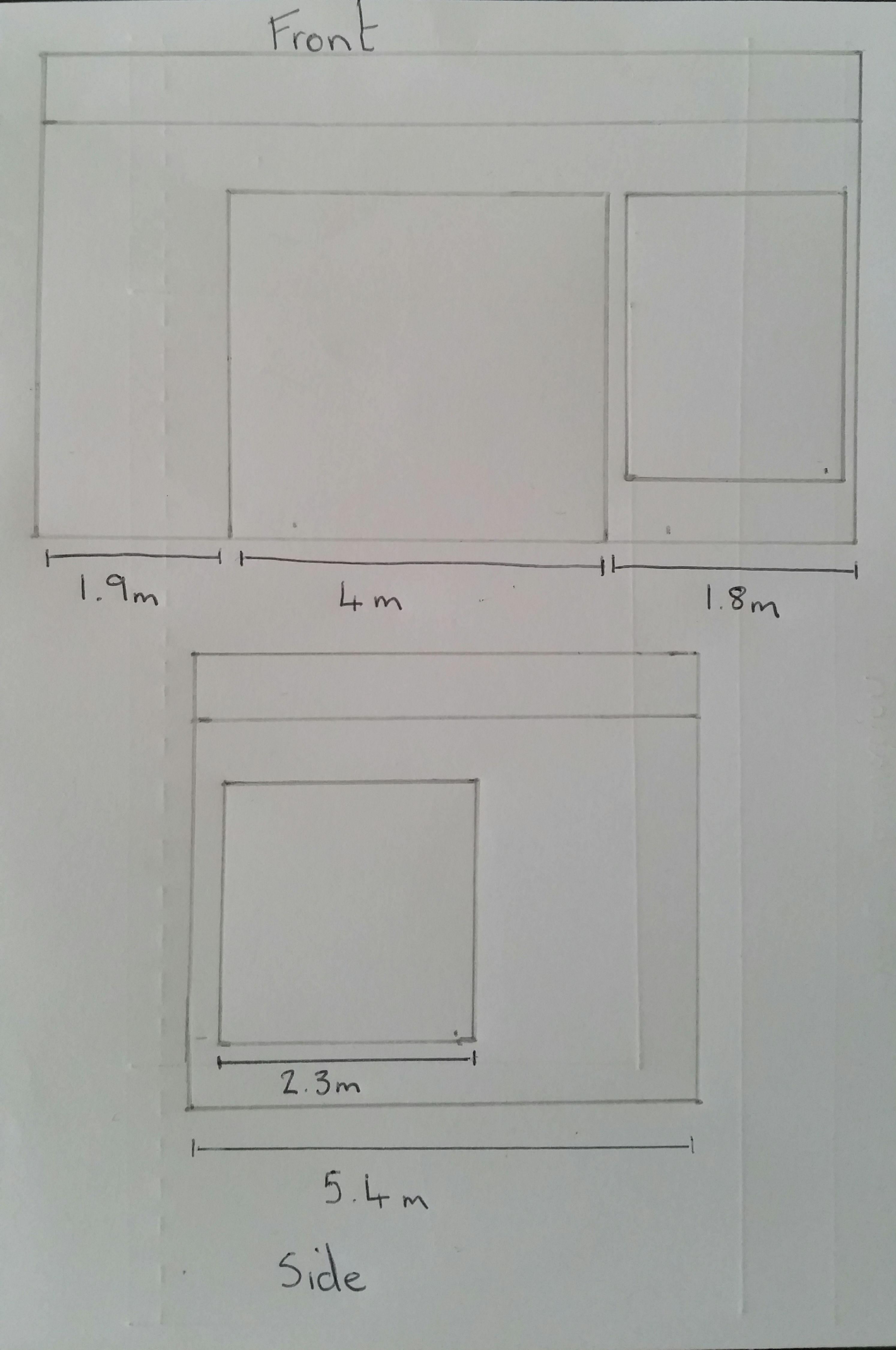

  22. I'm glad you've said this Peter because this did worry me aswell. I was just asking him in passing when he was here to fit some windows in our house. I did wonder if the corner post would even be wide enough to support a lintel let alone take the weight. I think I will definitely change the design to pull back both the windows. It'll make life easier for us aswell I think. Thanks
  23. Originally it wasn't going to be this big but the concrete pad that it will sit on is a large area so I decided to fill it rather then let it going to waste. I was planning to timber frame the inside walls, add some insulation plaster board etc. Aswell as insulate the floor and have a warm roof. It will be a games room/ bar area but also a place to store garden furniture during the winter. Currently we hang out in the garage to play pool etc, which is also a single skin with no insulation at all. I haven't looked at the windows yet but the bi fold I can get for about £2500. This is not an all in one build. This is very much going to be a thing done over time but I really wanted to get my head round everything. The walls, floor, warm roof are all straight forward but I had no real idea of how the joists would attach above the bi-fold and corner window. I have been told by a window fitter that a 90* square corner post can be used which the will have the corner windows attach to and they can be load bearing. Thanks.
  24. I've attached a really basic drawing with some of the sizes. Is this what you meant? Cheers
