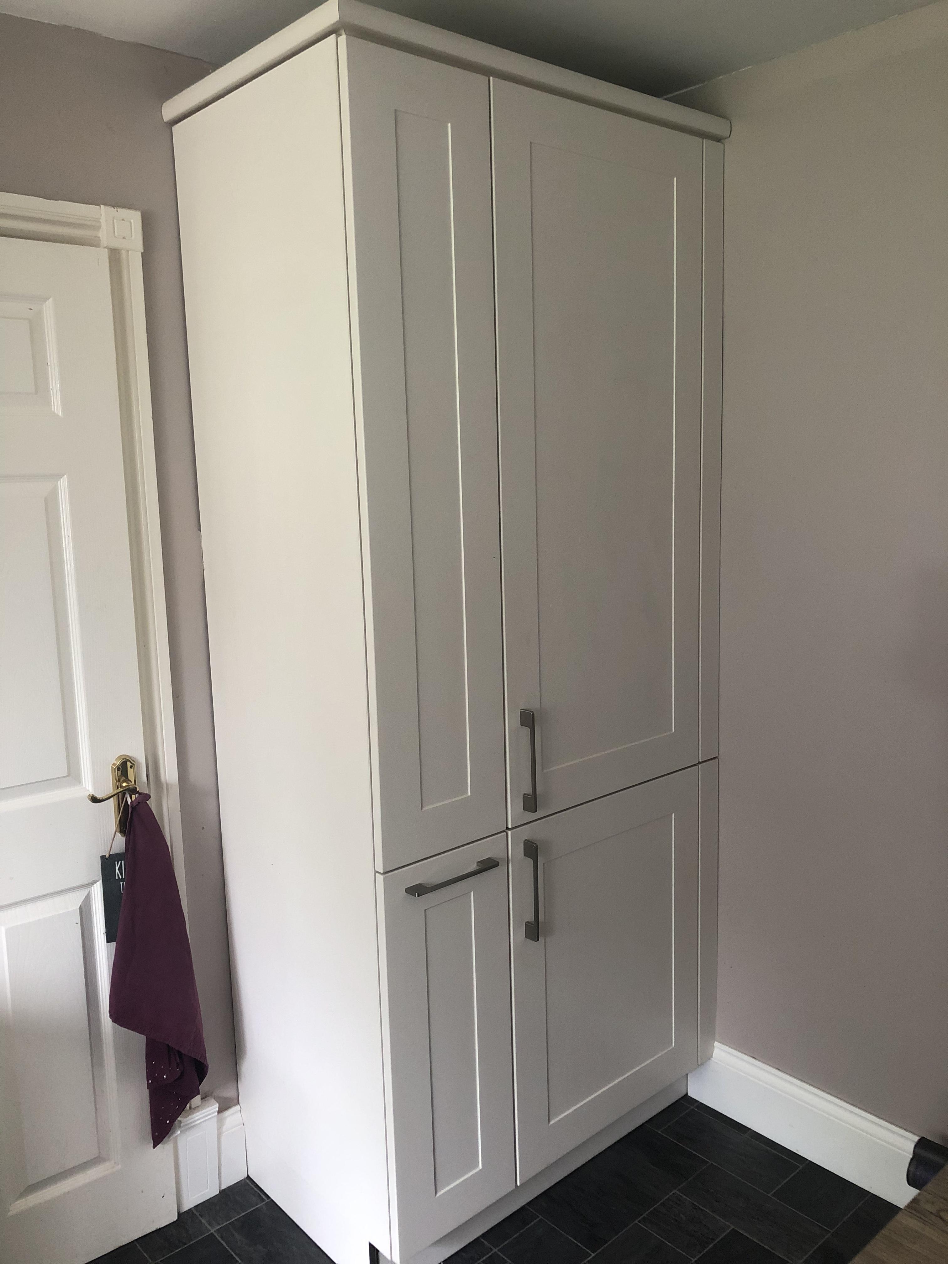

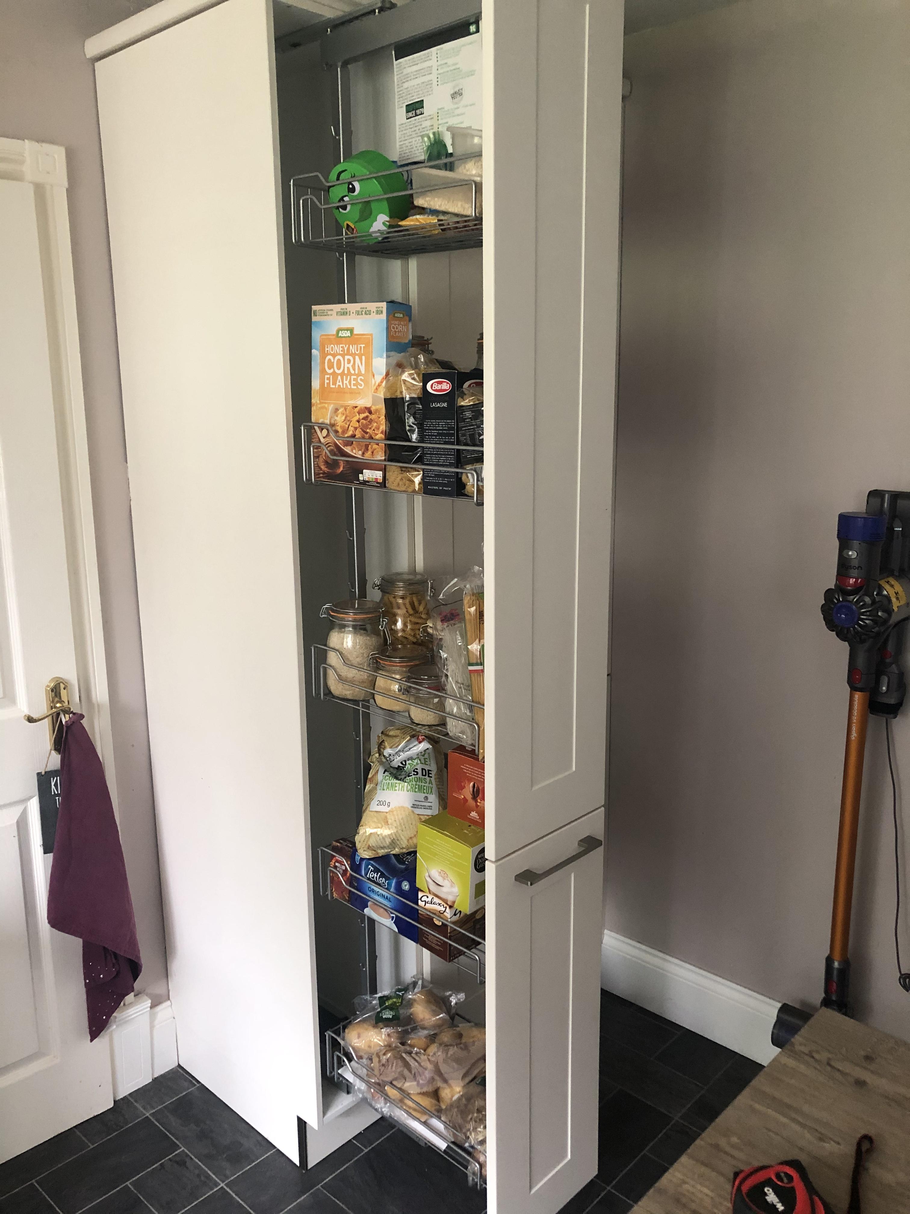

Why not have a slide out pantry unit rather than a door that swings open? We have a full length one sat next to our fridge and it works perfectly -
