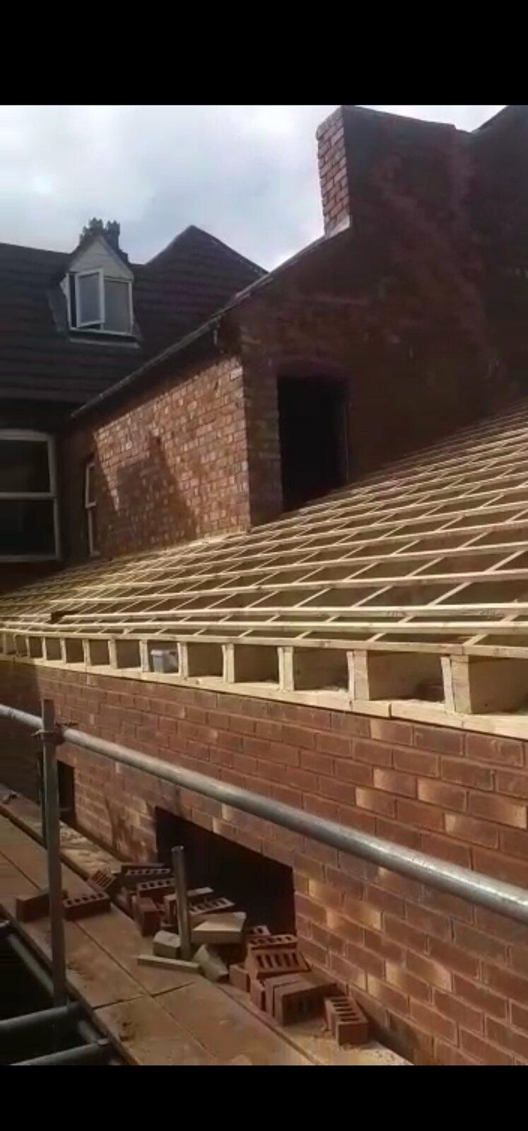

Wow thank you everybody for your input I'm learning a lot and I appreciate it every comment made. So obviously now reading these comments maybe tiles is not the best way because there's no much slope. One of the poster message me and said I should do use EDPM. It's a lot better than using tiles and a cheap option. He said on the back wall then you should bolt on a 4B2 along the last course of block. And then for the rafters to use 5B2 with 500 mil intervals. And then some plywood board 18 mil thick. And then the rubber. You guys think this is a better idea and is his suggestion for the timber correct
Thank you for your response. I had to look at this calculator but I'm not a good person with numbers or maths. It looks like it's telling me if I put the numbers in that I should use 4x2 rafters. I'm not sure if this is correct or not Also this refers to a flat roof but I'm trying to do a pitch roof which I can put roof tiles on.
Thank you for the response, So the back wall is actually the boundary wall. It was originally made out of bricks and then I added a few courses on top to raise the height of it and then the last course I made with blocks. The rest of the walls are block. I want to use tiles as opposed to felt or fibreglass sheeting. I want to create a slope in the form of a mono pitch roof. I understand there's not much slope but there is some so I was looking to know what size rafters I will need and what the space in-between needs to be. And in respect of the back wall plate, when you say it has to be 4inches? Do you mean a 4x2 timber bolted to top course of concrete block.
Hi all, Would really appreciate if somebody would give me some advice. I'm building a block shed at the back of my garden. It's dimensions of it's just under 5.97 m long and 2.6m wide. The front wall is 2.48m high And the back wall is slightly higher at 2.71m I know this isn't much difference in order to create a slope but this is the best we could do. I'm looking to know what size rafters you would use for this mono pitch roof. Also what would be the space between each rafter. And lastly for the wall plate at the back on the higher wall what size timber would you use. I have read for the wall plate, it should be 6x2 and then the rafter in front of this would be 4x2 Please anybody can advise I'd appreciate it.
