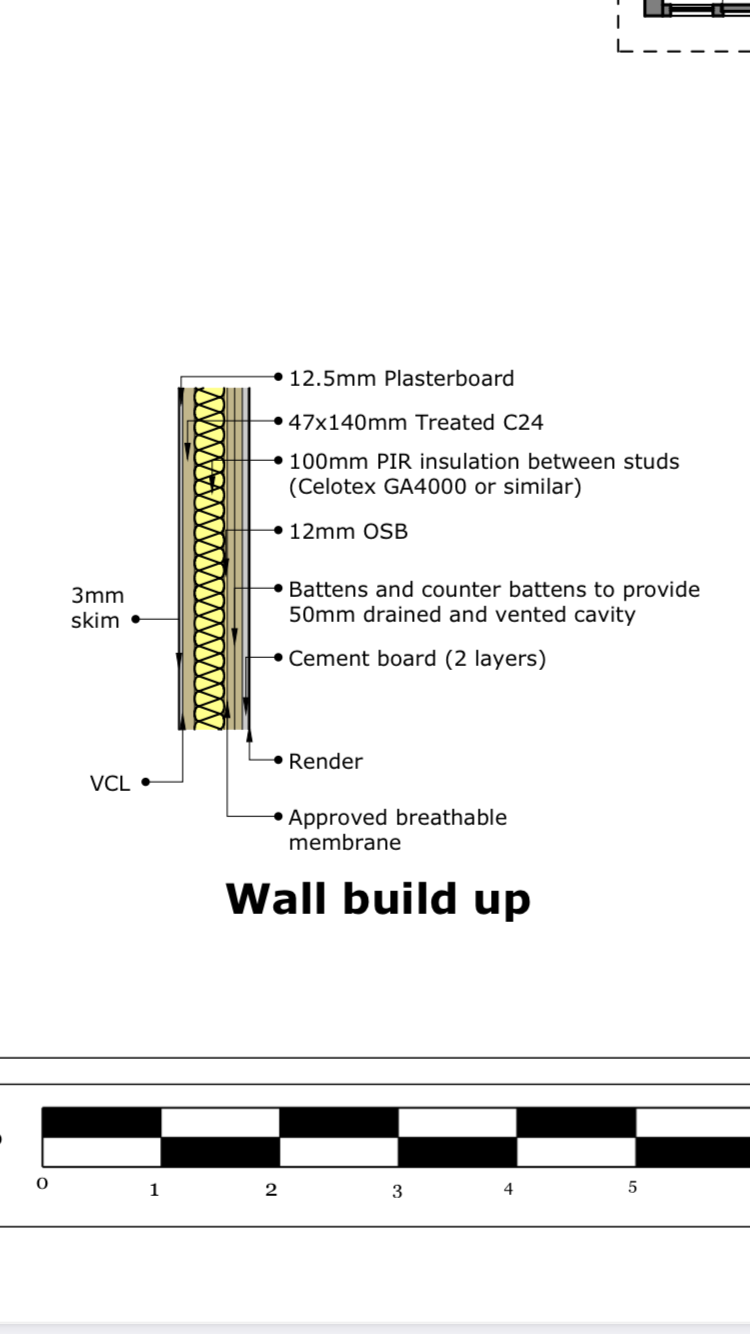

Good suggestion may cut the bottom of the battens at an angle so they come down a bit too. Also thinking of using marmox blocks under the sole plate as suggested on this forum.

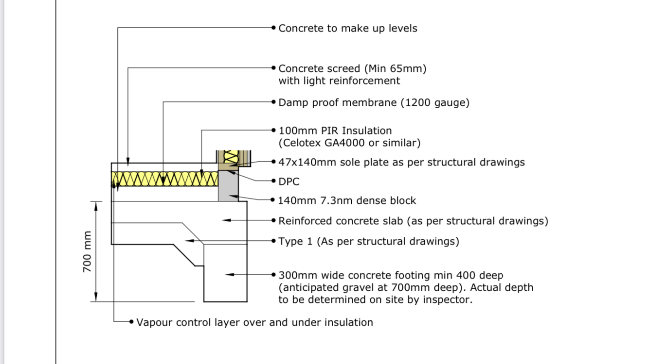

Hi all, been a while since I’ve been on here but finally started the timber frame porch. I plan on adding some insulation on the outside of the 140mm concrete blocks. the screed is above the timber sole plate…not sure if that’s acceptable? any other pointers? Chris
Any update to this? Finally got planning permission, in to building regs now. Be great if you did have a section drawing of the wall/floor connection etc.

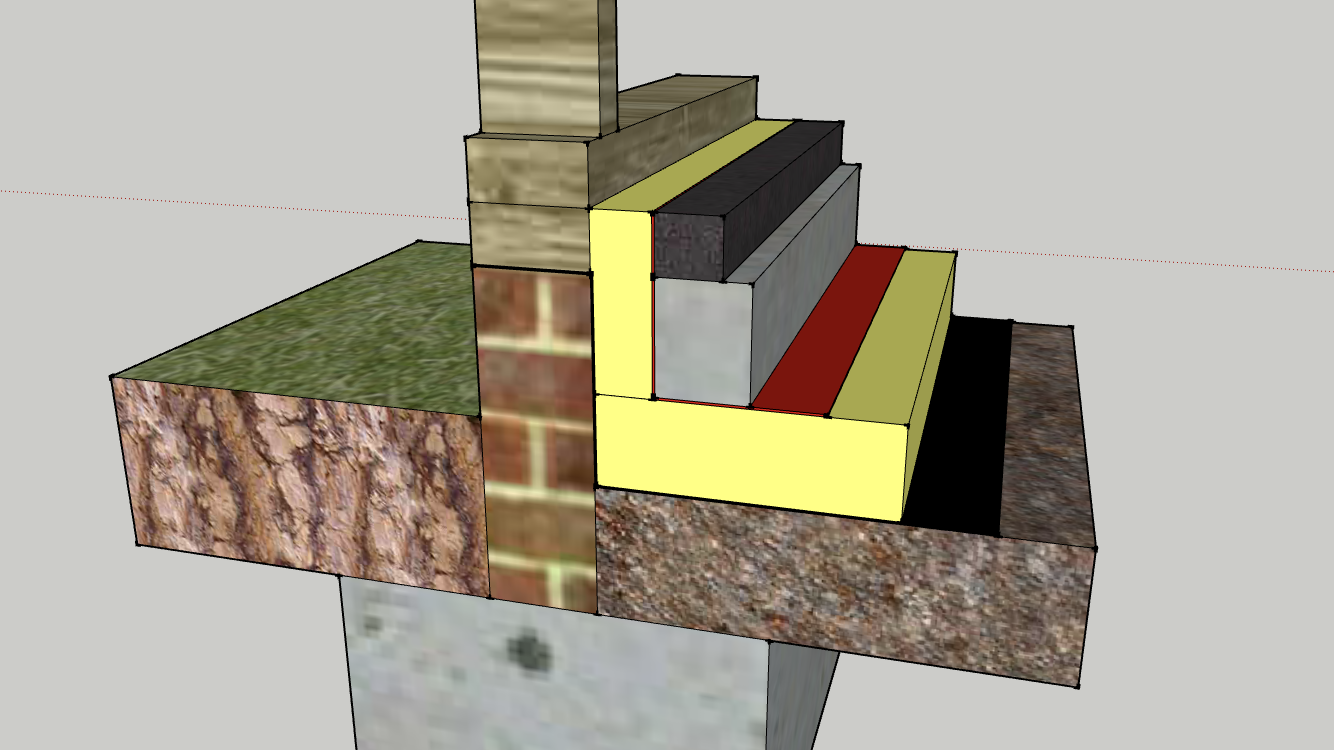

Looking at this again and with what I drew above it looks like I’ll have a cold bridge through the bricks with only 2” insulation between the brick and the floor slab. any way round this?
I’ve drawn this. Think it’s ok based on what I can find online etc. not included makeup of wall just the timber. single skin wall on top of footing with baseplate fixed above dpc. From the bottom. 150mm blinded rubble or type 1 compacted, 1200 dpm, 75mm rigid insulation, vapour control layer, 100mm concrete, 50mm screed. Insulation around edge of slab 50mm thick.
Definitely building above ground with brick up to DPC. Possibly engineering brick with a dark mortar so it looks ok. I’m more concerned with what happens with regard to connection of timber frame to the brick in terms of insulation. Single brick up to dpc and then frame on top is fine but the brick will need insulation on the inside presumably as opposed to cavity wall. Hope this makes sense. The actual footing will prob be same as house. Ground is very solid about 750mm down so BC were happy on rear extension with just 750mm deep. Want to use timber frame on front to keep the walls as this as I can and gain space inside.

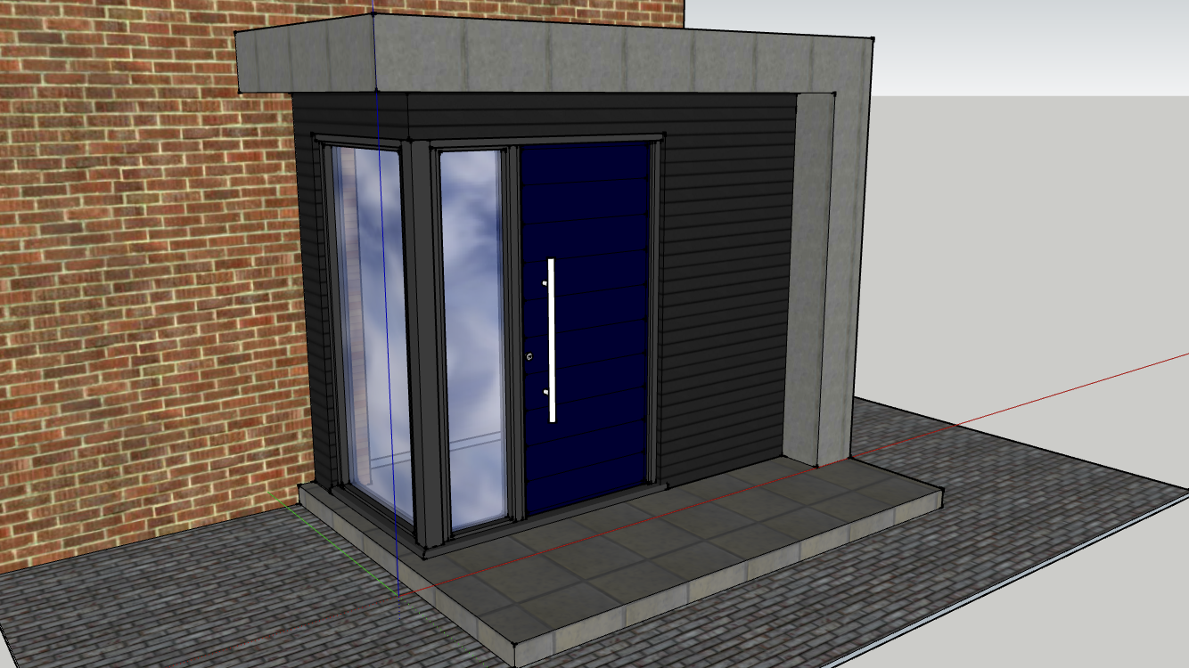

Looks good from that image. This is what we’d like to build, finally (assuming permission is granted). Just a small porch with a downstairs toilet.
Thanks, will check it out. We are partially cladding with Zinc and partially with cedar....or possibly painted black timber. Only a small extension really but should look nice. Be interested to see what your architect comes up with. Love corrugated sheet!
