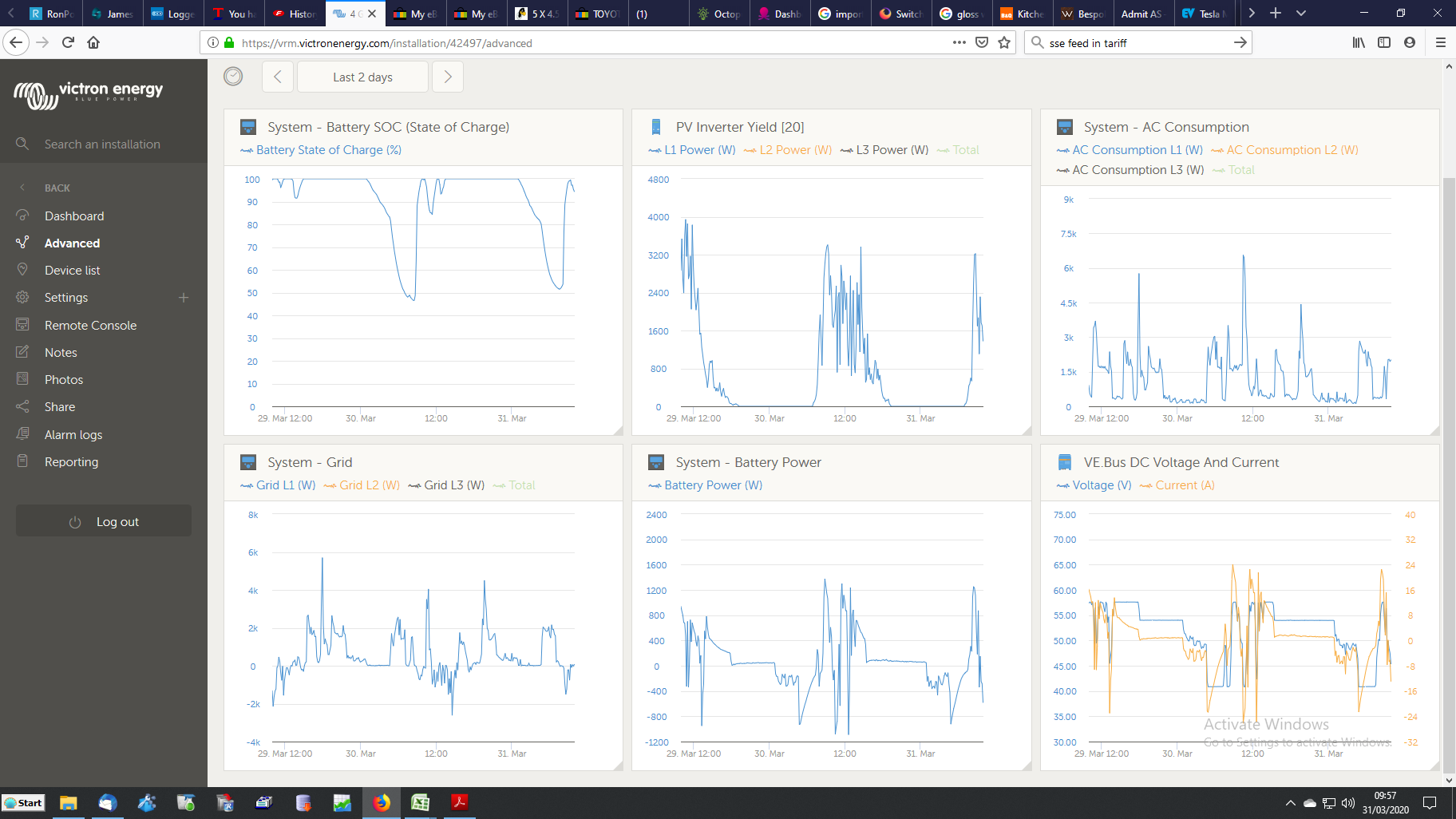

That I don't know I'm afraid. I don't think so, but I havent't gone that deep into it. In fact yes it does! It allows you to download the raw data to the cloud in .csv and .xls format
The graphs are for the past 2 days, I find that the most useful, however I can display from an hour to years.

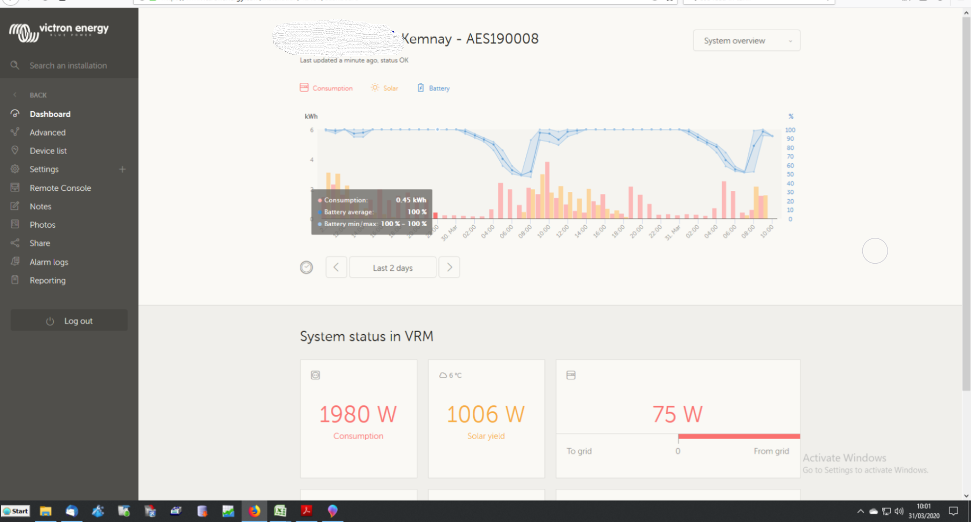

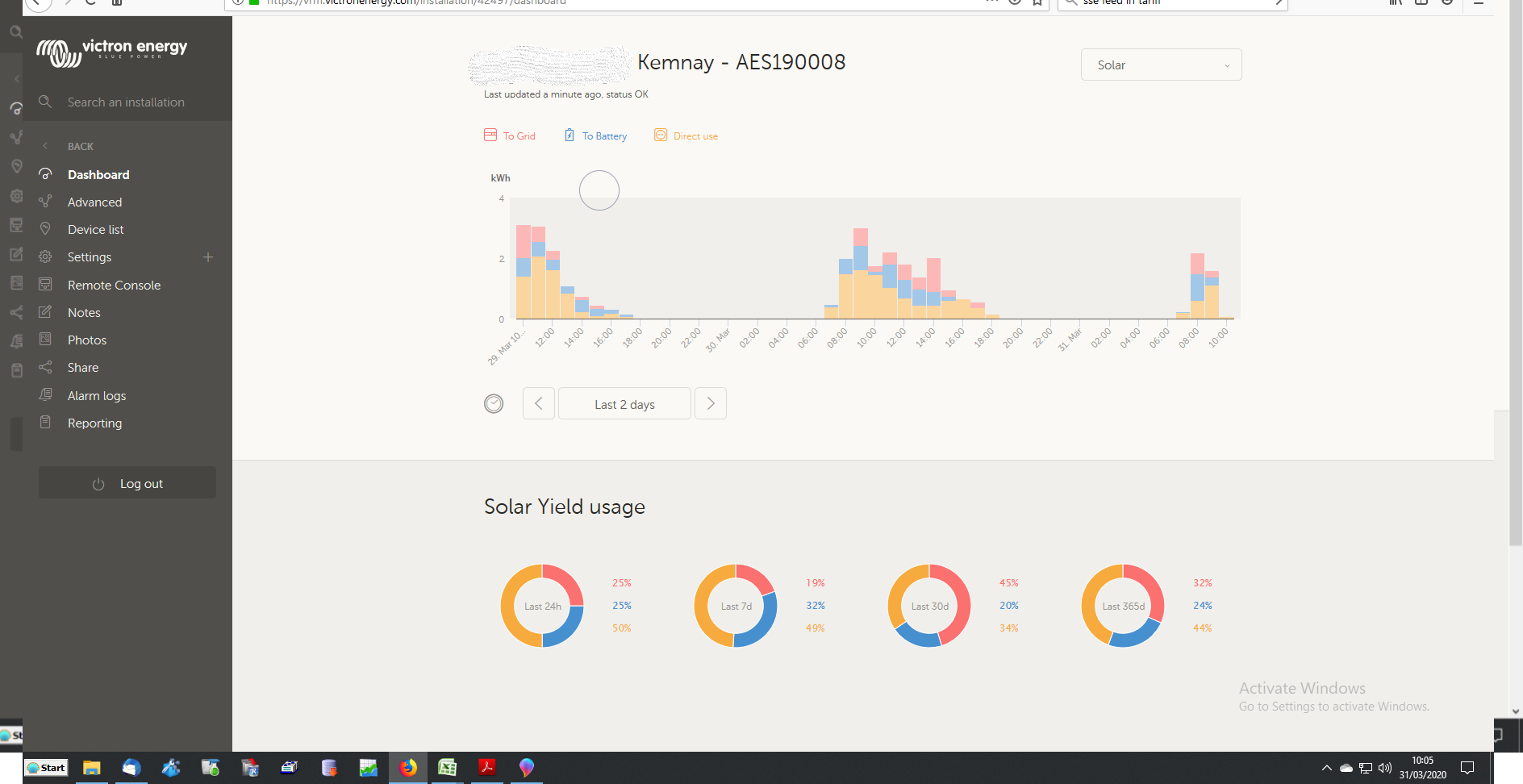

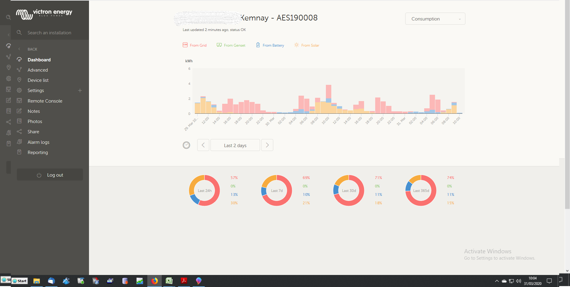

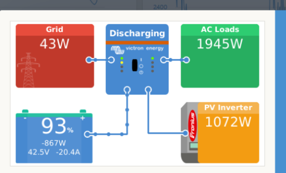

Here's a few views for you As you can see they're quite detailed.. You will notice the SOC graph isn't correct. We surmise thats because there's no BMS on the system.. there will be one when the new batteries get connected and possibly the Greenrock EMS next year
