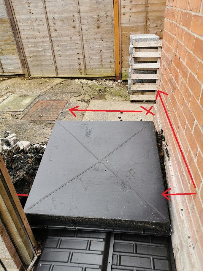

Hi, thanks for all the replies and advice, i really appreciate it, i have managed to locate the pipe, can anybody suggest what i need to connect to this pipe, to take it up and out, i can't block this off, or use a single piece fitting, as the toilet will still be in use, until we fit the upstairs toilet. thanks
Hi Peter, i did measure where the pipe is at the back of toilet, and then measured to the outside, so if the pipe does come out there, and not on some sort of angle, then i assume, that i am digging in the right place, and i wasn't aware, that i ad to let building control know, so i would need to let me local council know of what i'm doing?.
Whats an IC, downstream, which way? thanks

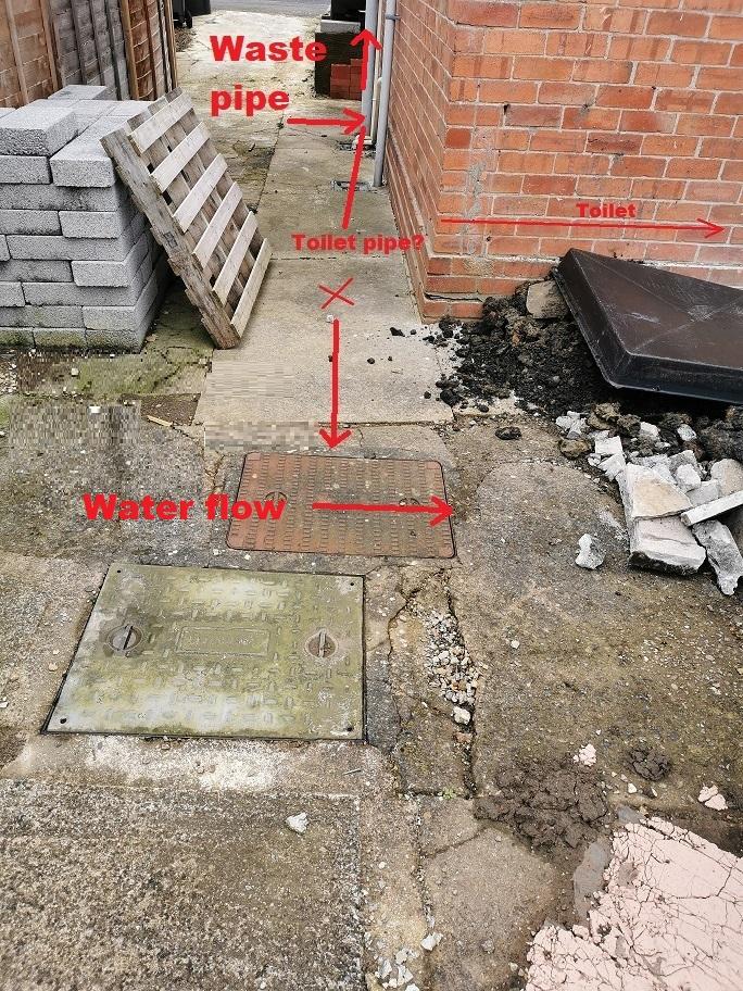

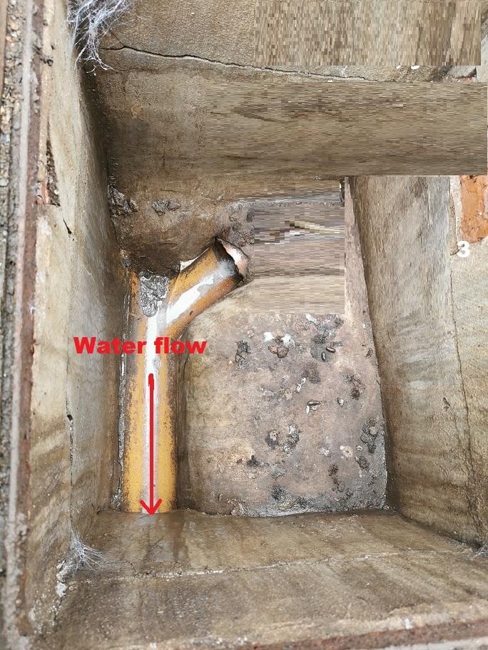

I have opened both manholes, and pulled the flush several times, those are the only manhole covers in my garden, but none of them show flush water coming through, and that's a real shame, my next plan was this.
Yes there are two covers, i have opened both and pulled the flush, and we see no water come through any of them? but on the first one, we hear the sound of water, and thinks we're going to see it, but it doesn't appear, i poured water down that manhole, and the water runs towards my neighbours house, so maybe that's the reason, only thing i can do is, go next door, ask if i can see it come through there.

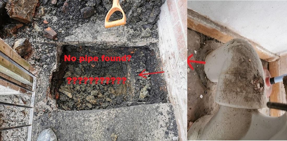

Hi, thanks, opening the drain cover, and looking at how deep the hole is, the hole is not as deep as the manhole is, i spoke to a guy who said it should be just below the service? this may explain why it's not been found, i just really need to make sure that the pipe is where i'm digging, as it stands now, to dig any deeper would mean removing more of the path, more work, which is ok, long as the pipe is in the place i'm digging, my reason for posting really.
I did take the lid off, the water flows towards my next door neighbours house, as when we pull the flush, we cannot see any water flow through any of the drains, but can hear it.
Hi, looking for some help to locate the waste pipe that comes from the toilet, downstairs, to the outside of the house, as want to get rid of that toilet, and put a toilet upstairs, with bathroom, i have dug hole, as show in the pictures, but the pipe is not visible. thanks to anybody who can help.
