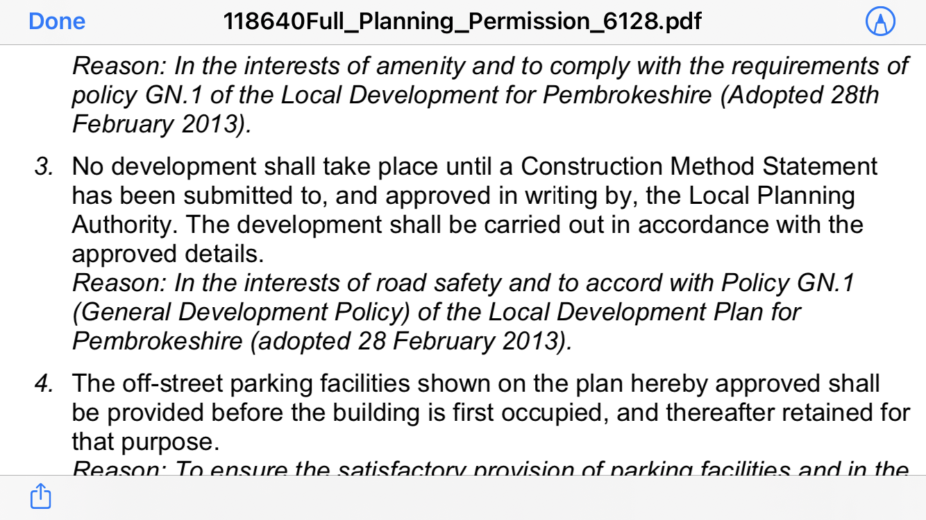

Construction method statement
DeanoFromTheDock replied to DeanoFromTheDock's topic in Building Regulations
Evening all, and happy 2021 just had the planning permission through for our new self build, the building regs are being put together by the architect but he doesn’t do construction method statements... I’m guessing all are pretty much the same and a national company could do it? would anybody on here have a better idea?

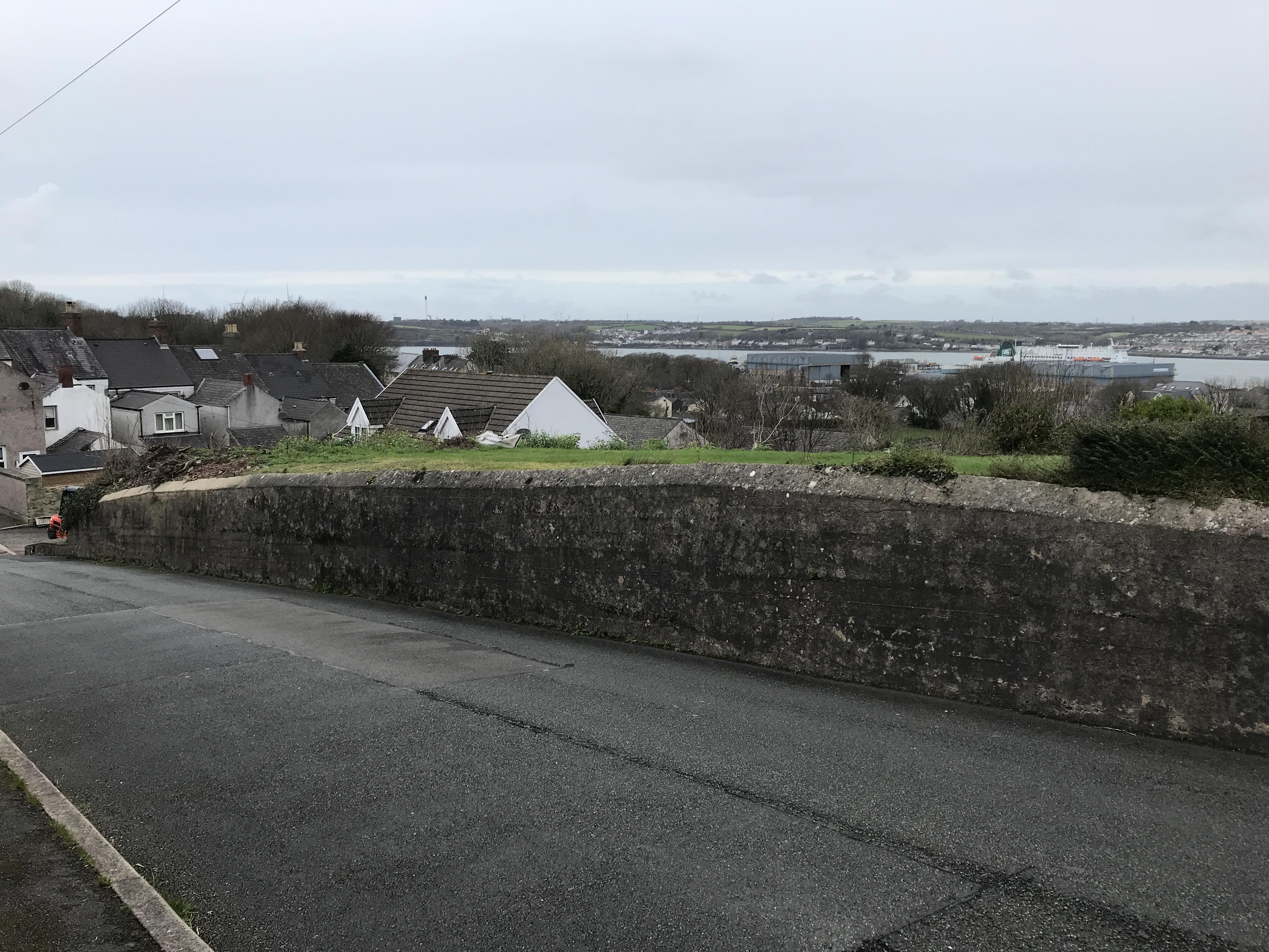

Good afternoon all, Planning permission in pro and making the step from house renovation to my first self build... so stand by your lap tops and please help a guy out. difficult build but i'm up for the challenge, looking to build a dorma with a garage below. i will attach a few pics later, im guessing i have around 200 ton to dispose of first
