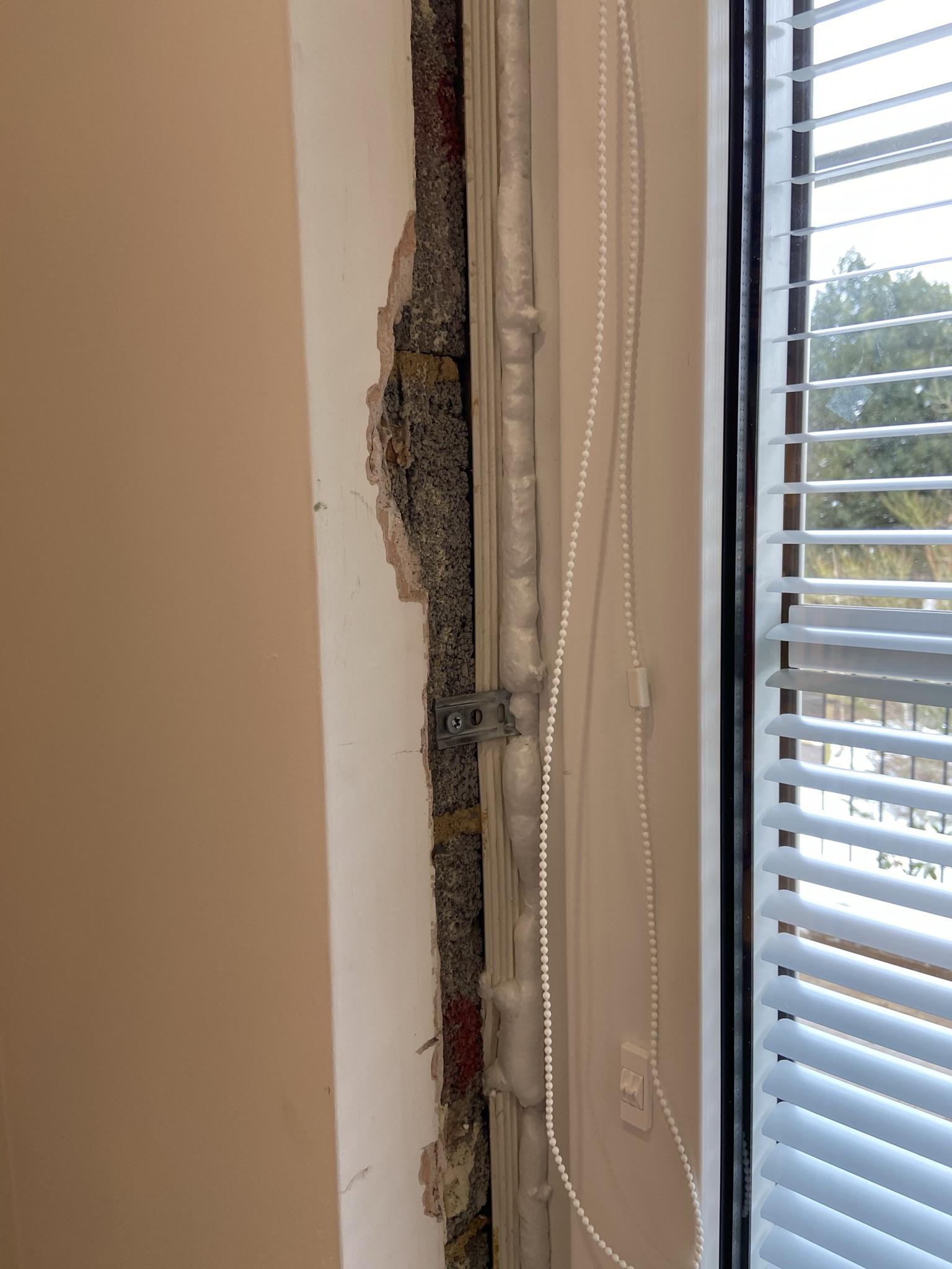

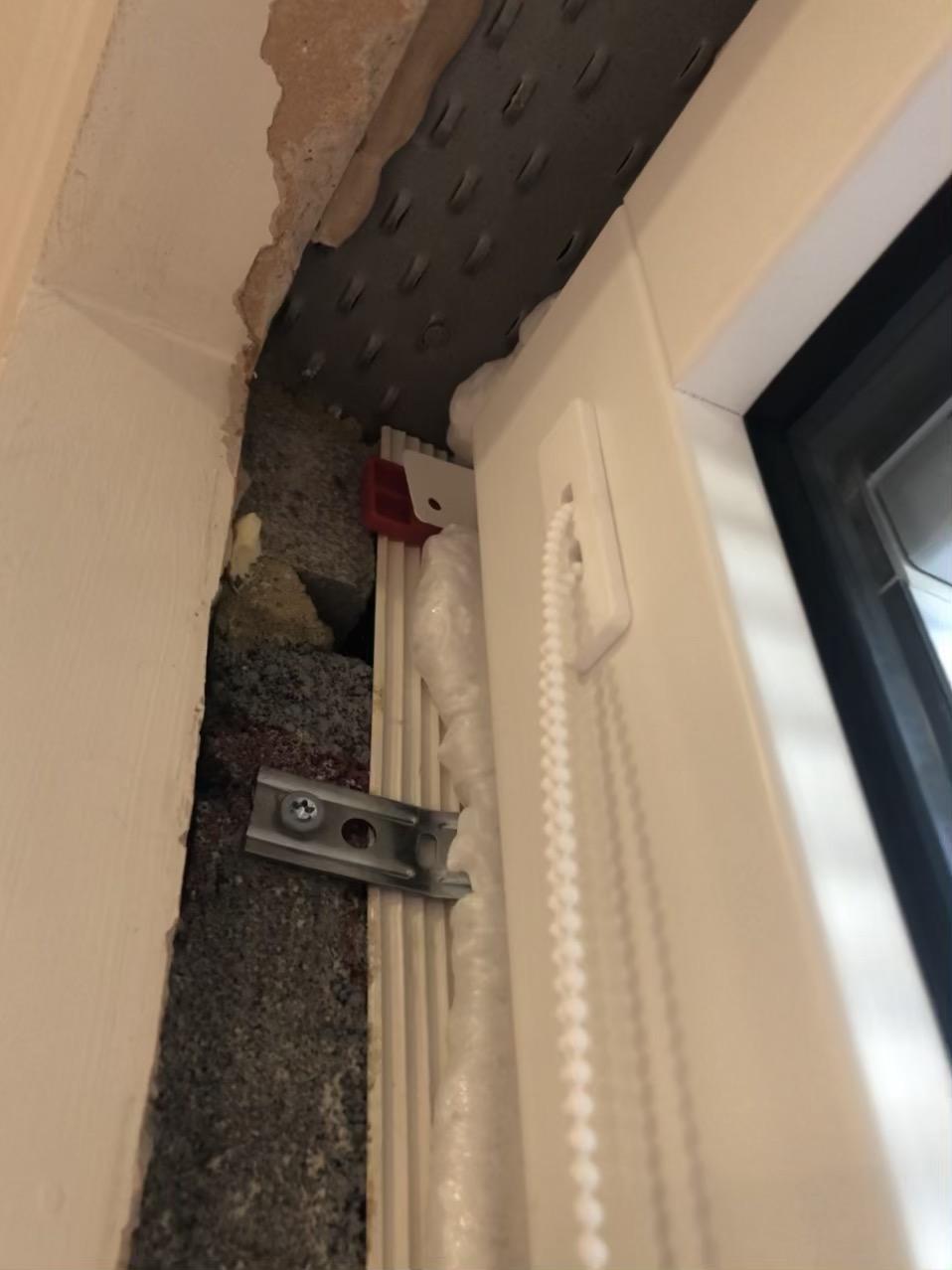

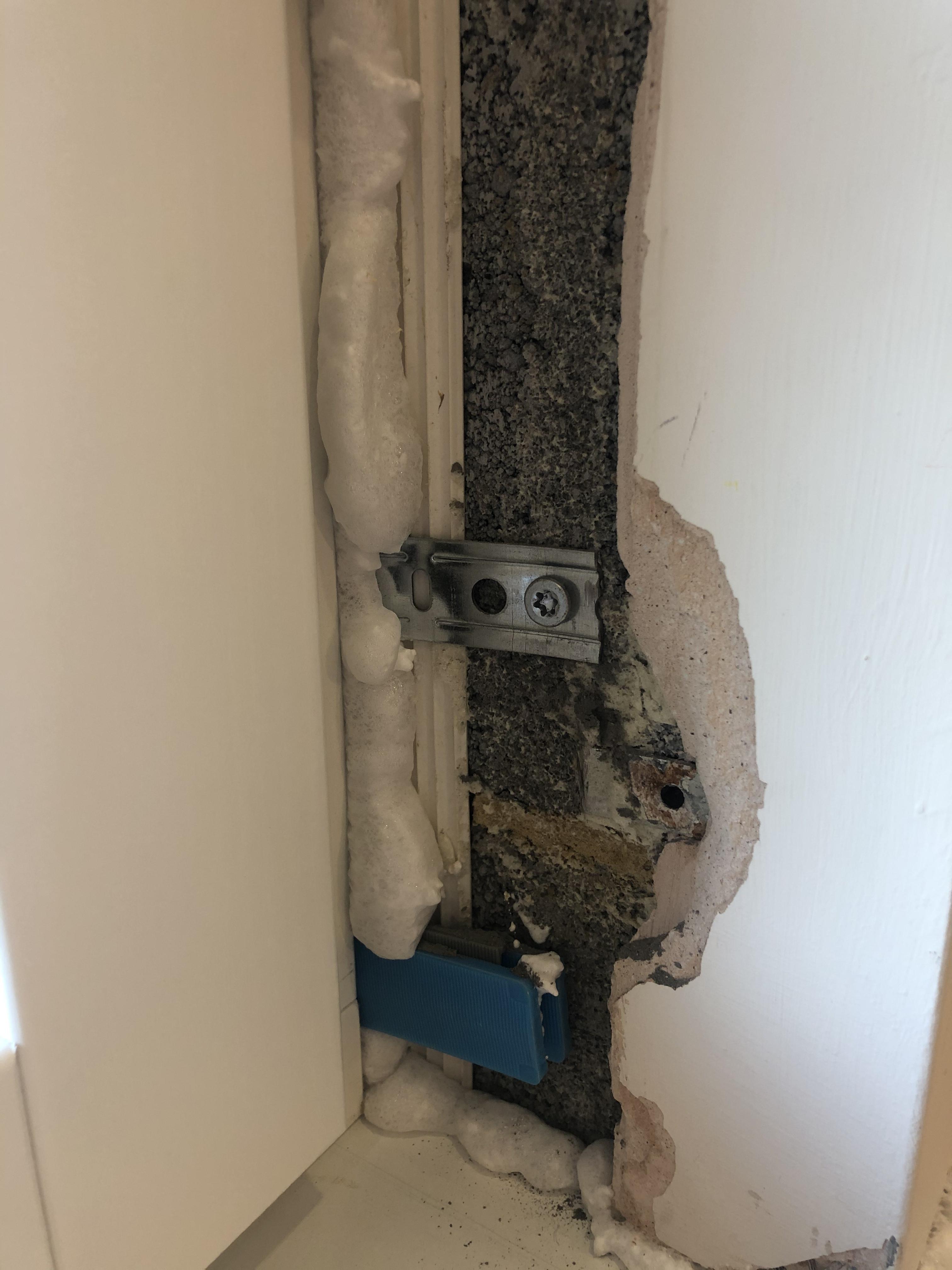

  5. Thanks Mike this is really helpful. If I was going to buy some tape, to tape the cavity closer to the block work - what would you recommend? I should also fill the holes then in the block work. What should I use? Trip to Screwfix coming. Thanks so much.
  6. Thank you very much - it is a relief to hear that the plastering will make a difference and the drown of car engines may decrease. Plasterer coming Monday. I’m not sure on compriband
  7. We’ve just had Internorm windows fitted - they are Timer Aluminium HV450 so should offer sound reduction 41-46dB. They have replaced timber sash windows. I am attaching some fitting pictures as not yet plastered. Bought for sound proofing but disappointed in what they are giving. could anything have been done on the fitting to improve the sound proofing? We asked for best sound proofing tapes/materials. It is a huge amount on windows £ to not get what we wanted. They are not plastered yet - will this make a big difference? thanks everyone.
